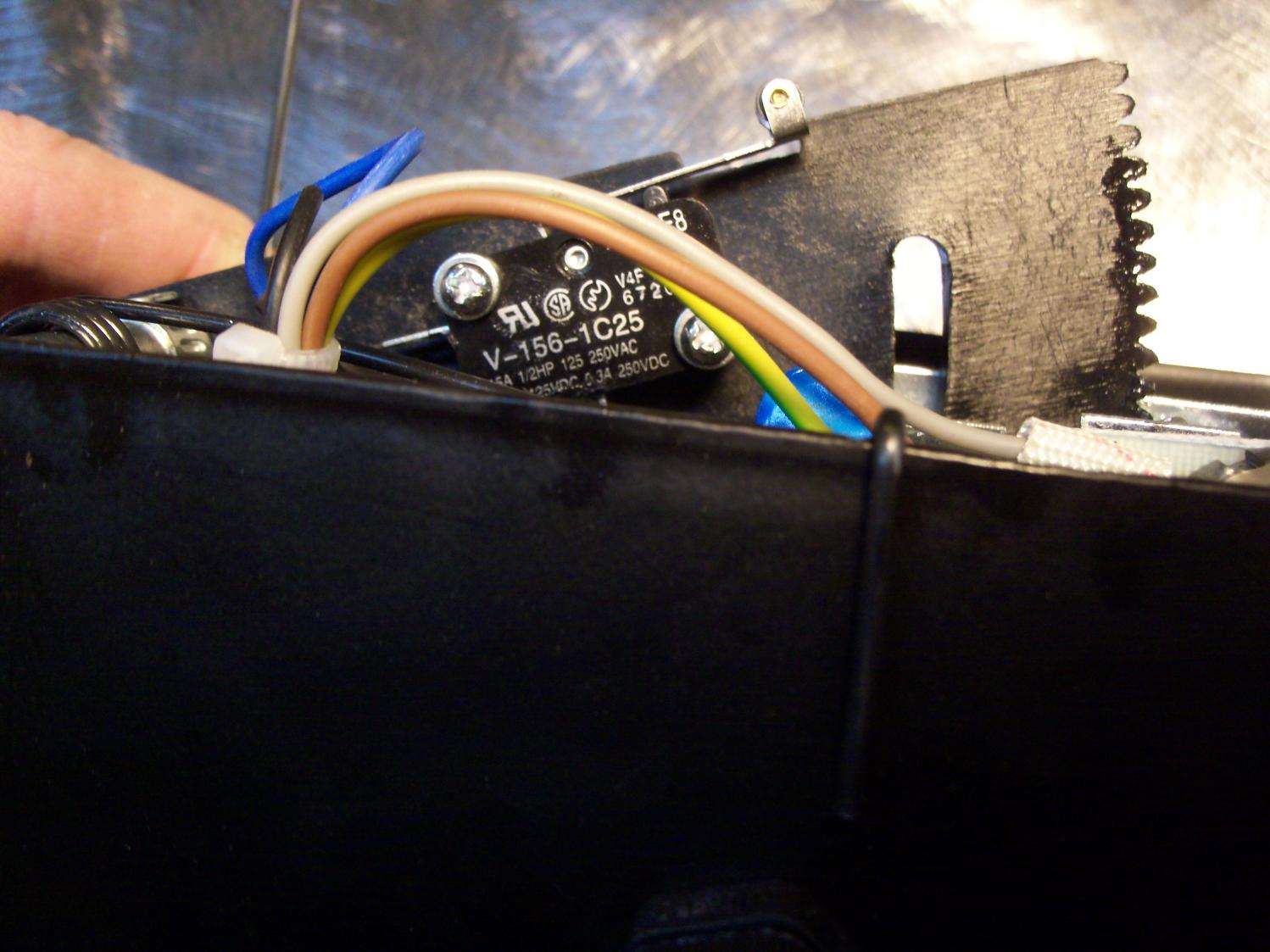

    Until this project, I have never seen Code 805. I do use the pedal in 2T, and also of course in Pedal mode. What I get is the Pedal mode gives me current control, and the 2T gives me instant panel amps. Great feature, use it often. The way the pedal is built, there is a slight disconnect between the switch and the pot. The first 3/8" of travel touch the switch, and after that the gear sector moves the pot shaft. This is better than the older style when you needed to fine tune the switch point, as the belt was already changing the pot value. Not the case with the new pedal, it works very nicely as a foot operated torch switch.
ID:	11373 Click image for larger version.
    I have set the AC start amps to 5 (the default lowest value) and then to 25, and get about the same results, which are: In Pedal mode, HF buzzes, enough to trigger my AD helmet (Balder lens), but no arc initiation. Let off pedal, post flow timer runs out, then next time nothing, no click, no pre-flow, no HF, etc. it seems that when it does this it will come back to normal after maybe 15-20 seconds. Then all is fine until it decides to do it again. It acts like an un-grounded work piece.

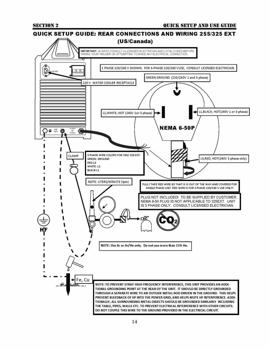

    Thanks on the green lineup. On page 14 of the online manual it shows the welders 220/240V plug is your not connected to the water cooler so when you turn the welder on it turns the cooler on. The Canadian one has it.
    Attachment 11370
    I may have to set up an outlet and wire my pump for 220. My machine is the early release with no rear outlet and the incorrect accessory package, (which should be on their way to us soon). It is such a capable machine, though, these teething pains are just that.

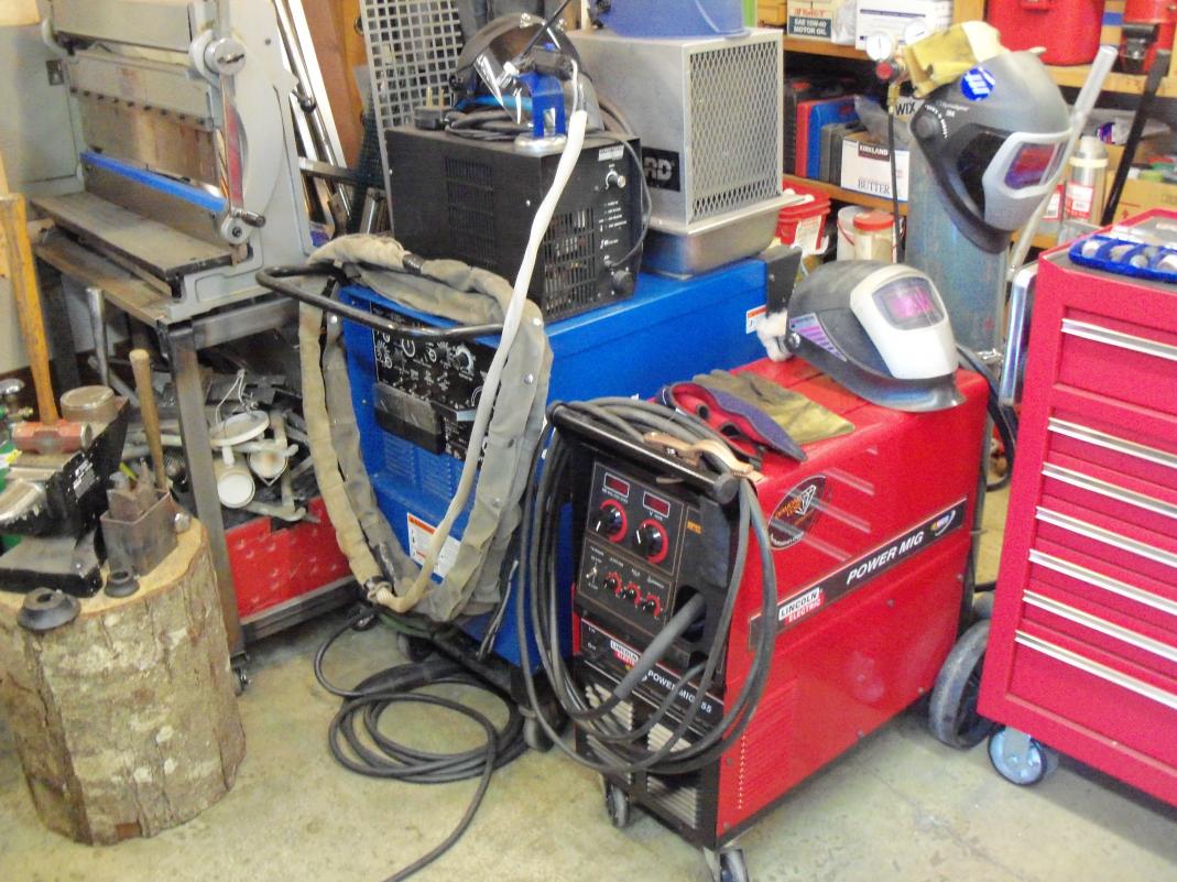

    I had never known of that trick on the Syncrowave crater fill/HF operation, nice little trick. Now had you been able to set the target ending amperage with the crater fill, you'd have had spot welding there, too. That option is not installed on my SW, and always made me want to get it just so the panel had all the knobs! But not so much any more.
    Here she is on display in my shop, hasn't had any use since my Legacy EXT showed up.
    Onward and Upward!
    Jim
