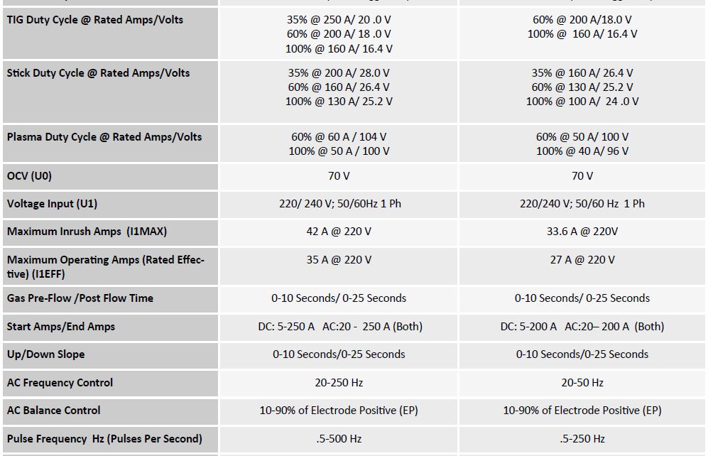

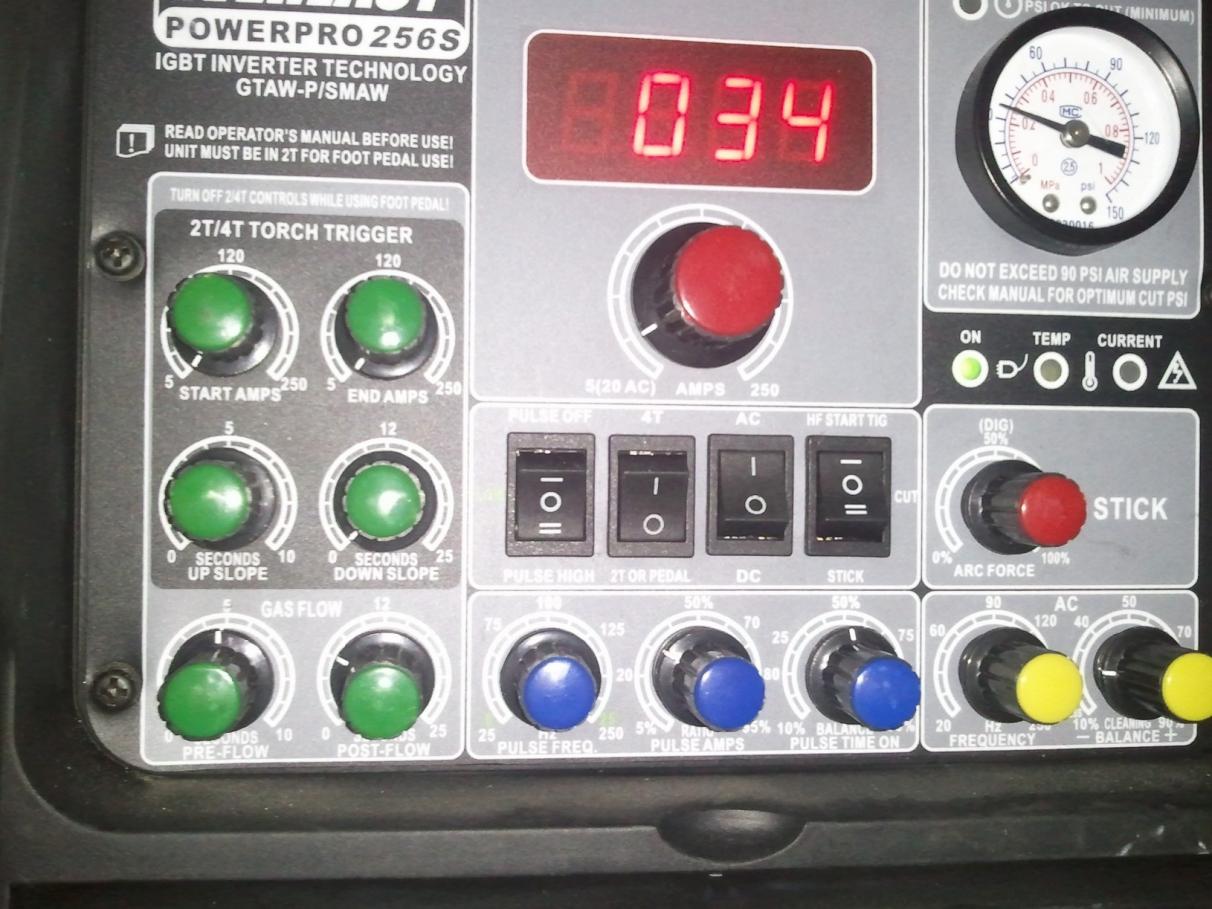

    Hello,
    If I am reading the specs right my PowerPro 256S should pulse up to 500Hz. However the nob only goes to 250Hz.
    What is up with that?

    See if it goes to 500 hz in DC pulse, your picture shows it in AC. My 255 EXT works correctly, and it pulses at 500 in DC and half of that in AC. 500 hz DC pulse is actually musical
    Jim
