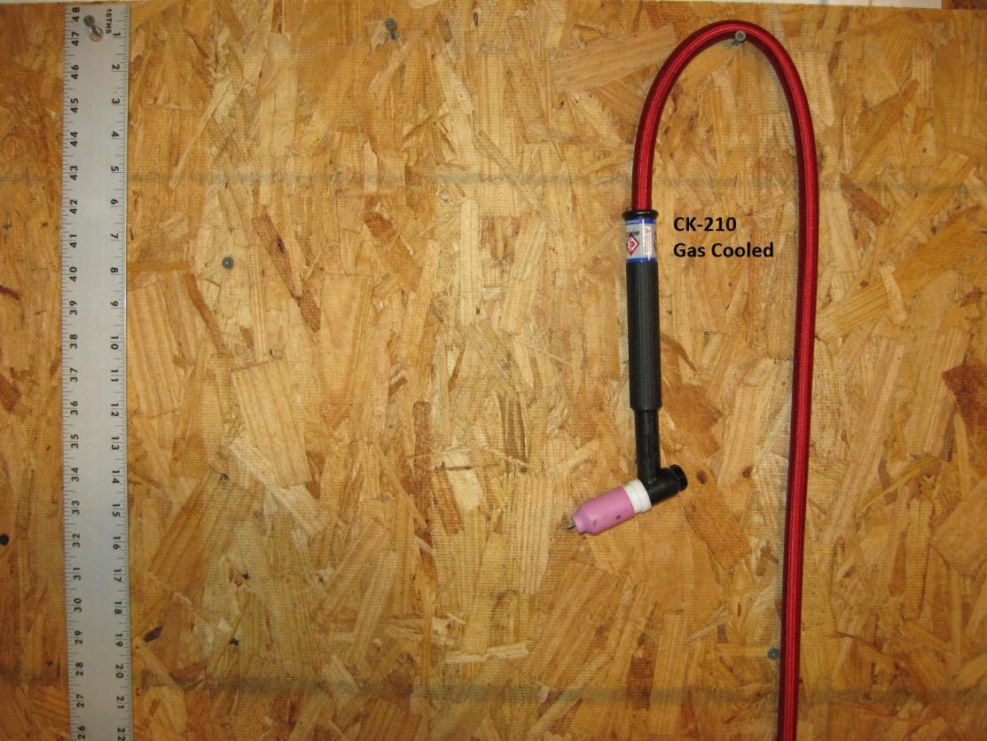

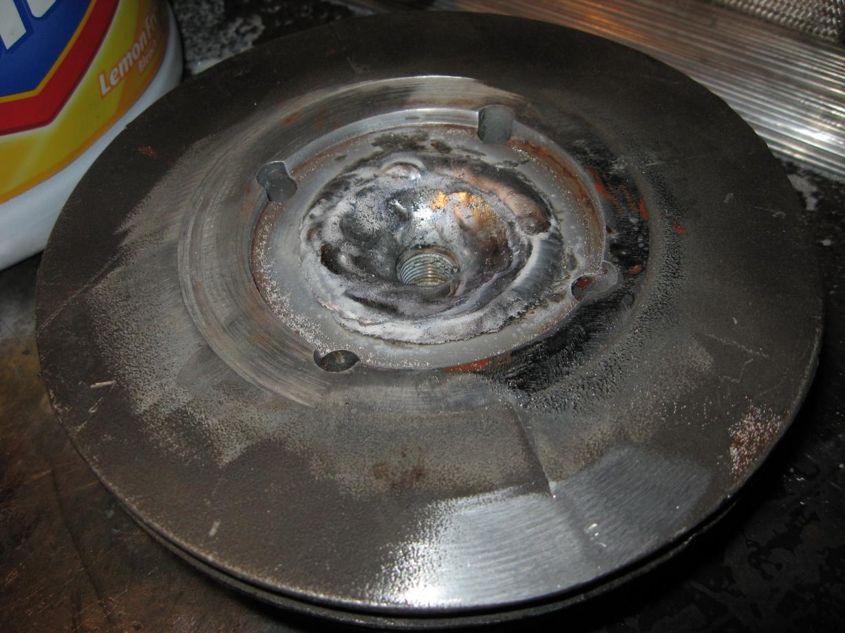

    I use a gas cooled CK 210 with my 250EX. It'll take 250 amps for short welds but it gets pretty warm on AC over 200 amps. I recently built up an aluminum cylinder head for a air cooled 2 stroke race engine so that it could be remachined for a smaller chamber. With all those cooling fins I had to bury the fins in a bucket of glass beads to keep the heat in it. I gave it around 240 amps to get it hot, then backed off to around 200 once the heat started to build. It looks ugly and uneven with one little low spot, but all that will machine off. The Tig Finger I was wearing got so hot I couldn't touch it for a few minutes.
ID:	11328 All kinds of junk was cooking out of this thing as it heated up... sounded like little firecrackers going off.

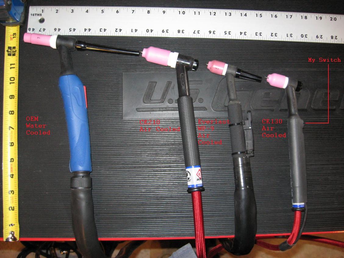

    I use a gas cooled CK 130F under 150 amps which is most of the time.
    Plug and play CK torch packages are available through Everlast sales.

    One of our welders brought in a similar project to what you posted. I watched him weld it and was really shocked at how much junk was coming out of that thing. It looked just about like yours after weld but it really machined up nice.
