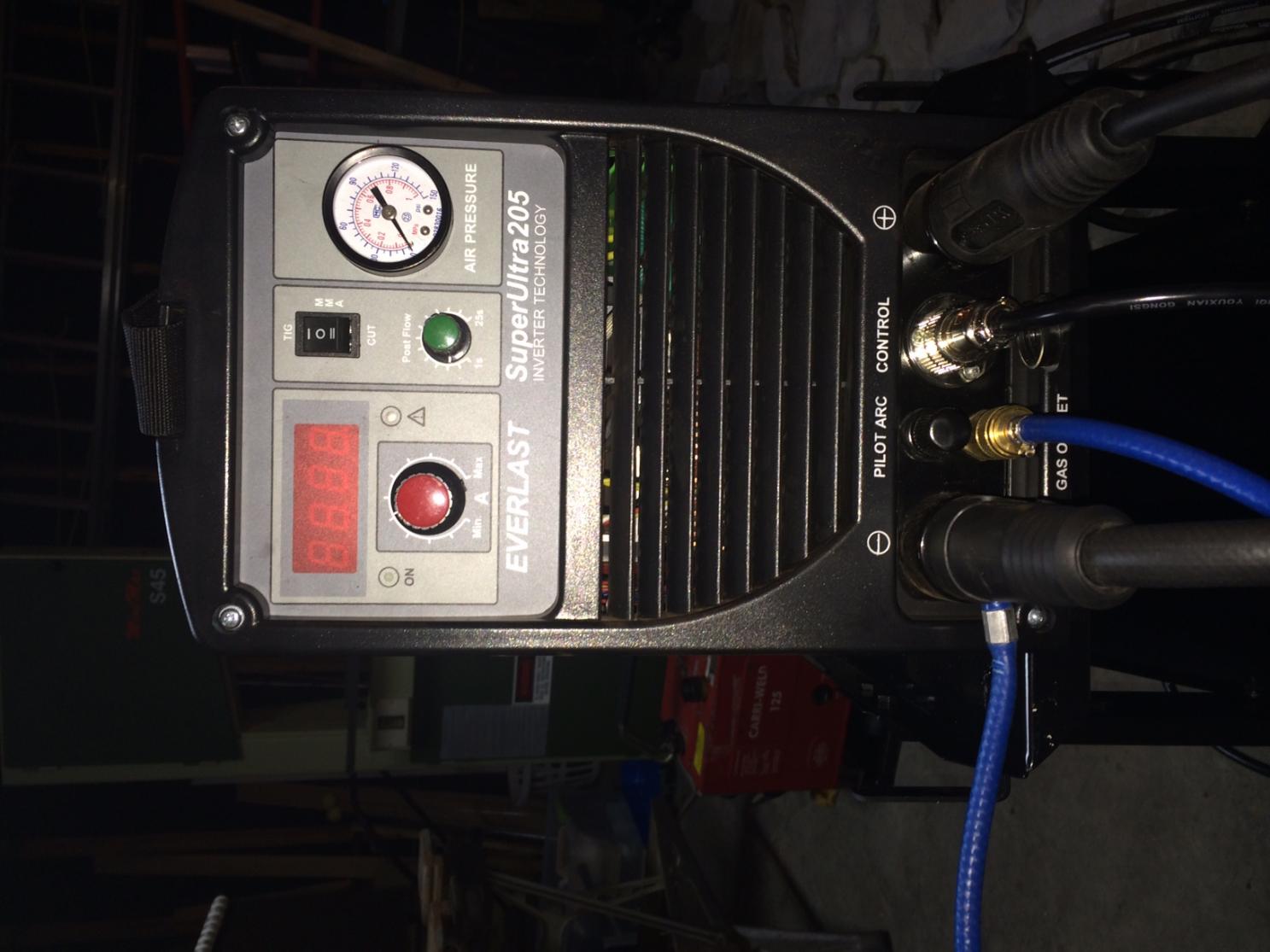

    Do you have the rocker switch set to 2T for foot pedal operation ? A picture of the front of your machine always makes it easier to diagnose problems because we can see all the settings.
    Hi Zoama, I do not believe the SuperUltra has a 2T switch...
    Is there an amp control on the foot pedal ?
    No Amp Control knob on this foot pedal... There is pot inside that gets rotated when you depress the pedal.
