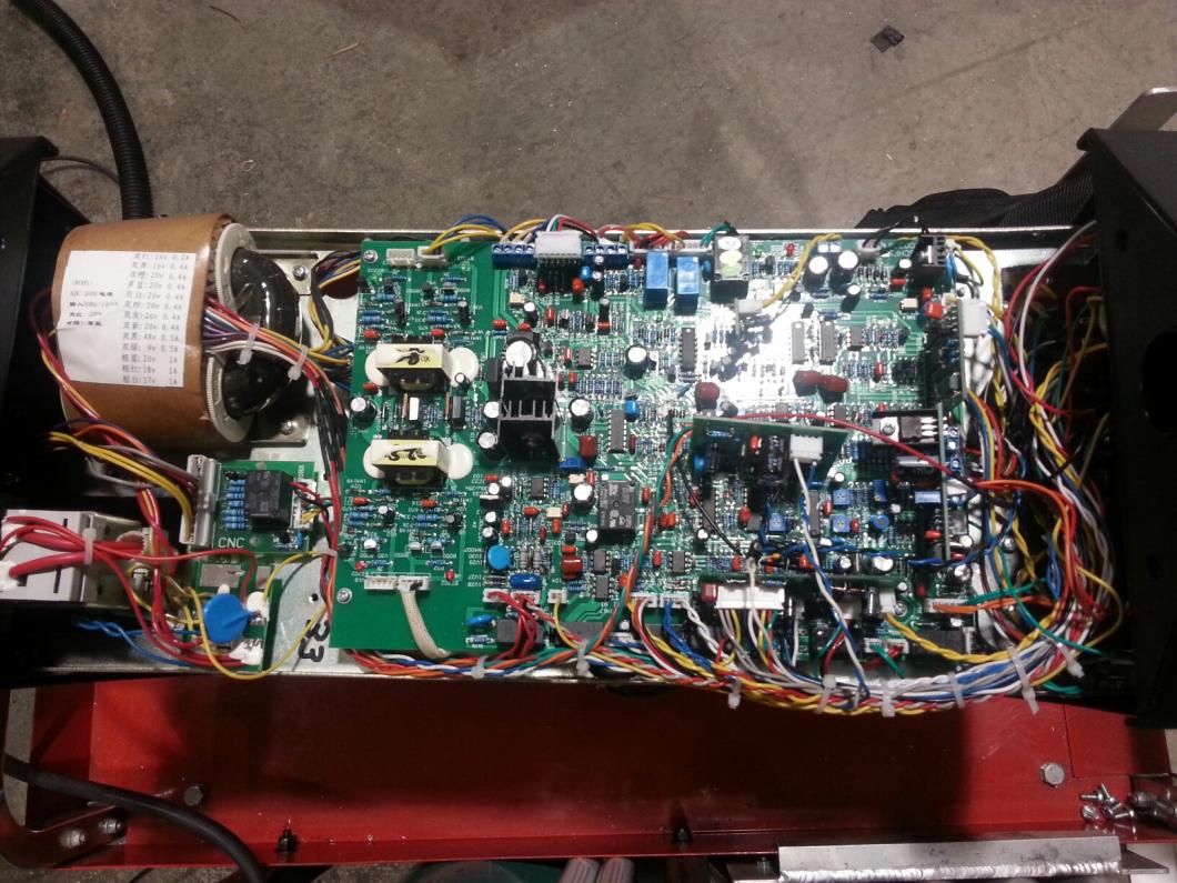

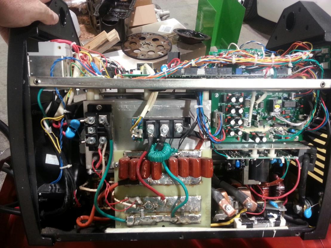

    still trying to get this resolved. Ray stated that the red light on the front of the machine is an overtemp light and that it may not be cooling but i can get it to happen from a dead cold machine inside 3 seconds of welding at 100amps and plenty of airflow through the machine from the cooling fan. he also thinks it could be a faulty temp sensor. but im not sure where itis located to jumper it for testing. any help? schematyics etc to help me find it?
    thanks guys!
    Chris

    Above are pictures of the inside of the machine, I removed the protective plastic sheathing from both sides for better viewing. does anyone see anything that jumps out thatmay be wrong or can anyone point me to the temp sensor so i can test it?
    Thanks!
    Chris
