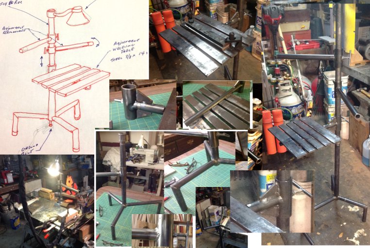

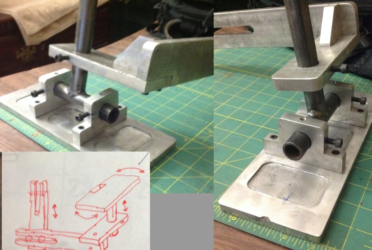

    Anyway, I have been meaning to post an update to let everyone know that this replacement 205 has been very stable and I have been having a blast with it, when I can find the time… Have gotten over my whiney phase ;-) and now just plowing along…Havent taken many pictures really but have made a few changes to the shop in the process and have done a lot of little odds and ends welding and practicing, here are two little projects, a little adjustable welding fixture stand of sorts out of SCH 40 pipe (coping practice really) and scrap and a 6061 work rest for a 2x72 belt grinder still in processs, the rest itself is actually made from two pieces of 6061 ½”x2” , double v groove welded then quickly milled.. the tubing is welded and the rest will get welded out once I get my geometry the way I want it… its down and dirty,,,
    Have done a bunch of other crap, tested everything and had a great time stick welding after all these years as well, that has been great fun…. And The plasma is just plain awesome, but the AC/DC tig is the friggin the bomb as they say!!!!
    Oh well, take care and thanks to everyone for all the support will post more when I actually have time and something good to report..
    Gary
    Simple Fixture stand

    6061 work rest for belt grinder
