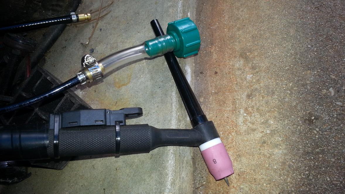

    On the water cooling, hook up the hose or tap to it, done it for too many years to count. Get a arc flow (as Mark would say) "about like a water fountain" and just drain it outside the shop or in a sink. See below.

    There's a number of ways to adapt the torch. It doesn't take a lot of flow so you aren't wasting a lot of water.
    Old school shops have done it this way for years. If you've ever walked into an old welding shop there's a water spigot right beside the refrigerator TIG sized welder, and a floor drain right next to it.
    This isn't anything new...and works just fine...especially if you've got some flowers that need watering.

    Ok I'll do that. Seems simple enough. Apparently that's what my boss use to do. I'll post results today or tomorrow. I have a small 60cf tank I'm refilling with argon to test for gas contamination as well. New torch is on its way too.

    If you suspect bad gas, a refill may not do the trick. A swap would be preferable. Of course, if your supplier is giving you bad gas, even a swap is not guaranteed to fix it. Anyway, best of luck.
    I meant swap. I get my gas from GTS Welco. They just swap empty for full bottles. Although I'll pretty sure 90% of local suppliers all fill from a place in Fairhill, Pa. So hopefully it will tell me something new with another bottle.

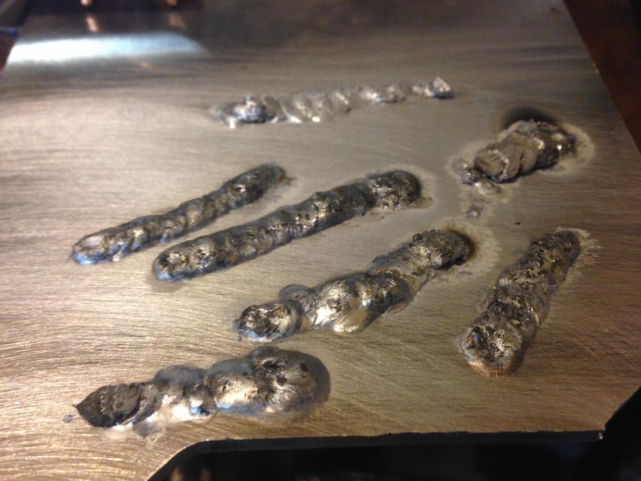

    Well I tried the water cooled torch. Doesn't seem any different as it was before. I guess the next step is to check for bad gas. If I had bad gas would I still be able to weld steel nicely? After I welded some aluminum I threw down some nice beads on steel with no problem. Well here is the picture of the welds.

    Could you post a picture of the tungsten sticking out of the torch and the steel welds. What was your arc length ?
  18. #38
    Your problem is largely coming from the metal in this picture. You can see the discoloration on the metal in that light. This is not cleaned well, not even close... Whatever is causing the discoloration, whether rust from a piece of steel, or laying in the dirt etc, this piece of metal is not cleaned well enough to start welding.

    i would like to know if those shots of the al welds are all on the same piece of aluminum.

    I went at it with a stainless brush. That's the same level I've cleaned aluminum and welded on other machines perfectly fine.
