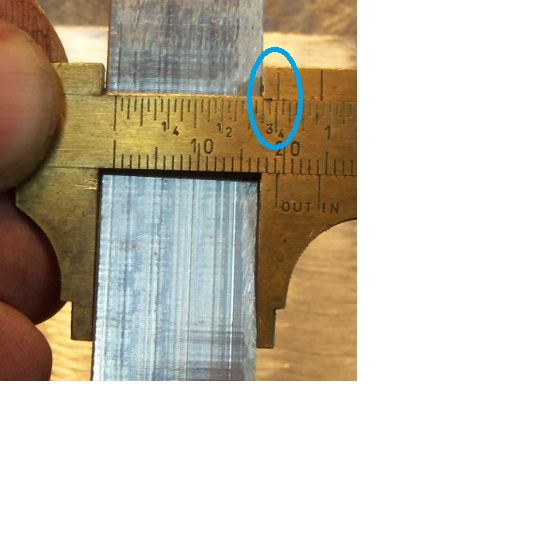

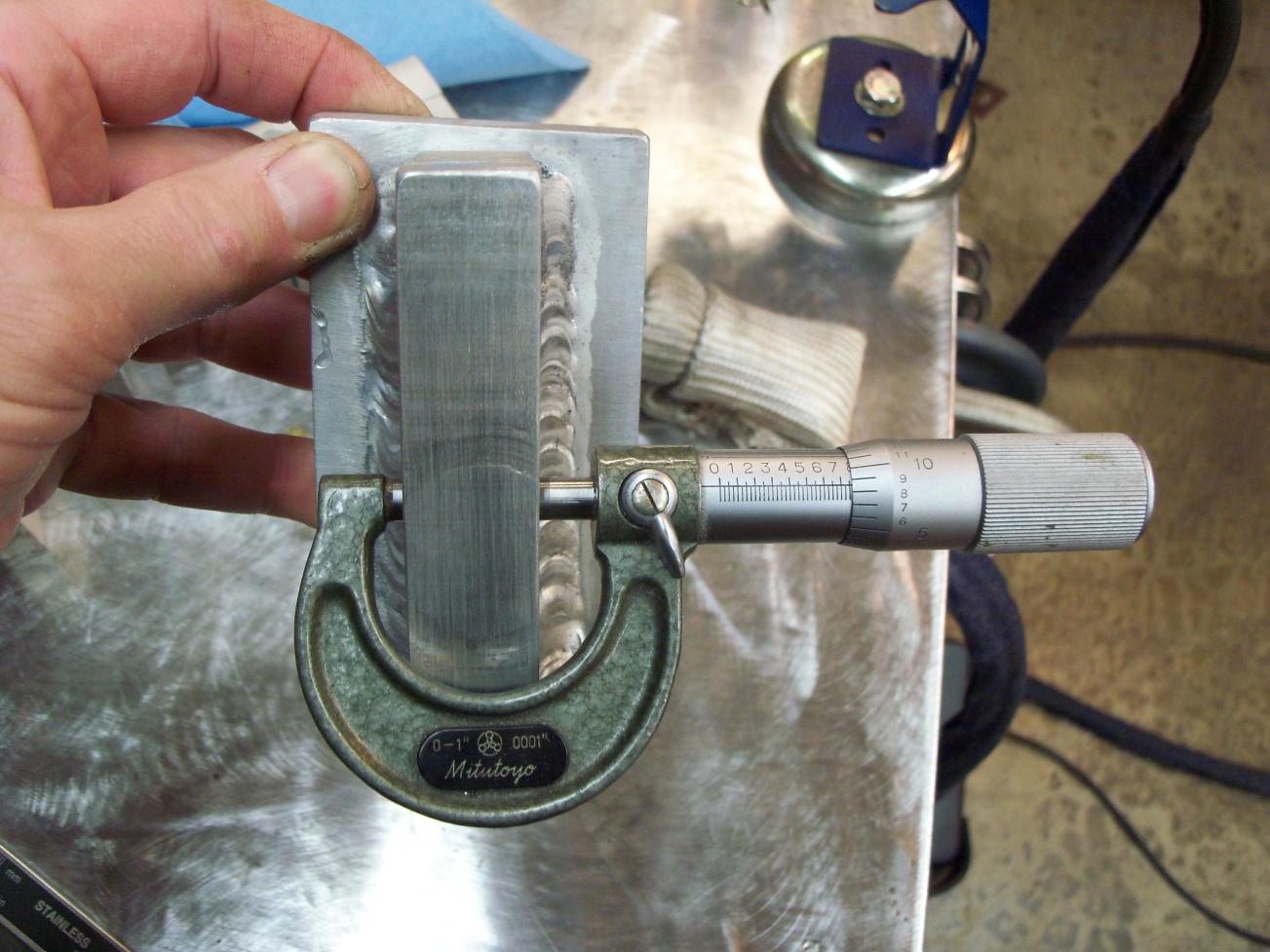

    Actually, that's 3/4" aluminum, not 11/16!
    Thank You Mark, it is indeed 3/4" 6061 Plate.

    It mic's out at 0.7586", a few thou over 3/4"
