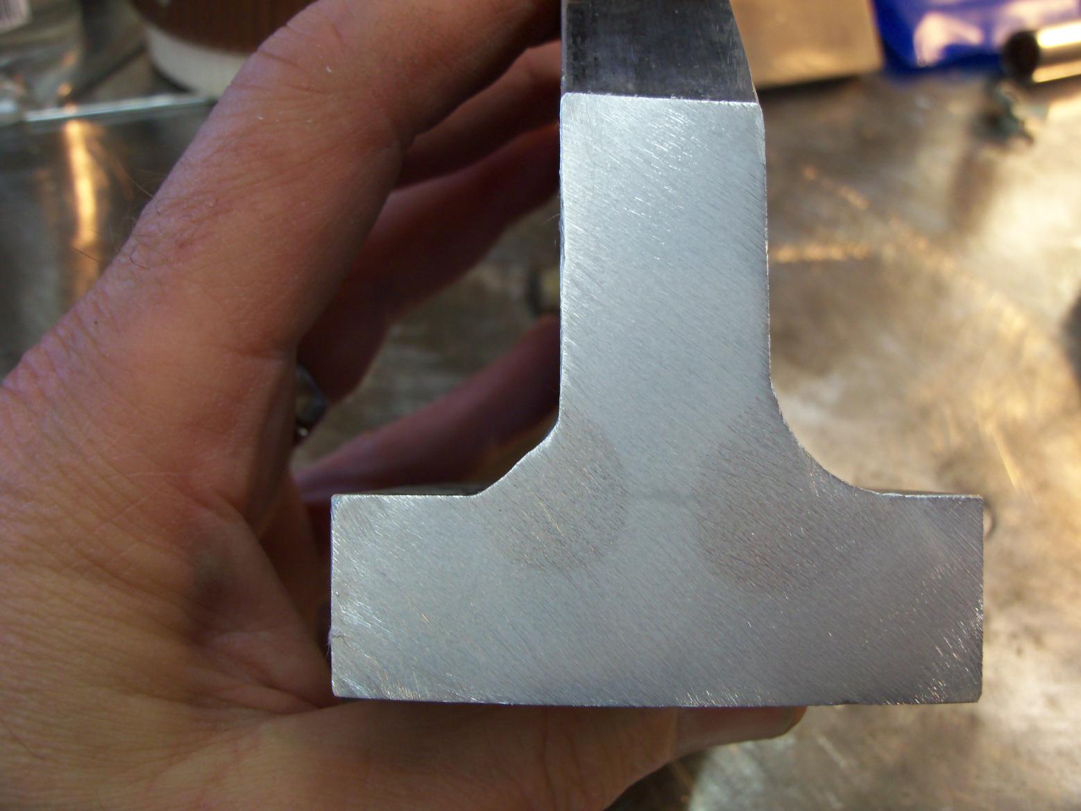

    Welcome, ATOM, I recognize your handle from over at weld.com. Here's a link to a thread from just the other day, showing pictures of what thickness aluminum the 255 EXT will weld.
    http://www.everlastgenerators.com/fo...tional-machine
    The photos show the machine welding every thickness literally from razor blades to 11/16" aluminum... I'm sure anyone reading this thread is curious to know what you have in mind to weld that is thicker than that- if you don't mind telling!

    Actually, that's 3/4" aluminum, not 11/16!
    Thank You Mark, it is indeed 3/4" 6061 Plate.

    You can get a good deal if you directly with someone at Everlast (like me).Our warranty is the same for all products sold through authorized distribution centers/dealers. Amazon is one. We, of course are another, which is direct from the source. The last major update was earlier this year...but we always are making additional improvements we don't publicize...same as everyone else.
    If you look at Jim's thread, (use new posts button to check for the most recent update tonight) you will see cut away images that shows the penetration.

    Quote Originally Posted by A-T-O-M View Post
    The heavier aluminum plate images are more interesting to me. However, they would be a lot more impressive if they were sectioned so we could see the root penetration. Still, the heat is apparently available to melt the plate at least on the surface...so that is a good start.
    The plate sectioned > Attachment 11150 Click the image for a larger view.
    Source: http://www.everlastgenerators.com/fo...0589#post50589
