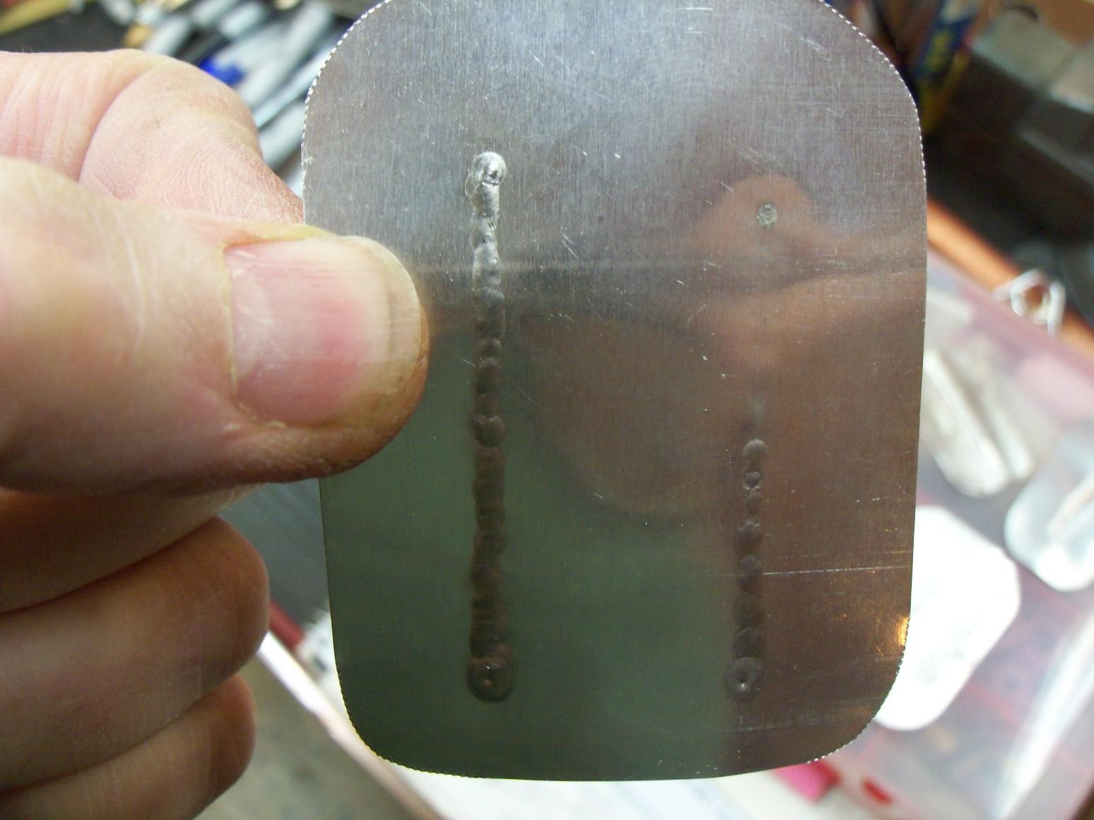

    Now onto the thin aluminum. This is 0.015" sheet aluminum roofing flashing. The settings were all under about 15 amps, and various AC frequencies, and some with 30hz pulsing. AC frequencies as high as 250hz. All using pedal control.
    A shot of my more successful samples, I could work harder to make them pretty, but this was a test of the machine's low-end, not me so much.

    This is a very small autogenous edge weld joining these two "L" shaped pieces. Amazing control that can do that without a total meltdown through that thin edge.
ID:	11130Click image for larger version.
    This is both sides of the same piece. I have flipped over from bottom to top. As you can see, I was able to lay a bead on just the top surface of the right-hand side of this 0.015" thin sheet. That's good and low.
    That concludes the low-current testing. The PowerTig 255 EXT excels in this department, and puts tremendous control and capability into the hands of the operator. But that's not the real story here.
    In the next episode, we leave charted territory behind, reality will never be the same. Follow me, now, down the rabbit hole...

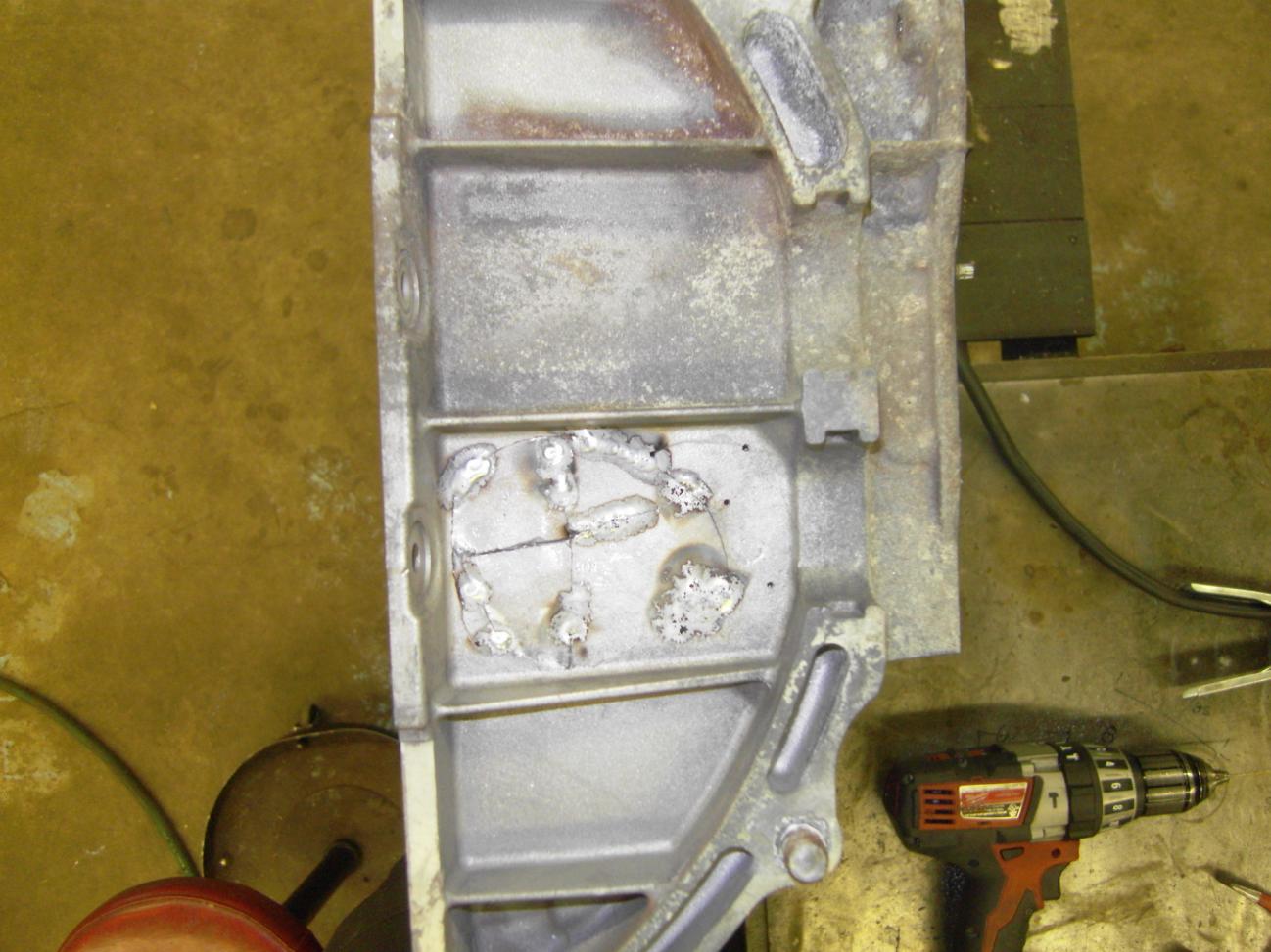

    Welded up some transmission cases with the 255EXT. The cases are very thin and keep cracking after welding so I just weld them to keep the pieces in place and the transmission shop uses Fel-Pro Aluminum epoxy to seal it up.
Name:	Trany case 1.jpg
ID:	11418Click image for larger version.
Name:	Trany case 2.jpg
