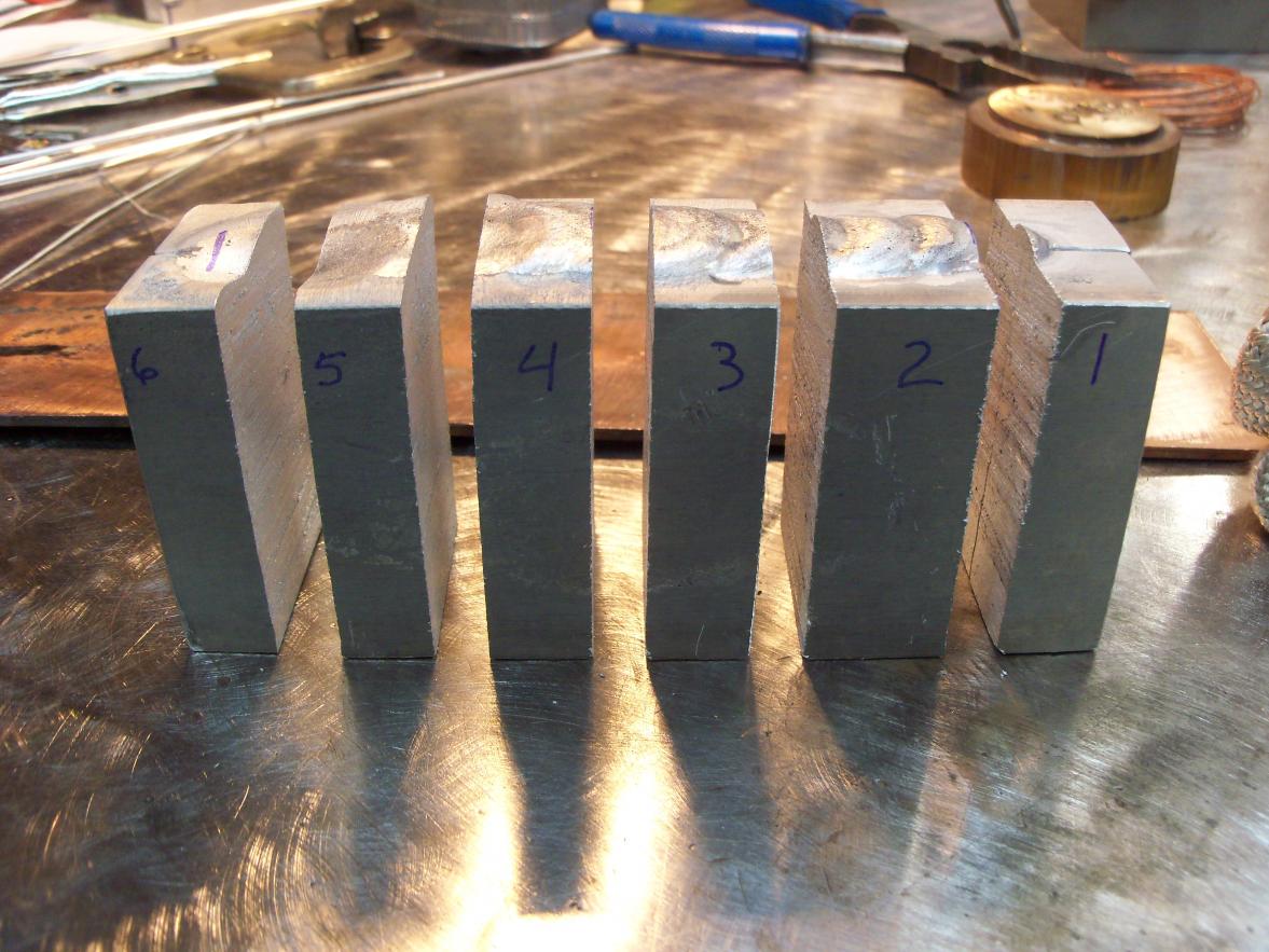

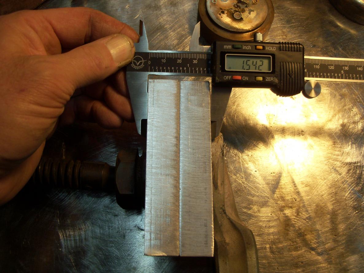

    great thread. i think the photo that grabbed my attention the most (though they were all good) was the one of the perfectly formed dollop of aluminum sitting below the hole in the plate above it. how the heck did that happen. lol
    Seeing that hole WAS pretty impressive. Mind you, the whole review was impressive. I'm going back to the other thread to look at Duncan's specs to see if I can figure out the settings.
    Jim, nice work. That is very intersting effect on the thick plate melt-through. Haven't seen anything like it.
    Can you add how long it took to get a puddle on those thick pieces? If you say "right away as fast as can be, I wasn't even flooring it", for pure argon, I will be VERY impressed (although that is probably not a realistic expectation).
    Eventually, I'd like to know or see how the 255EXT with your "magic settings" might work on a truly large weldment. Here is the massive flatbed alumium trailer that kicked my Super 200P's butt:

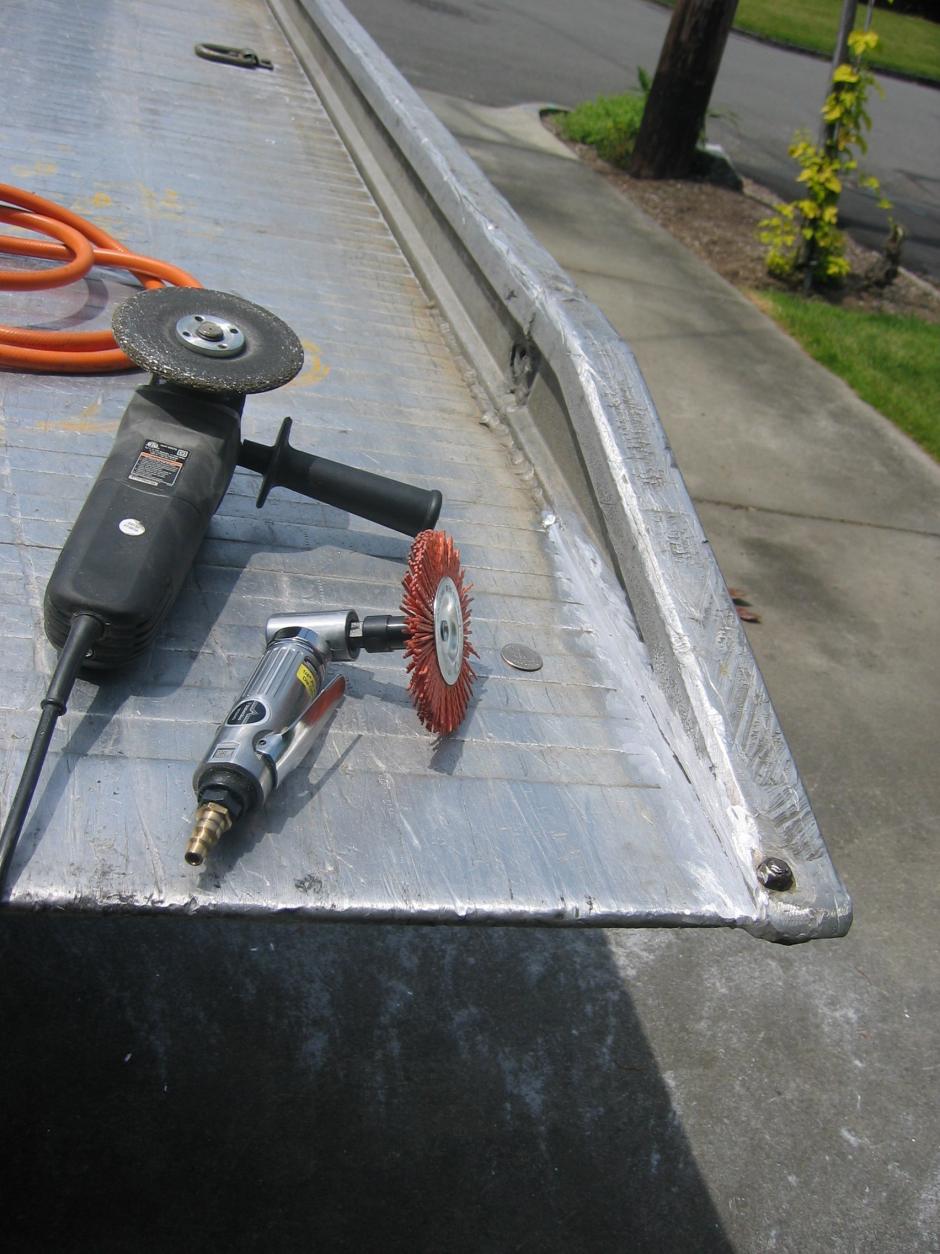

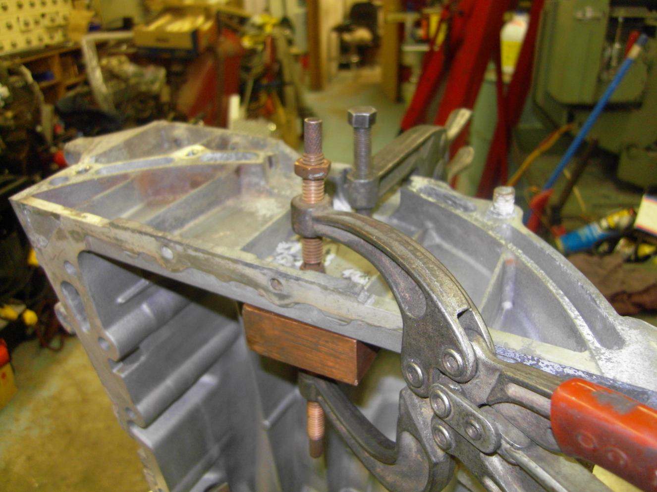

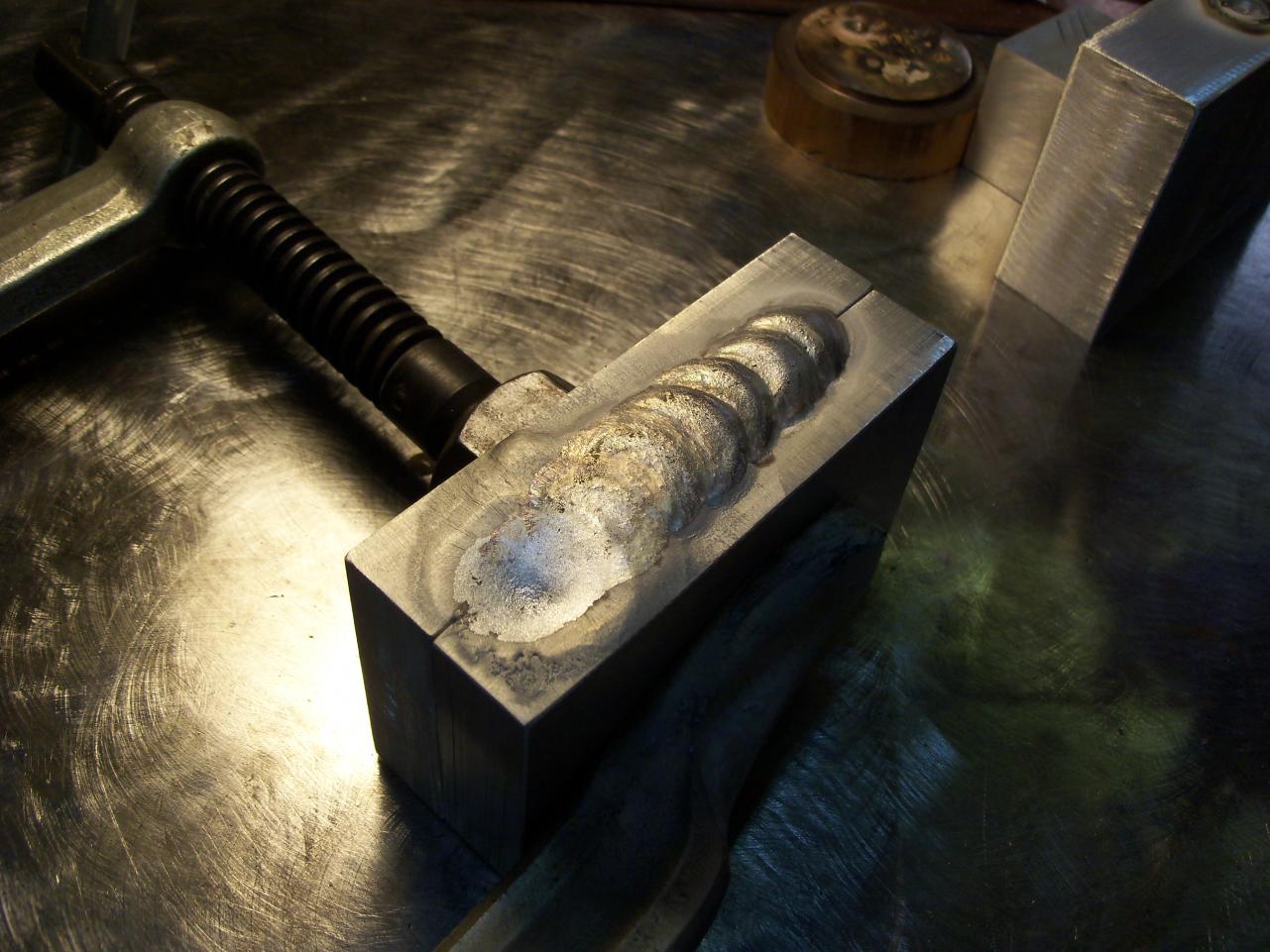

    It's the biggest and thickest aluminum "thing" I ever tried welding. I think those cast side rails (with a cast-in beam shape) had upper and lower flanges about 2"x1.5" (you can see the 2" dimension being measured above). But the massive size weldment really made it impossibe to pre-heat or even really to sit there with the arc letting the heat build up, even. The massive weldment just conducted the heat away too fast for anything to work. (This was before I got Helium, and I still wonder if even with Helium I could have done it with the Super200P.)
    Do you think your 255EXT could have done it with pure argon?

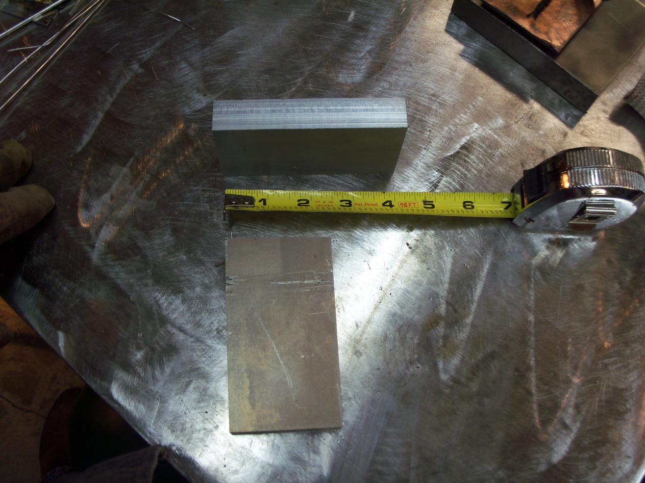

    Jakeru, the 1/2" plate took only about 30 seconds to start, run across the plate, AND melt through. The 3/4" T-joint took about a minute for each side from a cold start. So, it gets going right away, and I only have argon.
    It would be interesting to see how it handles your trailer work. Where exactly does it need welding? Does it break, or wear down?

    Judging from the grind marks, it looks like jakeru was aiming to weld the inside corner where the side rail meets the bed(?) That's one massive heatsink but given the really small and well formed hole that Jim put into that block of aluminum with the 255ext, I think jakeru could have done that job with his new 255ext on Argon. The 255ext seemed to be able to put down a lot of localized heat quickly which is exactly what jakeru needed.

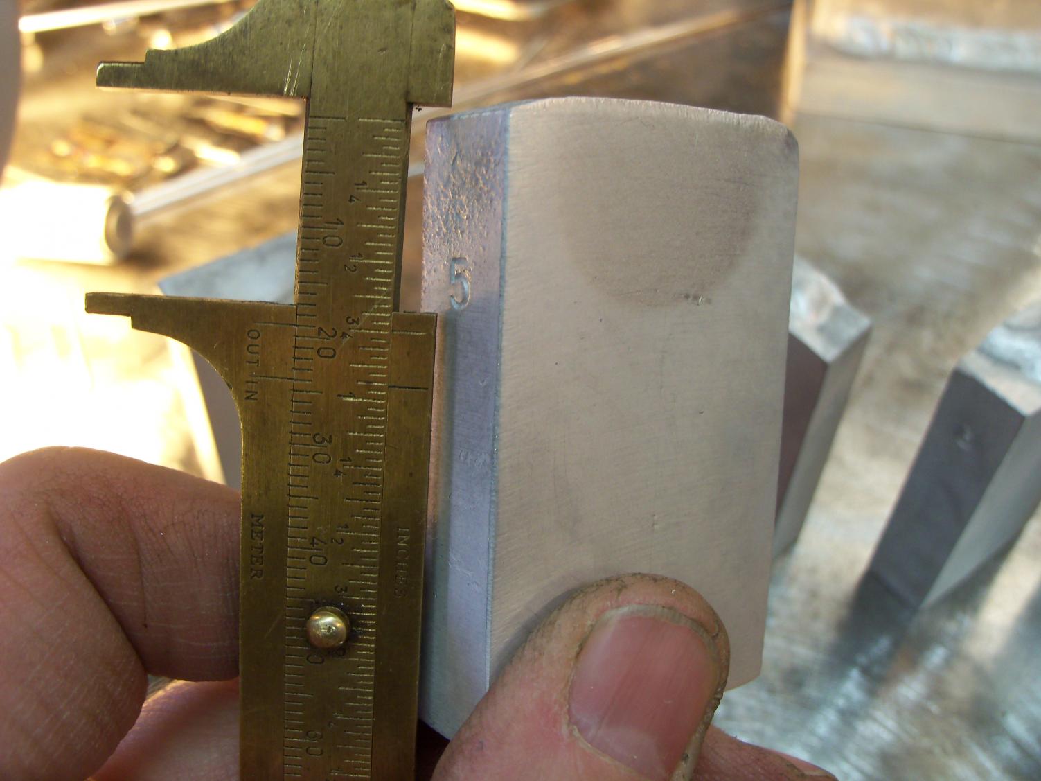

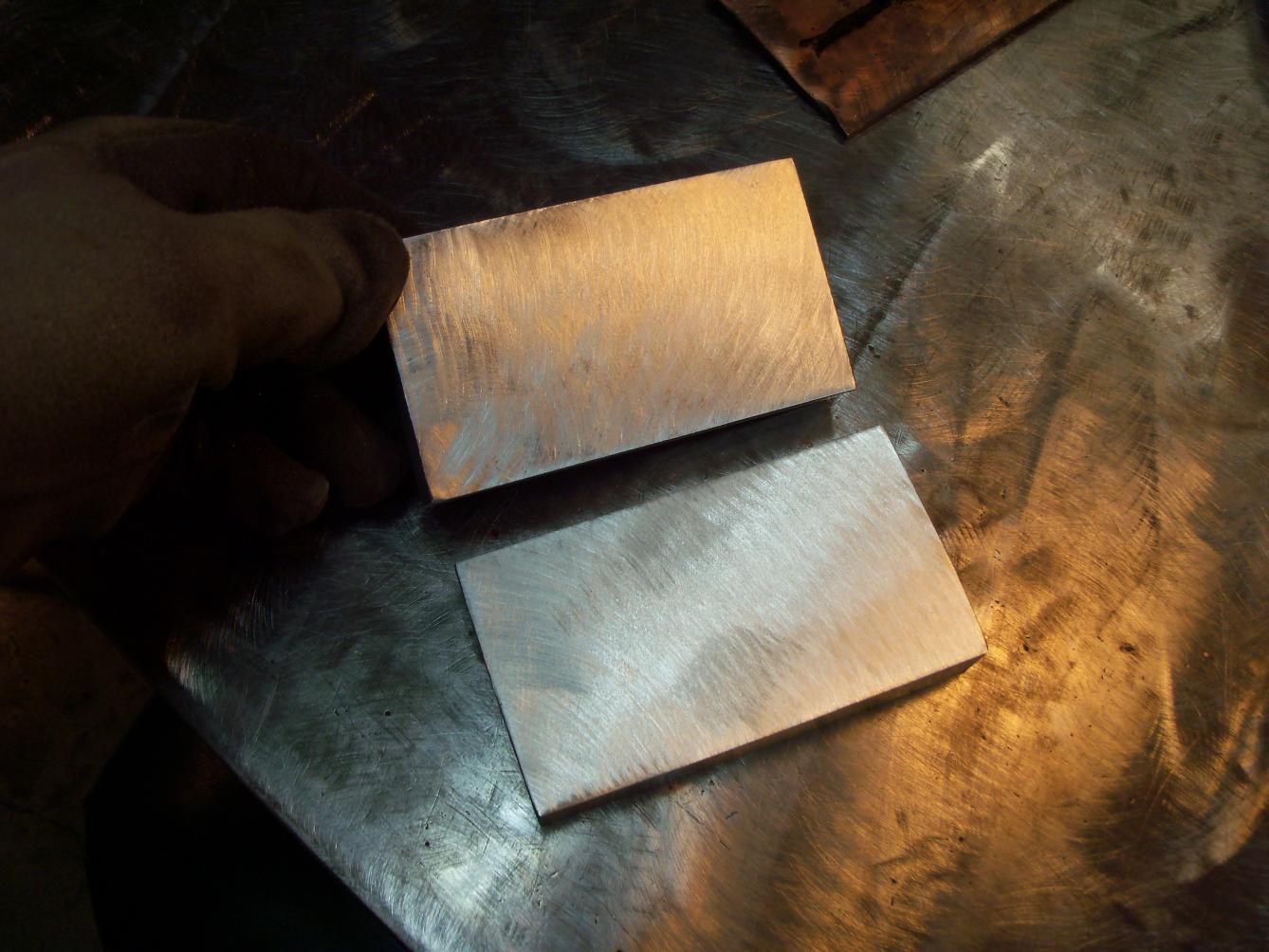

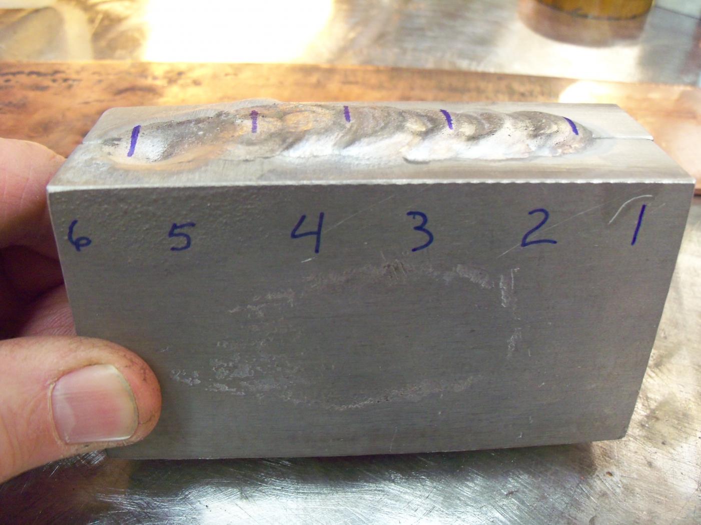

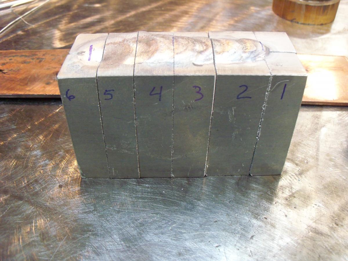

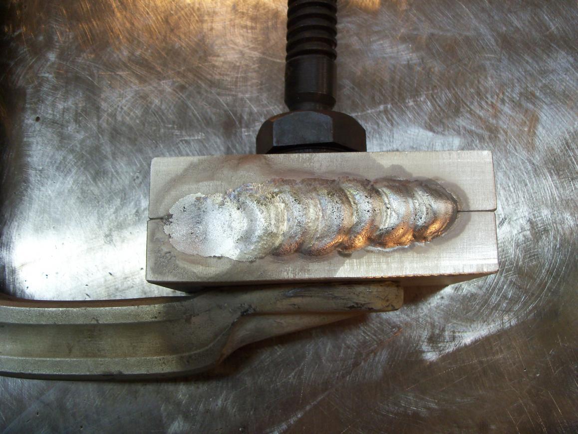

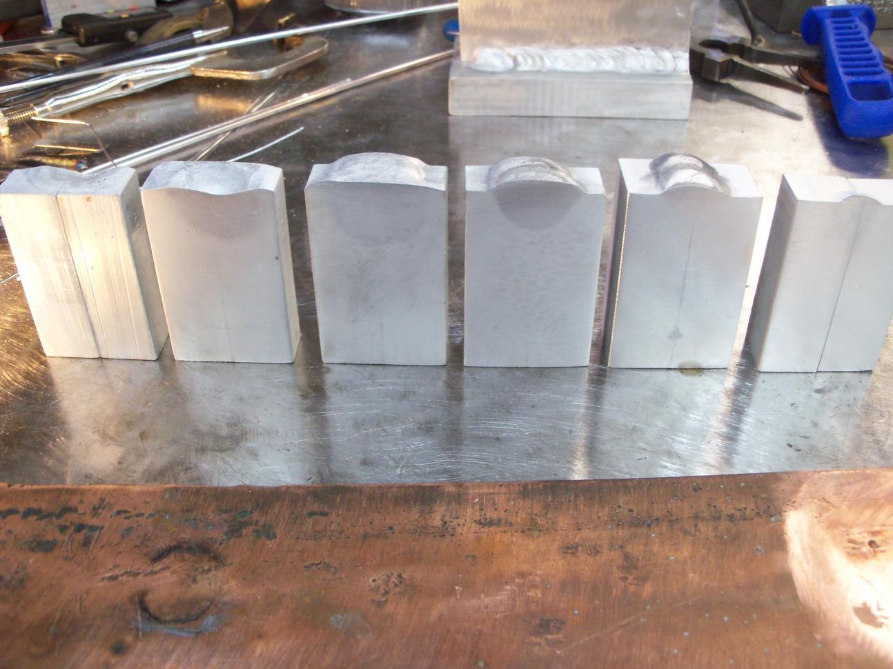

    Gentlemen, I trust you are all up for another "day hike" on our journey into the Unbelievable, so come along.
    As you will remember, I have been exploring the upper and outer limits of the 255 EXT's capabilities. But I have not yet found them. I thought this test would reveal them, but I actually got into a dangerous situation and had to abort the test without conclusive results. So, here is Part 1 of that latest exercise, I call "Deep Fusion".
ID:	11179Click image for larger version.
    More of the 3/4" 6061, cleaned and prepped, tape shown for scale.

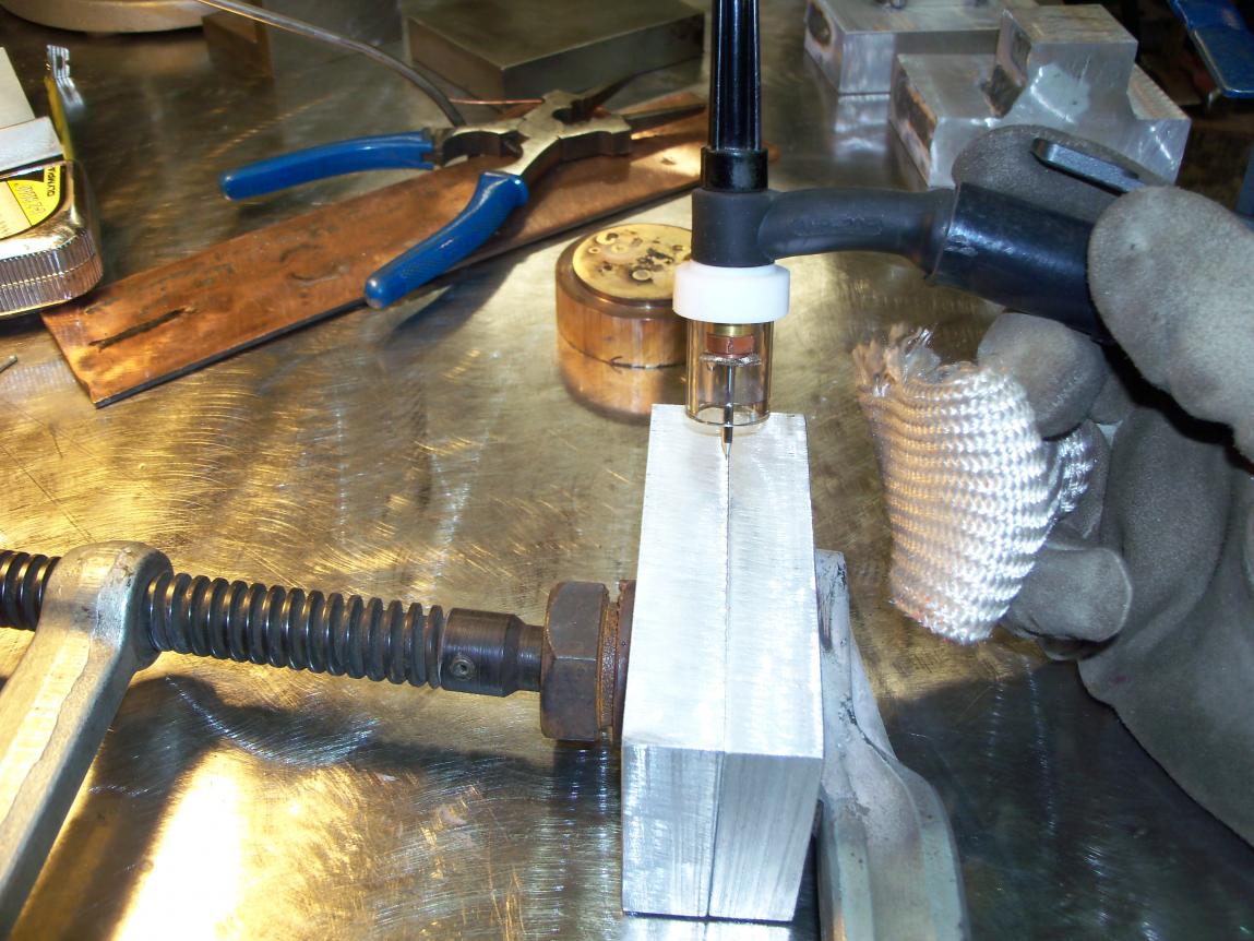

    CK Pyrex gas lens setup with sharpened 3/32" 2% Lanthanated tungsten. Argon at 20 CFH.

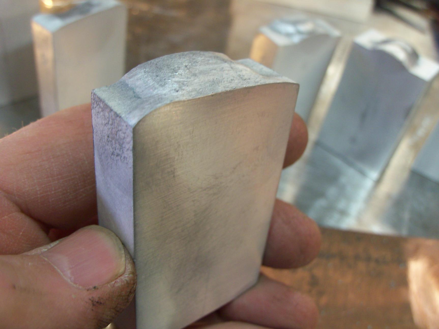

    This process gets Hot, goes Deep, and the reason I didn't crater out is because it went Sideways! TOWARD MY SIDE! I got off the pedal just before the puddle melted through the side walls! This generates a LOT of molten aluminum, and I punched out at the last split second. I don't yet see how this could be done other than in the flat position, surface tension will not keep a cubic inch of molten aluminum in place.

    There is much here to polish and etch, so we will look at all that in Part 2...

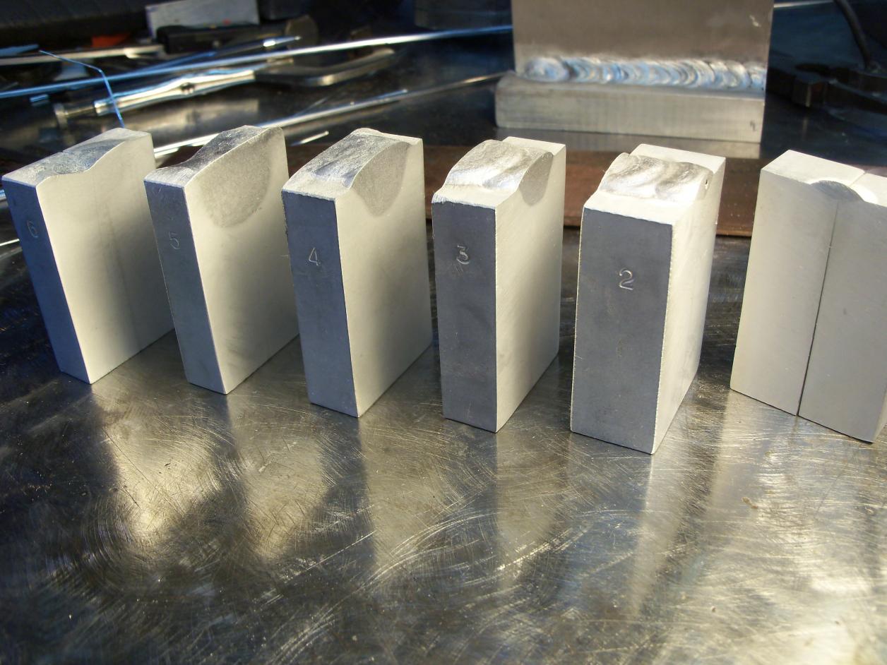

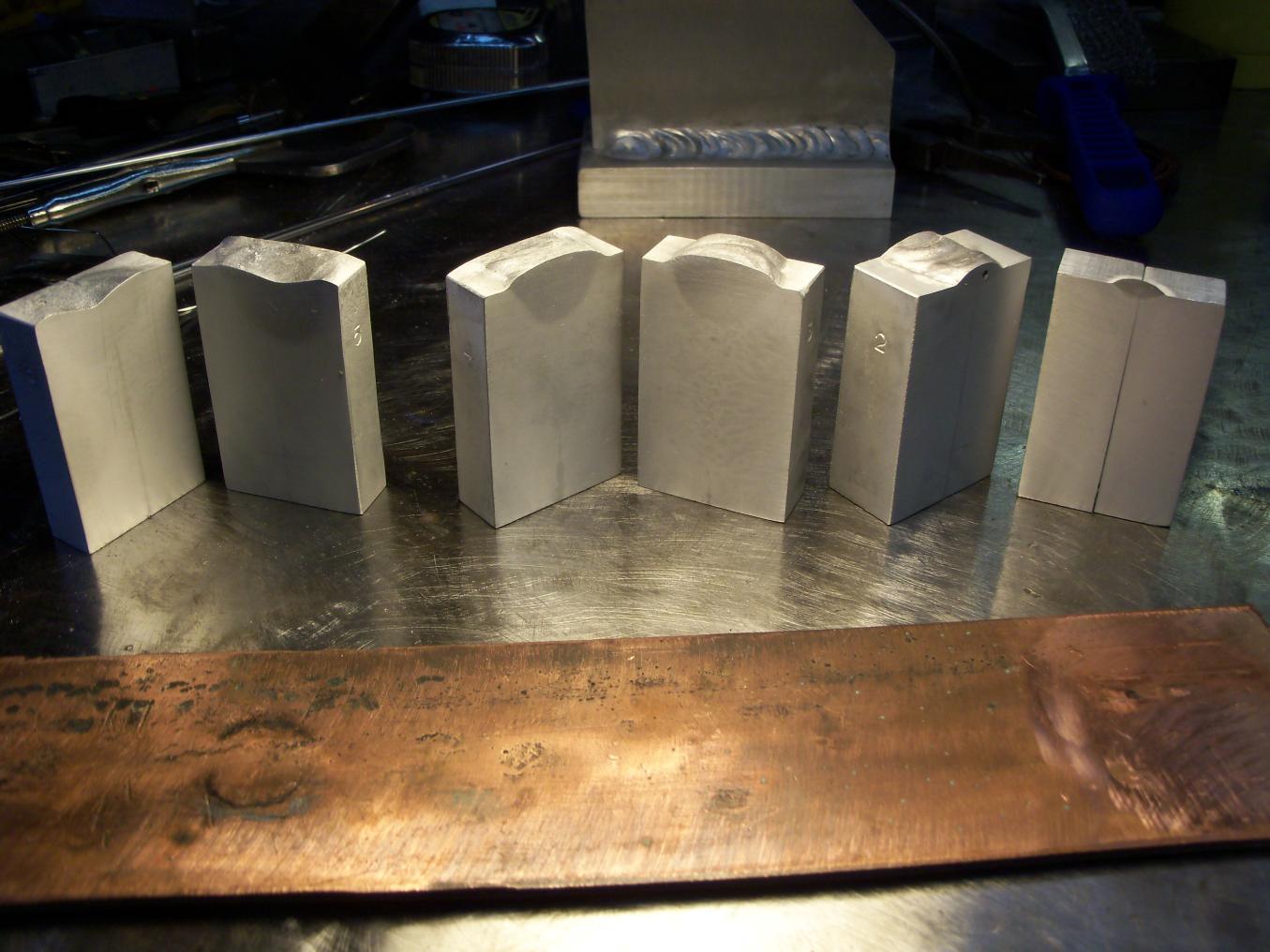

    Part 2 of "Deep Fusion"
    Alright, let's have a look.
    I preheated with a MAPP gas torch, started in Section #1 and moved to the left. Filler is 1/8" 4043.

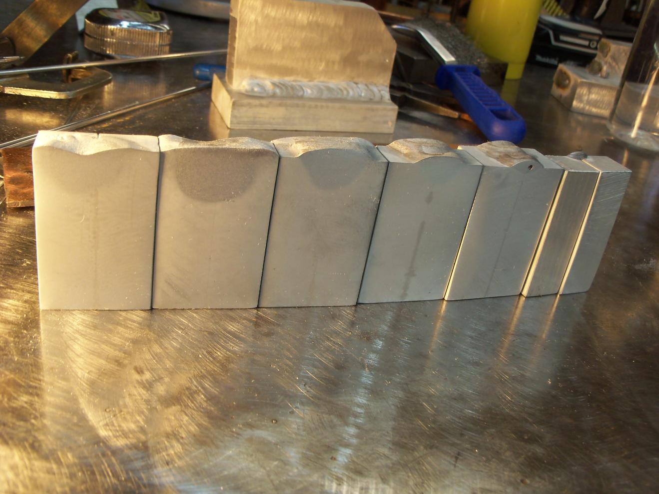

    Another perspective of both sides of the stack.

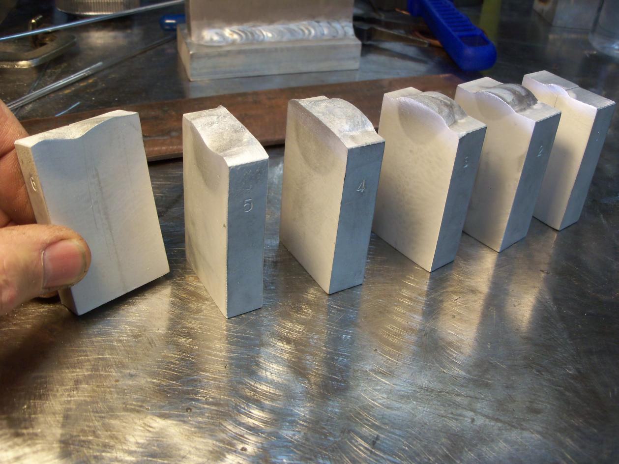

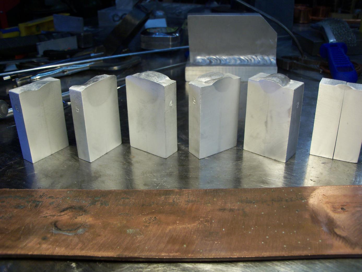

    These are paired to show the mating surfaces.

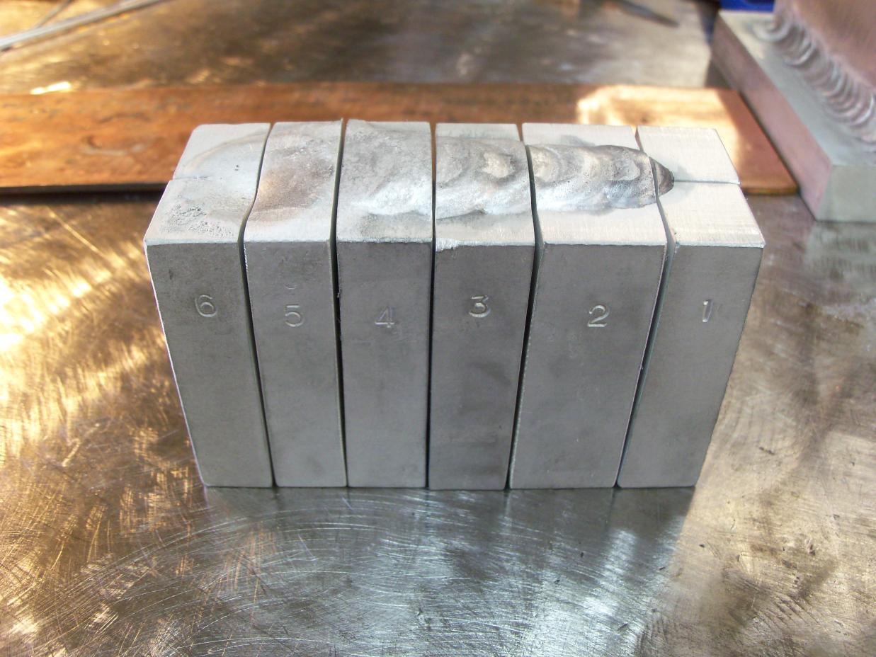

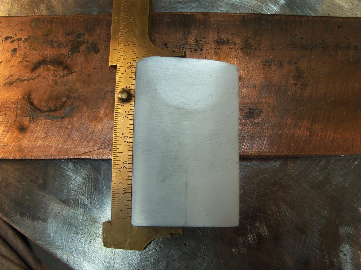

    These are of section #4 showing how wide the puddle got.

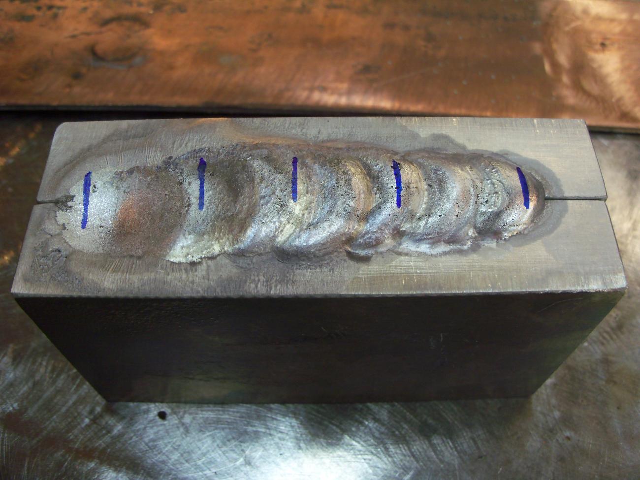

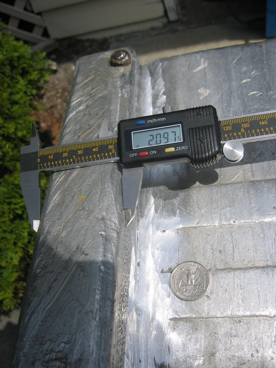

    Here is the deepest penetration achieved, just before I bailed out, about 0.680". Total weld time was about 2 minutes.
    So what IS the deepest we can go? This got pretty close, but as you can see, it was still going deeper when I stopped. So we don't quite know yet. I'm not sure when I'll be able to find out the true limits, as I need to get back the Real world and do some work!
    But, there is One More EXT test I plan to perform, so I'll be back with that before too long.

    Thank You, yes it was indeed a Grand molten puddle! These are really surprising discoveries. The "T" joint was a first try and so was this deep fusion. I'm just beginning to understand how this process behaves. How long it takes to go so deep, how to handle that amount of liquid metal, etc.
    So, here is what you need to try this at home or at work. You need an Everlast EXT-Class machine! Nothing else will do it because nothing else has 'The Feature'. The Feature is Advanced Pulse . This alternates from AC welding current to DCEN pulse current. This is only available in a Green box, and if you only need one reason to buy Green, This Is It!
    The other guys have Amplitude control, and that's nice, but is no way in this league of heat and penetration. My guess is that it would take their 700-class machine to do this in AC alone. What we get is the cleaning action of AC with the deep penetration of DCEN.
    I did think of three test to perform before I call this experiment complete. Another "T" joint, a 3/4' plate butt joint, and a 1/2" test plate with my 255 set to 210amps, to simulate a 210 EXT.
    So, stay tuned for a few more pix, keep thinking about how I set the welding parameters and post your guesses, and I'll be back real soon.

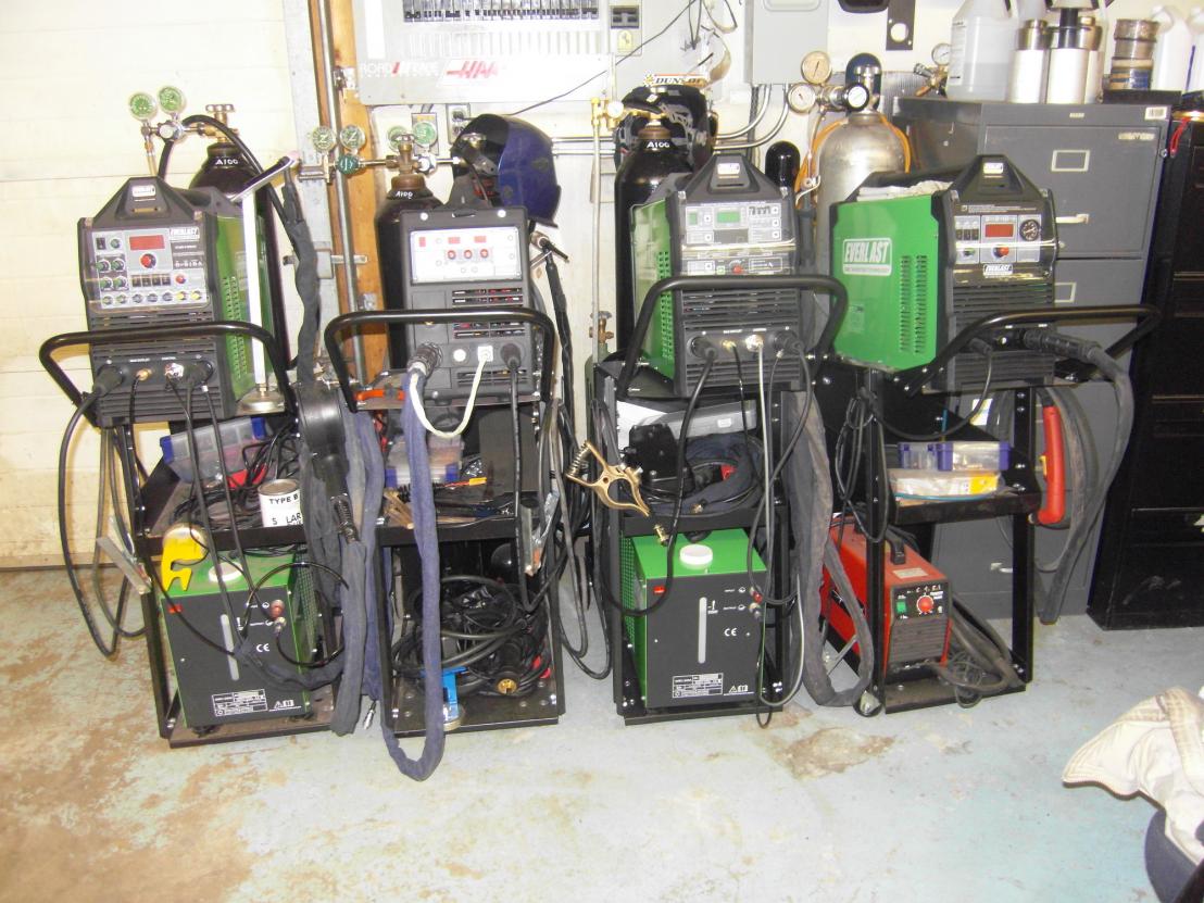

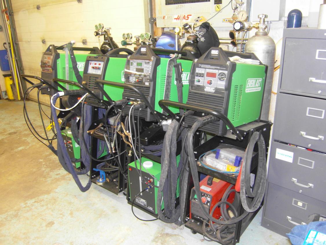

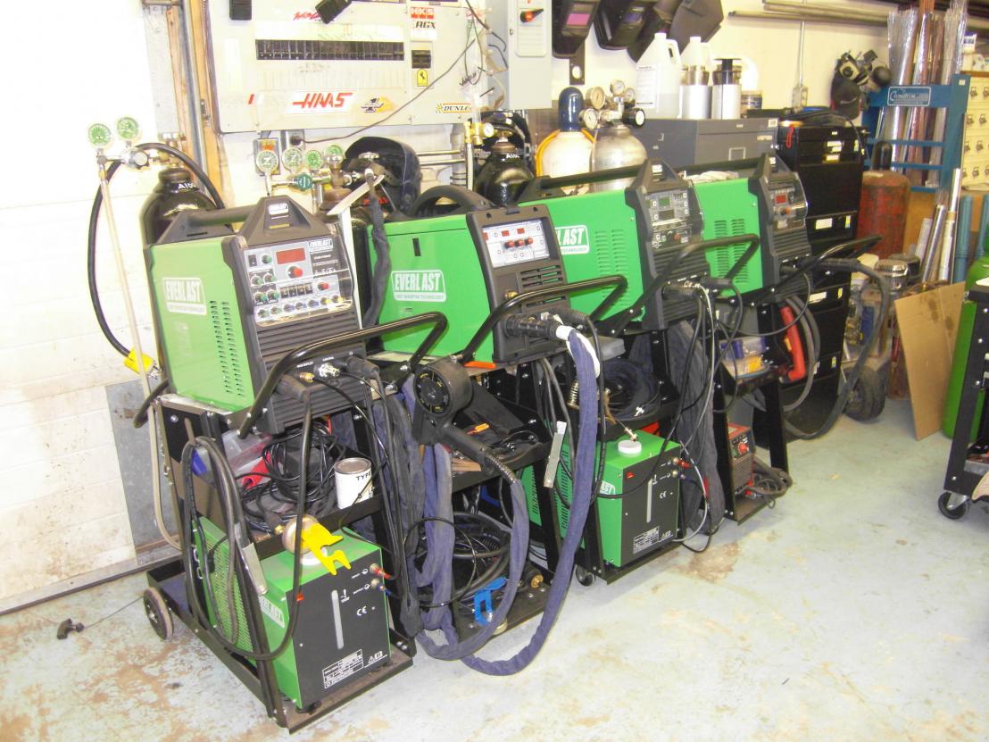

    Well I got one and still have the 250EX will keep testing both but the 255EXT is out front at the moment. The thing I like best of all so far is the save it and recall it just wish it had more memory numbers 1 to 9 is not enough.

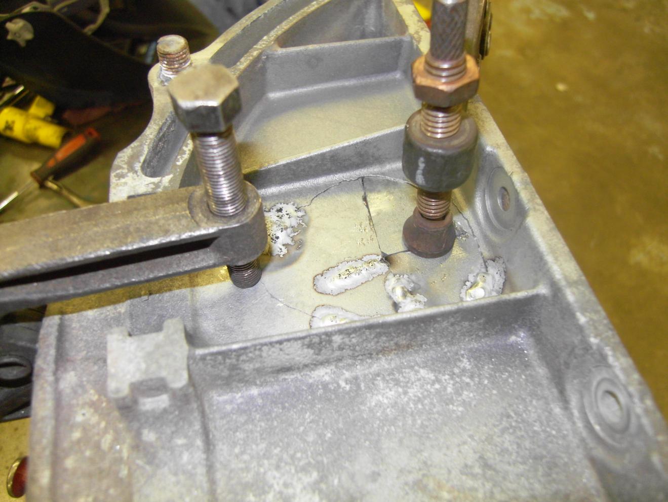

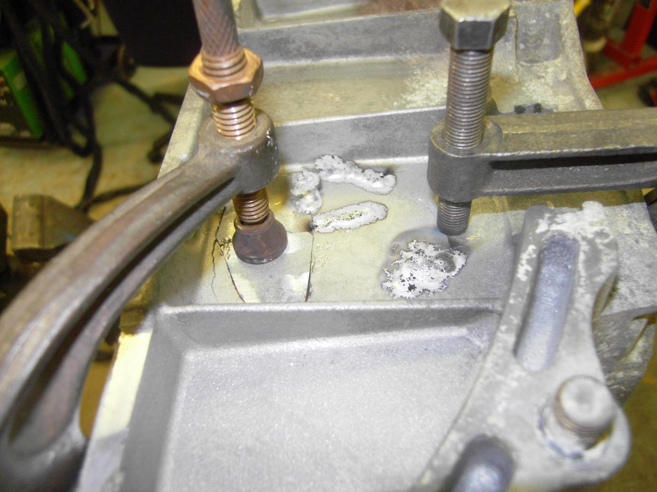

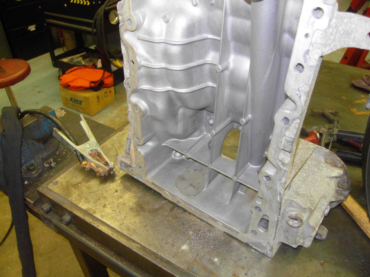

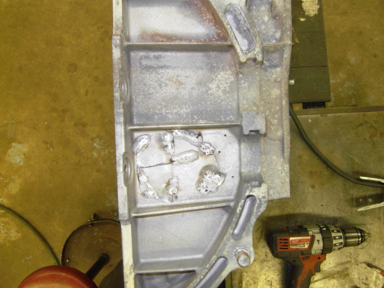

    Welded up some transmission cases with the 255EXT. The cases are very thin and keep cracking after welding so I just weld them to keep the pieces in place and the transmission shop uses Fel-Pro Aluminum epoxy to seal it up.
Name:	Trany case 1.jpg
ID:	11418Click image for larger version.
Name:	Trany case 2.jpg
ID:	11420Click image for larger version.
Name:	Trany case 3.jpg
ID:	11421Click image for larger version.
Name:	Trany case 4.jpg
ID:	11422Click image for larger version.
Name:	Trany case 5.jpg
