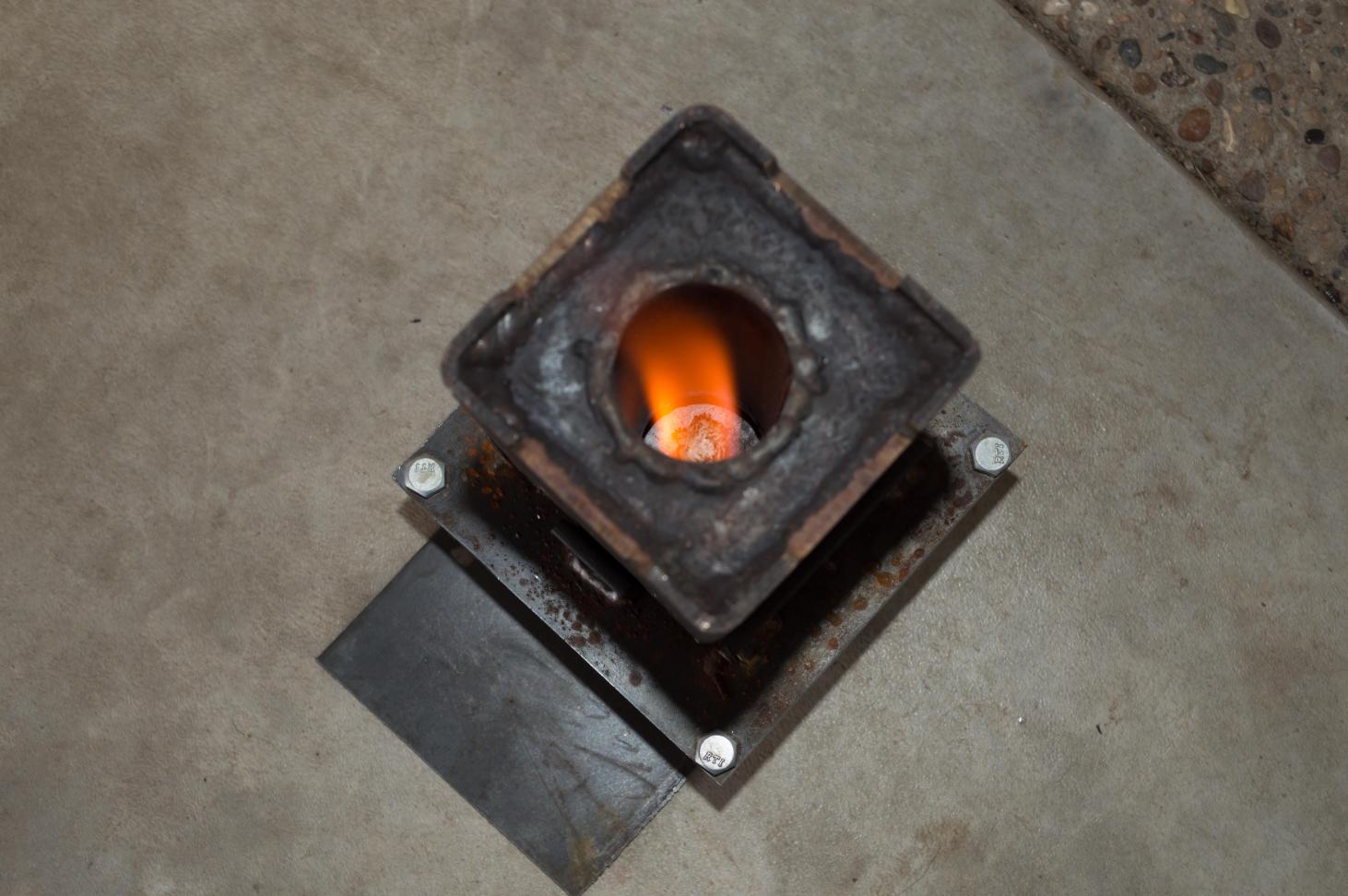

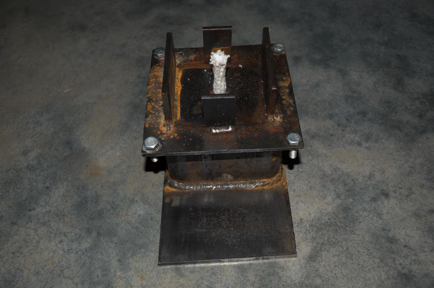

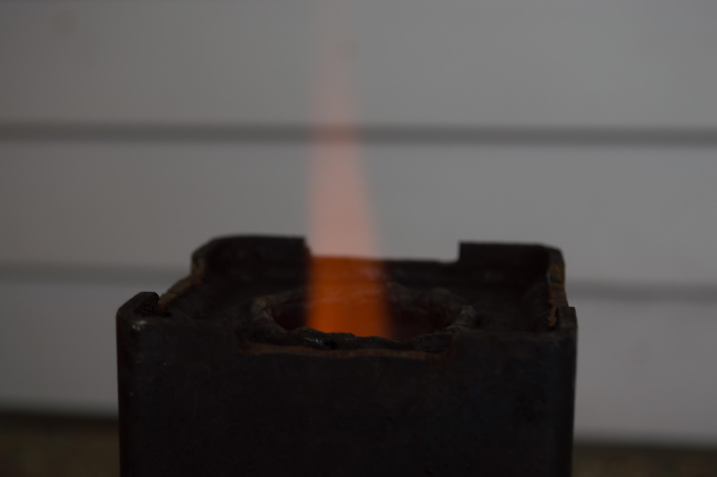

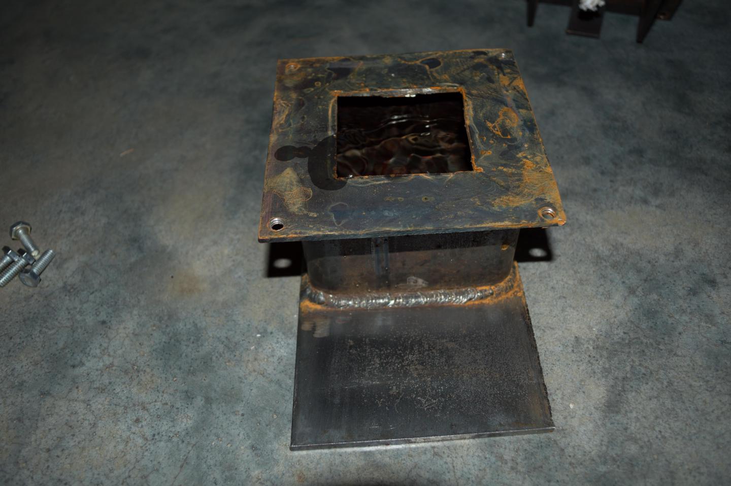

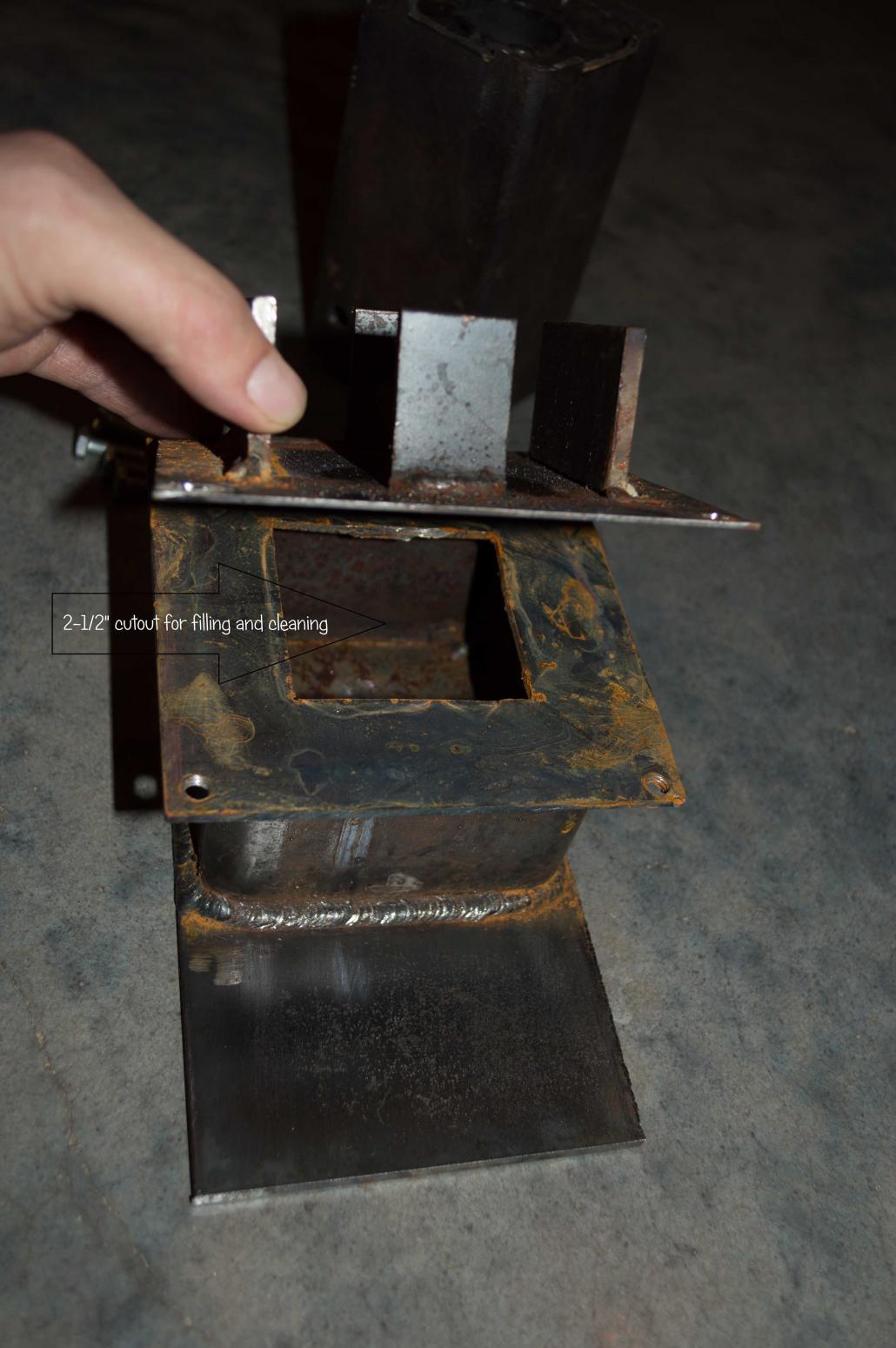

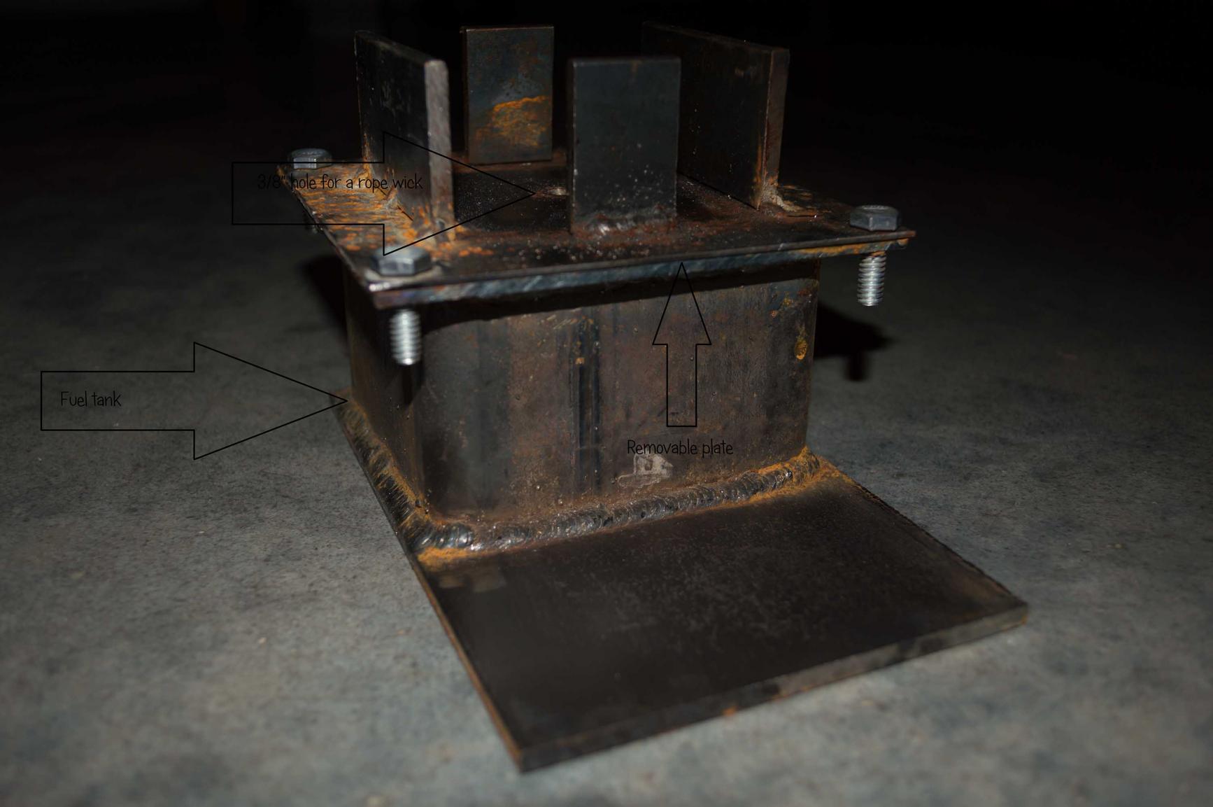

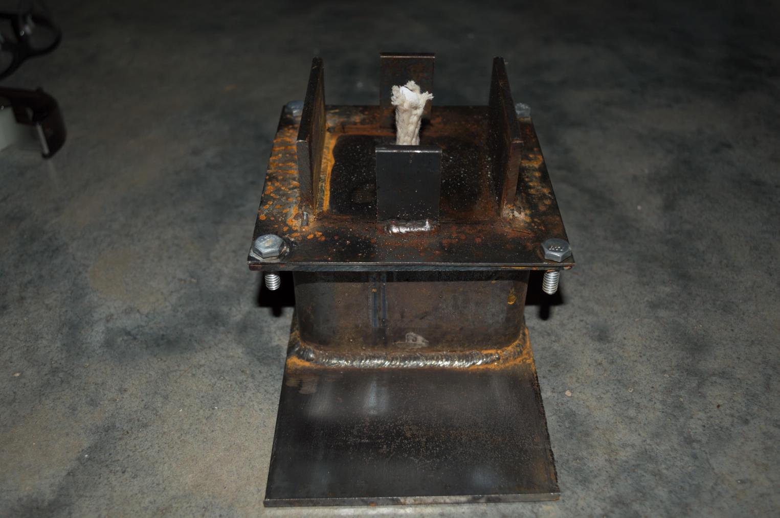

    This will boil a 1qt pan of water with a 1/4" poly rope (I just used poly to test). I have 3/8" cotton rope on the way.
    I'll post more pictures once I get it going good with the 3/8" rope.
    I run it on Methanol, but just about any liquid fuel can be used (I wouldn't recommend Gasoline).

    Interesting build, please do post pictures in operation. Does this *require* a 3/8 cotton rope wick? Could you roll a cotton t-shirt/rag into a tight cylinder instead?

    Sure - just make sure it is 100% cotton. I ordered some ordinary cotton rope from Amazon for about $8.75; I hope it gets here today.

    Haven't tried beer cans as I don't drink beer, but I have tried very similar concepts. The beer can type burners don't like wind; whereas, my contraption will still work in 15 mph+ wind, as I tried it yesterday. Also, mine is a lot easier to get started since it's just a "wick" saturated with fuel.
    It took me a couple days to think this out completely and then three part days, over two weekends, to get it finished.
    I'll get more pictures up and maybe even a video once I get the rope.

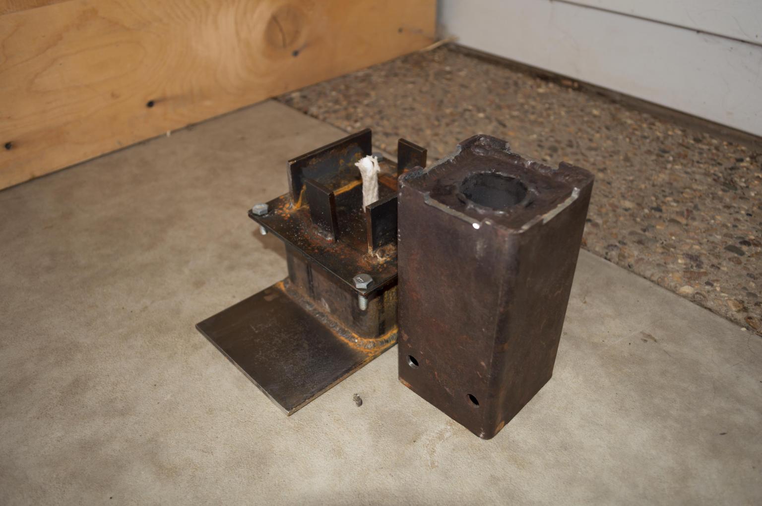

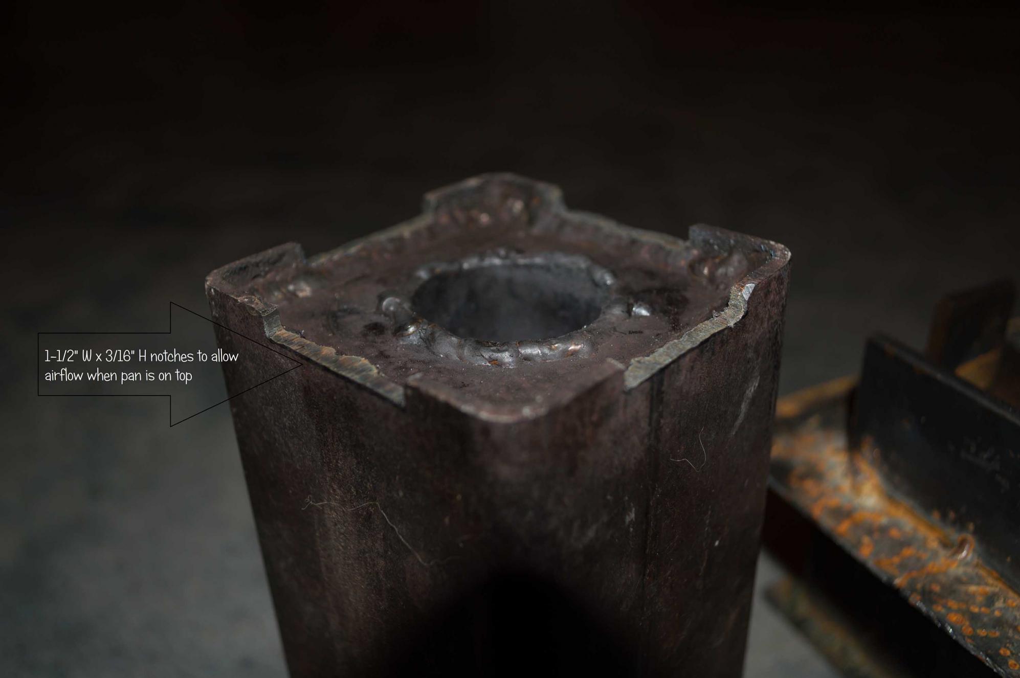

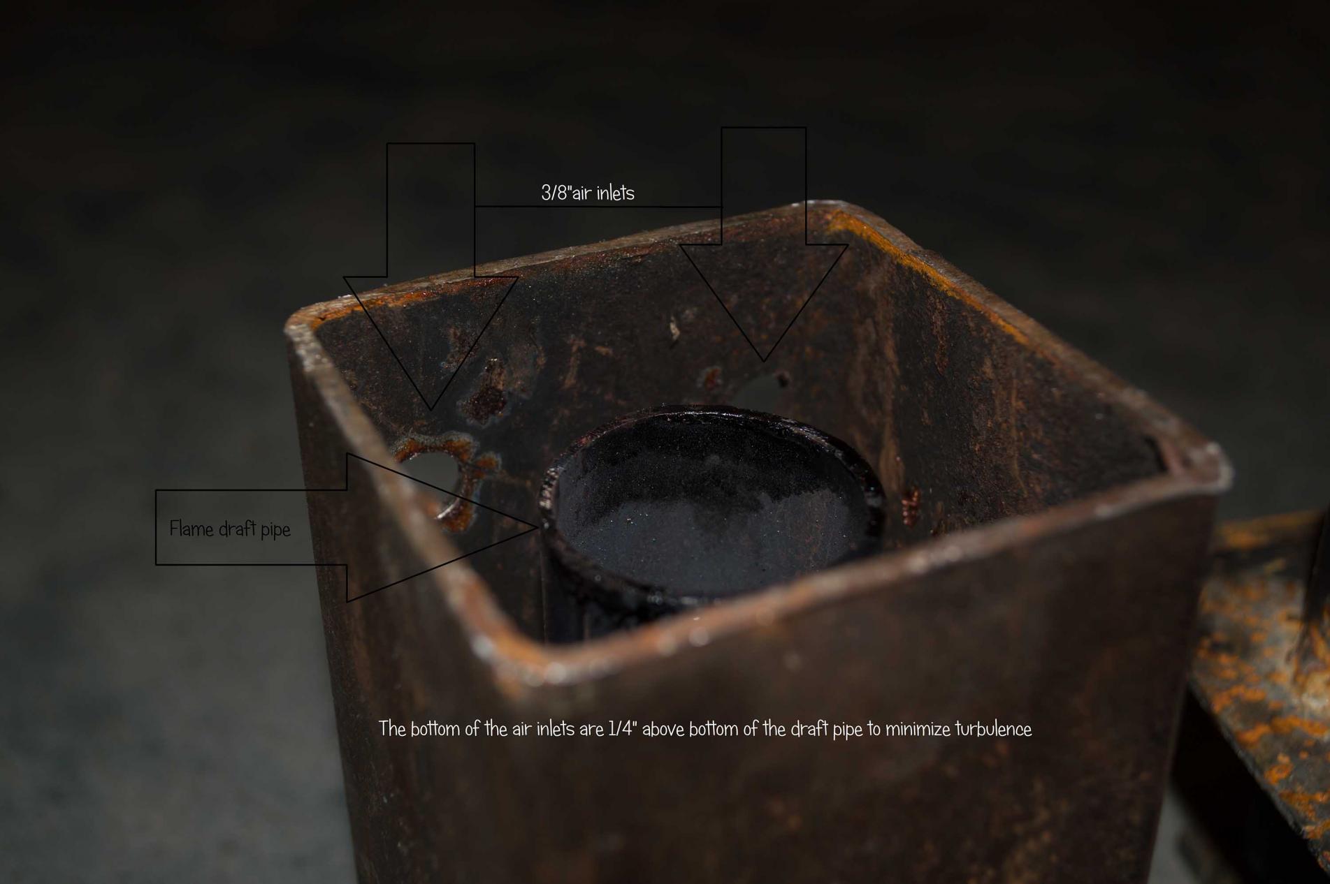

    Default More pictures as promised...

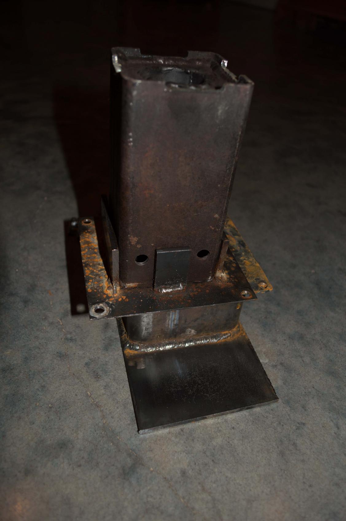

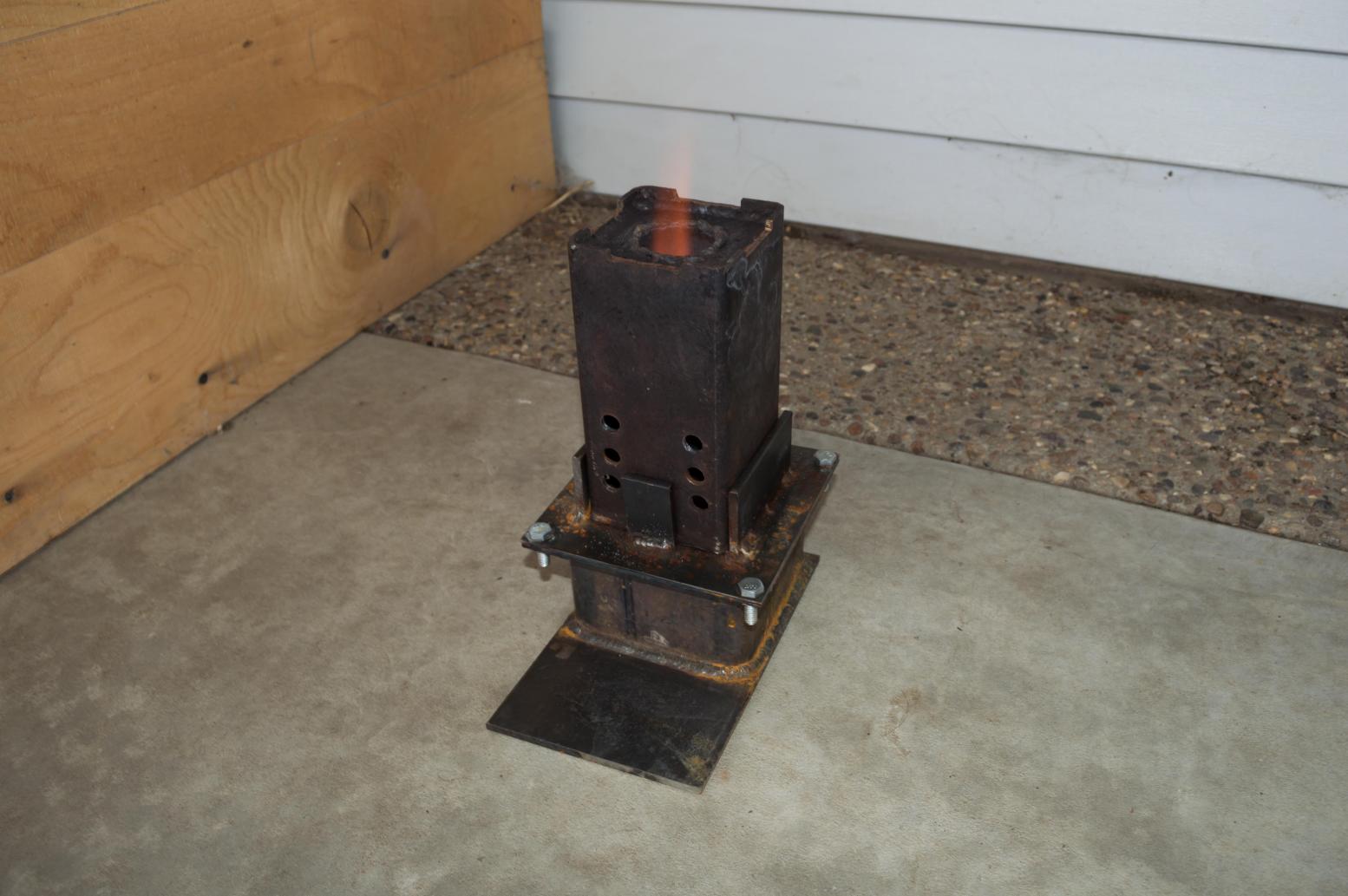

    Hey guys,
    I finally got that 3/8" cotton rope that I was waiting on.
    I have the "wick" sticking out about 1-1/4"
    I also added 4 more 3/8" air inlet holes to allow enough air to burn clean.

    My Youtube video is currently uploading (41%) as of 4:25 CDT
    http://www.youtube.com/watch?v=V2ZFz...ature=youtu.be
