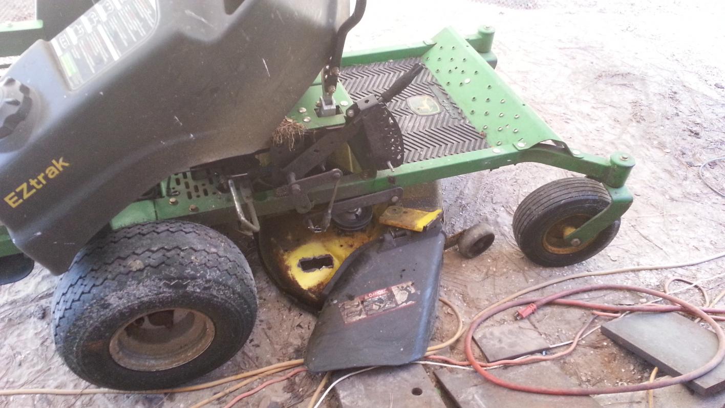

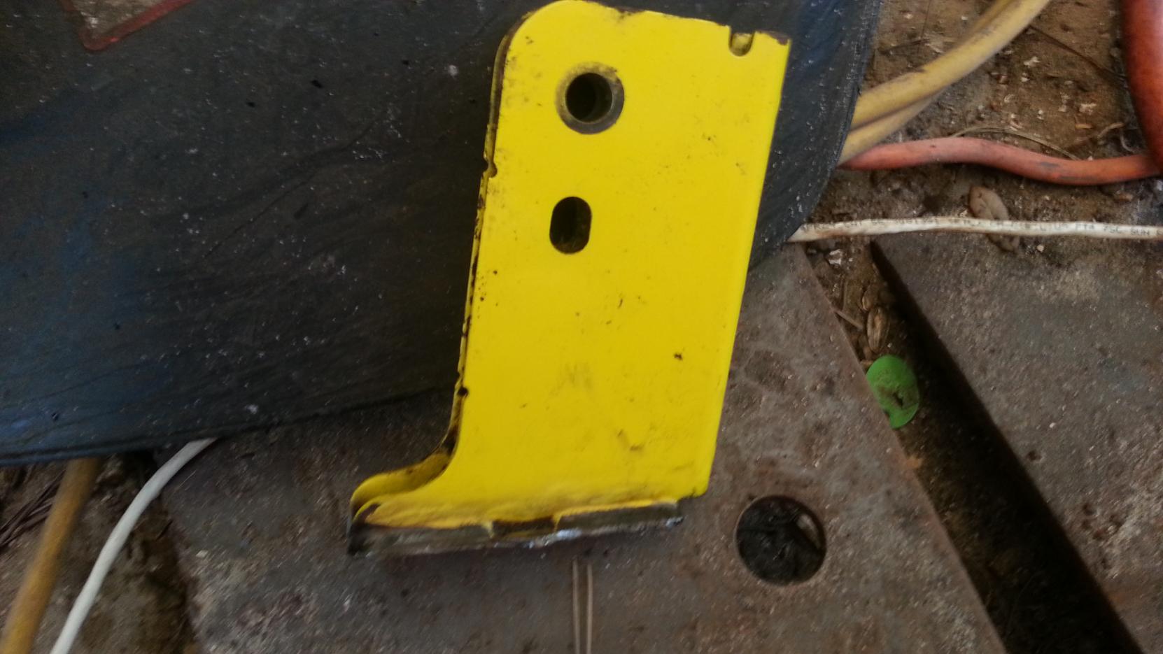

    Did a repair on a John Deere the guy swears he did not hit anything. Hope pictures came out OK.
    Start removing parts.
Name:	2013-09-27 11.36.47.jpg

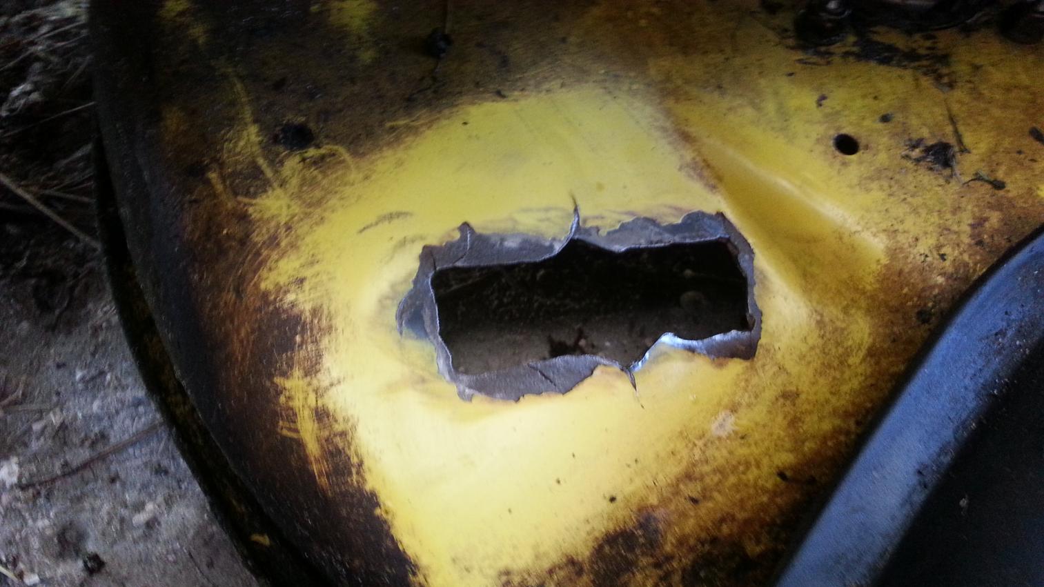

    Grind out hole. There was no rust.
Name:	2013-09-27 11.36.38.jpg

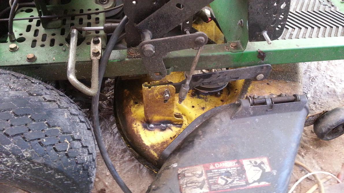

    Tack and square up.
Name:	2013-09-27 11.52.11.jpg

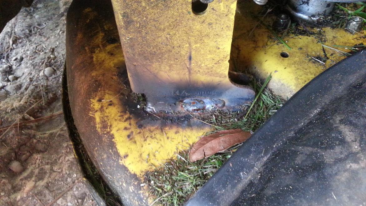

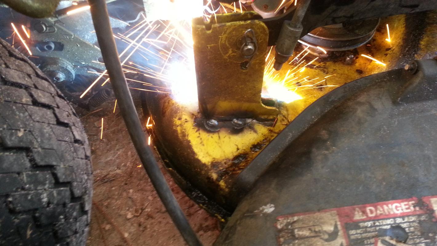

    Weld. You can see the tear
    in the metal. He must have hit
    something. Cash is cash no matter.
Name:	2013-09-27 11.36.55.jpg

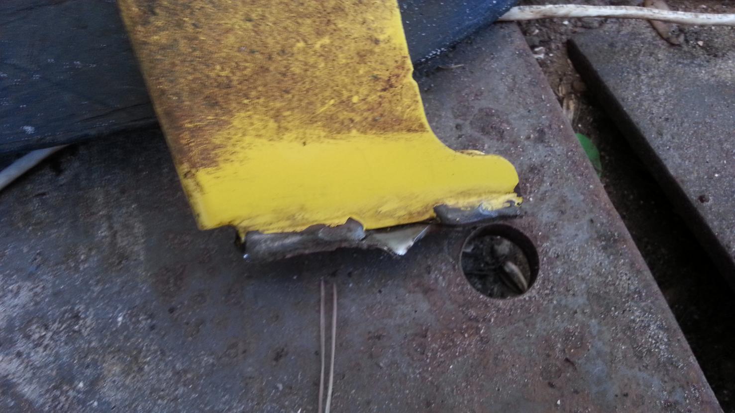

    I went over tear and did the back.
Name:	2013-09-27 11.55.09.jpg
ID:	10997Click image for larger version.
Name:	2013-09-27 12.21.20.jpg
Name:	2013-09-27 11.37.02.jpg
    Everlast IMIG-200
    Dad's TIG and plasma
    Lots of tools
    Not lots of space.
    I didn't hit anything and I wash this thing after every use...
    yeah..Right,,,and don't forget about those promises to change the oil in that poor machine..
    Those tires aren't OEM, and the pitting on the top side of the mower deck next to the discharge guard, and the thin/thick sections around the metal and the anti scalp wheels say that that unit is at least 3 years old if used daily, rode hard and put up wet. I've got a 7 year old JD mower with less wear and it's been used to cut a lot of grass.
