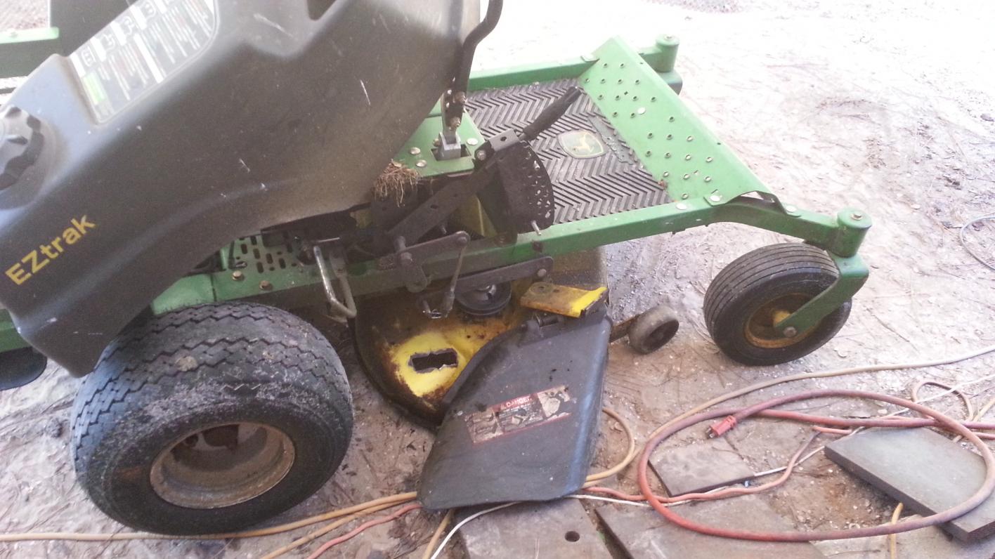

    Did a repair on a John Deere the guy swears he did not hit anything. Hope pictures came out OK.
    Start removing parts.
Name:	2013-09-27 11.36.47.jpg
    Grind out hole. There was no rust.
Name:	2013-09-27 11.36.38.jpg
    Tack and square up.
Name:	2013-09-27 11.52.11.jpg
    Weld. You can see the tear
    in the metal. He must have hit
    something. Cash is cash no matter.
Name:	2013-09-27 11.36.55.jpg
    I went over tear and did the back.
Name:	2013-09-27 11.55.09.jpg
ID:	10997Click image for larger version.
Name:	2013-09-27 12.21.20.jpg
Name:	2013-09-27 11.37.02.jpg
