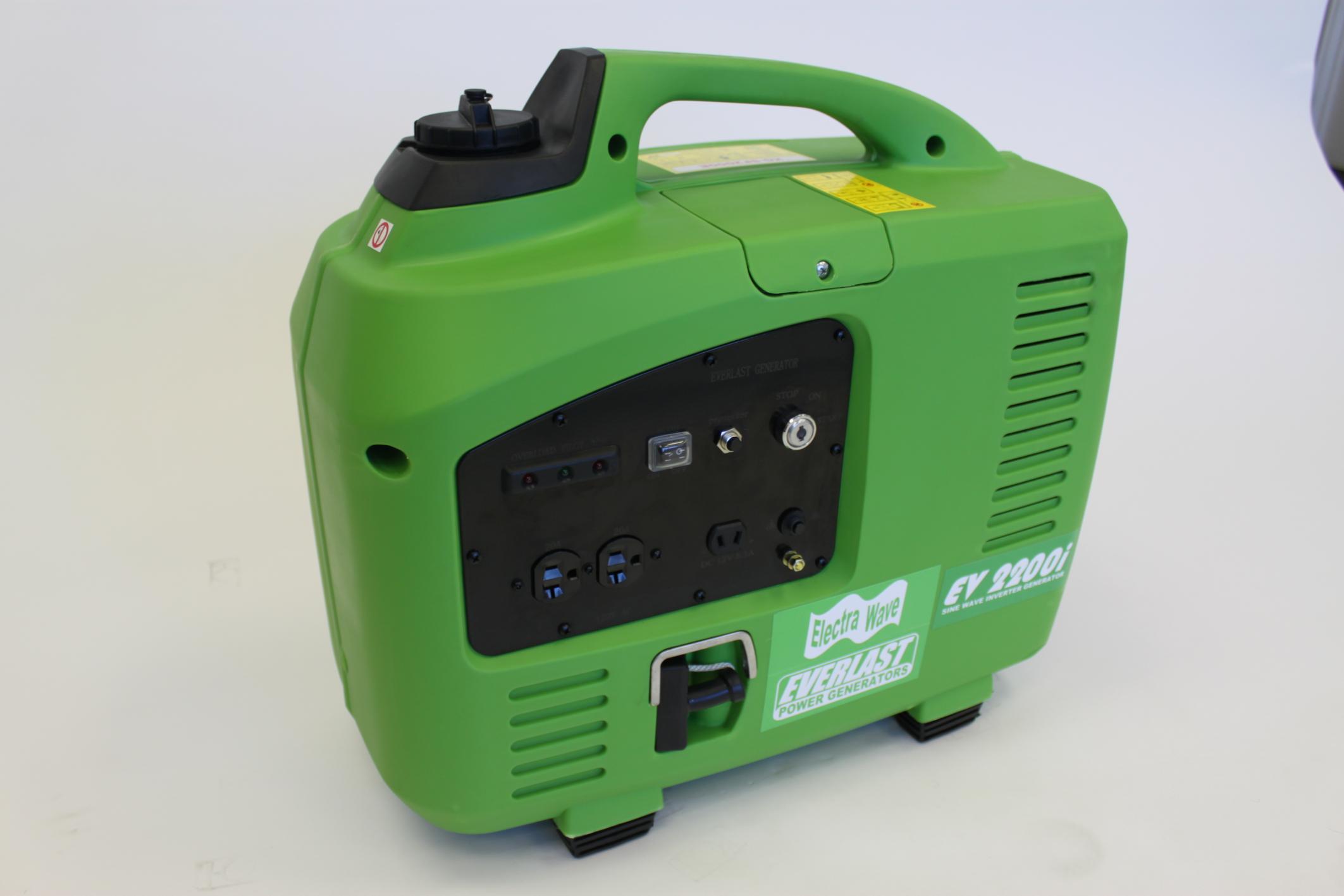

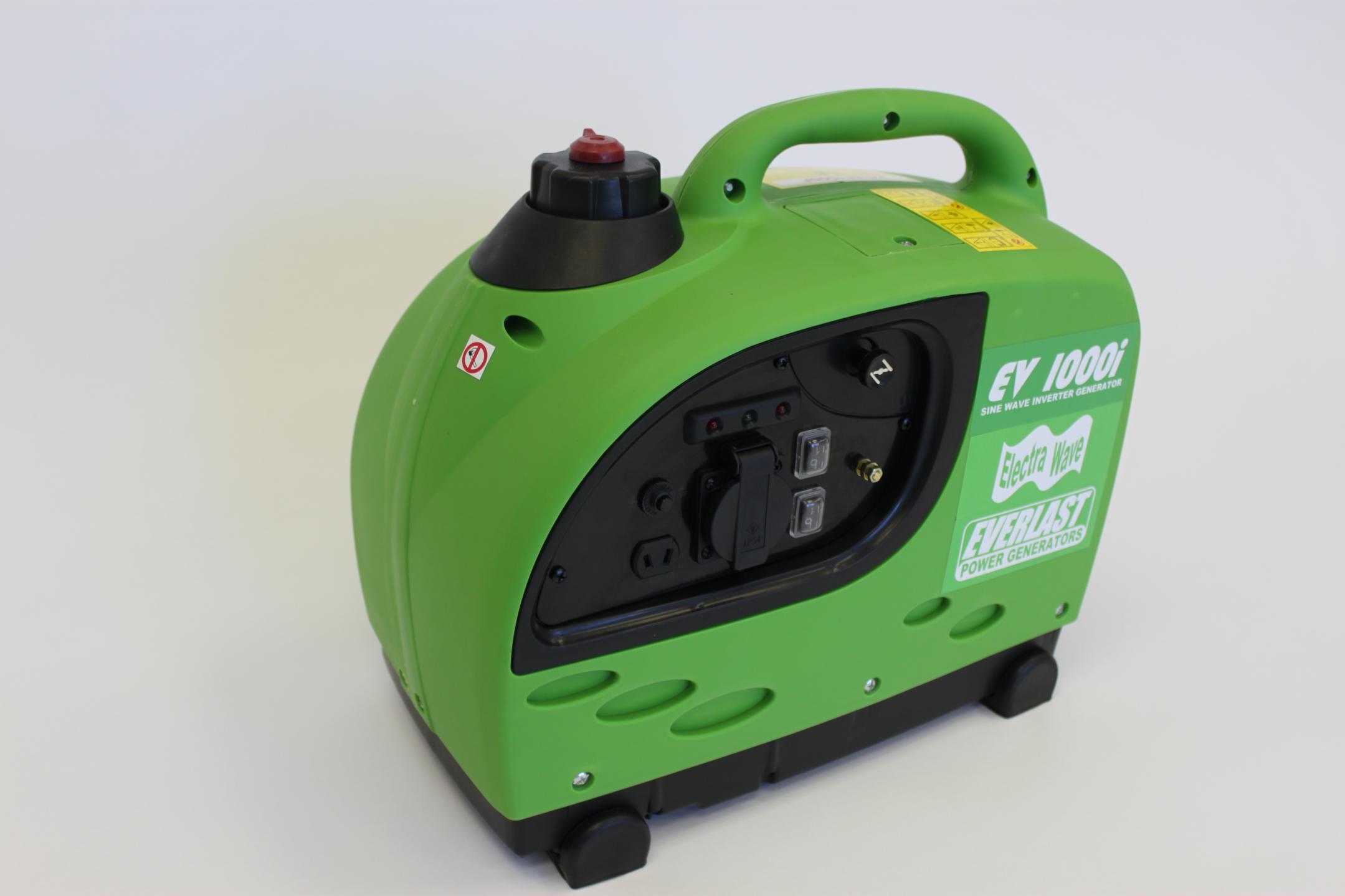

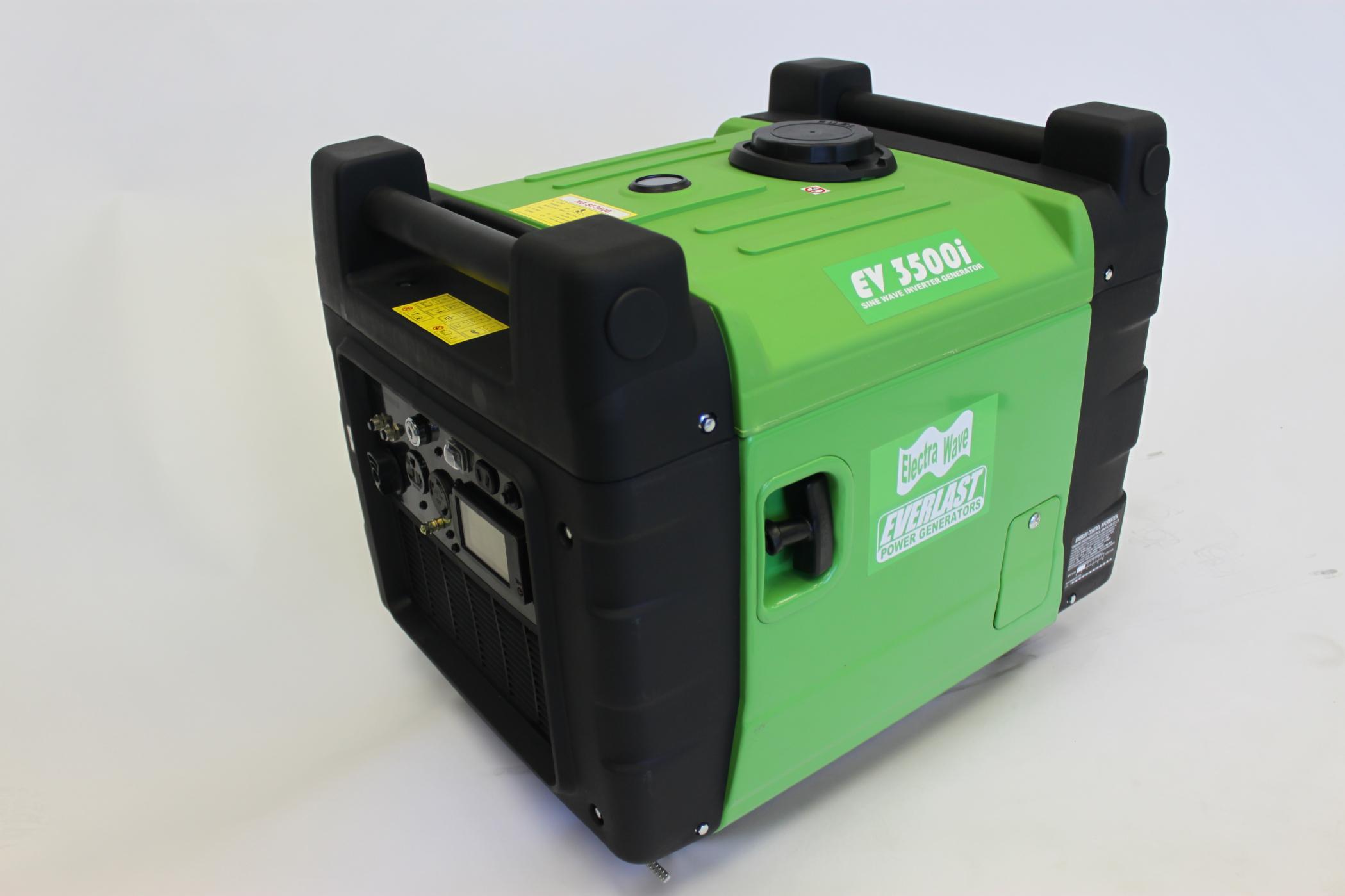

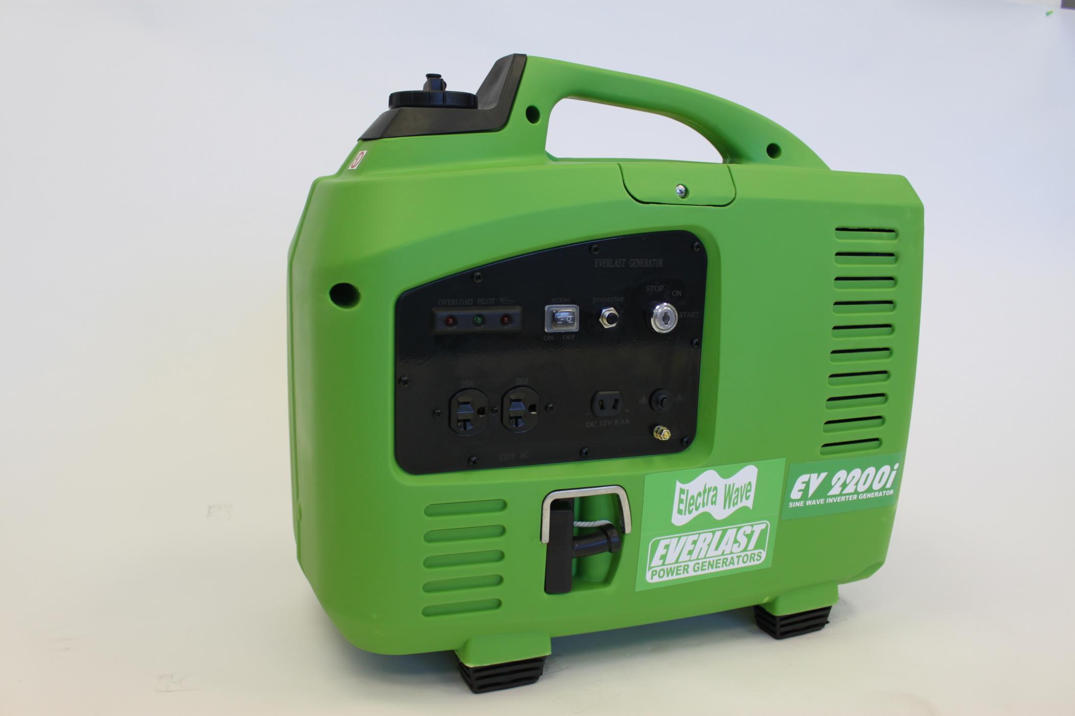

    Yes, they are our new Electro-wave inverters. Ours are available from 1000 to 3600 watts. We'll still have our 6500 diesel quiet (but dirty power) genset. On sale now on Ebay.

    Is it a real 2200Watts or is that the peak and 2000w the running power?

    On most it is peak. The 3500 is 3600 peak I think. Let me see if I can find info. Be back shortly.
    Any chance of including the 5600 version as well?
    I'm not sure what I am going to go with for the trailer, but always good to have lots of options.
    The 1000 info says 900 watts rated...I believe this is continuous.
    The 2200 info says 2000 watts rated
    The 2800 says 2600 watts rated
    The 3500 says 3000 watts rated.

    The 2200 watt to 3600 watt have the Econo mode which drops the idle and noise level right down . You can switch this over to high output or just leave it and if the power requirement exceeds the Economy mode it will automatically jump in to full output. The 3600 model has no priming or choke setting as just flip the switch. The reason it has no remote start at this time was because we chose to add a LED. Screen giving info such as how many hours what the power output is being used for what electrical appliance oil reading power warning etc.
