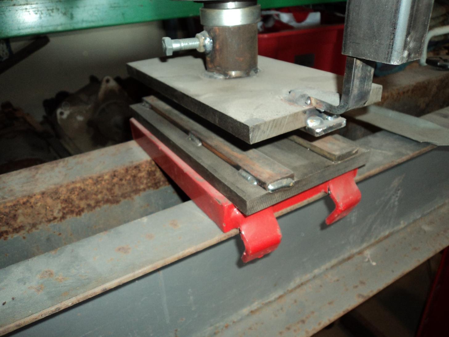

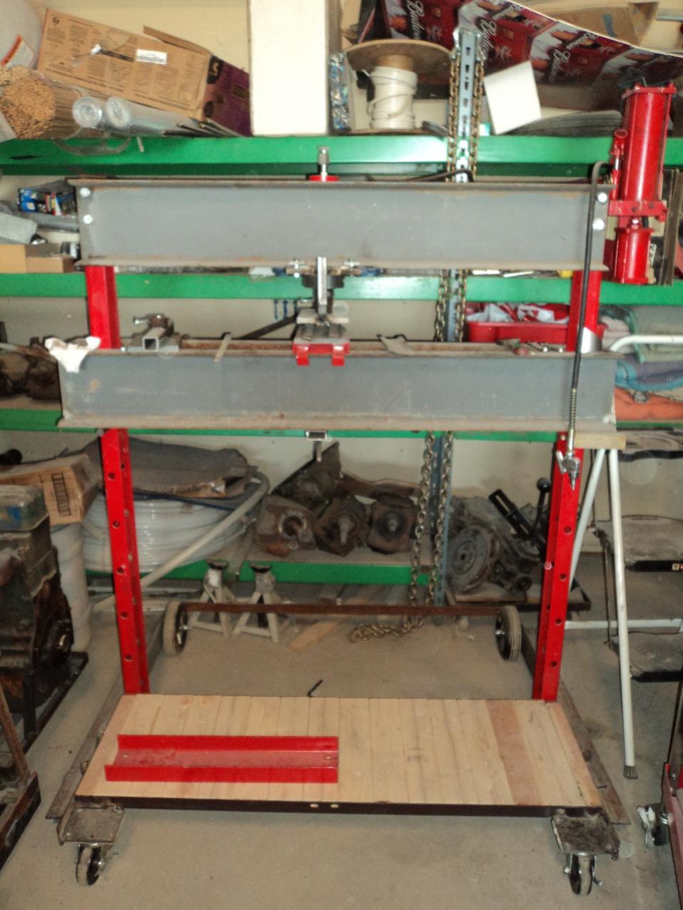

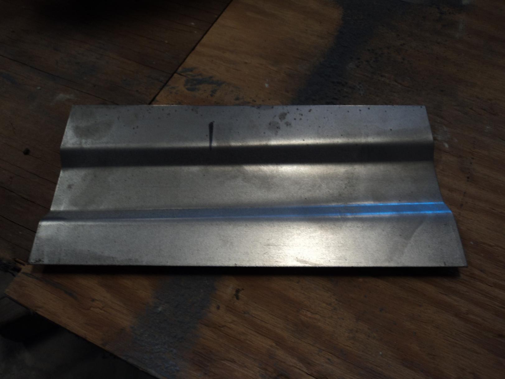

    Needed more room in my press for making floor pans ect. had a new 30 ton air over hydraulic press 20" between the uprights. Used some 8" 13.75 structural channel. New inside width 48" this will let you stamp in floor pan channels across a sheet. I can now work a 30" square sheet and channels it across the sheet. I made a couple of dies to stamp in the channels and some flat dies for crimping and folding edges.Used the 200 DX in stick mode for the new 8" channels and the mig for die building.

    I was surprised to see that the side rails are pretty much the same as my little 12 ton press,,thought they would be more robust,,,,your cross rails seem plenty strong..
    Very cool setup! That hat channel looks professionally stamped. I've been kicking around the same idea about doing some stamping, but I need some dash contours and gauge holes stamped out with rolled edges and the combination die for that project wouldn't be easy to build. Besides I still need a press and I have no floor space. Does your press flex a lot resting on those casters (as opposed to sitting flat on the floor)?
    It's not much different on the sides mostly the cross members that are taking the load, 30 ton starts to move those 8" channels when you bottom out that little channel die. I am trying to find an old set of press brake dies to cut down and make it possible to bend 48" up to 16 ga. I have a small dual groove bottom die that will let you bend a 3/8" lip on a sheet but it is only 36" long. I miss my old brakes and shear 12' 1/4" shear and 12' 1/4 press brake in steel , had a 75 ton DK press brake with a flat table on the bottom to take uni punch frames with different dies in them and a bunch of small forming dies to stamp out parts in one step.

    Nice setup. Do you have the ram mounted on a slider, similar to the red base plate?
    Yes it slides left or right to get in the position you need to. I have it setup with bolts to loosen and tighten in the needed position. The bottom die also tightens down.
    That's a great design feature. It's probably easier to align the ram to the part than vice versa, especially with big, asymmetric control arms or other odd shapes. I'd like to mod a 20ton this way.
    That is pretty neat. You could tack in some round bar on some dies as well to make radi in the corners or even a corrugated sheet.
    That makes it so much easier to form sheet material that you're dedicating to one side of your project or the other. Even if you follow the correct sequence when forming your project, you can hit a "brick wall" on the last brake when the ram is stationary.
    That idea works really well. I use to have to form bull nose countertops from sheet metal at work and we didn't have enough of the factory produced dies for the brake, so we modified some leftover dies using rod. Depending on how you space your braking points, you can still achieve a gentle curve using a die with a tighter radius by "bumping" the material.
    I used to have a full set of dies made to fab all the lower door parts for the old 73-79 chevy pickups, Floor pan dies also , the upper dies were made from 1/2" cold rolled round.
