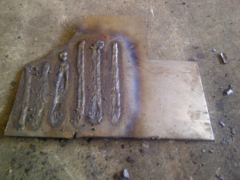

    Thanks, that is helpful. I'll follow that guide and try both AC & DC for comparison and post some pics of the results (please be kind!). Should polarity make a difference if both DC + & - are listed?

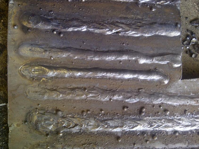

    Well, I gave it a try today and it was actually kind of fun. I'm not proud of these, but I said I would post...

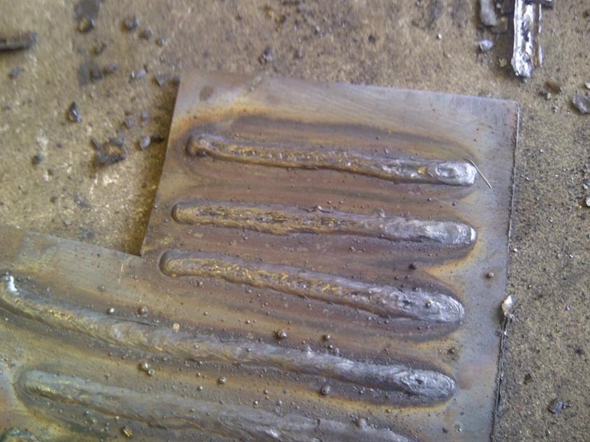

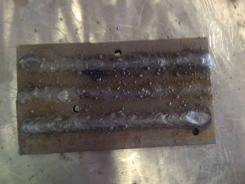

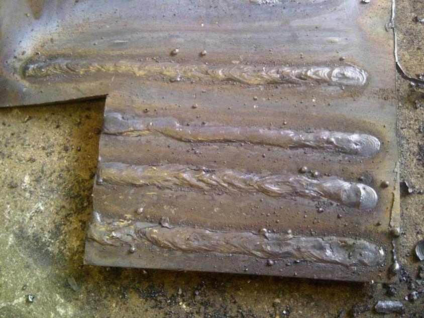

    First 3 were at 110a AC, next were 110a DC-, on 1/8" scrap plate. I quickly realized that welding toward myself was making it very tough to control the arc height, let alone see it well, so I changed to a left-to-right drag and the bead consistency improved. I switched back to AC for the last 3.
ID:	10875 Click image for larger version.
    Technique must be key to quality since (other than amps) all setting adjustments are made with the hand. This is a learned skill, I hope!

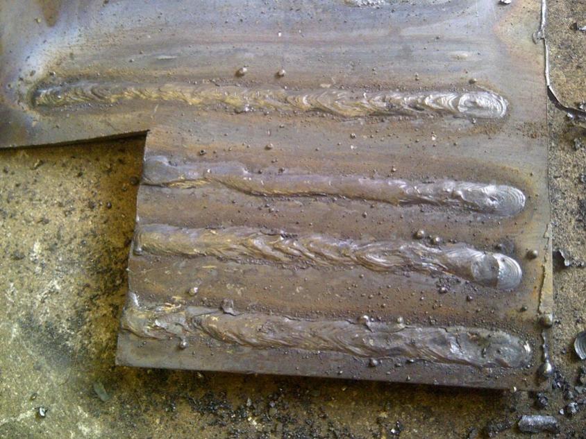

    These were some more on the back side. Trying to maintain more consistent angle and height.

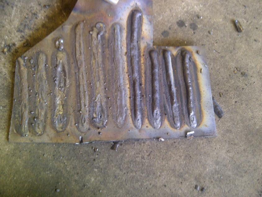

    I think the one in the middle was my best. Start and end quality are a whole 'nother project.
    My hat's off to those of you that produce nice, mig-like welds. This isn't easy!
    It would weld a whole lot better if you were using DC+, which is the preferred polarity for most rods.
    Thanks, I'll try that tomorrow and report back. I'm sure most of my problems are related to lack of experience, but I'll try any setting changes that might help.
  8. #28
    Basically every rod that can be welded on AC, can also be welded on DC. I don't know of any exceptions, but I don't know everything, so maybe there is one. If you have a DC-capable welder, you will pretty much always get better results on DC than AC, and you should pretty much always weld on DC-electrode-positive. As for dragging vs. pushing, the rule is, "if it has slag, you drag." So stick rods and flux-core MIG: drag. The purpose is to let the arc force push the slag back from the puddle while the slag solidifies.
    If you are going to weld with 1/8" rods on 1/8" scrap, you are going to have some challenges. It is 100% doable, but it's not where I would start a beginner. You don't seem to have had many issues with burning through, so that's good, but the real issue is that the piece heats up so fast that the puddle characteristics change rapidly in the middle of your weld, or from bead to bead, making it hard to tell if you're doing things right. I would suggest getting a piece of 1/4" plate or flat stock, if you can.
    Finally, running beads on plate is all well and good, but you really learn best actually welding in a joint. Consider getting a piece of 1/4" flat stock and then cutting it into 12" strips and setting up butt or fillet joints. If you don't want to bevel the edges, you can leave a gap between the pieces slightly less than one rod-thickness (1/8" in your case) wide, and it will do an okay job of letting you get penetration.
    Thanks, those are helpful tips. I definitely saw the effects of plate thickness as the plate curled up quite a bit after 3-4 passes. I'll look and see if I have anything thicker but I generally work with stuff that's 1/8 or less.
    I did grab a couple of scraps and butt them together but they were really short and did not teach me much. The repeated beads helped me practice arc starts which were not always easy.

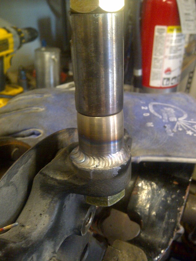

    As suggested, DC+ and heavier material made things much easier. I cut a 3/8" stake into 2 strips, butted them together with a small gap and ran a bead down the center. I seemed to get much better feedback with changes to the arc height and angle. I do struggle when starting the rod at full length (my hands are not too steady) but the second and third beads went better and I was better at adjusting position as the rod was consumed. Still not pretty, but I have a better feel for it.
    Thanks for all the tips, everyone. This has been a great intro to stick and I'll revisit the process when time permits or if the right need arises.

    You'll need even more practice than one four-sided fillet block, but just laying down a decent amount of beads will get you much more comfortable with stick welding. You're tig weld looks good.
