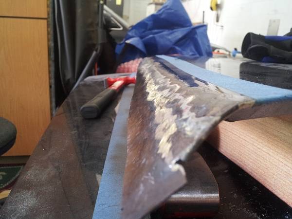

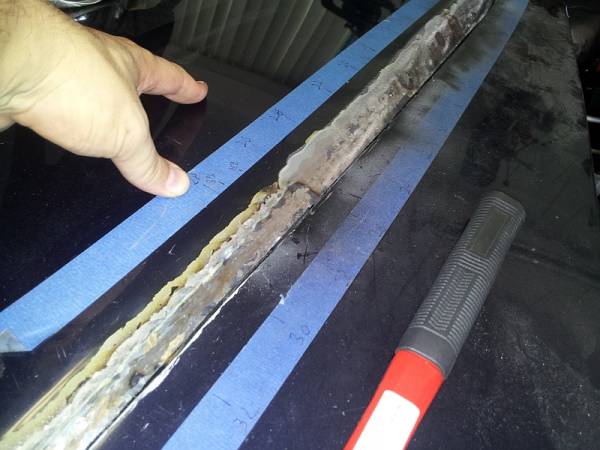

    I'm getting pretty good with the body dolly wet but I may need to buy a metal shrinking hammer/dolly. Finished welding the first seam of 6 pieces today. I'm going to grind it smooth, do some dolly work and see how much better I need to be on the next seam.

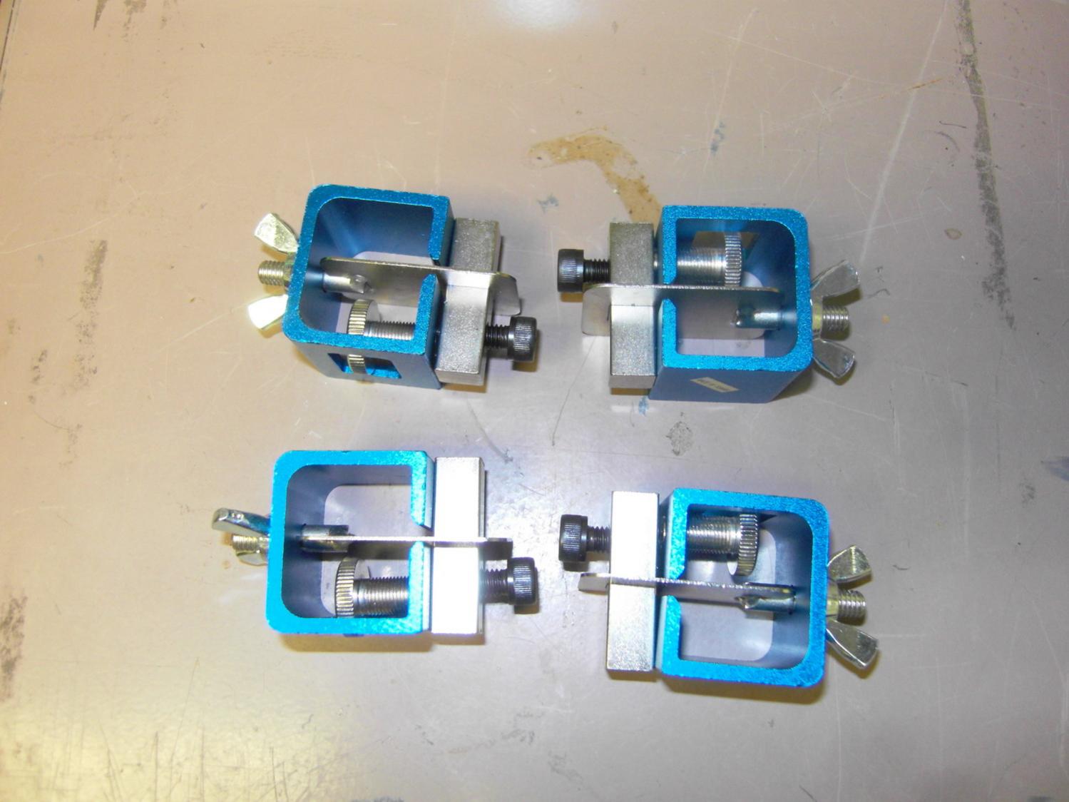

    I found that these work pretty good. They leave just a small gap.
    I got mine at Harbor Freight.
    Some pics of my progress

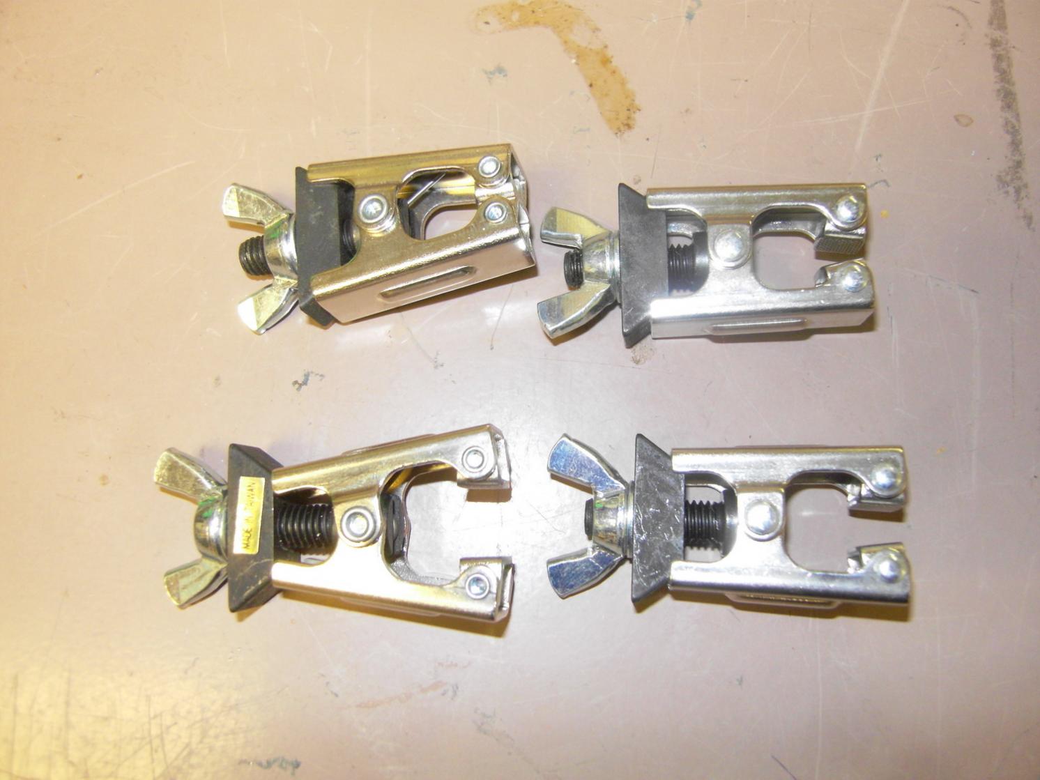

    I got the same at Princess Auto the same as in Harbor Freight in Canada we have Princess Auto and the USA have Harbor Freight.

    I have seen those on eastwood andhave wondered if they make things easier. Usually I just fit the piece and then use my triangle magnets to hold the piece while I tack it in place. Next time I am HF I might have to pick some of these up if they are not too expensive.
    Magnets work but with Tig they do cause problems but still looking for aluminum Magnets but no luck have to use the sheet metal clamps or vice grips.
    I use my triangle magnets for tacking up too. I do have the issues that Kempy mentioned sometimes with them, but there's no other way around it in certain situations. It's darn near impossible to tack something up that has a gap of any nature, while trying to use one hand to hold the part in place (say with pliers). And if you can't get to the backside of the part you're welding, vise grips are rendered useless. Cleco's can be used successfully in particular instances.
    I guess I have never run into the issue with the magnets and TIG. I so also have clamps that I use some times and the magnets do not work for aluminum so I either clamp that or find some way to hold it whether its proping something against it or trying to hold it by other means while I tack it.
    Will have to google that. Alumimum magnets??
    Also, the magnets can cause problems with MIG as well. They gets us on occasion but rare.
    What are these problems you guys speak of? I have never noticed any problems using them.
    A strong magnet can and will attract the actual arc. So often the arc will wader away from where you are trying to point it. Similar to how a static electric charge can bend a stream of water.
