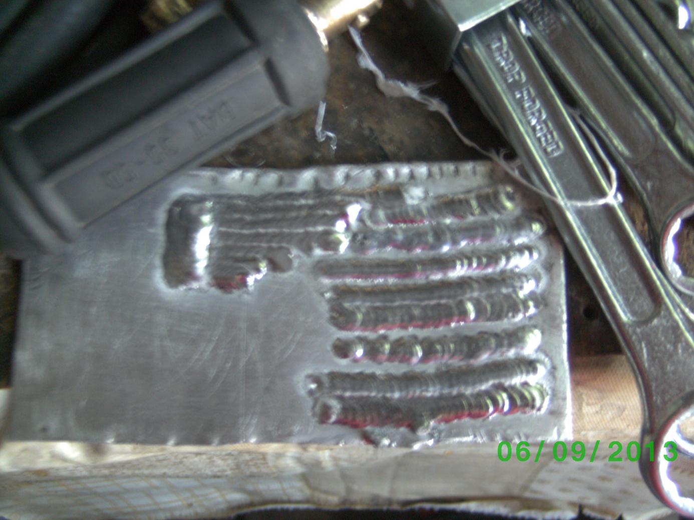

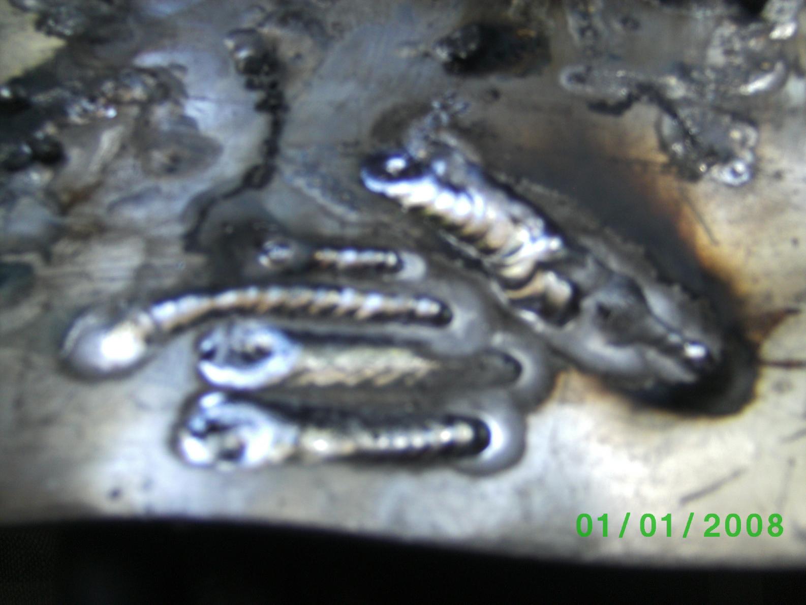

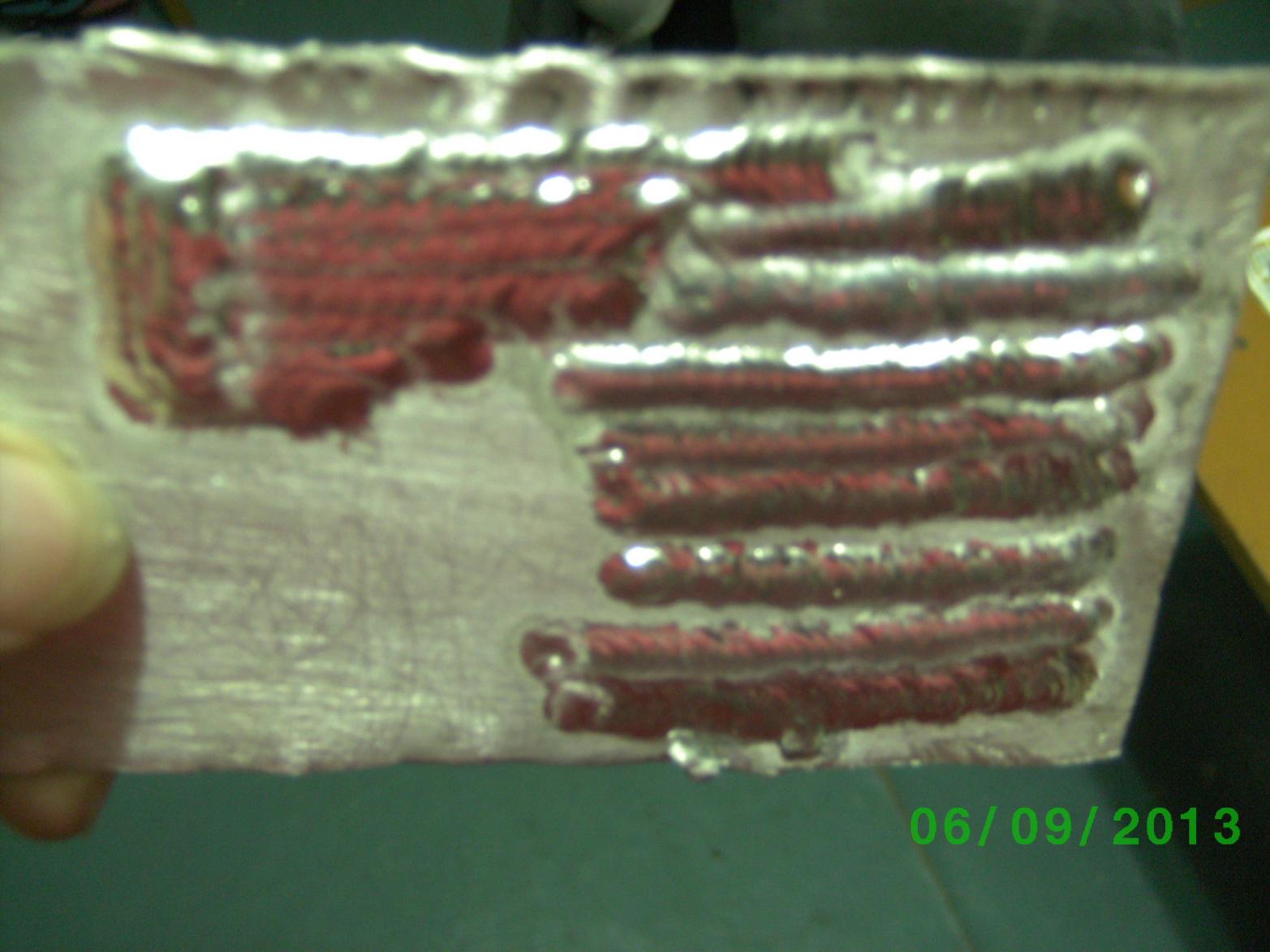

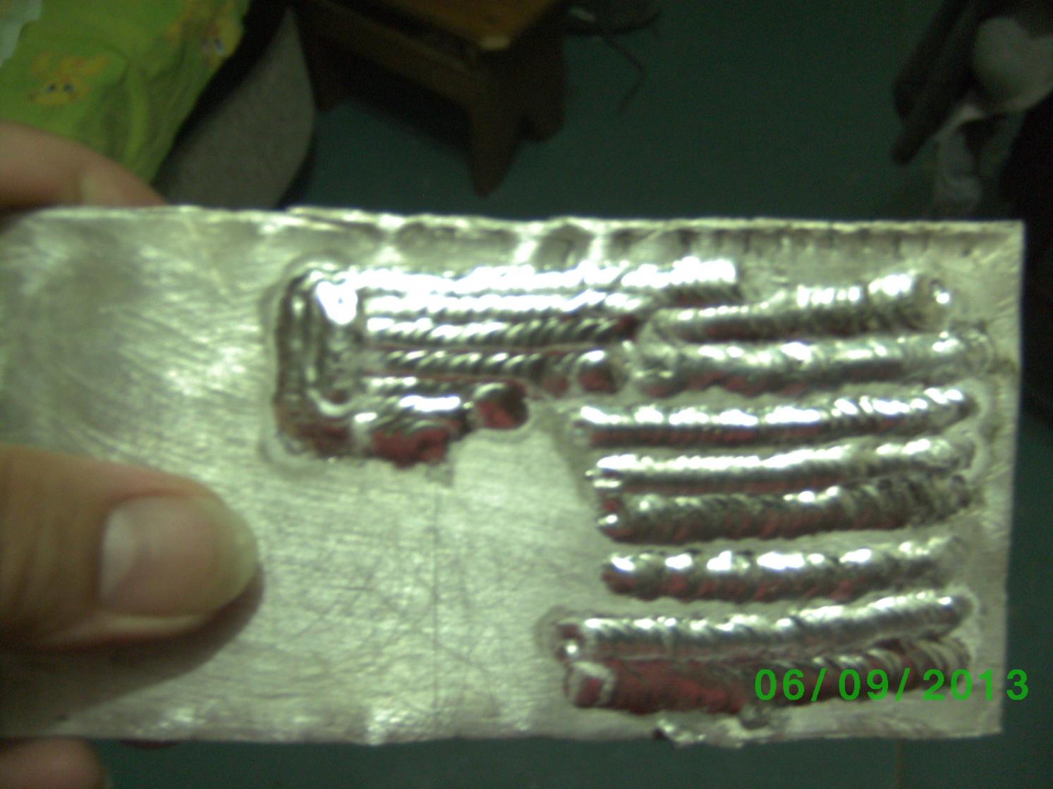

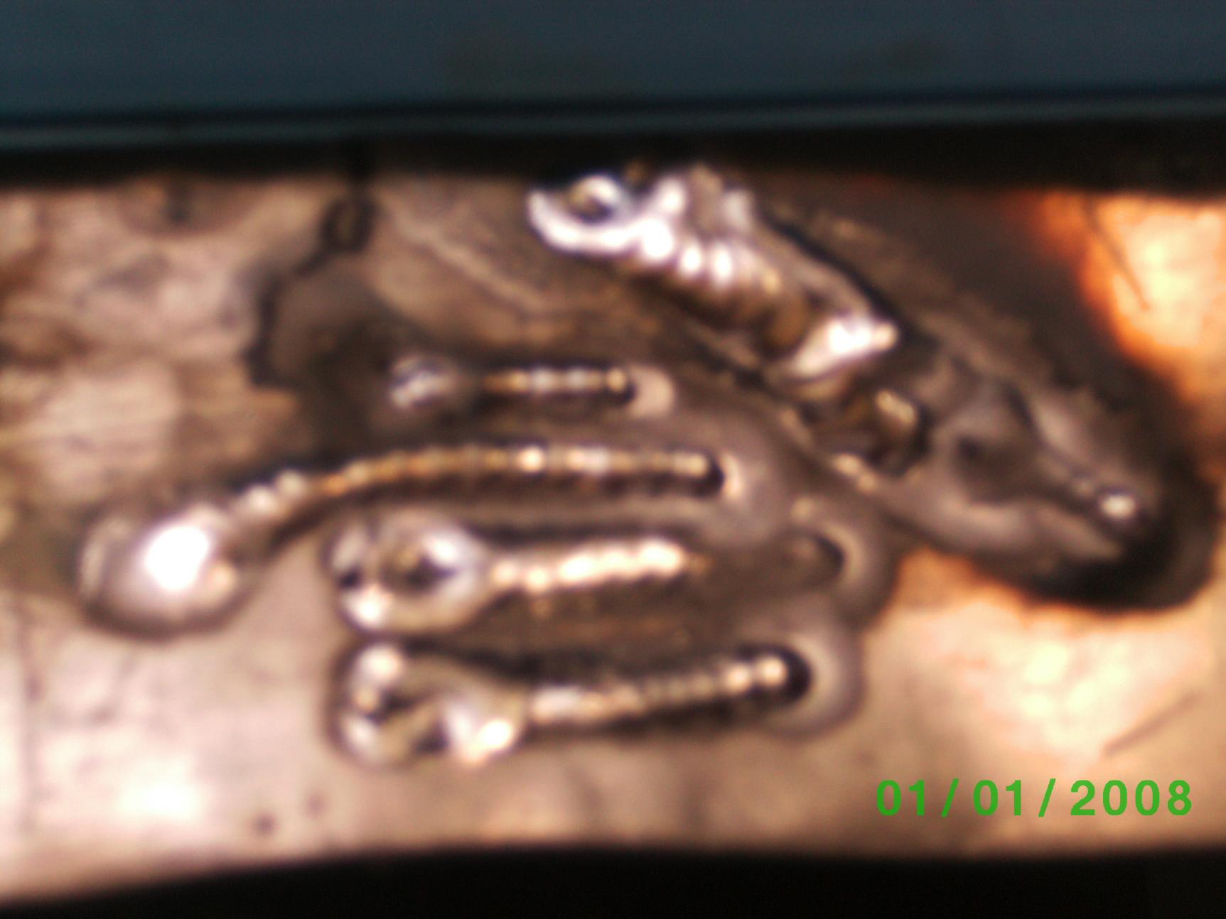

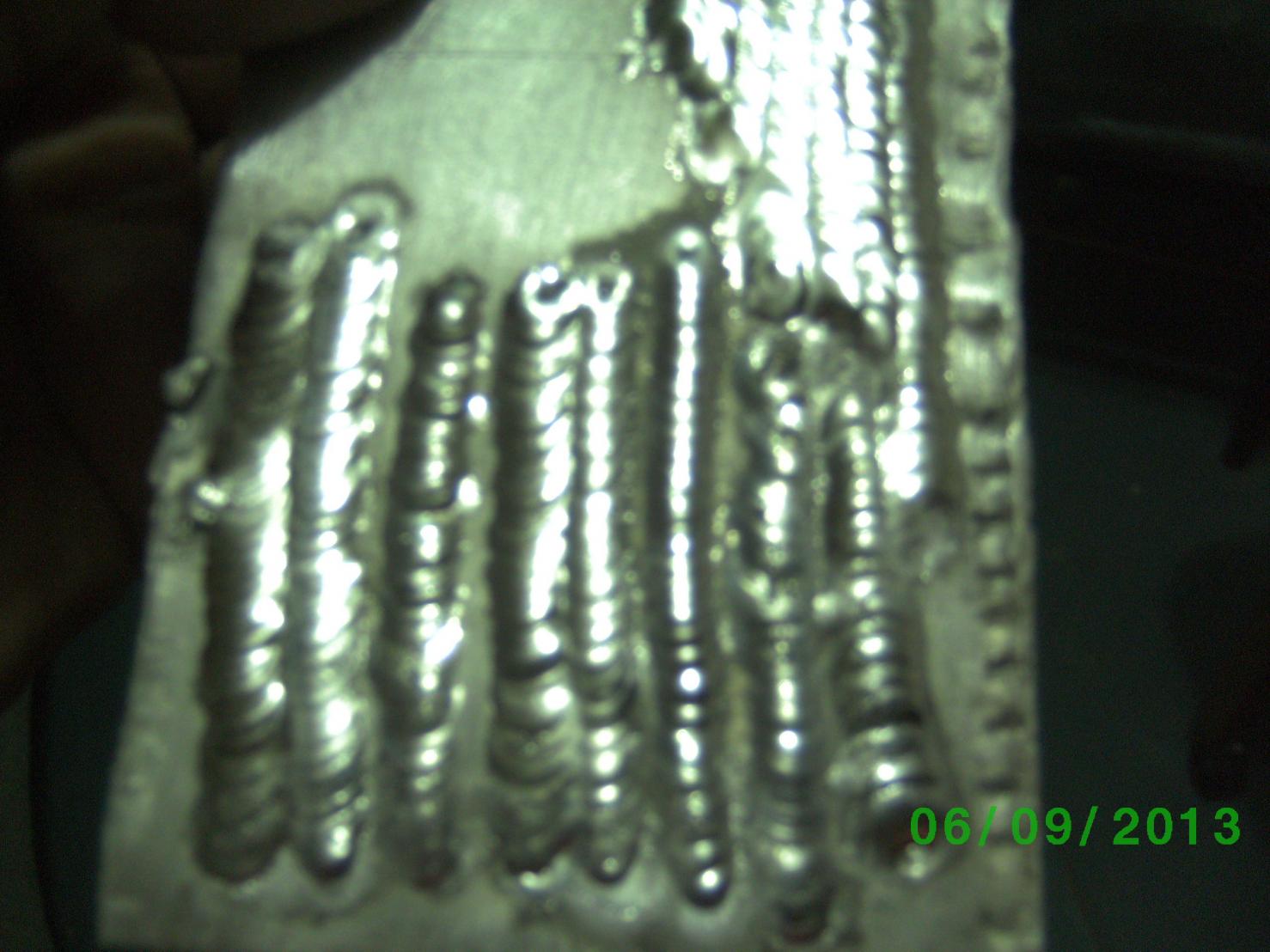

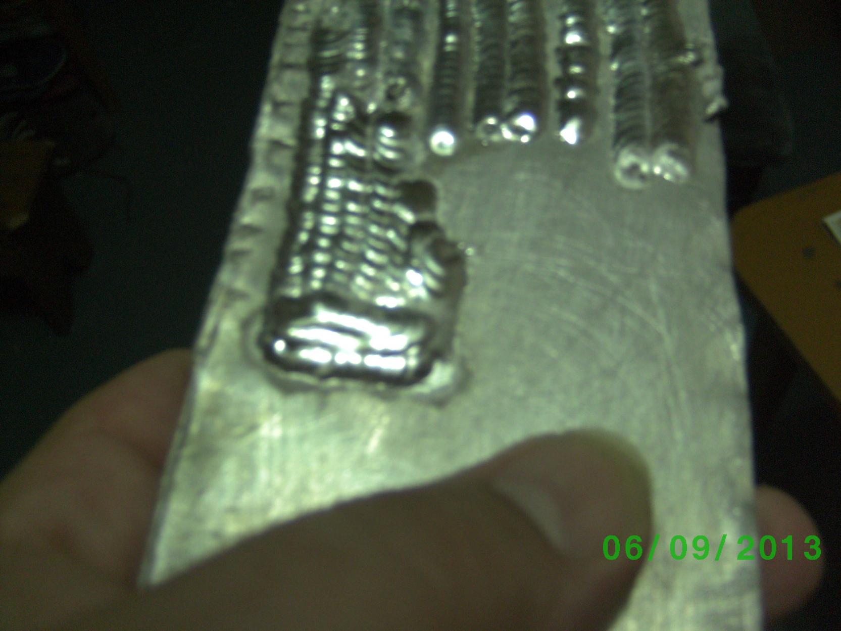

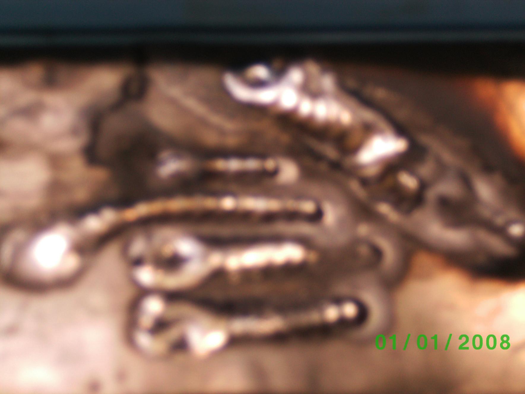

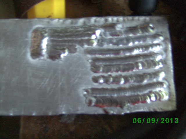

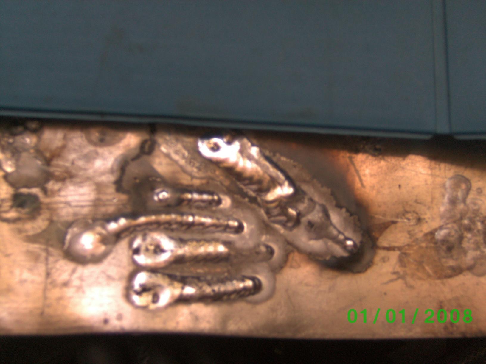

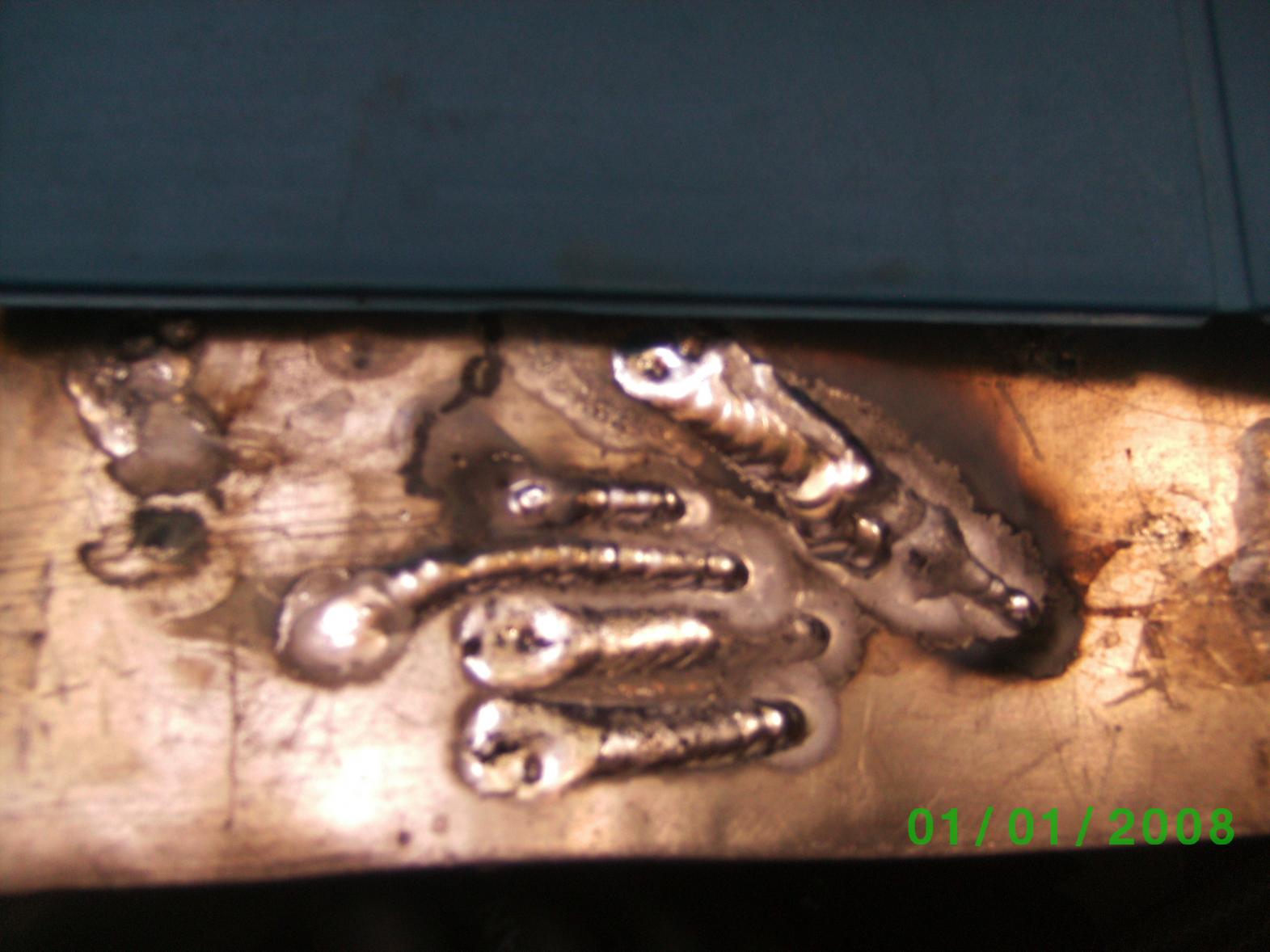

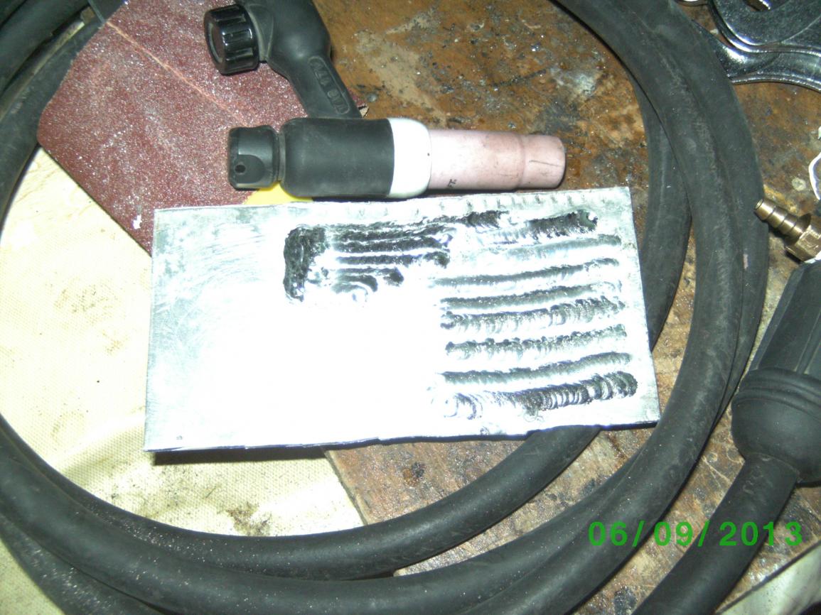

    Dear friends, I have to write again to correct some minor mistakes that I made ...as I promised, I'm back with some good news-for me are very good.I managed to upload the argon from another company and big surprise ... the device works very well at tig welding aluminum,I can only say I am glad about the welding machine everything is ok and those who loaded first argon tube will make them a little email to reprimand them ( I suspect it is that they put mixture of argon with CO2 ) I also apologize to those who have answered before me here on the forum, but you should to think-I was really upset but thought that I had to send in the U.S. welding machine scare me very much ( other good weeks expected the device to return to me ;I'll put a few photos and even if you are not very good quality is what you need to see,I promise to come back with better quality and anyway you have to work at fine adjustment of AC BALANCE ... I said super pleased and have to thank again those of team Everlast -John Romania!

    Nice to see it was just a gas issue and not a machine issue. I just bought a 125cf Argon Tank on Tuesday. Looking forward to playing with the TIG.
    Used motorcycles and parts
    Just set the balance to 30%-35% and leave it. Also set the frequency to 120 hertz or so.

    That is looking much better, glad to see it's working for you. Following the settings recommended by others here has been very helpful to me as well.
