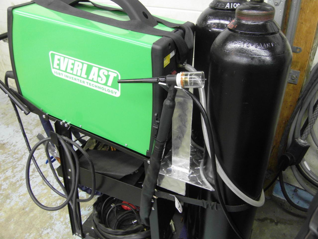

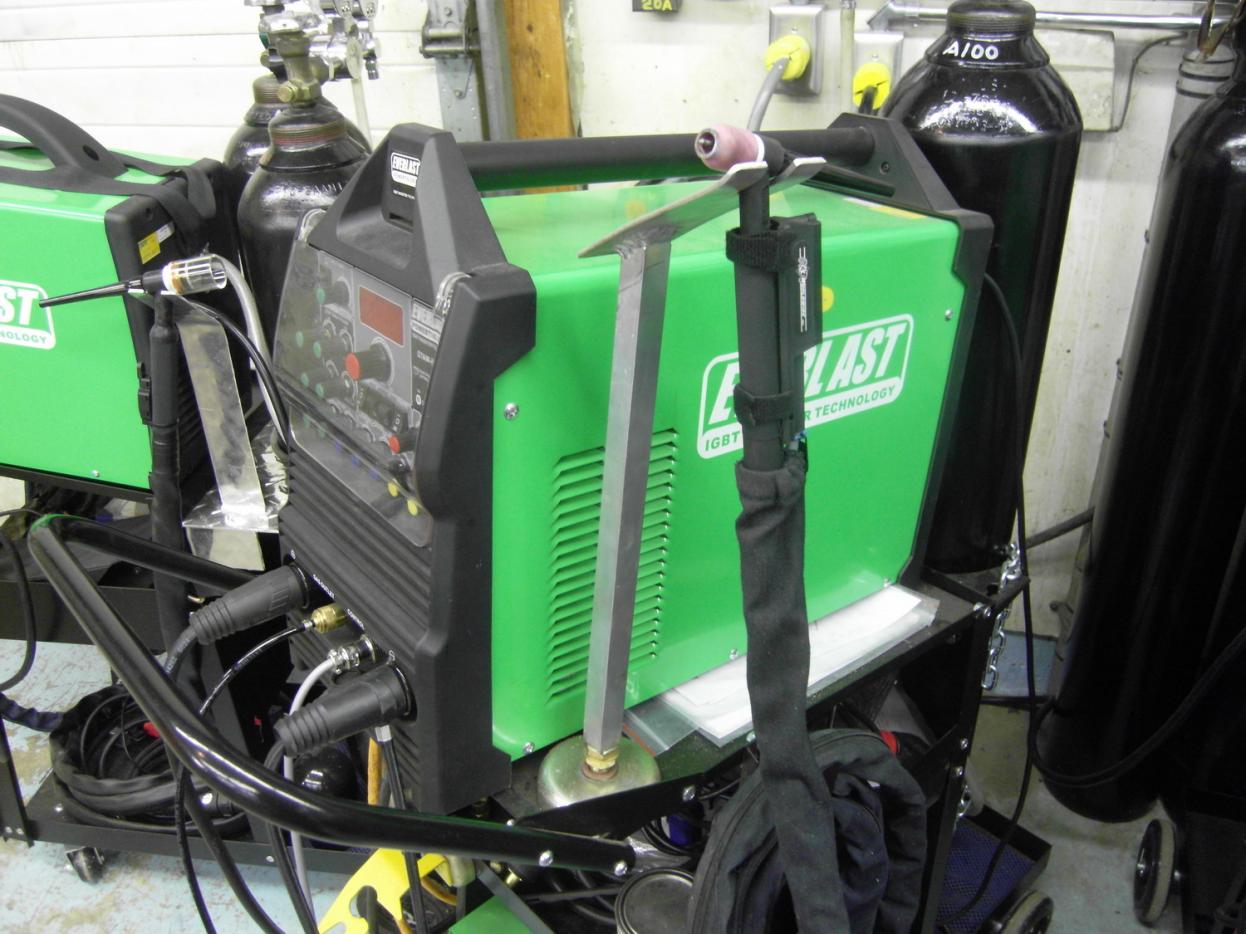

    I made this to hold my torches one mount to the cart and one on a magnet mount to use on the bench or were I am welding.
Name:	holder and magnet.jpg
ID:	10784Click image for larger version.
    That is brilliantly simple, thanks for posting. I think I'll cut something similar out of aluminum sheet and weld it to the shelf on the torch-side of the unit.
  20. #40
    I've use one of these for years. It's also magnetic, but might be a bit large to stick on the top of smaller welders.
    I think I'll have to make a couple of Kempy's style.
