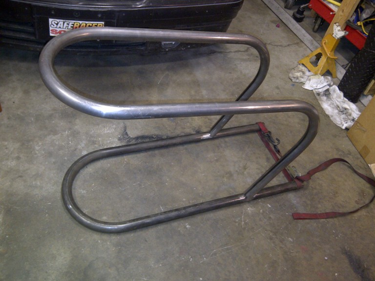

    I bought my 200DX almost a year ago and "temporarily" set it on top my bench until I built a cart. Last week I started bending some leftover 1.5" tubing into some 180's.

    Going for a shopping cart-style arrangement.

    Thanks. I'm using a hole saw notcher. It's one of the cheap ones (no ball bearings, stamped steel guides) but it works for light use. It took quite a bit of shimming to get it to cut on center.

    Here are some more pics. I added a couple of 3/16"x6" plates to hold the bottle and some 2" strips to suppor the shelves.

    I made an axle from some 5/8" bar with the ends turned down to 1/2" and put some small casters on the front. Added a short ring of 10" pipe on the lower plate to hold the bottle captive.

    Looks cool. Now I see what you mean by the shopping cart design.

    It was probably $30-40 and I'd consider it well spent. As much as I've used it, I probably should have just spent $300 on a well-made one.
