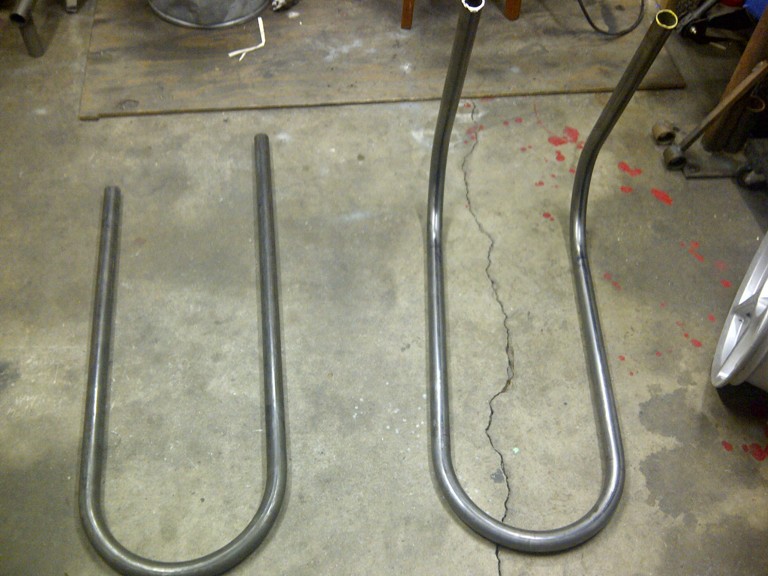

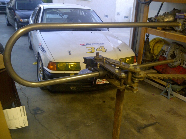

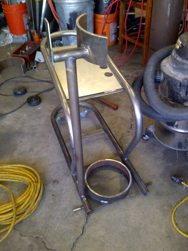

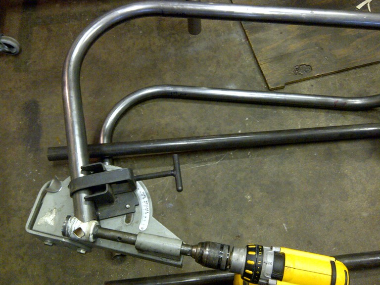

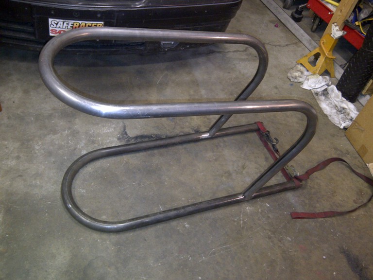

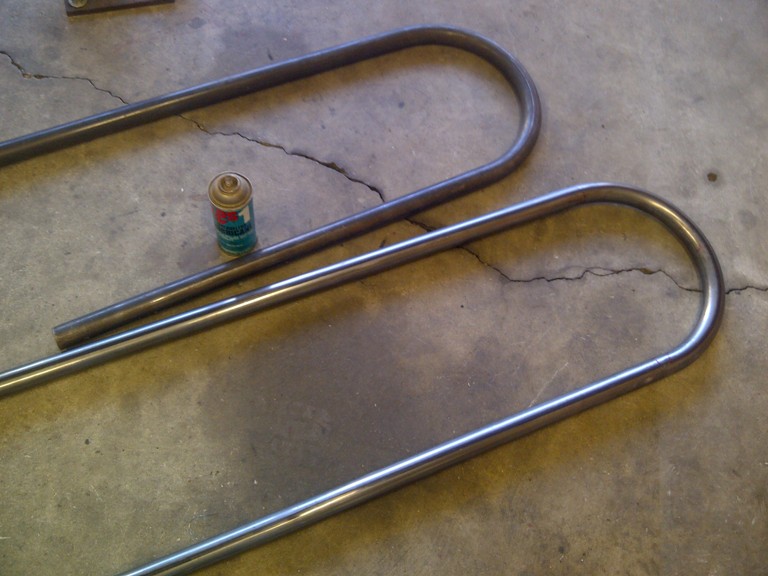

    I bought my 200DX almost a year ago and "temporarily" set it on top my bench until I built a cart. Last week I started bending some leftover 1.5" tubing into some 180's.

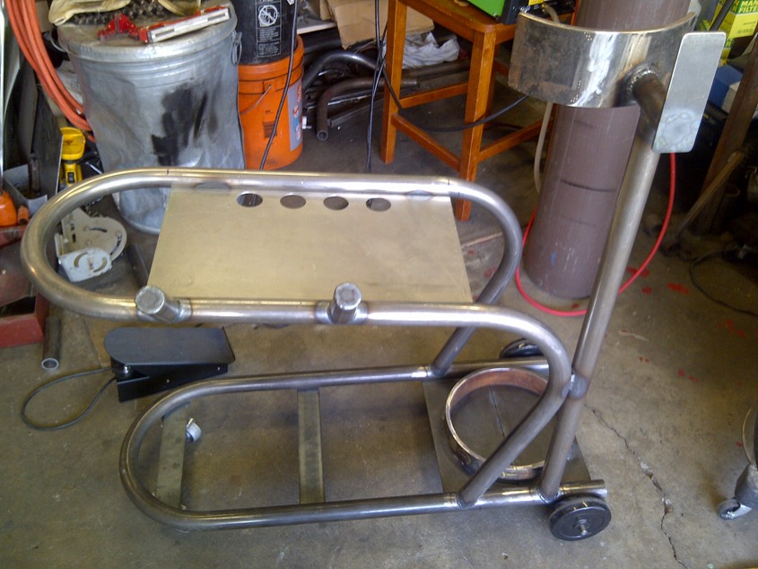

    Going for a shopping cart-style arrangement.

    That's a great start and I really like the design so far! What wall thickness is that tubing, what brand of tubing bender are you using, and how are you fish mouthing (notching) the ends of the tube? I'd love to see the cart when it's finished. You've got some nice equipment in your shop/garage and I'm sorta jealous!
    Thanks. I'm using a hole saw notcher. It's one of the cheap ones (no ball bearings, stamped steel guides) but it works for light use. It took quite a bit of shimming to get it to cut on center.

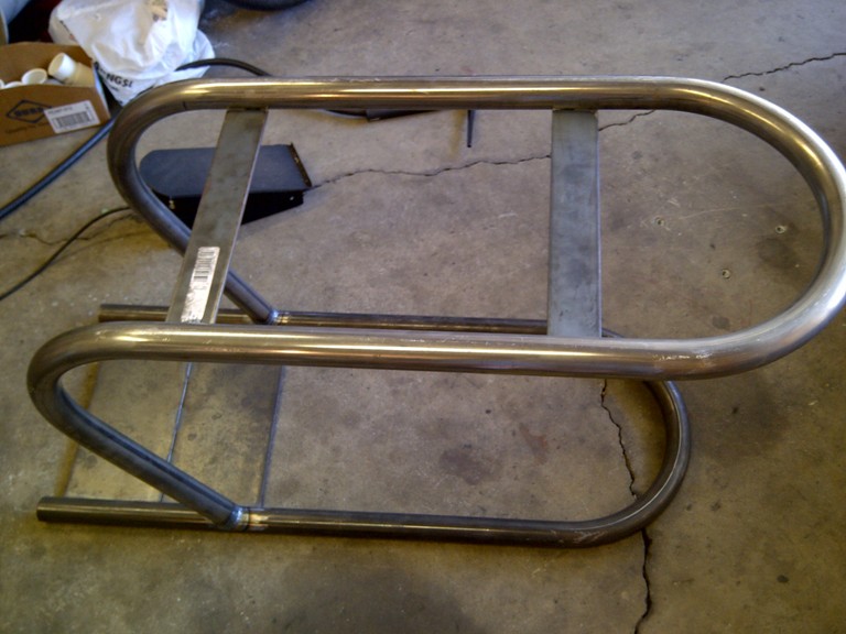

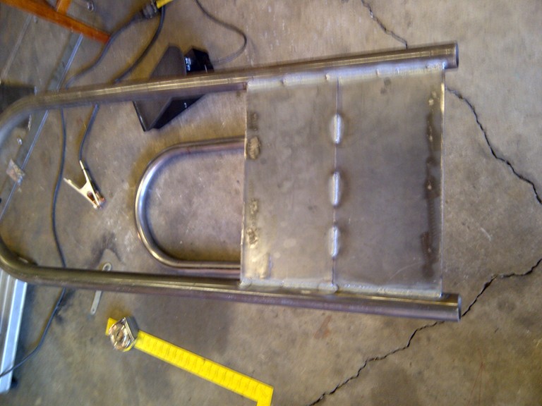

    Here are some more pics. I added a couple of 3/16"x6" plates to hold the bottle and some 2" strips to suppor the shelves.

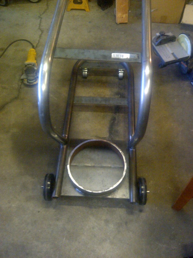

    I made an axle from some 5/8" bar with the ends turned down to 1/2" and put some small casters on the front. Added a short ring of 10" pipe on the lower plate to hold the bottle captive.

    Looks cool. Now I see what you mean by the shopping cart design.

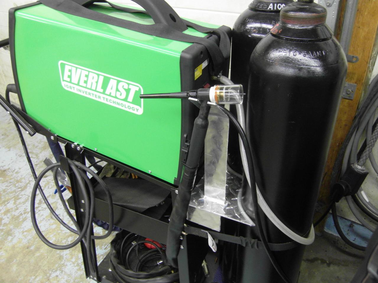

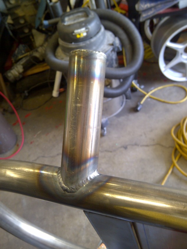

    I'm about finished with this thing. I put a post on one side that will serve as a bottle support and a hanger for my extension cord.
    I'm using some 0.080" aluminum for the shelves but didn't have a long enough piece for the bottom. The holes on the side will hold some PVC filler tubes.

    There are two short pieces of tube extended that will serve as hangers for the torch and ground leads.

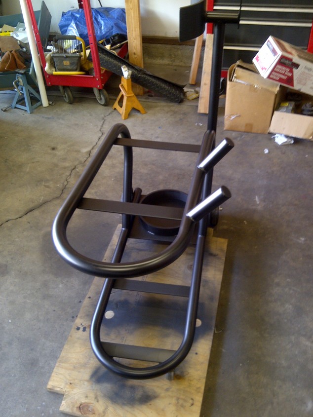

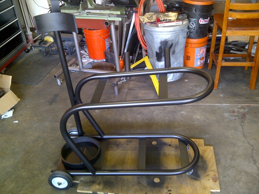

  18. Default
    I emptied a can of semi-flat black on it and swapped out the wheels for something with a bearing in it. Hopefully I'll pick up another sheet of aluminum this weekend and finish off the bottom shelf.

    Any concern that you will pile too much wait towards the front of the top shelf?
