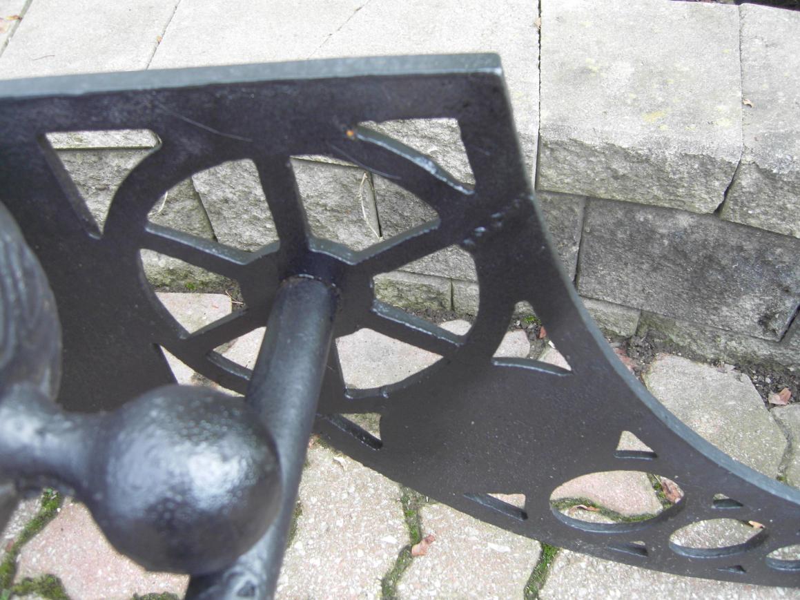

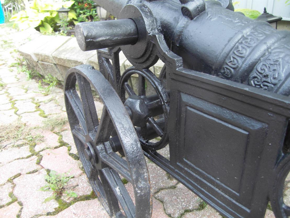

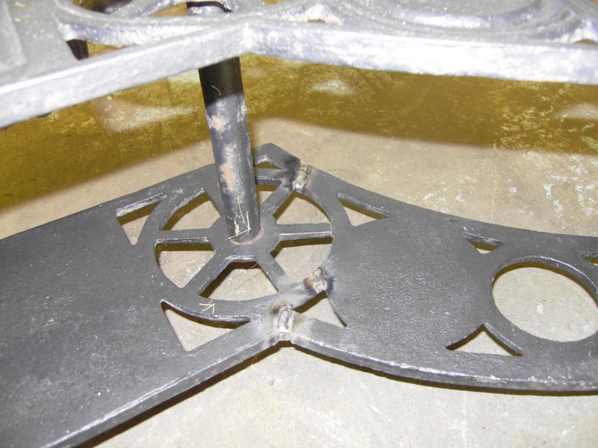

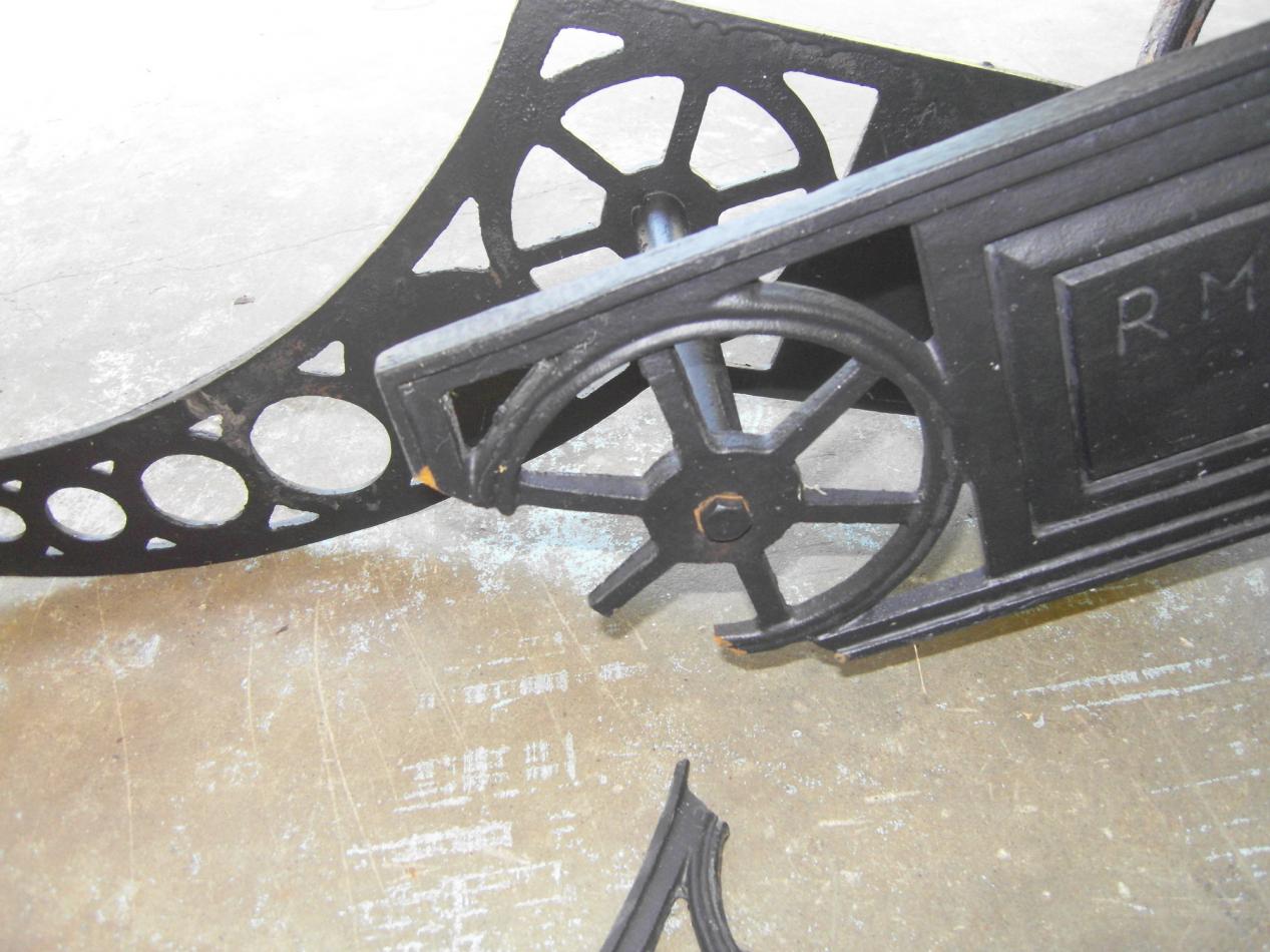

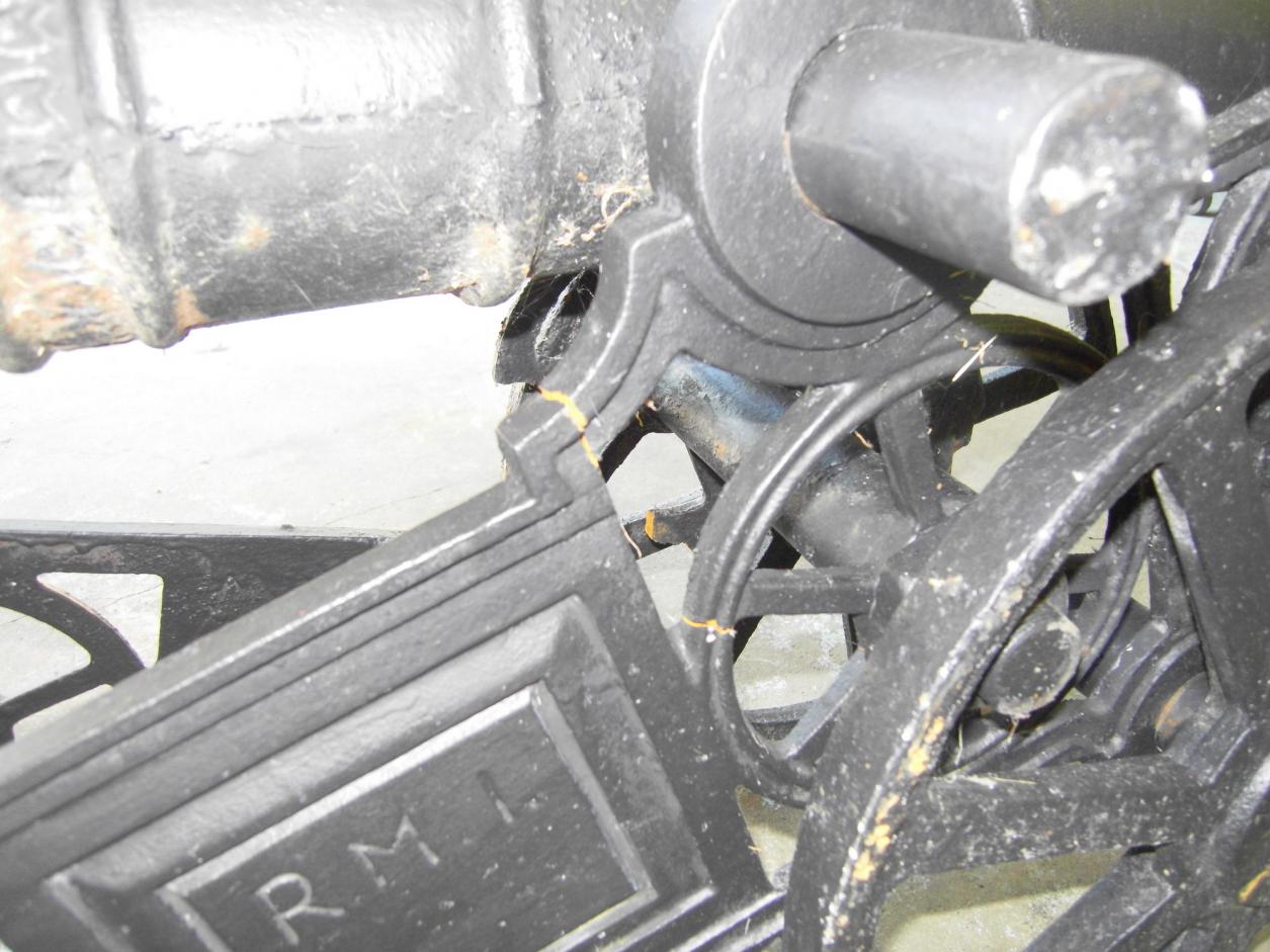

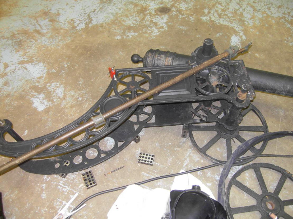

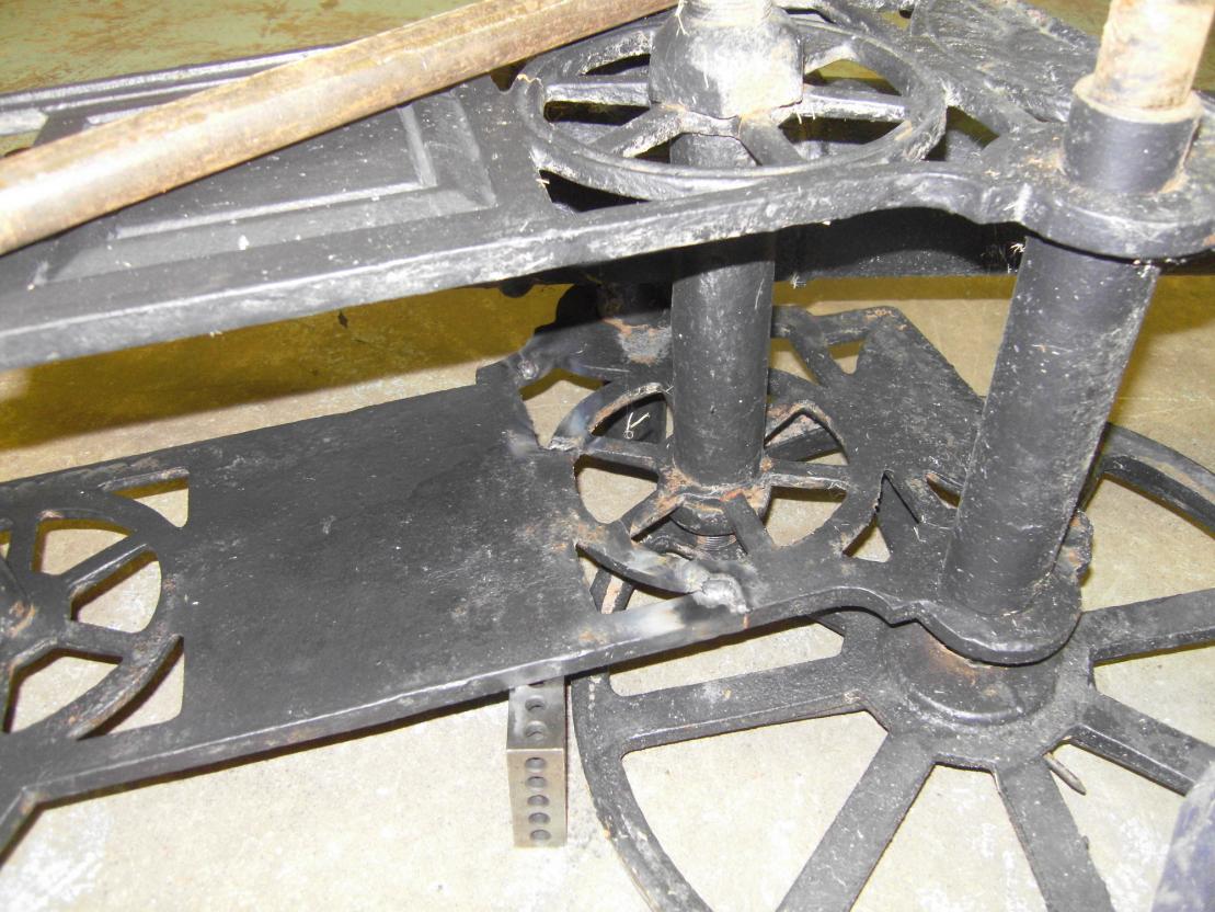

    I weld the broken cast iron cannon that someone dropped off a back of a truck then brought it to me to fix with a little love and care I got it back together used my MTS250S in Tig mode and welded it with Cronatron Cast Iron welding rod.

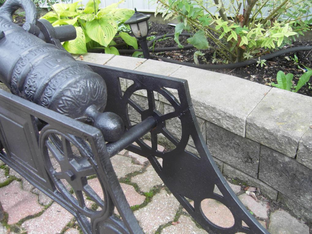

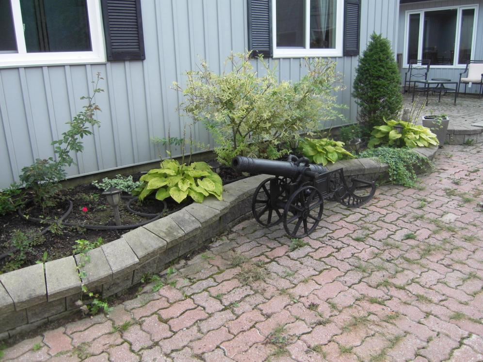

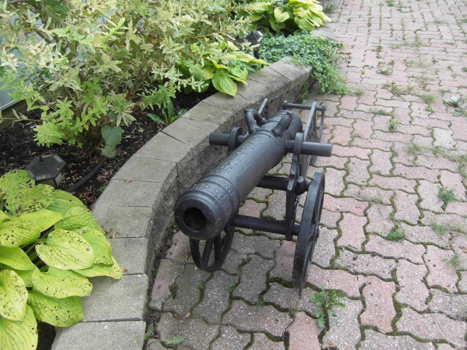

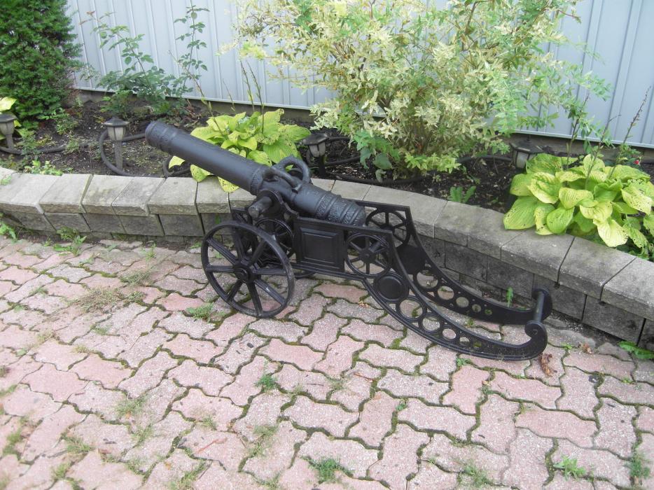

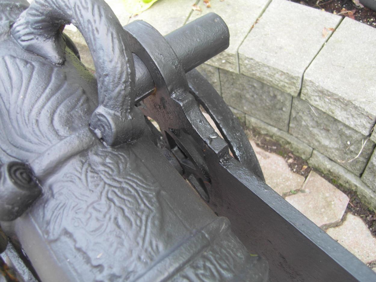

    All welded and painted and the customer not to be found phone out of order I might have a new garden toy.

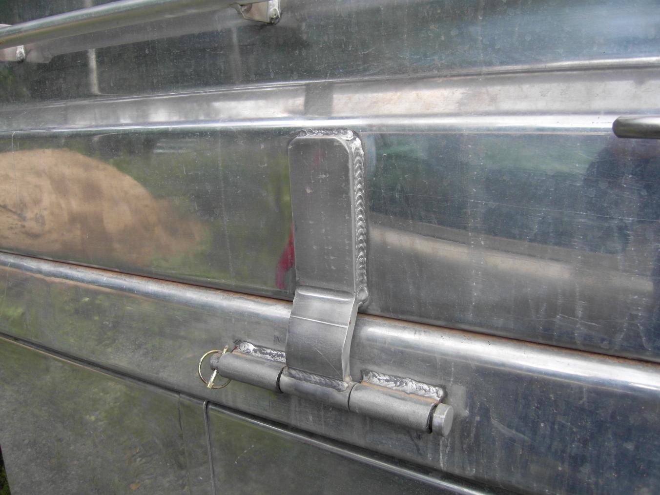

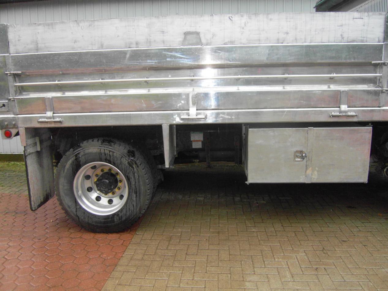

    I used my MTS250S and spool gun to welding out in the rain and wind to fix this dump truck aluminum box with a third hinge in the middle to stop it from pushing out. The factory hinge was weld with a Miller 350P at $8000.00 and me with my Everlast MTS250S and spool gun with no pulse no hot start and the truck was outside not inside. The customer was happy and thought I look the same, he is not a welder. With more practice I thing I can get it close.

    Hope the guy shows up (with cash) to pick up. There's a lot of Civil War history around here, and every now and again you see a cannon in a front yard.
    What parts were aluminum and what parts cast iron?
    The truck is aluminum and the cannon is cast iron.

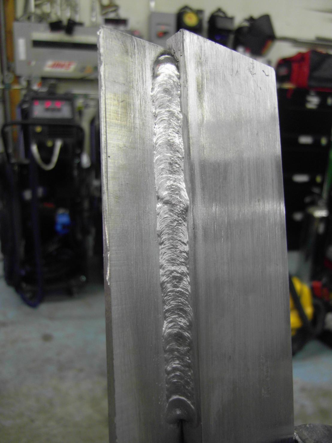

    Kempy, that aluminum looks like you welded it a bit cold. Was that in spray mode? That's the only way to MIG aluminum...or it won't hold up.
    Mark
    It was close to spray mode but when I was test it on the same material 1/2 on 1/8 inch it blow thru about 2/3 of the way down the hinge but look good up to that point, so I had to turn it down even turning it down the weld did blow out at the top because it was to hot, welding across the top part of the hinge the pressure inside got to high it was seal to keep water out I should have drilled a hole and weld it up later live and learn. Maybe I should have gone to .030 wire not .035.

    The cannon was made just for looks and was never able to fire, right ? Did you ever consider grinding the welds down and trying to match the cast finish ?

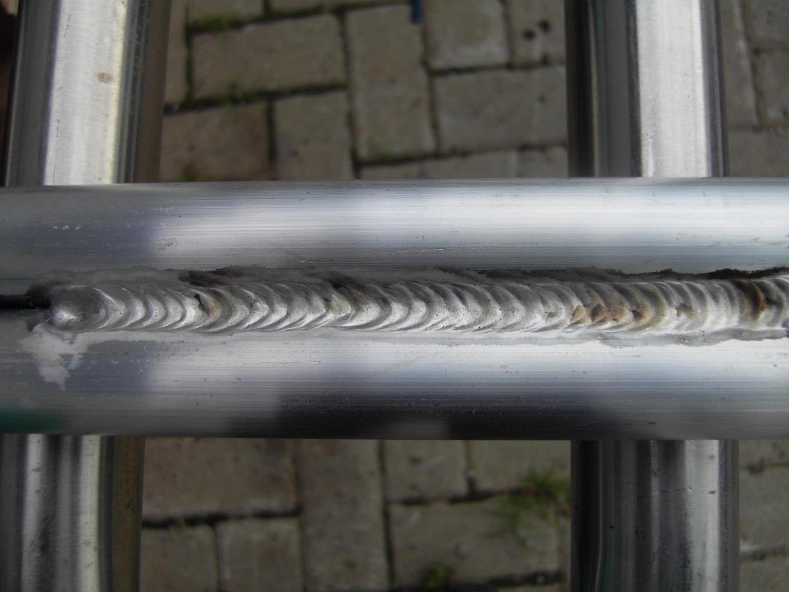

    Well I did a little research and most of the Mig aluminum thick to thin use Helium mix. So I mixed a 50/50 argon helium and tried it. That is the way to go with a little practice I think it will weld nicely. I used it in SYN spool mode and up the volts by 1.5 I read on Miller site. The heat is more on the weld with the Helium mix then with 100% argon just need hot start and pulse would be nice also, but that a lot of money buying a pules welder for aluminum from Lincoln or Miller or ???? I will just wait some day Everlast will come out with one I hope.
    When I tipped the barrel down out can a lot of used fire crackers but it is a show piece yes. I did think of grinding the weld but know one has even asked or pointed out the welds they are small and the paint covered up most of it.

    Can you see the welds easily?
    But maybe if I have some time to waste I will grind and repaint it again.

    The 205P is not heavy enough to weld like that, and is for small diameter wire. I never understood why it was offered. It's barely hot enough to do spray welding. It'll do aluminum though with the thinnest wires. Both the 205P and the 250P switch between High and Low VOLTAGE, not current. Single pulse switches between 20-250Hz. Double pulses usually max out at 5 hertz.
    Pulse spay can be in single pulse or double (pulse on pulse) pulse. Our units are single pulse. What you see there is a product of technique as much as it is anything. That's just a simple stepping motion. It's also likely that the item was welded flat, instead of vertical as well, and attached after the hinges were installed.
    Maybe I only notice because I know where it was broken.
    Mark
    You might be right the welds all on the door look the same but when they welded the two outer hinge parts the weld is different. I copied a picture from Miller pulse welder and it has a similar pattern in flat I could get it some what like that but not welding vertical. I will have to look into the 250P sell the 205P and move up.

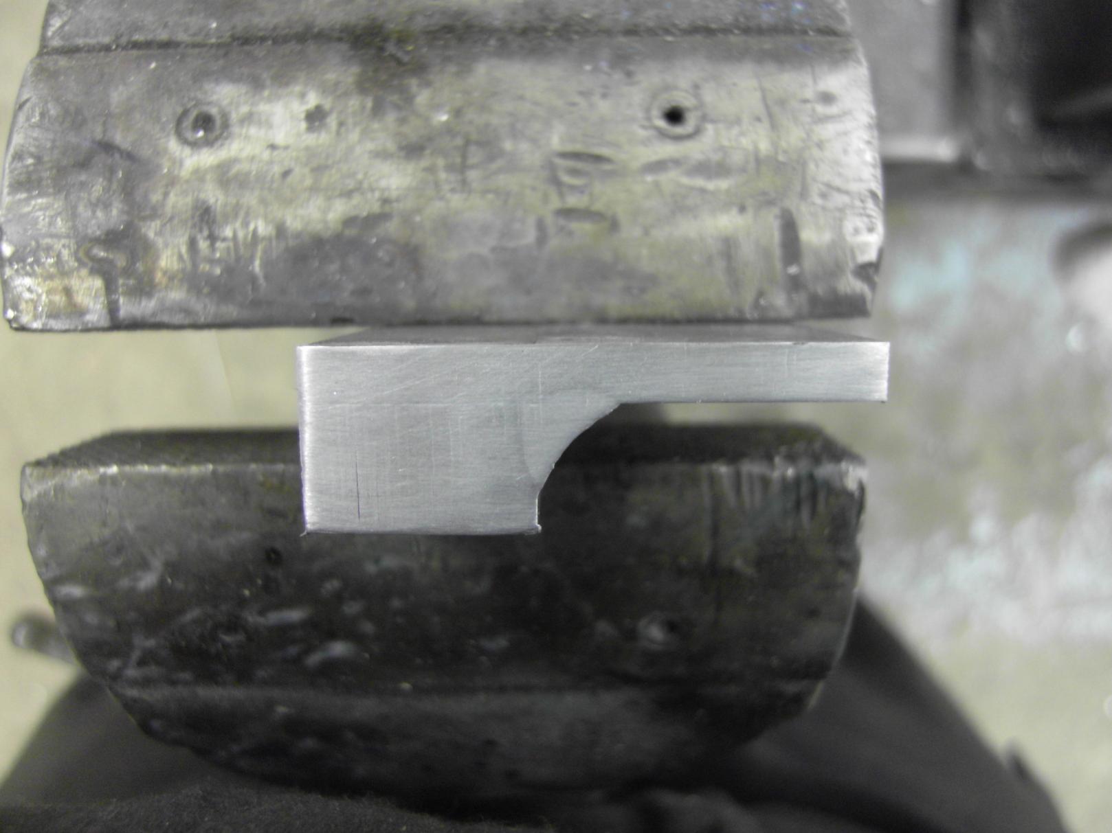

    Looks much more wetted out, for sure. I'd be curious to cut through a section and see how the root penetration was to the two different thicknesses. Did you favor the heavy plate with gun angle?
    This is the best I can do to show you the weld cut. I welded right in the corner 50/50.

    Looks great to me. I need to purchase a spool gun.

    Looks great. Thanks for the demonstration. The helium seems to make all the difference. Looks like another gas I should keep around. I haven't used it since school, and then the price was a lot more reasonable.
