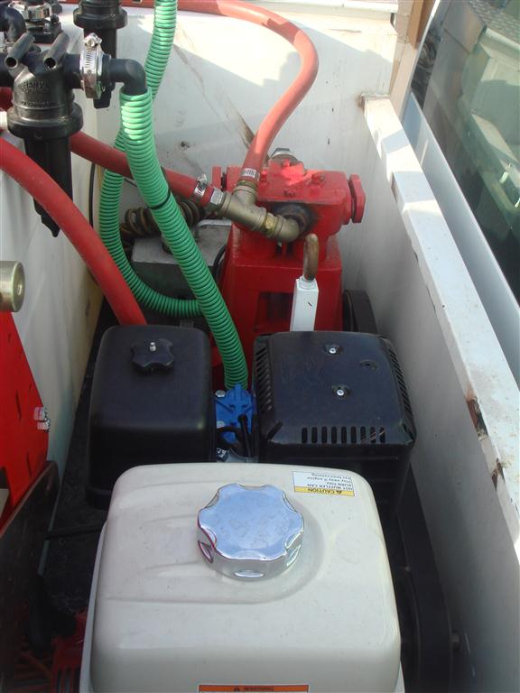

    Here the components are mounted, a 13HP engine, a low pressure 10 GPM pump and a high pressure 20 GPM pump You can see the belt tensioning system and the captive nuts, so it's easy to tighten the belts and lock everything down when it's installed with one wrench.

    The engine was supposed to be a new type of Honda with all electronic controls that would make a remote control panel a piece of cake. But even though it's been on their website over a year, it seems that it's still smoke and mirrors and I had to get the old style. The only problem is that although they kept the cable mount for the remote throttle, they redid the choke in all plastic and deleted the remote cable fittings in the process. So I pressed into service a door lock actuator, a piece of welding rod, and a spring to make up a remote choke that works at the press of a button. Welded a small triangle plate to mount it just under the fuel tank.

    And here it is ready to mount in the truck. I rolled the frame over a piece of pipe to find the balance point to attach a nice lifting hook so this can be removed for major service if needed, without disturbing anything else in the truck.

    And here is the final product. There are still a few loose ends to tie up, and the powder coating will be done after I'm sure all the welding is finished and any bugs are worked out in field testing.
