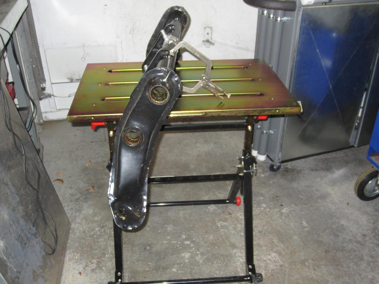

    So I've been planning to build a small portable welding table for quite some time now, but I have also kept my eye on Strong Hand's Nomad table after seeing Jody's review at WT&T. I finally decided that I have enough things to build that will keep me busy, and most of them will require a welding table that I can weld on, grind on, and clamp to. My final decision was made when Ebay sent me a 10% off coupon for select sellers only. Summit racing was offering this very table for $150 with no tax or shipping, and this item was eligible for the coupon, so I went for it and spent just over $135 total.
    Of course with UPS involved in shipping, I couldn't help but cringe...and with good reason. I watched the UPS truck storm by yesterday and then drive right back out several minutes later without stopping at my address, and I knew there was a problem when the tracking status online went from "Out for Delivery" to "At front door" 20 minutes later. Certainly not the first time this has happened with UPS deliveries, and last time was a HUGE mess until UPS sent the responsible driver to retrieve the package from the wrong address. About 2 hours after I called Summit and they volunteered to ship another one out immediately at no cost to me (while also filing a claim for the "missing" table), the UPS truck showed up, dropped the package in the yard quickly, then drove off before I could run out and get their explanation/apology. Of course I called Summit and cancelled the 2nd table.
    After opening the box, I separated the parts and fasteners neatly, and began assembling the table according to the instructions that Strong Hand sent with the table. About 40 minutes later I had a table that closely resembled what was printed on the front of the box, no cussing or yelling involved (FIRST TIME EVER!). I was able to use the table this evening for the first time and I think it's going to work out just fine, even as my primary welding table. Of course I have some upgrades planned, but I need to get through some other projects first. Possible upgrades do include adding the 32"x26"x1/4" aluminum plate that I currently use for the welding surface on my job box, some properly sized Z-bar side rails that will work in conjunction with the new top, plus hinged panels on the sides and back of the tabletop to help contain sparks and grit while stick/MIG welding or cutting/grinding (like a welding booth).
    And the best part is that my new nylon torch lead jacket still didn't have to touch the dirty shop floor! I must say that the table was quite sturdy as I turned and flipped the front beam I'm in the middle of repairing. I couldn't think of a project that is more awkward to weld then this for the table's maiden voyage. I'm very pleased, even as it sits in factory format with no upgrades.

    It is way past time to pull the trigger and just get one. Thanks for the review Andy.
    Your welcome! I'm a little embarrassed to admit that the table is currently the spot where I am doing some front end assembly work. The tabletop is covered in dirt and grease and I've only used it for welding once so far. I can't help that it's convenient for other things besides welding. One of the first things I figured out about it (in regards to welding) is that there is almost always an uncovered portion of the table slots which can be used to set the torch cup into to prevent the tig torch from sliding off the table (when you're not welding with it). Probably wouldn't work for a MIG gun with the trigger being in the way though.

    I do that with mine as well. Not necessarily the covered in grease part, but I use it as a bench to put parts when I pull the engine out of my bike. I also use the slots to hold the torch, although it doesn't do a great job and I had it hit the floor, breaking the cup.
    Guess one of the first things to do will be build a torch/gun holder then. The ergo plus gun is nice to work with, but the trigger extension is always getting activated when I set it down.
    I just happened to need a spot to assemble my front end and the table was sitting there looking under-worked. Yeah, the torch has tried to slide off the table a few times on me now, but I still find the slots to be handy for that purpose most of the time. I did find that a pair of Vise Grip C-clamps worked well for keeping the torch on the table (hook the ceramic cup around the upper portion of the C-grips).
    I'm trying to figure out what fixtures and tooling I want to insert into the slots (to give them a real use, but I still haven't put much thought into the idea yet.
    That's a pain with MIG! There are a million ways to build that holder with very little work and thought involved. Even something as simple as welding a short piece of tube or pipe to the Vise Grip C-clamps I mentioned above so you can clamp them anywhere. I use those Vise Grips for almost everything!
    Good idea, it never even occurred to me to just stuff the nozzle into a piece of pipe for a holder. As usual, I pass right by the easy solution on my way to yet another over-engineering challenge.Name:  duh.gif

    My welding instructor in college showed me that trick originally (years ago). Then I became a sheet metal worker shortly after and started working for a local HVAC fab shop as a pre apprentice (with the foreman, 7 journeyman, and a few apprentices). Almost everyone treated me like an idiot since I was young and new to the trade, until the 35 year certified welder/journeyman in the shop saw me using those "pockets" on the welding table to rest the MIG nozzle in and told everyone at lunch about it.
    Apparently everyone else (including the foreman) had let the stinger hit the floor multiple times whenever they used the welder, and the journeyman welder was stuck fixing the damage every time the gun stopped working. He even gave "heated" lectures about it to the other guys at lunch. Needless to say, I got treated with some respect after that and had a much easier time "fitting in" at my new job!
    Good idea! That had never occurred to me!
