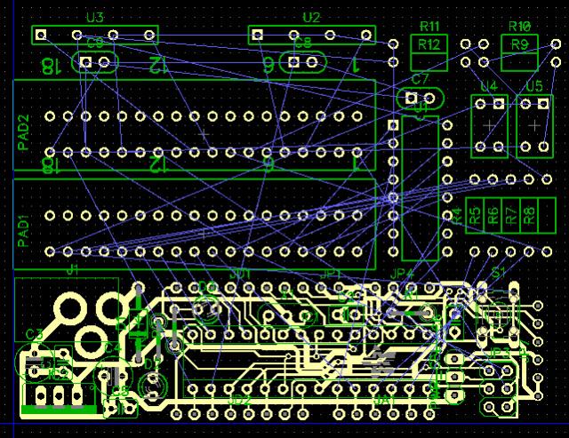

    I had a four-hour flight today, so I spent some time playing around with DipTrace trying to figure out how to integrate the Boarduino PCB into my PCB. Finally, I figured it out. First, I opened the Boarduino schematic and pasted my schematic into it, then hooked up my components to the Boarduino schematic's pins in the appropriate ways. Next, I opened the Boarduino PCB file. The key step was to select and "lock" the Boarduino PCB before doing a back-annotation to the schematic. Before, when I back-annotated to the schematic, it would erase all of the Boarduino PCB's nice, professionally-designed routing. With the Boarduino locked, all of its routing remained, and my parts were added to the board with rat-lines, so I could finish routing them. This is a good step if I ever get to a point where I want to produce the boards on a larger scale. For one thing, it wastes none of my valuable PCB space. For another thing, I can order the components of a Boarduino from Mouser (qty. 1) for about $7, whereas they cost $18 from Adafruit. $5 of that $18 is the Boarduino PCB itself, which I'll no longer need.
    Keeping the Boarduino layout is very desirable, as it includes a nice, regulated power supply, ICSP header for programming, and and all the other support miscellaneous that are needed.

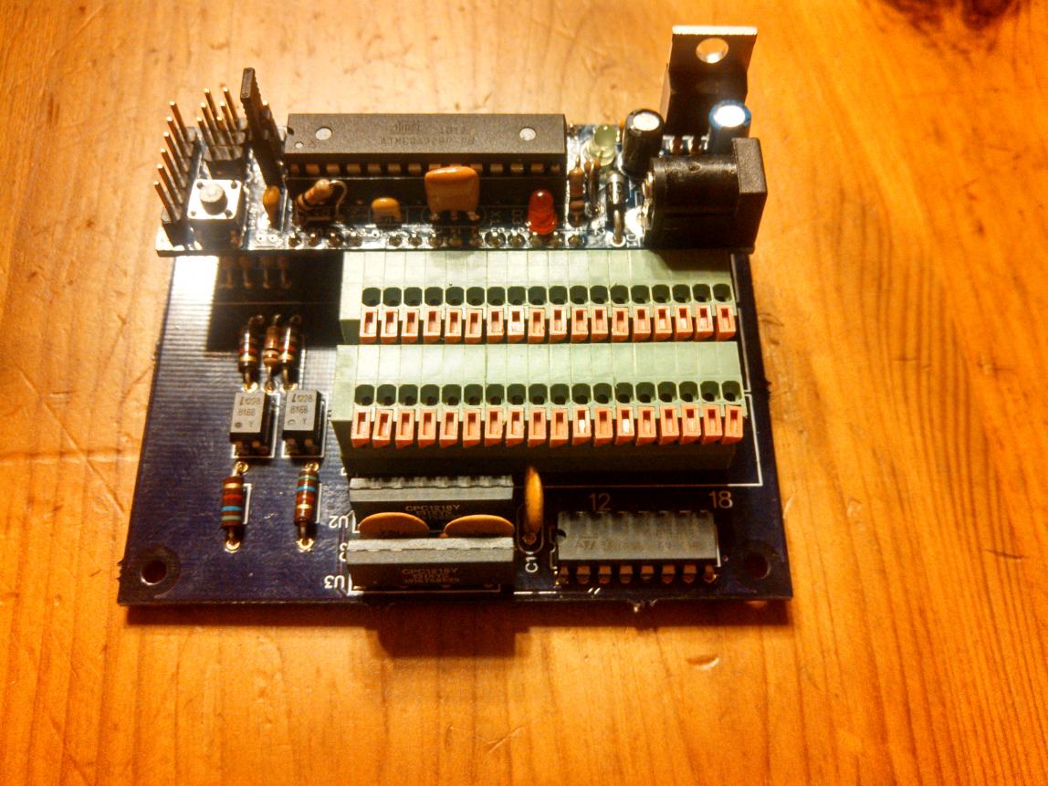

    Back from vacation. Got the PCBs in the mail. Spent a little quality soldering-iron time tonight.
Name:	2013-10-21 23.01.25.jpg
    Pretty satisfying to see the board looking all professional-like. I haven't tested it yet, as I want to get the metal enclosure set up instead of the plastic one I have been using. More to come!

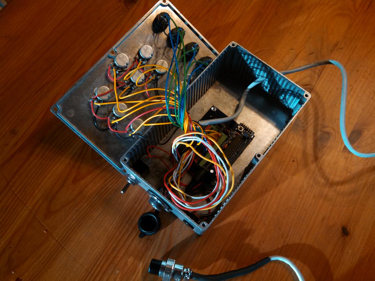

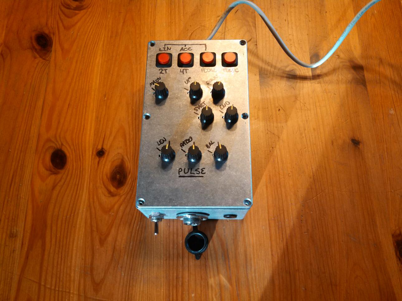

    I went to the hardware store this morning for a 5/8" hole saw. I needed a 5/8" hole to mount my buttons in the new, metal enclosure. On the plastic enclosure, I used a spade bit, but I didn't think those could be used on metal. Well, the hardware store didn't have a 5/8" hole saw, but the helpful clerk said that a spade bit could be used on aluminum no problem, so I gave it a go, and it worked okay.
    Basically, now I am back where I was 3 weeks ago, but this time with a PCB, a nice metal enclosure, properly-mounted board, spring terminals instead of solder joints that are going to break, and so on.
Name:	2013-10-26 17.29.46.jpg
Name:	2013-10-26 17.30.03.jpg
Name:	2013-10-26 17.30.21.jpg
    I have done some rudimentary checks of the PCB, and it is working fine so far. Knobs, buttons, and lights are working fine. I found that I forgot a smoothing capacitor on the PCB, but I soldered it between two of the leads so no problem there. Hopefully, that turns out to be my one mistake for this PCB.
    Once I have confirmed that the PCB is correct, I'm going to continue working to refine the interface circuit with the welder. I implemented a small change in the PCB that is supposed to improve the performance of the optocouplers a smidge over what I had with my prototype board. I also pulled the input line to the interface circuit out to one of the un-used spring terminals so that I could come up with a wholly new circuit on a daughter-board if I wanted to. I have some high-speed optocouplers that I may give a try to. I have passed them over so far because they require 4.5v minimum on the welder's side of the circuit. The welder puts out 5v to the remote when it's on 220v power, but only 2.7v when it's on 110v power, so it's possible the high-speed optocouplers wouldn't work on 110v power.

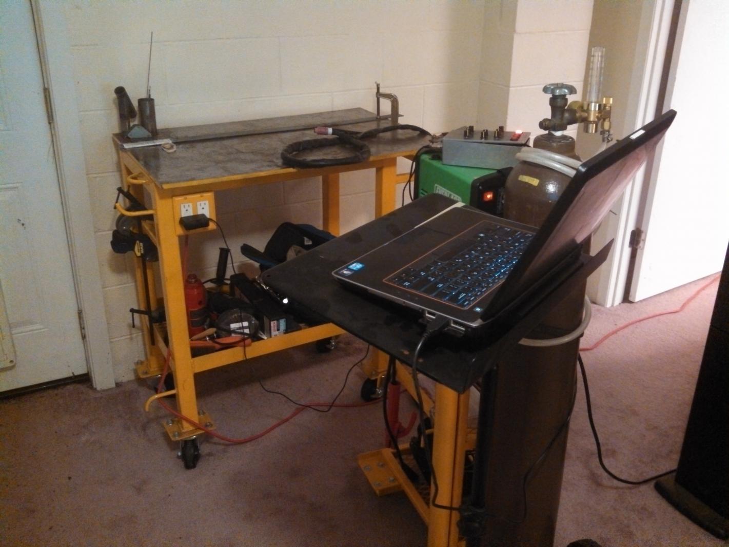

    Here's my workspace setup when debugging requires the use of the welder. Fortunately, it's TIG, and I'm really just striking a low-amperage arc on a flat plate, so I'm comfortable doing it inside.
Name:	2013-10-29 23.28.30.jpg
    I've been tempted to just set the laptop on the welding table, but the potential for disaster is just too high.
