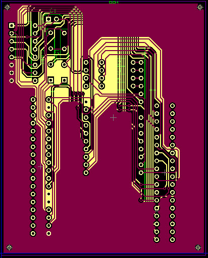

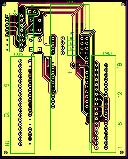

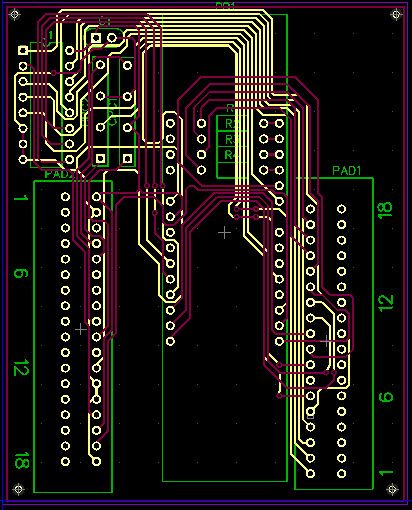

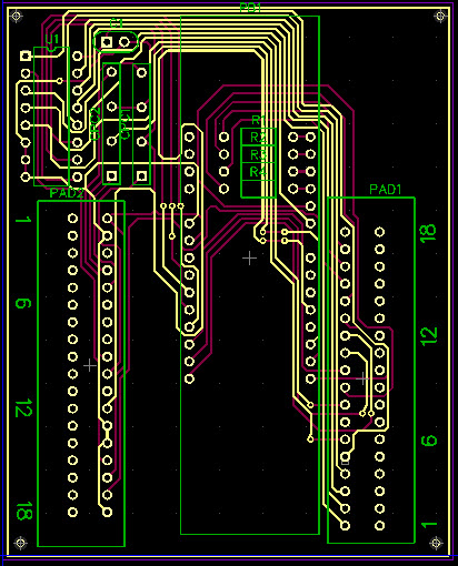

    I see what you mean about autorouters being kind of bogus. With a little practice, I think I did a much better job, although there's surely still room for improvement. I wanted to focus on keeping as much of the board as possible available to the copper pour, which is why some of the traces go out of their way when going directly would be possible.
    Top trace.
Name:	top layer.jpg
    Bottom trace.
Name:	bottom layer.jpg
    Top, with copper pour.
    Bottom, with copper pour.
    Also, I realized that, as long as I'm using the Boarduino on headers (vs. incorporating it into the PCB), the least I could do is use some of the space underneath it, so I stuck the resistors for the LEDs under there. I think that some of the remaining components, like the optoisolators, will also be low-profile enough to stick under the Boarduino if I need to.

    A question: when I designed my board, I put bypass capacitors on all the Vcc pins of my ICs--three of them, to be exact: an analog mux and two solid-state relays. When I got to PCB layout, I realized that it made sense to put those chips right next to each other, and looking at the ratsnest, I realized how dumb it seemed to have three capacitors, all within 150 mils of each other, all going from +5v to GND. I took them out and settled on just one capacitor.
    I know the rule of thumb is, "one bypass cap per Vcc pin," but does this become redundant if the Vcc pins are close enough together?
  3. #143
    It all depends on the signals involved. Typically you want the bypass caps as close to the pins as possible, say 250 to 500 mils or thereabouts. Things get crazy as the frequency goes up.
  4. #144
    ... but if I could keep them within 250-500 mils, then it's fine?
  5. #145
    The effectiveness of the caps are reduced by trace inductance. That is why it is generally preferred to use one bypass per pin. I assume you are using the bottom pour for ground. You may even want to consider using 1206 surface mount capacitors going from the vcc pins to the ground pour for best noise performance. I would also recommend adding thermal reliefs to your ground and vcc pins otherwise soldering becomes difficult on those pins since you have to heat up the entire plane. If there are any left over pins and you have room add extra connectors with signals, power and ground. Maybe one for some a/d inputs, an extra usart line, and some general purpose I/O. Copper is free!

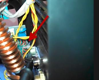

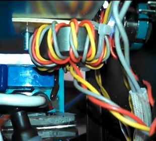

    Let's take the discussion a different direction. When I have the Box working 100% with lift-arc, then I will consider it to be basically rev 1.0, but my ultimate goal, of course, is to get it working with HF start too, and that means noise protection. One thing that I've done is buy a die-cast aluminum project box with no vent-holes or anything, to limit the amount of EMI that gets into the box. But that won't do me any good if the EMI comes into the box on wires, and of course it will. So I took the cover off my welder and looked inside.
Name:	10-2-2013 12-27-10 AM.jpg
    The photo above shows the back side of the remote jack. A pair of wires coming from the jack is routed to this board, which contains an inductor coil and two what appear to be capacitors, but they could easily be some other component in a similar form factor. I couldn't really get at the board to get a good look at them. I assume that these two wires are the torch switch, because the only other thing they could be is the remote-detect circuit, but since that circuit has no wires external to the welder, I bet it is less in need of noise protection than the torch switch, which runs alongside the welding lead.
Name:	10-2-2013 12-29-49 AM.jpg
    A bundle of three wires, which I assume to be the potentiometer connection, goes to a second coil, pictured above. This bundle doesn't appear to get its own special capacitors (or whatever)--just the coil.
    So I guess I am going to eventually want to put an inductance coil on the wires where they enter the box. It would be mighty convenient if I could simply wrap all the wires around the same toroid, but there's probably a reason why the Everlast engineers didn't do it that way. Any advice from the smart folks here is welcome, as usual.

    The noise may turn out to be a non-issue for you. The welder will have HF filtering for the control signals that need it. Your big problem will be not crashing your micro from EMI. That will be coming from the arc itself, not from the control circuit. However your control line will be acting as an antenna to catch that and bring it inside your shielding. It might take nothing more than a ferrite bead to control that, or you might need to add a different common mode choke depending on what you see. Shielded cables can help, when nothing else does, but just making sure that your enclosure is well shielded might be all you need to worry about. Large plastic switches might be something to avoid in your final design. Metal pots keep your shield integrity pretty good.
    Unless you want the kind of isolation that will let you strike an HF arc to the outside of your enclosure. That might take a lil more work.
  15. #155
    Well, yes, exactly! I tested this once, months ago, and about every third time I struck an arc with HF, the Arduino crashed and had to be reset. Of course, it wasn't inside an enclosure at the time.
    Bingo. And, of course, the torch's welding lead, and the two wires going to the torch switch that run parallel to the welding lead for 12 feet or so.
    I wonder if the shielding on the welder's end of the Box/Welder line will also protect the Box. After all, an inductor resists AC current flow, and current flow along a wire is equal, right? So then the location of the inductor on the line shouldn't matter, right?
    Naahhhh... just not having the dang thing crash while I'm using it will be fine. But I think you're right. I think I will table this issue for now and see if just the plain metal box does the trick.

    Any wires going to you circuit should be treated/considered as an antenna. I would scope them Also note the number of turns of wire on that toroid. De-coupling caps will not solve the RF issues. Also, maybe scope the AC input on the circuits PS. Did you try a Faraday cage? That was brought up many posts ago I think.
  17. #157
    I can't tell if you're saying that the exact number of turns is important, or if it's just important to have a lot of turns.
    Sure. For one thing, the signal is likely induced equally in both the signal and the return line (unless they're twisted-pair), so there's no potential difference for a cap to shunt.
    I've got an aluminum project box, but I haven't got around to installing in it yet.

    Exact number of turns. You can wind and unwine with a scope and maybe dial it in better too.
