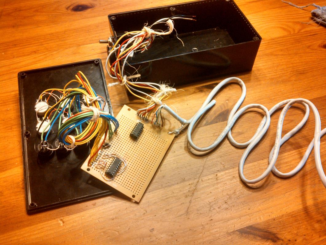

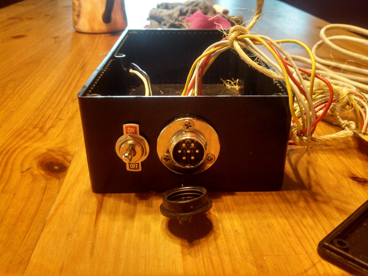

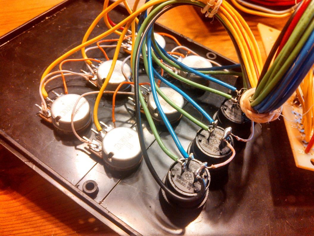

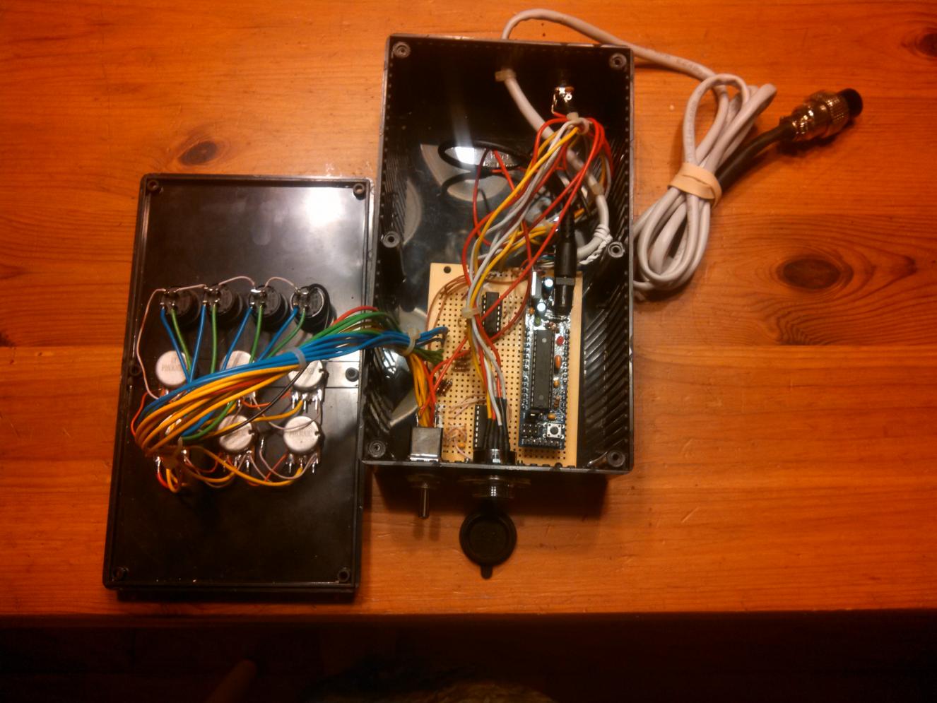

    I have been soldering like mad. Although the hardware design was not 100% complete, I got really tired of stuff falling out all over the place when I was carrying a breadboard around, so I started wiring it up to perf-board. I also ordered a Boarduino so that I could mount the Arduino on headers on the board, instead of having it be a separate component with jumper-wires connecting it to the main-board.
    Once I get all the stuff wired up, there will be a round of debugging where I shake out any mistakes I made in the wiring, followed by another round of software revision, shaking out any lingering bugs and refining any small features that I have glossed over in my desire to get to a working product. I am going to a welding workshop this weekend, and it would be really exciting to have this ready to demonstrate, but I'm not holding my breath. The Boarduino comes tomorrow, and there is every chance that I will find a show-stopping problem that I have totally missed. Even if things go smoothly, it's a lot of work to get done, but it's not out of the question.
    Here are some pics of the project in its current state.

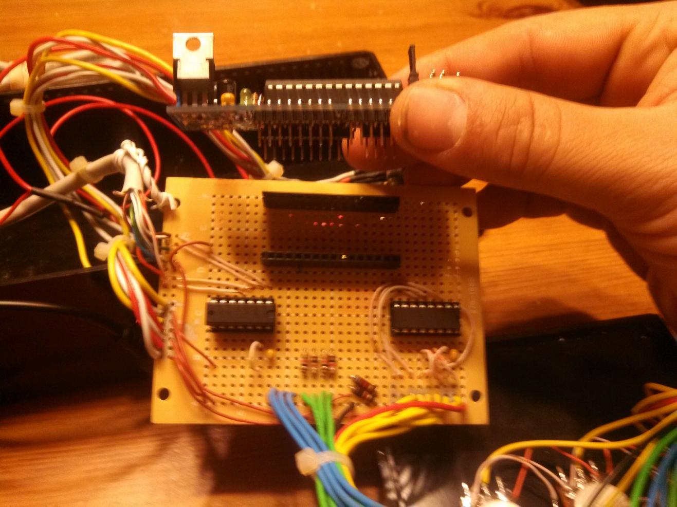

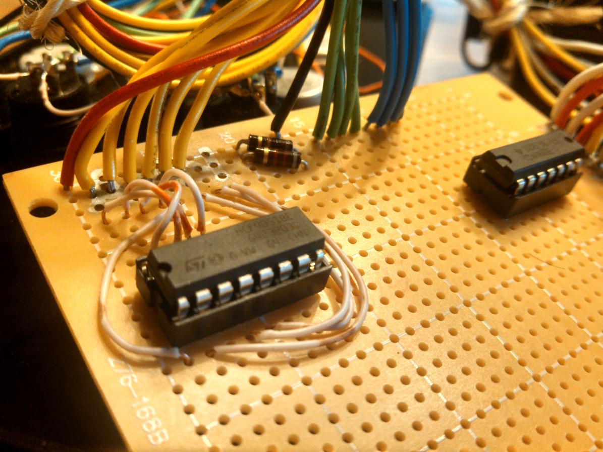

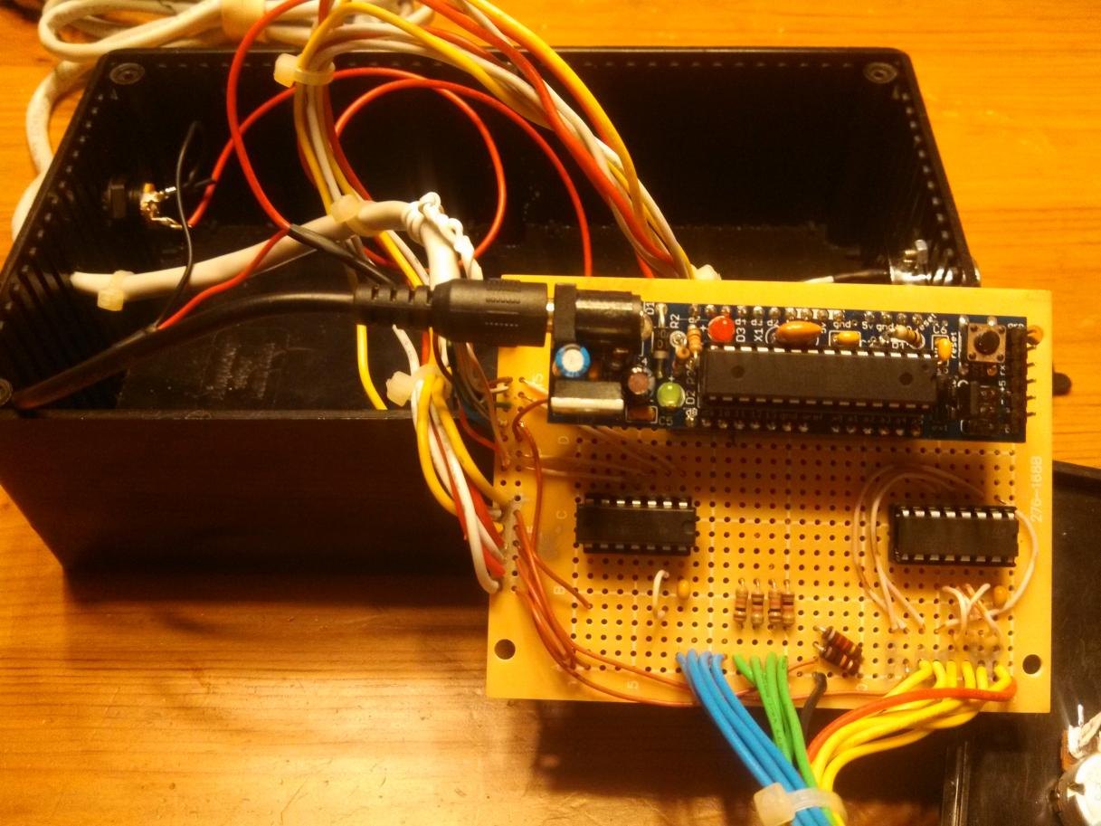

    I've got some more pictures for y'all. The Boarduino came tonight and I spent about an hour and a half soldering it all up. If you saw how many components were involved, you'd laugh. I'm a slow solderer. The other thing that came in the mail was the parts to pass the power connector through to the inside of the box. There is a panel-mount 2.1 mm barrel jack on the box that passes through to a plug on the inside. This, combined with mounting the Boarduino on headers instead of soldering directly to its PCB, allows me to remove the Boarduino if I want to, for any reason. It's a general-purpose component, so who knows? Maybe I'll want to pull it out and use it for something else. Why limit myself?
    The main thing left, on the hardware front, anyway, is to finish wiring up the connections to the Arduino. There are about 20 pins to hook up. It's the home stretch, but I'm going to put it off for tomorrow, when I'm fresh.
Name:	2013-09-13 00.50.55.jpg
    What the board might look like when mounted in the box.
Name:	2013-09-13 00.51.57.jpg
    Close-up of the mainboard. This, with the exception of about twenty trace-wires, is complete.
Name:	2013-09-13 00.52.32.jpg
    With the Boarduino removed.
Name:	2013-09-13 00.53.34.jpg
    My awesome cable. I needed a seven-connector, small-gauge, stranded cable. I spent about a week trying to figure out where I could purchase such a thing locally, before I realized that an Ethernet patch cable would do fine.
  12. #92
    Nice..
    Did you cut the power supply out of the arduino or was it already seperate?

    The decoupling cap will normally smooth a certain frequency, like 60Hz. So you might want to drop a scope on there and see what you have. I know I had a PIC problem many years about on a street bike and .1uF did solve it, but it was a shot in the dark. PICs are a little more picky (no pun) than Atmel.
    On the rheostat vs potentiometer, rheo will handle more power both do the same. reho will be wire wound and a little larger, but last longer and is tougher.

    Not sure if I understand your question. The Boarduino comes as a kit, with PCB and all parts ready to solder. It includes a basic power supply, with 2.1mm barrel jack, voltage regulator, electrolytic capacitor, and so forth. It's basically totally self-contained, including the microprocessor, power supply, input/output pins, and FTDI interface for programming. All I did was install an additional panel-mount 2.1mm barrel jack on the wall of the enclosure, and wire it to a 2.1mm plug inside the box, so that when I plug a power supply into the side of the box, it is passed through to the Arduino's jack. This approach is very versatile, since the Arduino can handle up to 20v input (although at above 12v, heat dissipation will become an issue). I can plug the Arduino into a wall, or I can plug it up to a battery pack. An option for future development would be to put a rechargeable battery inside the box and wire it up with a charge controller so when it's plugged in, it charges the battery, and when it's not plugged in, it runs off the battery.
  15. #95
    ... as expected, I ran into some hardware-related issues. I have passed pins 6 and 7 of the welder's connection into the box so that I can selectively indicate to the welder whether the box is attached or not. This way, I can power down the box if I want to, and return it to panel control, without having to disconnect the plug. These leads need to be Normally-Open, and then be Closed whenever the box is powered up. I tested an analog switch IC that I have, and with no power, the pins showed open on my multimeter. With power, they showed about 190 Ohms (which I believe to be the internal resistance of the IC, since that's present between all of its four switch-pin-pairs when they are closed). So I figured they would work perfectly, but they didn't. For some reason, even when the board is powered down, the welder detects that the device is plugged in. I am going to troubleshoot some more, just to make sure I haven't accidentally shorted a wire somewhere (I don't think so--multimeter says the pins are open), but in the mean time, I have ordered some Normally-Open optically-isolated solid-state relays. This will provide total isolation between the welder's electrical circuit and the Arduino's, and should be as close to just flipping a manually-operated switch as it comes.
  16. #96
    Do you have a manual toggle for turning the box on? Could just make it a double pole switch and connect one pole to the power for the box, and the other to make the connection to let the welder know it is active.
  18. #98
    That solution is head-smackingly obvious, and yet I totally missed it. Never would have thought of handling the situation that way. Good suggestion. I'm still going to try solving it with the equipment I have on hand (vs. buying another power switch), but it'll be my fallback. The current suggestion that I'm going to test is whether a pulldown resistor will make the switch work properly. I didn't realize that analog switch ICs were leaky (vs. a relay, for example), and that may be the cause of my issue.
