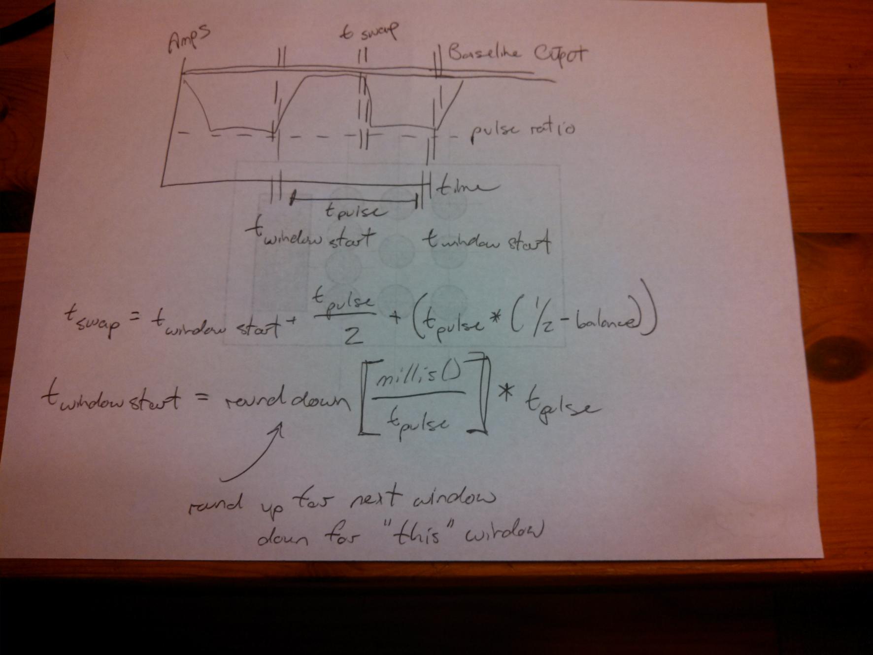

    I sat down tonight and started working on the code that manipulates the welder's output when actually welding. If pulse was ignored, this would be pretty straightforward, but with pulse in the picture, it gets a lot more complicated. Certainly, one way to handle it would be to write separate routines--one for welding with pulse and one for welding without--but that gets pretty complicated pretty fast. One for pulse in 2T; one for pulse in 4T; one for pulse with pedal control. Etc... I wanted to come up with a single routine that handled welding output, regardless of other parameters. It's absolutely possible to come up with a Grand Unified Algorithm of welder output, and to then create cases like plain old 2T by setting some parameters to zero and having them drop out.
    I think I made a big leap towards cracking it with this information--the Rosetta Stone of coding pulse, at least for me.

    Looks really good there. There are a lot of conditions for you to deal with. However, if you really want to spin your head around a few times I have a welder for you to emulate. It adds optional pulsing settings during up and down slope, up slope and main pulsing delay timers, post heat time, main weld time, auto stitch repeat timer, and some automated frequency tweaks that require a module that I don't have.
    Have fun!
  20. #60
    Thanks... my head is spinning enough already. I just finished getting the code written, compiled, uploaded, and... of course it didn't work. But I'm going to call it a night and save debugging for tomorrow. At least I got the design part done. Also, I have a bad connection to one of my pots that I have to sort out.
    Once I get the main welding algorithm debugged, which will include the pulse functionality, that will actually be a huge step towards completing the unit. I still need to do some tweaking on the user interface (lighting up LEDs when buttons are pressed); I still need to implement the multiplexer chip so that I can actually read all the inputs at once; and I would like to try out the "transistor plus fixed resistor equals digital pot" trick to see if it works. Short of wiring everything up and putting it in a box, those are the last main steps until I have something that I can call an alpha product. All in all, not bad for... what is it, a week's work?
