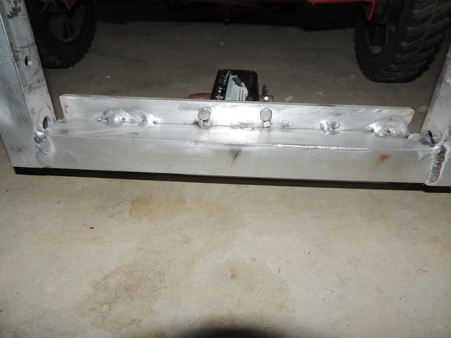

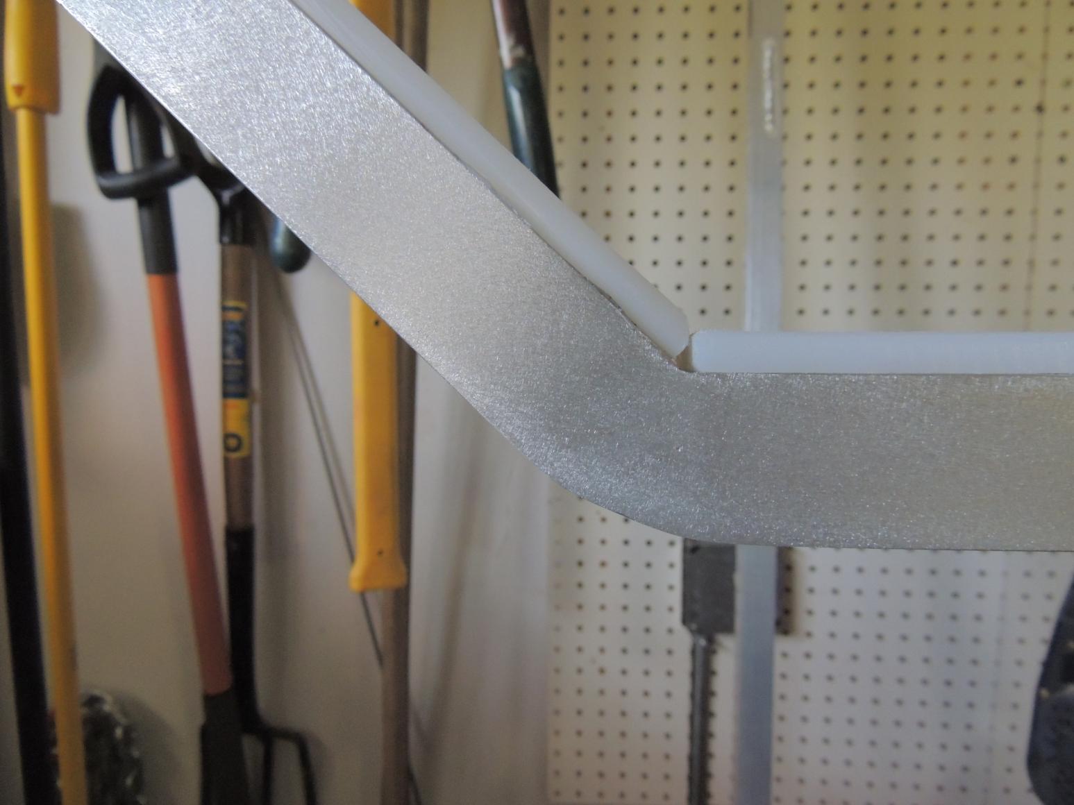

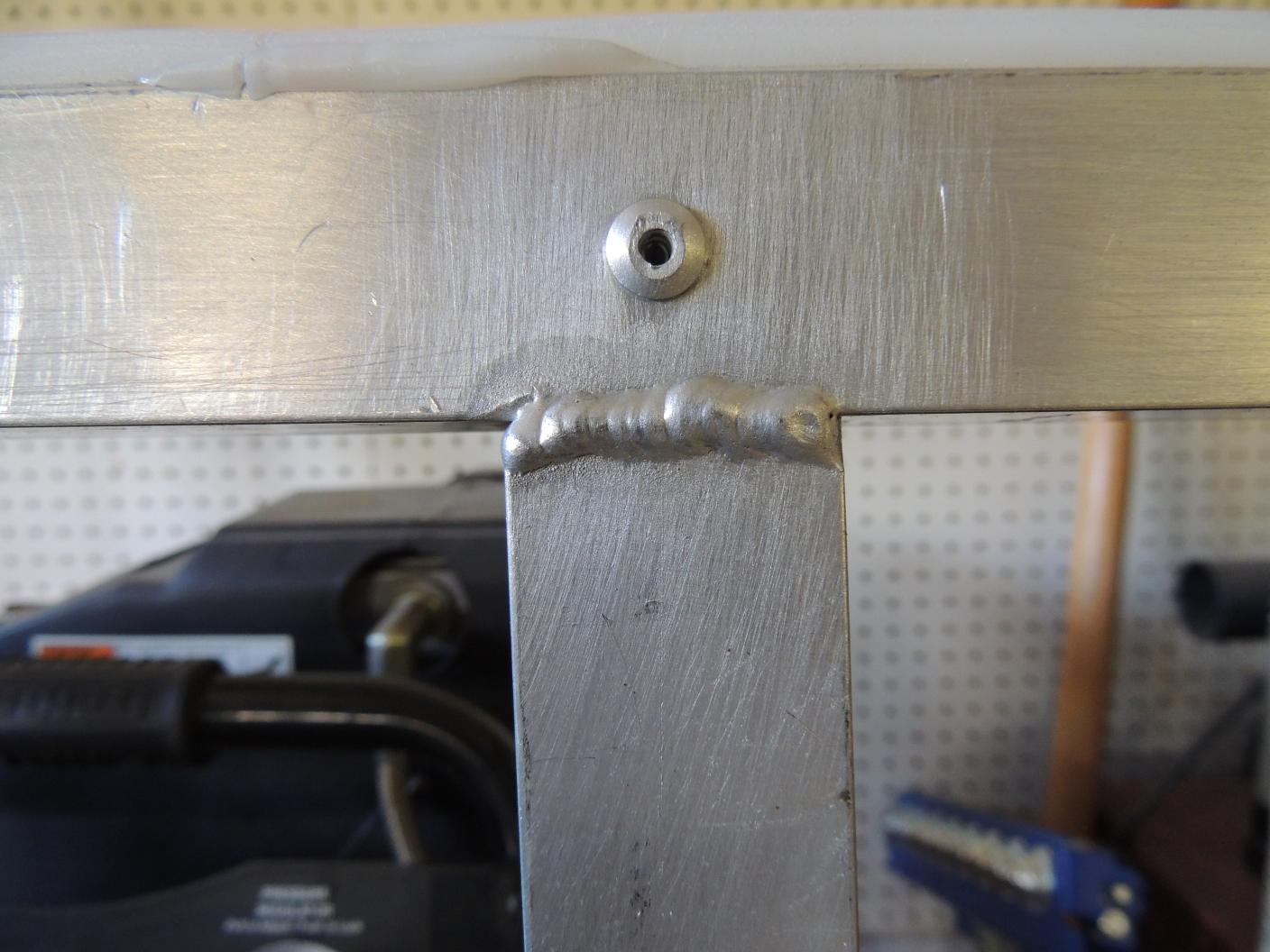

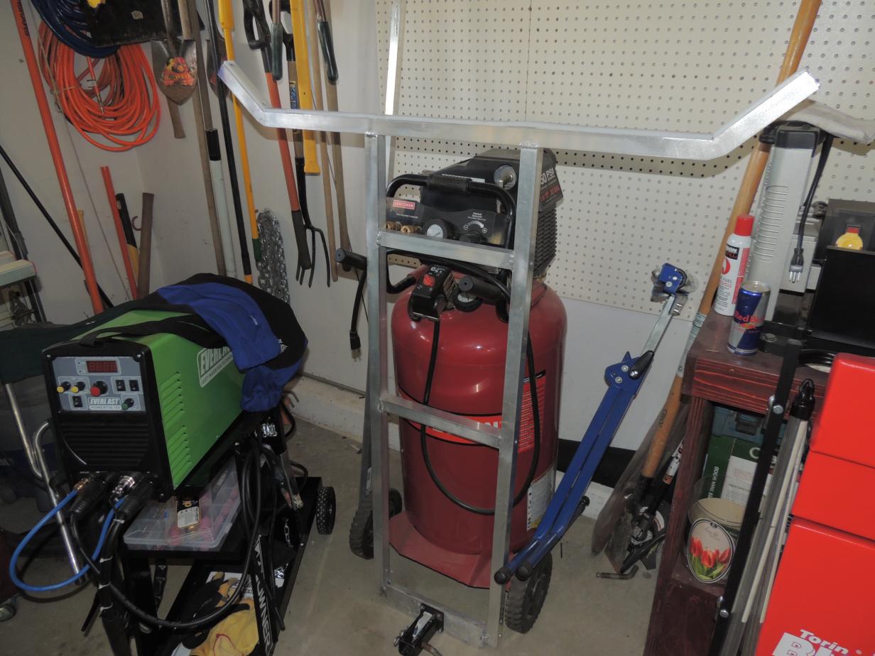

    Just went and installed the other argon valve and same issue. I ended up pulling the dial indicator out and the orifice was filled with piped dope. After cleaning with alcohol and a piece of monofilament fishing line, it works just fine. As far as projects, I'm working on a T loader for my trailer hitch to make loading my kayak a one man job. After that most likely an extendable roller rack to replace the T loader. Both will be made out of aluminum to keep the weight down.
    I have a lot of practice ahead of me, especially joining the thicker to thinner materials like above.

    I picked up some HDPE cutting boards ($1.99) and used pop rivets to fasten them on the top edge to keep the sharp edges away from the kayak. I have a 12' Hobie Pro Angler which is nice and heavy. The next time I use it I'll post a few pictures. It's generally used on a Grand Cherokee with a 3" lift, so any help getting it up there is greatly appreciated. The first yak I had was a Trident 15 from Ocean kayak, I think it was just about as long as the Jeep.

    Great first project, Chris! Glad to hear your were able to get the machine working and put Everlast technical support to the test with positive result. It's nice to see someone actually work at getting their machine going instead of sending it back and complaining about Everlast products. You gave them and the machine a chance, and they came through for you! I keep looking at the 185 myself, but I think I want the extra 15 amps (plus pulse settings) of the 200DX.
