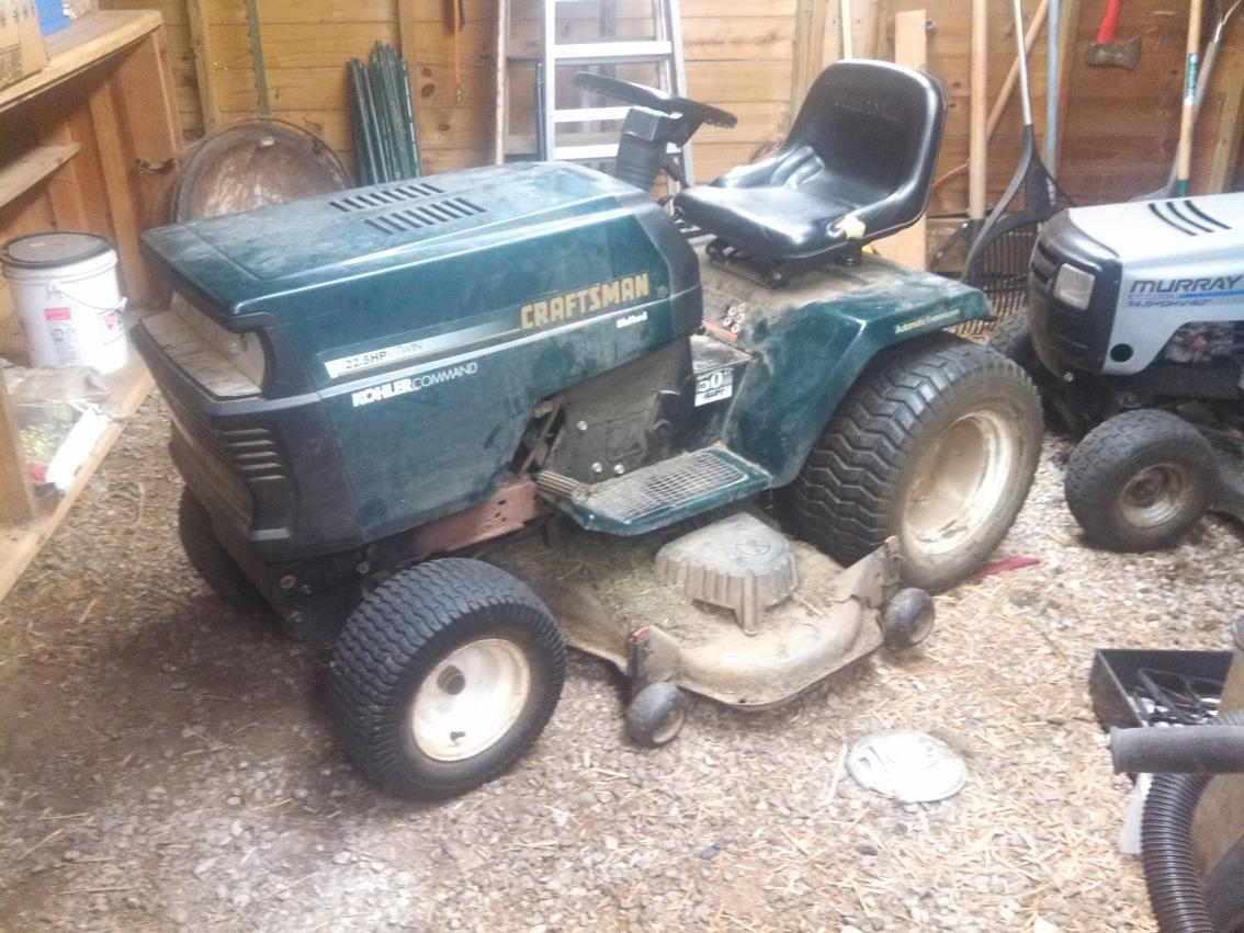

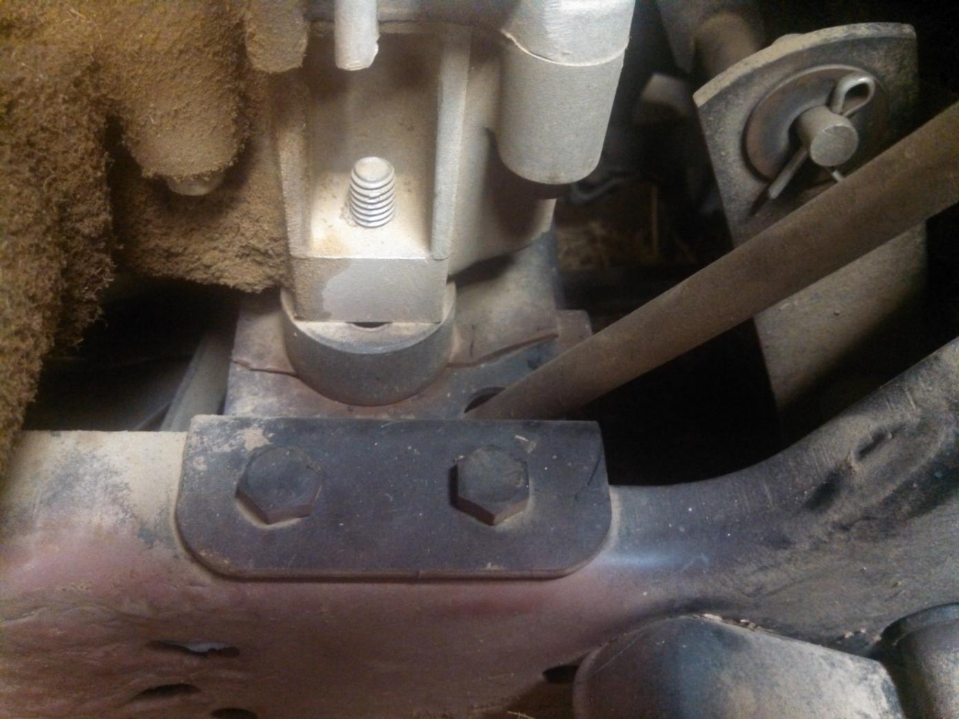

    My neighbor gave me his 15-year-old Craftsman riding mower because the frame and motor mount cracked, and he knows I weld. He said he got plenty of use out of it and wants to upgrade to a new Deere, and he's glad for me to have it.
    The mower. It's a step up from my current 14.5 HP, 42" cut. It's showing its age (lift arms wallowed out, deck a bit beat up), but the fundamentals (engine and transmission) seem sound. If I can get it cleaned up, it'll be a great replacement.

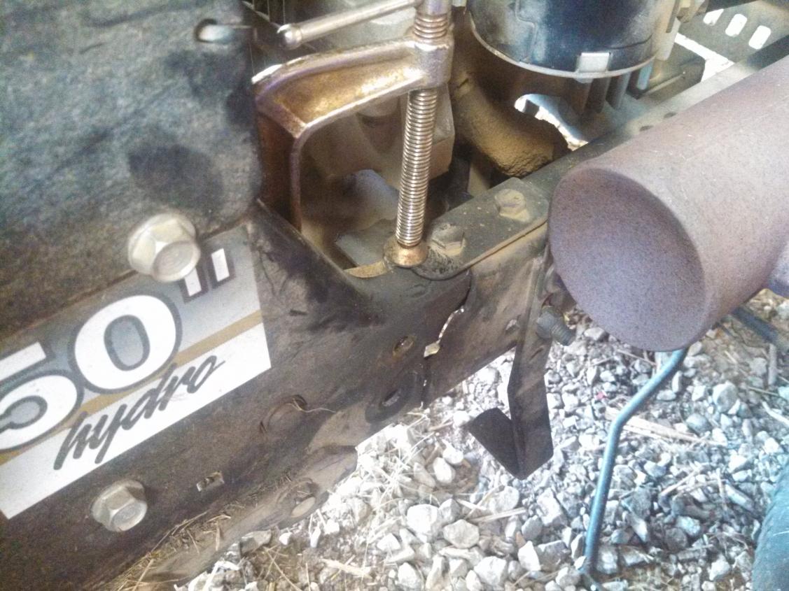

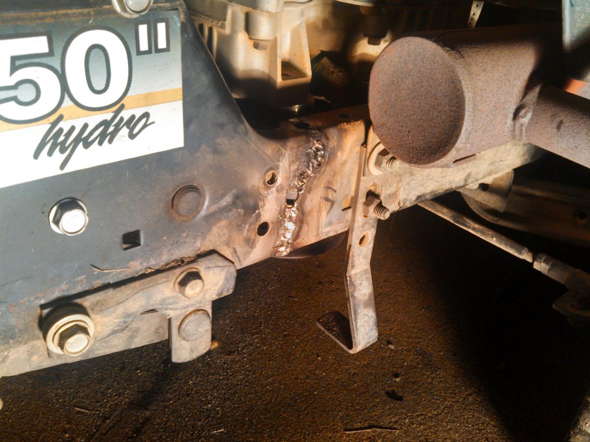

    The frame is cracked and the rear motor mount is broken in two places, likely because of torsion due to the broken frame.

    Ground out and tacked up. 3/32" E6011 at about 75 amps.
    Welded up.

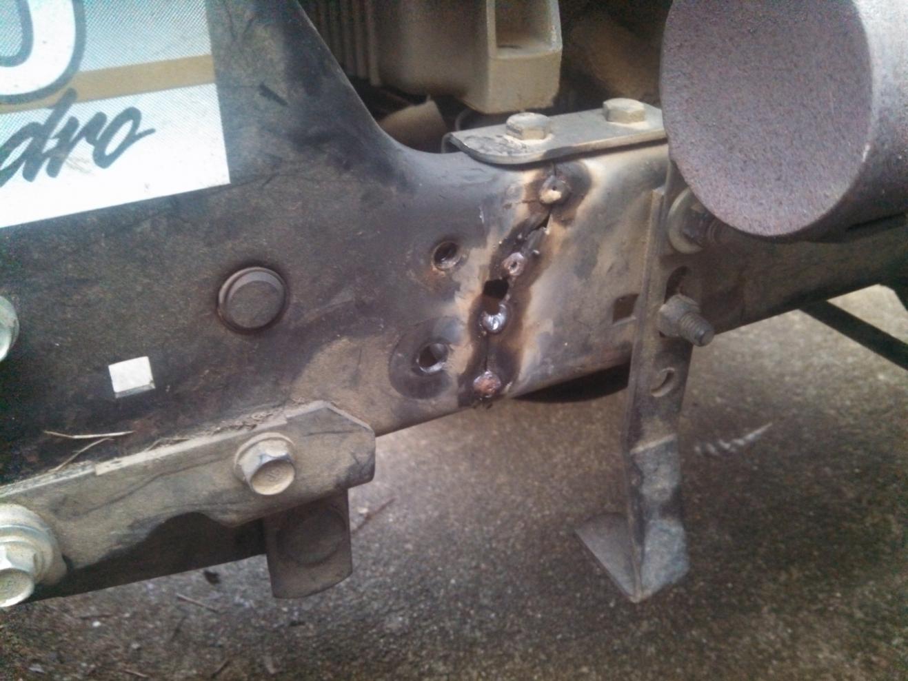

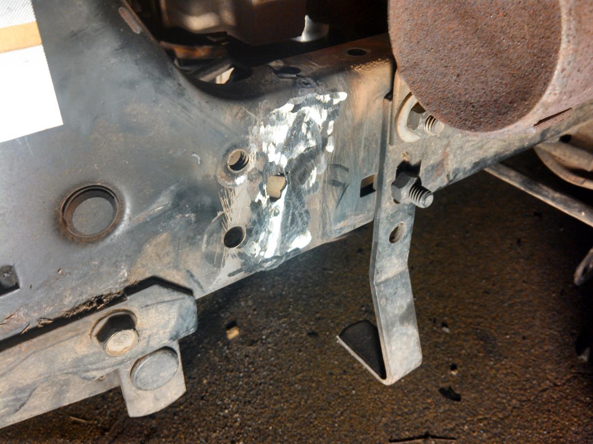

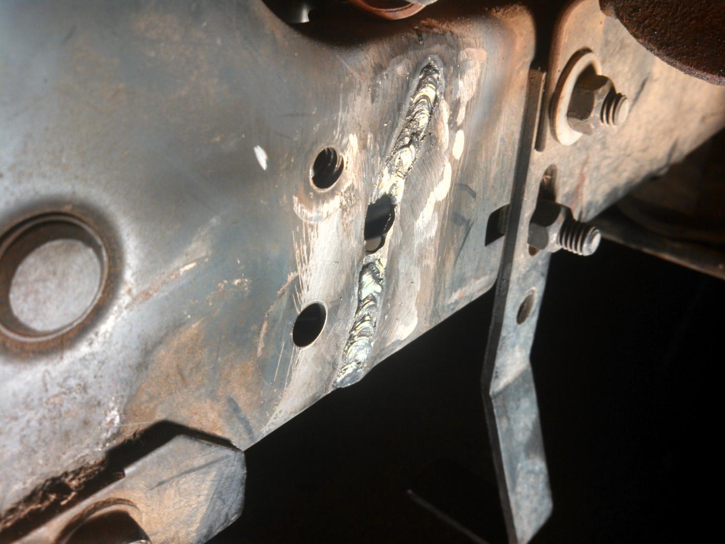

    What a mess. I stink at vertical up, and doing it kneeling and bent over doesn't help. I did my best to at least get full penetration by watching the joint keyhole. I checked from the back side after it was all over and I did get full penetration for most of the joint, but boy is it ugly. No need to pick on me. I'll pick on myself!
    So let's just grind that mess away. At least there wasn't a lot of porosity and/or slag inclusion. Just a bit at the end where I tried to fill my crater.

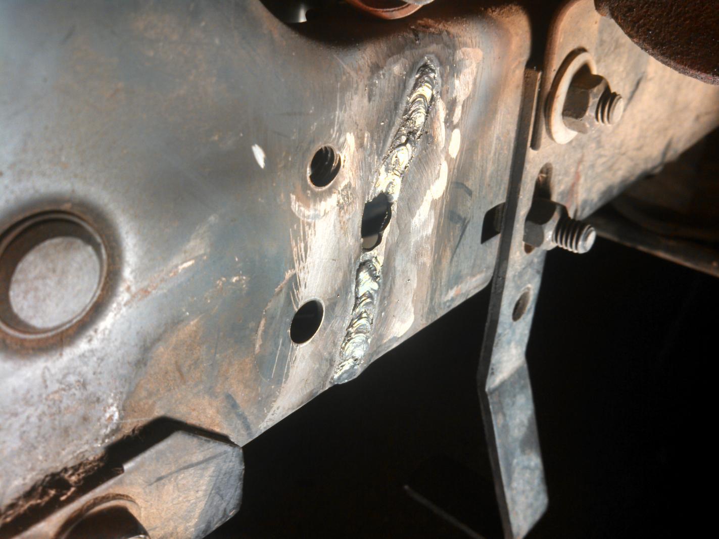

    Oh, that's much better. But I could still see a bit of the crack, so I put another pass in.
    Well, that's not the worst weld I've ever seen, anyway. I ran this one vertical down, which I found to be a little easier than vertical up. But maybe it was just because I wasn't trying to fill a 3/32" gap anymore. BTW, I did round the corner and weld the top and bottom of the frame. It's only the last bead that was only on the side.

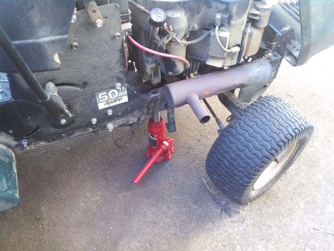

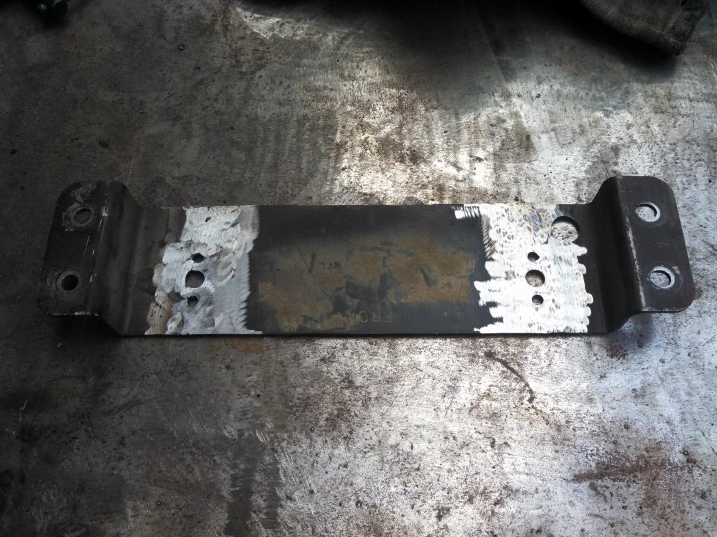

    I didn't want to have to pull the motor off the mower, so I jacked it up from underneath and slid the motor mount out. Welding it up was a piece of cake.
    Unfortunately, I forgot to take a before picture, so you'll have to take my word that it was in three pieces!

    Good for you,,,nice repair job,,,always like to see people doing that kinda stuff,,,turning someones junk into a thing of beauty,,You could add a fishplate on the frame to strengthen it if you feel it is a high stress area..
    You know, I put some thought into that. Part of what complicates it is that a foot-rest (to keep you from kicking the hot muffler) and foot-board bolt on near there, so it's got to be flush. But that could be worked around. I thought about putting a reinforcing plate on the back side, then drilling holes in the frame and plug-welding the plate before grinding smooth. I was considering all these options, and somebody said to me, "It's a mower, not a race car. Weld it up and run it. If it cracks again, weld it up again." That made a lot of sense, and I ran with it.
    Amazing,,,backside reinforcing plate and plug welds,,my thoughts exactly,,,great minds think alike...

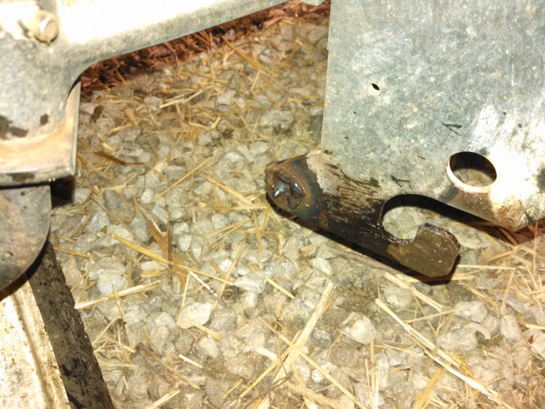

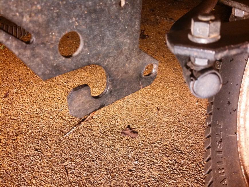

    The above pic shows the wallowed-out mounting hole for the front lift arms. I was kind of 50/50 on whether to just weld up the hole, grind it smooth, and drill it out again, or whether to cut off the tab and fab up a new one. I went with welding up the hole, because I figured that way, most of my bad weld would end up getting drilled out again anyway. I even used the opportunity to burn up some old 3/32" 7018 that run really bad. At first, I started trying to build from the bottom up, figuring the shelf I was building would help the next bead lay in well, but it actually worked better going from the top down. The molten metal would sag and fill the hole better than when I was working bottom-up. Also, I ran DCEN for less penetration and faster fill on the relatively thin metal.

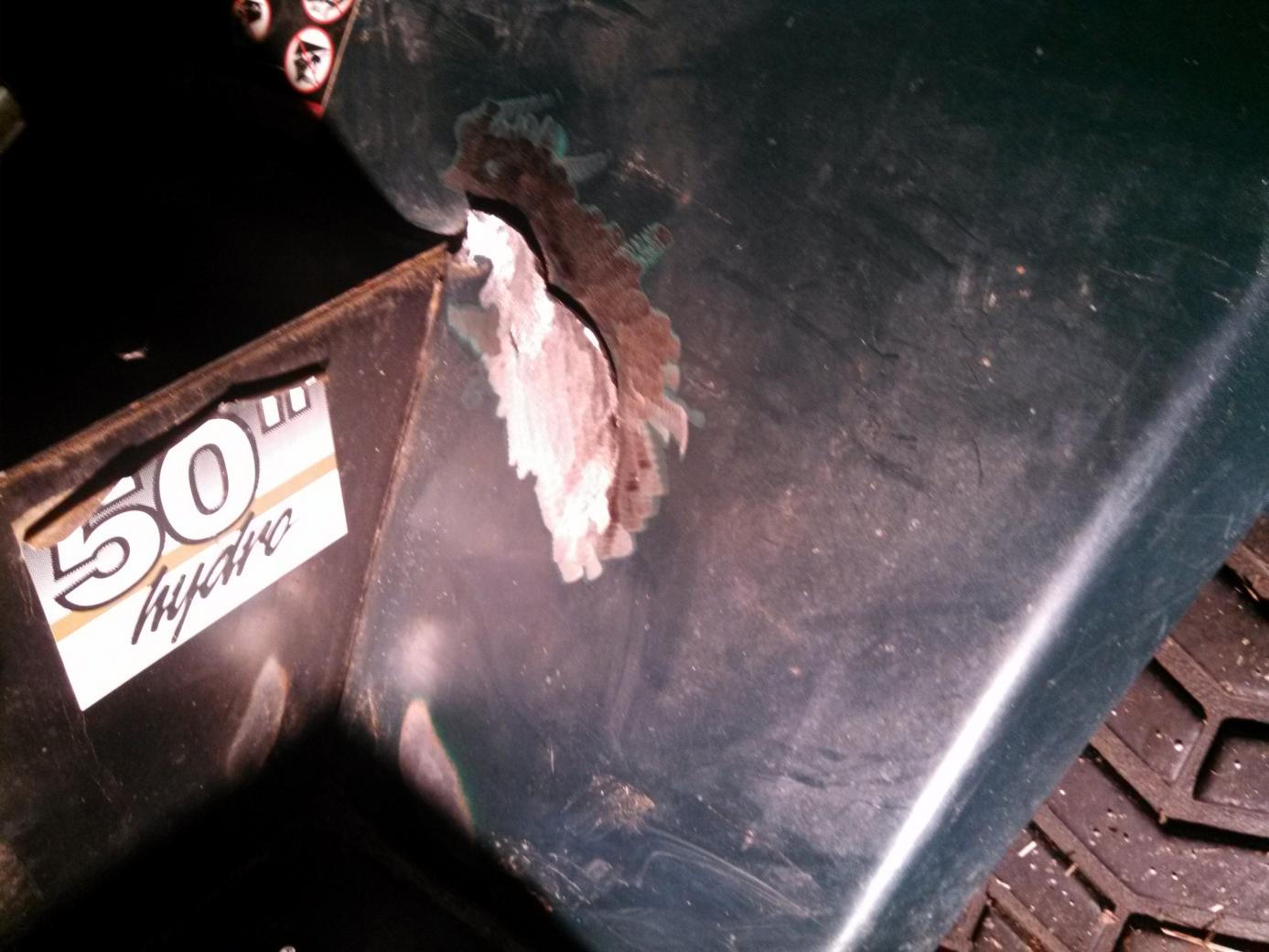

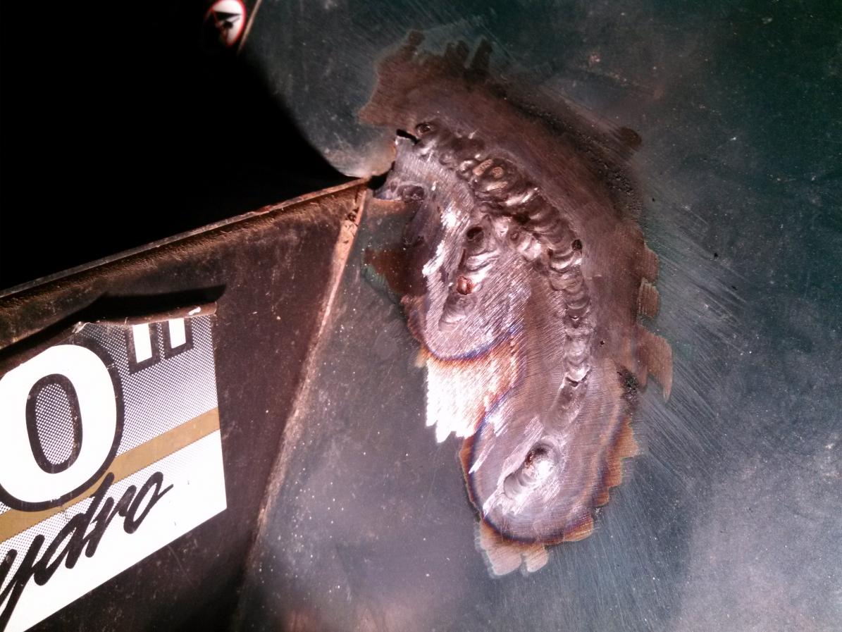

    I also discovered a nice crack in the sheet metal of the fender. Now this is a job I would never attack with stick, although I might-could get it done if I had to. But this is tailor-made for TIG. Except that there is that huge gap, which is hardly ideal for TIG, but I can make it work. I tried to think of ways to jam the crack back together, but I don't have a clamp with a throat that deep, and so in the end, I just left it the way it was and filled up the hole with weld metal.
Name:	2013-08-21 23.43.42.jpg
    The result. The part that looks like a hole is actually a piece of contamination that floated up.
