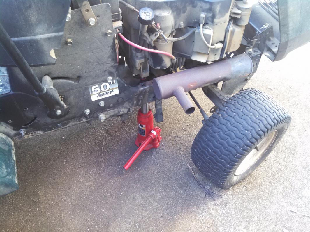

I didn't want to have to pull the motor off the mower, so I jacked it up from underneath and slid the motor mount out. Welding it up was a piece of cake.
Unfortunately, I forgot to take a before picture, so you'll have to take my word that it was in three pieces!
