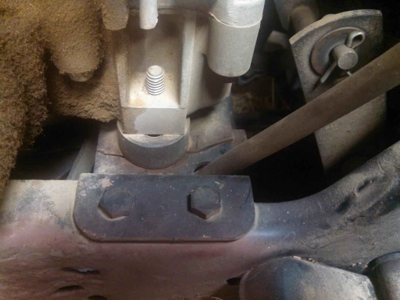

    My neighbor gave me his 15-year-old Craftsman riding mower because the frame and motor mount cracked, and he knows I weld. He said he got plenty of use out of it and wants to upgrade to a new Deere, and he's glad for me to have it.

    The mower. It's a step up from my current 14.5 HP, 42" cut. It's showing its age (lift arms wallowed out, deck a bit beat up), but the fundamentals (engine and transmission) seem sound. If I can get it cleaned up, it'll be a great replacement.
    The frame is cracked and the rear motor mount is broken in two places, likely because of torsion due to the broken frame.

    Ground out and tacked up. 3/32" E6011 at about 75 amps.

    What a mess. I stink at vertical up, and doing it kneeling and bent over doesn't help. I did my best to at least get full penetration by watching the joint keyhole. I checked from the back side after it was all over and I did get full penetration for most of the joint, but boy is it ugly. No need to pick on me. I'll pick on myself!
    So let's just grind that mess away. At least there wasn't a lot of porosity and/or slag inclusion. Just a bit at the end where I tried to fill my crater.

    Oh, that's much better. But I could still see a bit of the crack, so I put another pass in.

    Well, that's not the worst weld I've ever seen, anyway. I ran this one vertical down, which I found to be a little easier than vertical up. But maybe it was just because I wasn't trying to fill a 3/32" gap anymore. BTW, I did round the corner and weld the top and bottom of the frame. It's only the last bead that was only on the side.

    I didn't want to have to pull the motor off the mower, so I jacked it up from underneath and slid the motor mount out. Welding it up was a piece of cake.

    Unfortunately, I forgot to take a before picture, so you'll have to take my word that it was in three pieces!
    I have a little maintenance to do like replacing the wallowed-out lift arms and repairing the wallowed-out holes where the front of the deck attaches, as well as fixing some cracks in the deck, but things are looking good!
    It's hard to beat free... keep it under 30 mph and don't jump any hills and it should last a long time.
