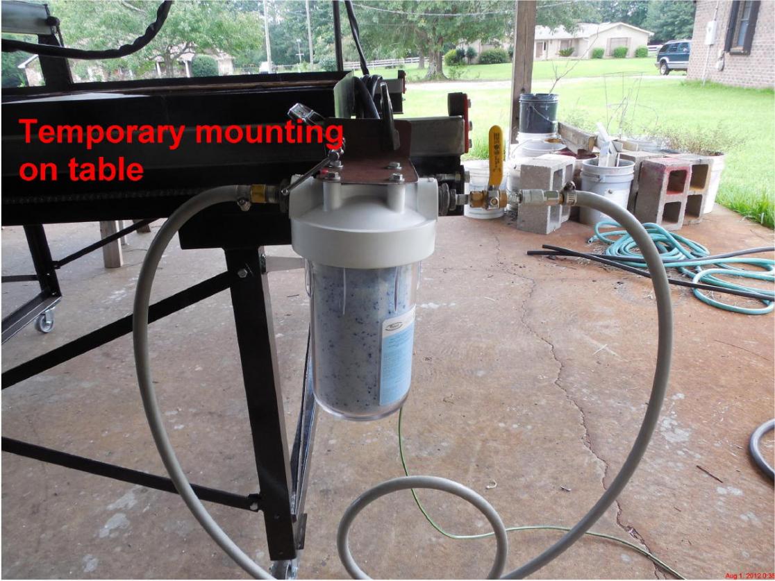

    Here is one I built for my table. I bought the large water filter from Lowe's and modified it with aluminum screen both input and output ports. I reversed directions of the air flow as I wanted to have a tube going to the bottom of the Silica Gel (MIMI cat litter from Wal-Mart) one bag will fill the filter $4.00.
    How much pressure can it take ?
    2,661
    From the photo it looks like the Whirlpool model WHKF-DWHBB which is rated to 100 psi.
    Thanks, I just might try one of those.
