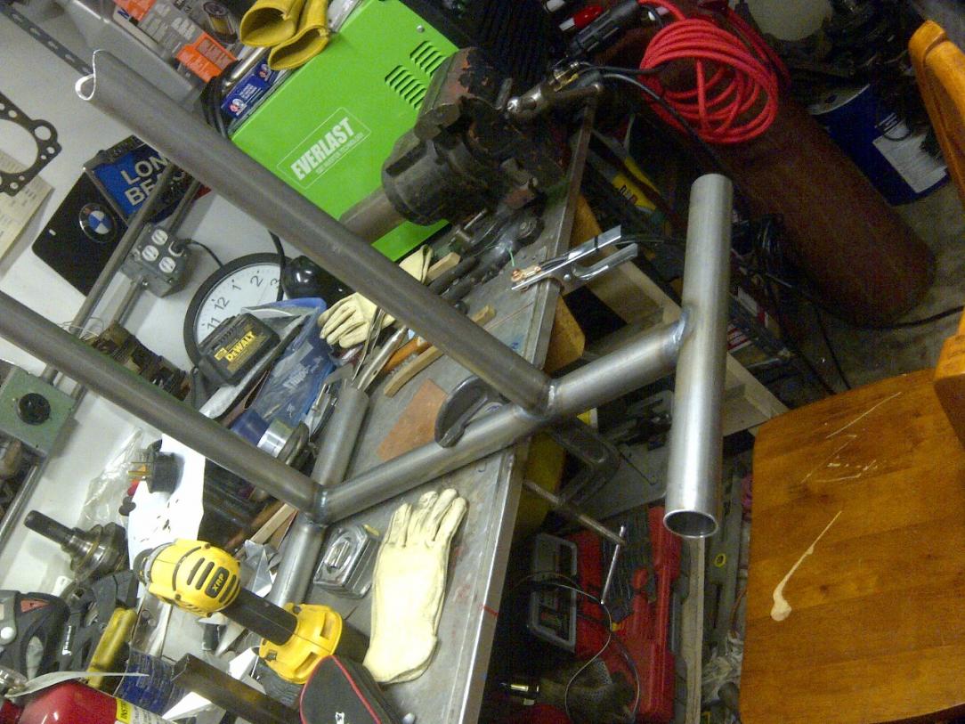

    Inspired by some of the 4x6 bandsaw stands here, I fabbed my own out of some short sections of tubing I've had laying around for a while.
    The design was mostly driven by the length of the pieces I had since this was a recycling project. I've had this saw for about 15years and never understood the supplied stand design. Seems like they were trying to take a "good" tool and make it "tolerable."

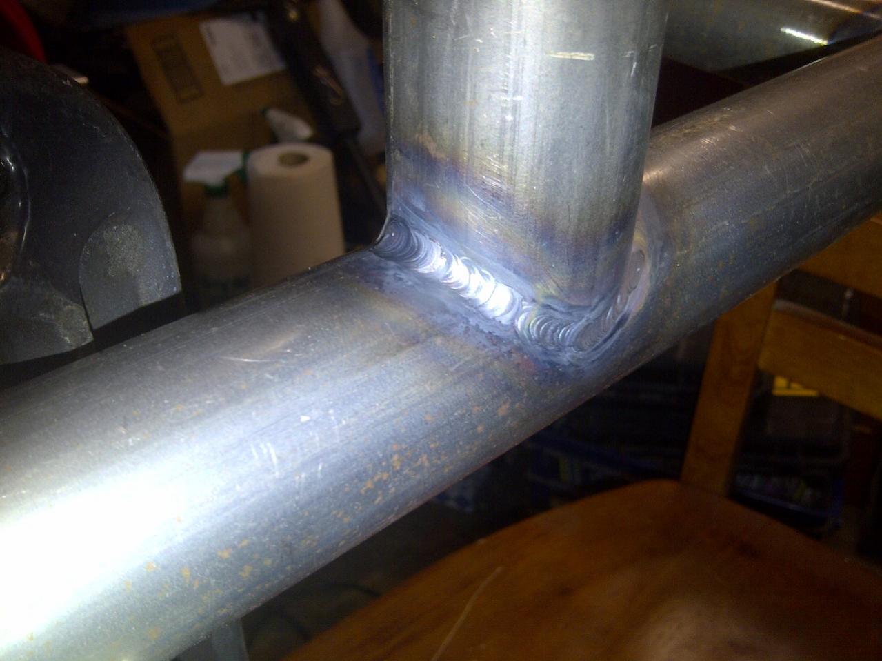

    Once I had it mocked up on the floor, I started looking at wheel sizes and opted for some thread-in casters.

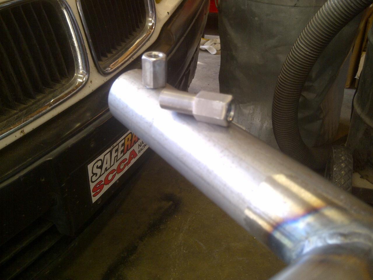

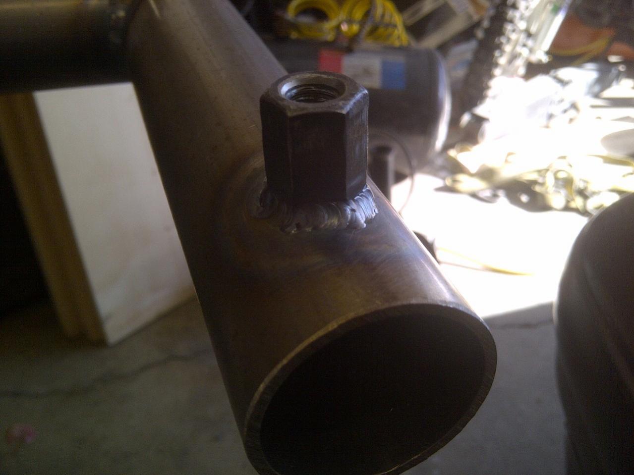

    I used some 3/8"-16 all-thread couplers, turned them down and placed them in drilled holes at the bottom tube.

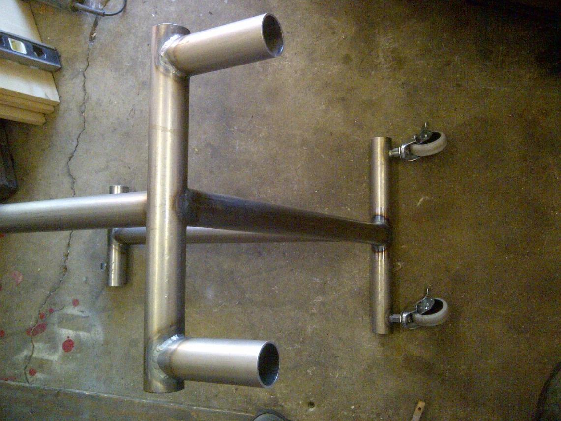

    The other end has some short pieces of tube welded on to keep it level.

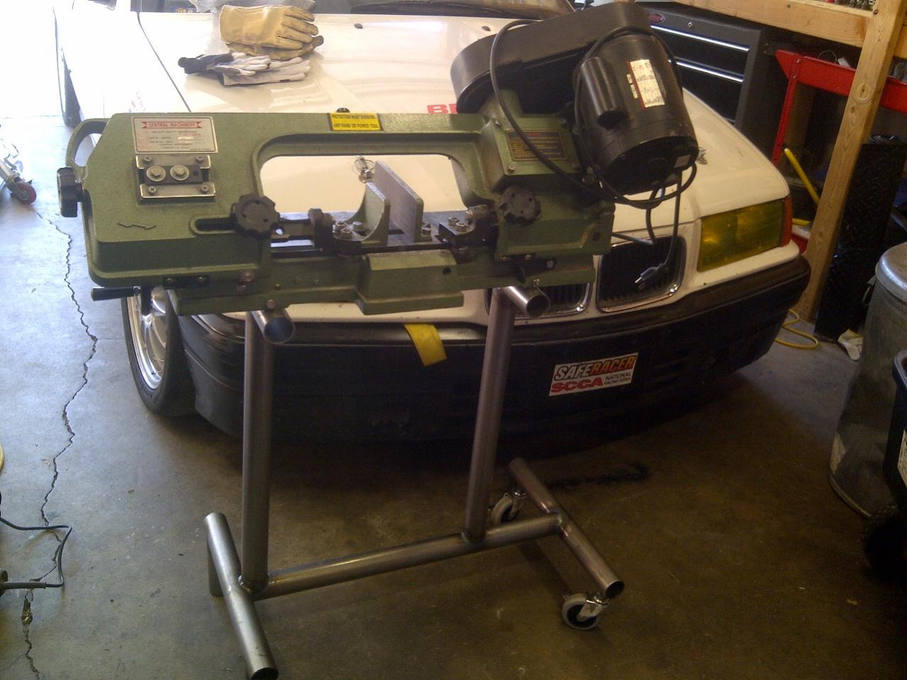

    Here's the final product. Much easier to use with the height raised up above knee-level and I can now roll it around the garage rather than dragging it on the flimsy wheels it came with. The wheels have a little too much caster and can make moving it around in the vertical position a little wobbly.

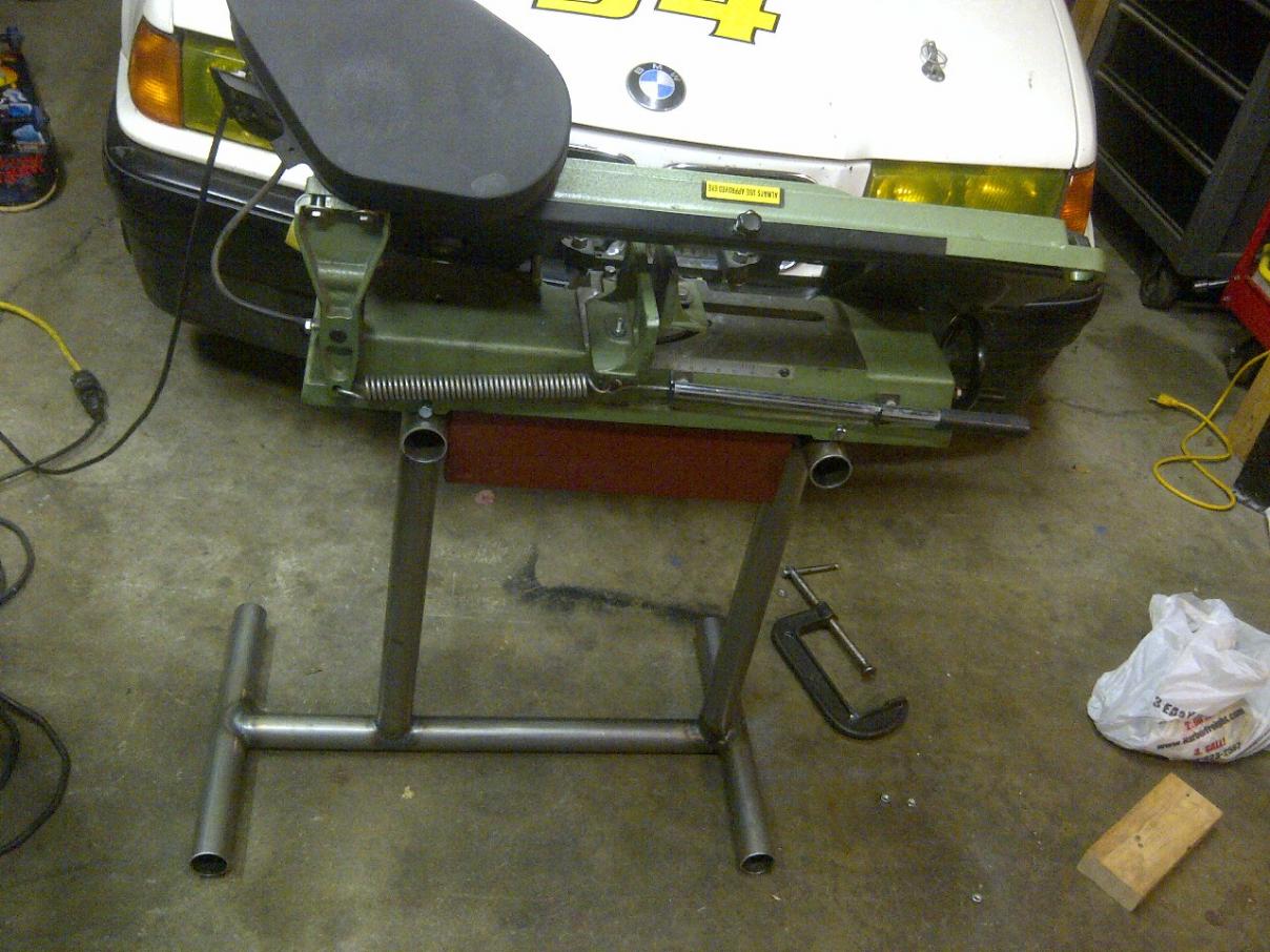

    Nice looking welds and a cool stand. How is the saw mounted to the stand? Are the swivel casters by design, or something recycled? I used to have a similar stand for something else and the casters always seemed to have a mind of their own until I tack welded them so they didn't swivel anymore.
    What did you use for coping the tubes? I would build a lot more things out of round tubing if I knew an easy way to cope (without having to buy another piece of equipment, naturally). I use square tubing for most stuff. I like the idea about the thread-in casters. I always use the bolt-on ones, but mostly because I assumed I would need a tap and die set to create threads.

    Thanks. The casters were a Home Depot item. They have brakes, but in hindsight, catering probably wasn't necessary. It just makes it easier to push it up against a wall when not in use.
    I have an adjustable notcher but since these were all 90's, I just used the drill press. I also have a small belt sander with an upper roller that is just the right size for cleaning up 1.75" tubing. I actually broke the 3/8 stem off my holesaw arbor doing this and ended up finishing the last few with the lathe.
    I didn't have to tap any holes since I started with a threaded coupler. Welding on a couple of nuts would work too.
