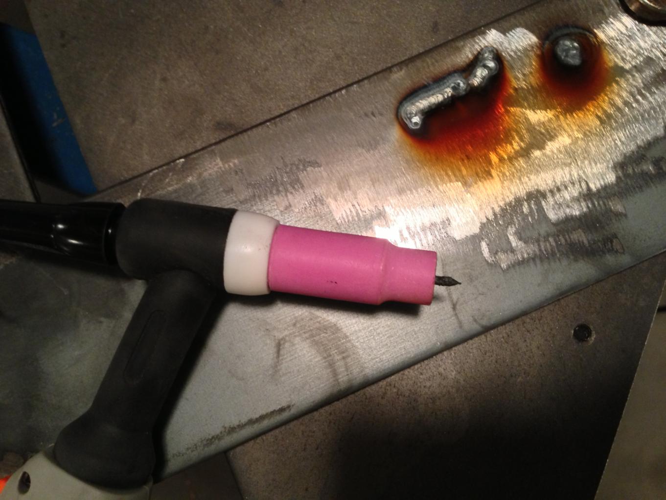

    Here are a couple pics of the setup. The tungsten electrode has some blackish "hair" on it.

    By any chance, did you touch the molten puddle with the tungsten? You would see a greenish flash and get results that look like that. You need to grind your tungsten clean after any steel contamination.

    Anything is possible, but it is pretty rare to get bad gas. First I would check over your torch for air leaks, especially around the back cap o-ring. That can suck air into your argon stream. TIG does take some practice. Acetone is kinda over the top for steel, but if you are not sure about any oil or grease it can't hurt to wipe it down. Remember to re grind your tungsten any time you contaminate it. Also keep your torch angle as close to 90° as you can. Also hold the torch still at the end of the weld while the post flow is going, to shield the end of the weld while it cools.
    Contaminated or not, that electrode is ready to be ground! Grind 'em on both ends so you can weld twice as long--but be careful. If it balls up on one end and you pull it out the front of the torch, then stick it back in and it balls up the other end, you can't get it out without cutting it.

    Here's how it went:
    1.) ground tungsten and kept all previous HW/settings the same (3/32" tung, 10+ LPM AR flow, and #6 cup) ==> major arc instability and brown ugly contamination
    2.) raised/lowered AR flow rate (and finally read manual). Ended up at 5 LPM flow rate (for steel). Major arc instability went away but still had brown ugliness and arc was still not totally "right". i.e. arc wass somewhat spitty
    3.) As a WAG I changed the ceramic cup from the #6 I was using to a #5: ===> Super stable arc now and NO brown ugliness. Yehaaaaaaaa!

    Yes, 100% Ar. What I'm thinking now is that there was major turbulence in the cup which caused the arc instability and 'brown soot' contamination.

    Sounds like the #6 cup wasn't seated correctly and let air mix with your gas. Too much gas flow can cause turbulence and draw air into the gas stream also, 6 - 9 lpm is the range you'll use most.

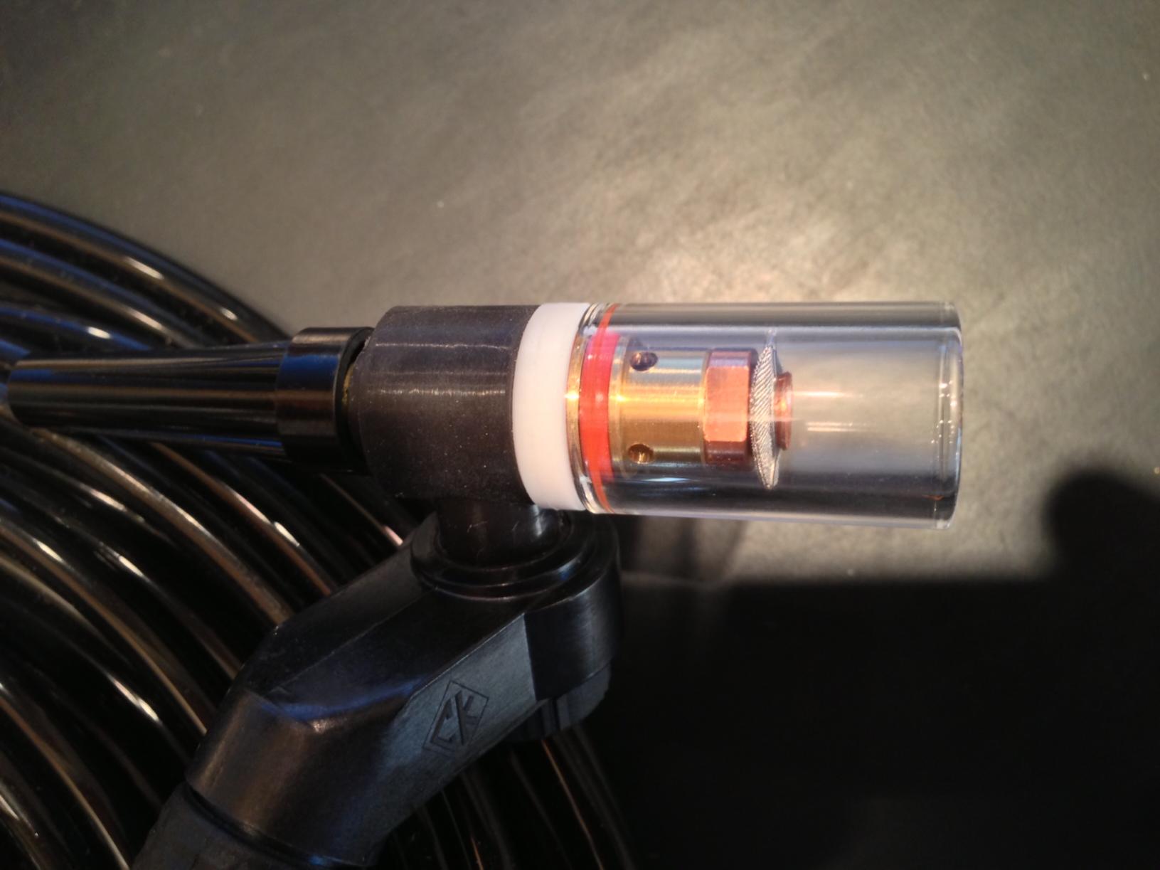

    I use a "gas lens" on mine most of teh time. It has a screen diffuser inside to increase gas coverage.
    From what I've read that's a good way to minimize gas turbulence. I'm in the process of collecting parts for a CK water cooled torch with the "gas saver" screen diffuser.
    Here's a pic of the pyrex cup with the screen diffuser installed.
