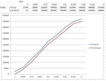

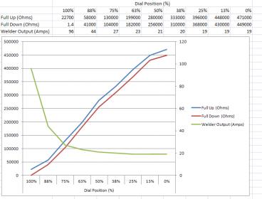

    Default Data!
    Well, who doesn't love data? Just for kicks, I measured the resistance on pins 4 and 5 of my pedal. Here's the results.
Name:	Pedal Resistance.jpg
    It occurs to me that one other useful thing would be to add the welder's power output onto the same graph, to see how it is mapping resistance to weld output. There's no reason to assume a linear relationship there.

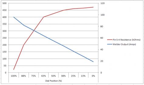

    Okay. One more data point. This adds the front-panel output value, mapping it across the resistance values. The pedal was full-down for the front-panel series. The welder was plugged into 110v power for the exercise, so I could have it in the same room as my computer.

    I think this really clearly demonstrates the issue. More than half of the dial's travel range is spent between 27 and 19 amps, which is only 10% of the usable range of the pedal (96 to 19 amps).

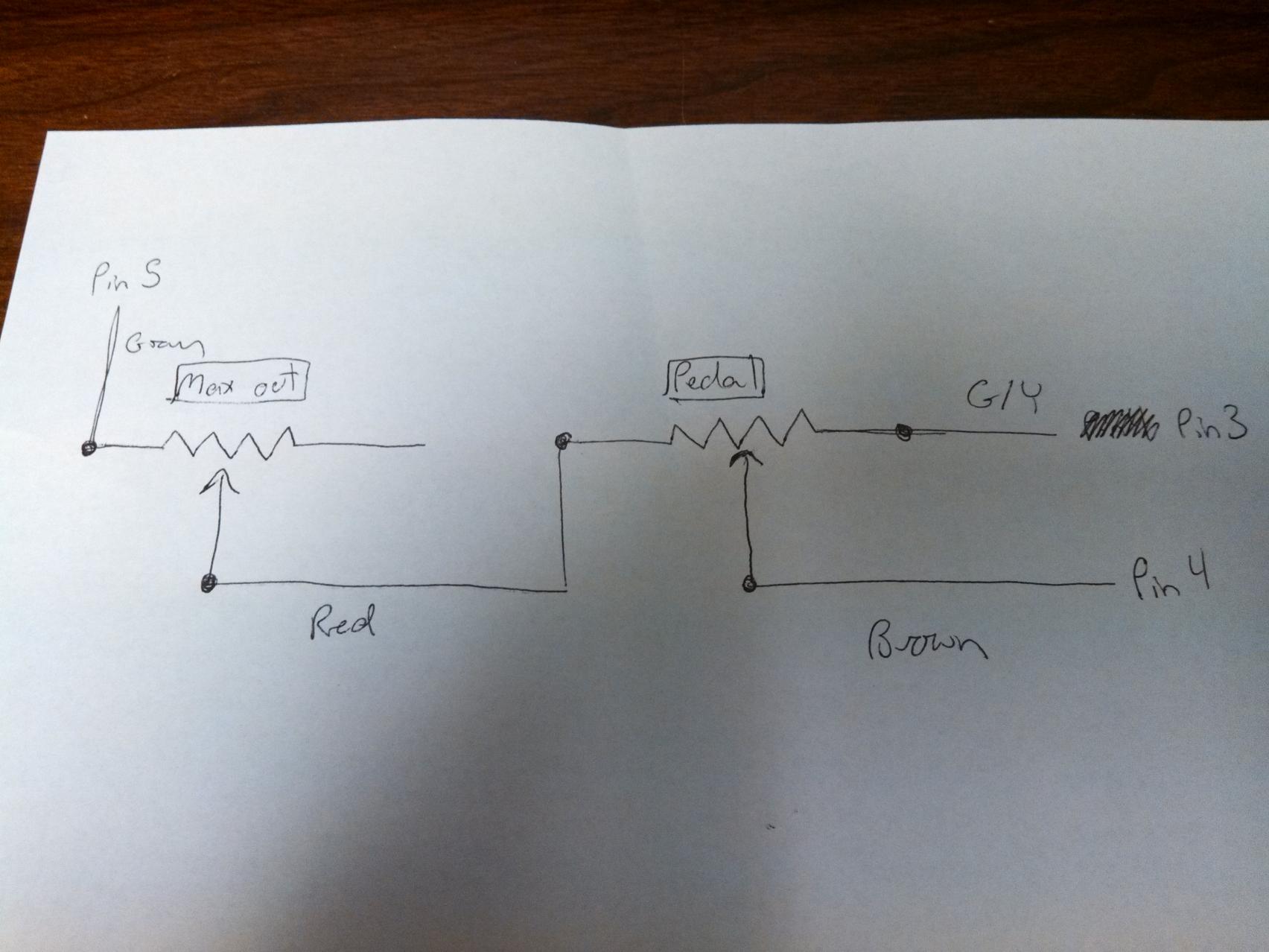

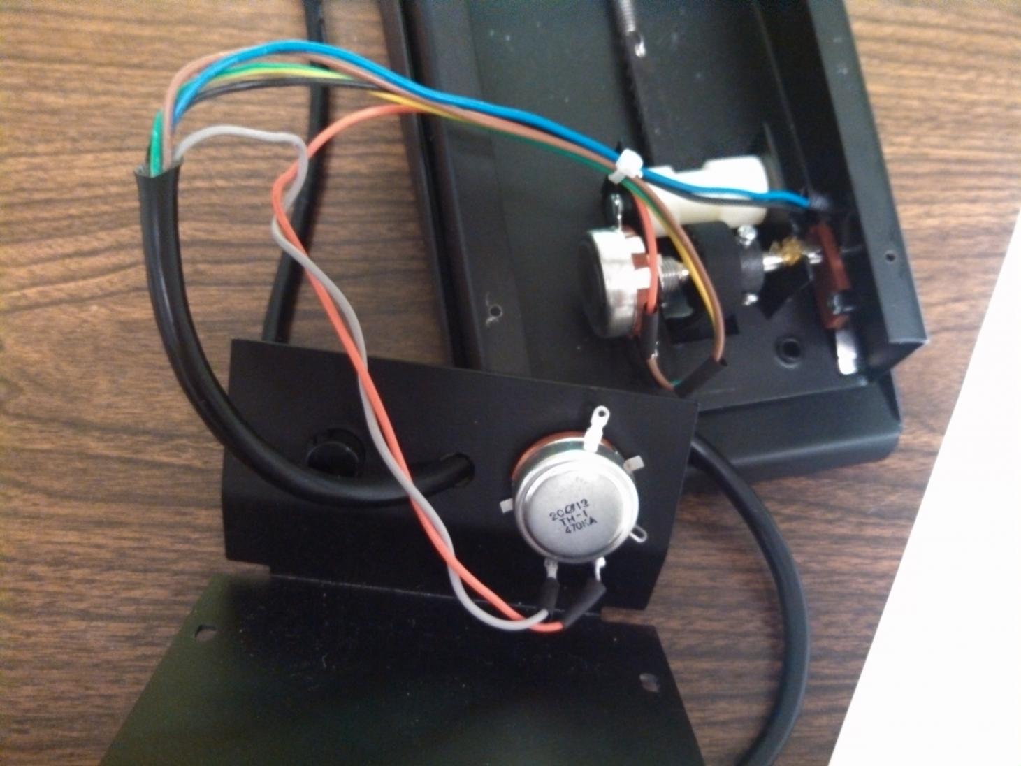

    Ok. I opened up the pedal and poked at it with a multimeter. Here's my wiring diagram.

    To sum up: The gray wire goes to pin 5. The brown wire goes to pin 4. The green/yellow wire goes to pin 4, but only when the pedal is pushed. Hopefully, this is enough information for a person familiar with electronics to suss it out. I'm a bit surprised to find that the max-output pot doesn't have three wires going to it, but maybe it's just being used as a rheostat. Or maybe there's some nuance of electronics there that I'm missing--quite likely.
    I have been thinking about the graph of amp output relative to potentiometer resistance. The pot seems to have basically a linear response. The amp output line seems basically logarithmic. It seems that if the max output pot could be caused to be inverse-log, then the amps output would become linear. Any intelligent people have thoughts about this?

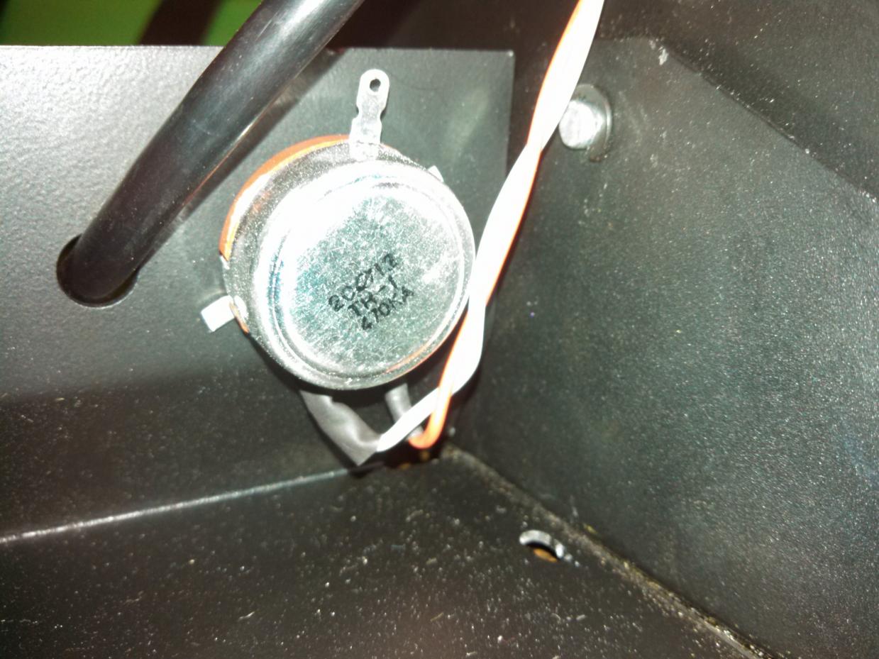

    ... and here's the marking on the back of the pot, which I'm sure will be very informative to a knowledgeable person.

    Kinda hard to tell things from your diagram, maybe pictures would be better. You have two leads going to pin 4 and that isn't correct. Where the wires go on the pot are important. A pot has a fixed resistance between two leads, with a wiper that can sweep between them, connected to the third. That one photo of the max pot is an odd one, too. It has three leads but they are placed in a way that I would check everything with an ohm meter to verify just how it is constructed, it may be something a little out of the ordinary.
    There's no question that that's how it's hooked up. With the pedal in the neutral position (full up), there is a 0-ohm connection between the G/Y lead and pin 4, and an open condition between the Red lead and pin 4. As the pedal is pressed, the resistance on the G/Y increases and resistance on Red decreases. Brown is always 0-ohms to pin 4, regardless of pedal position.
    The max pot has two wires hooked up to it. The third lead is disconnected. My understanding is that this causes it to act as a rheostat instead of a potentiometer.
    I did a lot more poking around inside the pedal with a multimeter tonight. I read that you can convert a linear pot to semi-log by attaching a resistor in parallel. I have some resistors up to 10 kOHM, but given that the max-output pot is something like 500 kOHM, they didn't even budge it. After quite a lot of thrashing about, I hit upon the trick of rubbing some pencil lead on a piece of paper and using paper clips to create a variable resistor (based on the distance of the clips). Actually, I knew that trick, but I was pretty sure we didn't have any pencils in the house. Anyway, this allowed me to at least characterize the effect of putting a resistor in parallel, even if the exact resistance wasn't particularly precise. Basically, what I found is that you can approximate a semi-log curve from a linear pot by putting a resistor in parallel, BUT you do this by decreasing the max output of the pot. The less linear you want the curve to be, the more you have to reduce the max output of the pot. This had exactly the opposite effect that I was looking for! By the time the dial got sufficiently non-linear, the max output was only around 50 amps (on 110v). I had a TON of resolution within the range of 20-50 amps, but that's hardly what I'm looking for. I have no trouble dialing in 50 amps with it the way it was shipped! It's stuff in the 70-96 amp (on 110v) range that's the issue!
    Also, I discovered that the pot used in the pedal appears to have a "runoff zone" at either end. What I mean is that when the pot is hard-over one way, it is full open, and when it is hard-over the other way, it is 0-Ohm. What this means is that, no matter what kind of tomfoolery I might pull with resistors, the pot is always going to jump abruptly to max in the last 1/8" or so of travel. I think this "runoff zone" is part of what's causing the problem--the pot goes very quickly from close to its max value RIGHT on up to wide open, and the welder interprets that literally. I wonder if the situation could be addressed by putting a resistor in series, thereby basically pulling the whole curve down to a lower point on the pot's travel. By the time the pot got to the threshold of its "runoff zone," the welder would already be at max output and you wouldn't notice the pot jump. If this worked, it would have the effect of losing amps off the bottom of the dial. Instead of being able to turn the dial down to 20 amps, you would only be able to turn it down to 30 amps, or something like that.
    The long and short of it, IMO, is that the only way to even attempt to address the issue would be to swap in a new pot with the same resistance, but a different curve. I still have some hope that if an inverse-log pot could be used, additional sensitivity in the upper output range could be gained without compromising lower-end range.

    No. The max-output pot only has two leads. My (amateur) understanding is that this turns it into a rheostat (burns off excess electrical energy as heat) instead of a pot (acts like a voltage divider, cutting current between two leads). I agree that the fourth lead is ground, as it is a part of the back cover of the rheostat. It appears not to be used, and my best guess is that's because the circuit is deriving reference from the welder itself, via the pins in the connector.
    The wiper of the pot is what is hooked to pin 4. You are reading the resistance of the pot when you move the pedal. All pots have a section near each end of travel where the wiper goes to zero ohms to that pin, that is normal. Some photos or a better drawing would really help. What you are dealing with is a voltage divider the max amp pot is wired in series with the pedal pot, and goes to zero ohms for max amps. What you are looking for is a combination that will give you max amps at full travel, and about half amps at half travel. You do not want a log output, as that is what you have right now. You need to make the circuit more linear, in it's behavior. If you parallel a resistor across your max amp pot, you will lower the resistance. The taper will not change very much. Most pots are labeled with the taper A = log and B = linear. It looks like what you have there is a 470 kilo ohm log taper pot. A photo of how the leads are connected would help determine if the taper is wired in a way that makes it more touchy at high settings.
    An no a pot never goes open, you are just not using the correct range to measure it. Yours should go from aprox 470k to 0 but I have to see exactly how the legs are wired as often when a pot it only using two leads, the wiper is shorted to one end. This makes it behave slightly different.

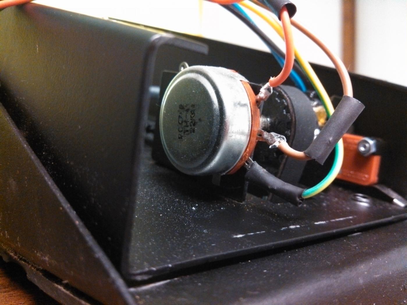

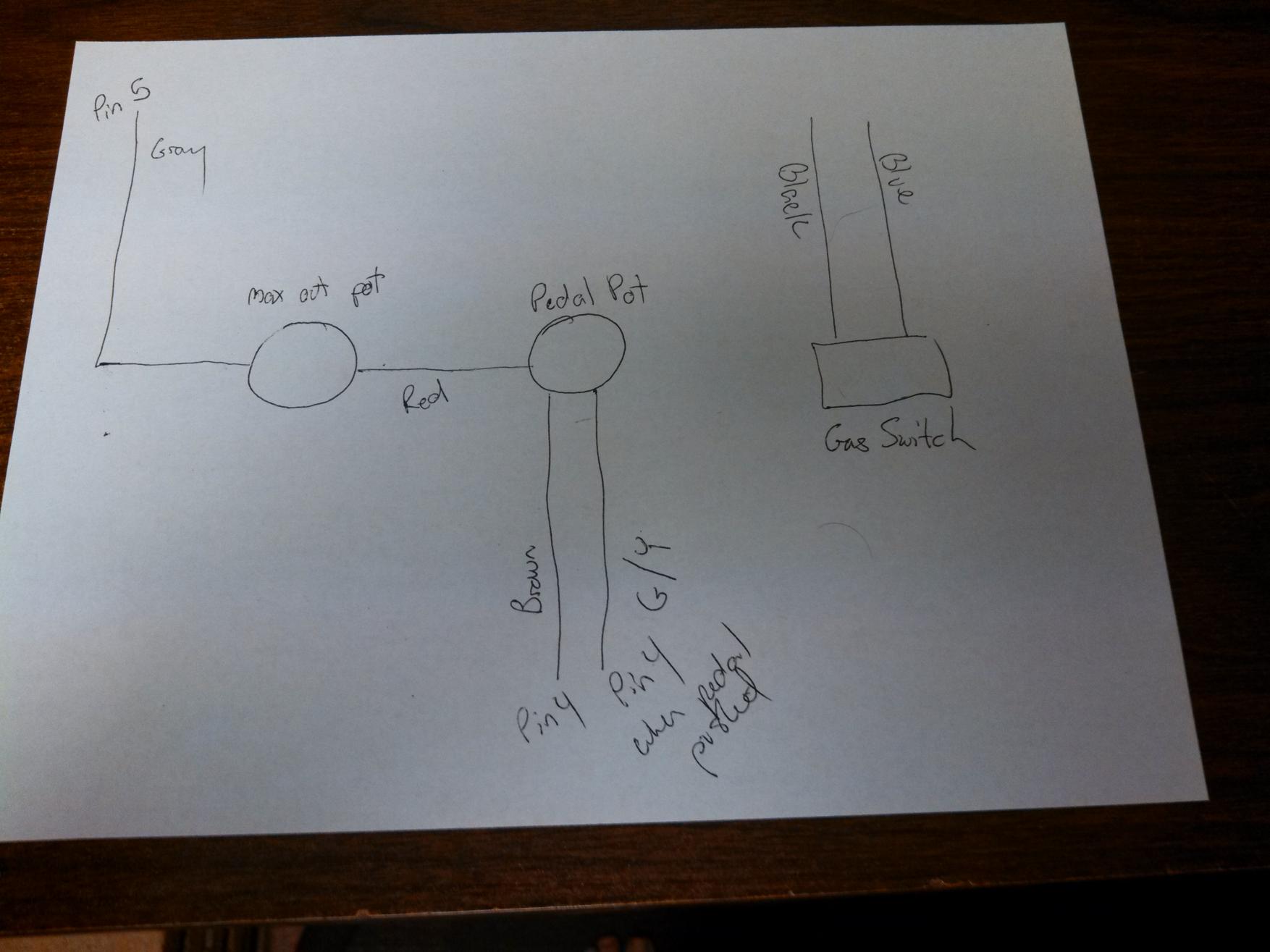

    Thanks for sticking with me here, Rambozo. I'm attaching some pics that will hopefully help make things clearer for you. It's not quite visible in the pic, but the pedal pot is labeled 22k A. Thanks for telling me what the A was, by the way. The only way I could think to read it was Kilo-amps, but that made no sense at all.
    On all pots that I have used, the middle lug is the wiper and the outer two lugs are wiped-between. That seems consistent with what I observe when I put a multimeter on these two. On the pedal pot, resistance between Y/G and Brown goes from 2.4 Ohms to 22 kOhms when I push the pedal down. Resistance between Red and Brown goes from 22 kOhms to 2.4 when I push the pedal down. So my reading of it is that Brown (middle lug) is the wiper and Red and G/Y are being wiped-between. If that's true, then a more formal wiring diagram would be as shown below:

    You're right that both Brown and G/Y are not attached to pin 4. I was confusing myself. When the pedal is pushed, G/Y shows connectivity to pin 4 because it is being connected to Brown through the pot. G/Y is actually connected to pin 3. Brown to pin 4. Gray to pin 5. You're also right that the pot doesn't go to zero Ohms. I just got sloppy in my speech. It's actually about 2.4 Ohms.

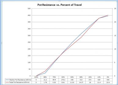

    Can you tell I love data? To get a better understanding of the pots' behavior, I mapped resistance vs. percent of dial travel. Here's the result:

    Two things I don't understand. First, since the pots are logarithmic taper (A type), why does their Ohms-vs-Travel look linear? If this was a logarithmic unit, like dB, then it would make sense that a logarithmic output mapped on a linear scale would look linear, but I don't think Ohms are logarithmic, so if the pot's output is log, and we map it on a linear scale, it should look logarithmic. No?
    Second, notice that the two pots' response is basically identical, as you would expect. So why is the pedal pot soooo smooth and easy to control, but the max-output pot is all jumpy at the end of its travel?
    Because it is.
    With Chinese pots, it's like that box of chocolates, you never know what you're gonna get. The problem is that the pot codes are different in Europe. Japan usually uses US coding, but China uses whatever they are copying, or maybe they flip a coin. I don't know, I just know they use different codes all the time.
    In the US and Japan:
    A - Audio or Log taper
    B - Linear taper
    C - Reverse Log taper
    G - Graphic taper
    In the EU (mostly, there are exceptions):
    A - Linear taper
    B - Audio or Log taper
    G - Graphic taper
    So when in doubt you just have to measure. Gotta love when they use the same code letters with different meanings.
