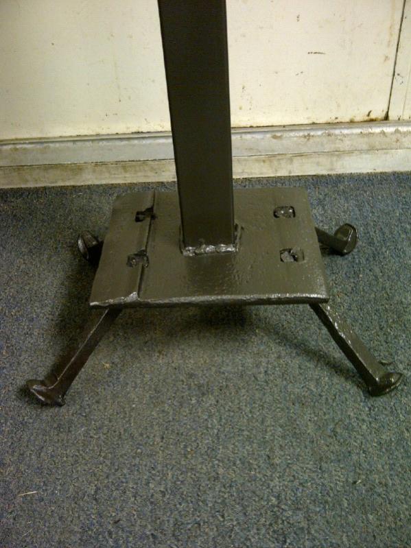

    I had a lot of stuff laying around, so I put it together. It ended up looking like this. The base is a tie plate.

    That's very cool. What is the 'finish' on steel? It almost looks like it's been powder coated.

    Neat. Any difficulties getting the feet level?
    No, I cheated.
    I put a box under the tie plate to hold it at the height I wanted and shimmed it a little to get the tie plate sitting on it level.
    The I put the feet in the holes of the tie plate at about the angle I wanted them to be at and welded them in place.
    So rather than trying to level the base with the feet, I added feet to a level base.

    That's Rust-Oleum's Hammered version of paint. It's called bronze, but looks a lot more silver than bronze to me.
