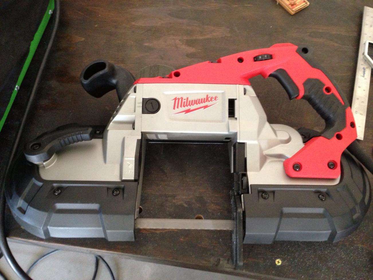

    I just picked up a Milwaukee MILN6232-21 handheld bandsaw and a bunch of blades from CPO Milwaukee.

    First impressions are that this is a 'seriously well made' tool. Has the heft of my older Milwaukee tools. So much so (hefty) that it takes some getting used too in terms of managing saw cuts. I suspect that a small stand like what Swag Offroad sells would be a good option for using this saw. I'm still getting used to how the tool "handles" and will post more comments as I get on with it.
    Note: This is my first powered metal sawing tool so you can take my comments from that perspective.

    More observations on using the saw:
    Works very good for cutting notches but it's not easy making a perfect normal cut.
    The LED light is very useful. i.e. would be difficult to use this type of saw without an LED blade light.
    There is NO trigger safety on the saw! Since the trigger is part of the rear gripping/lifting handle (and the saw is darn'd heavy) you have to be VERY careful not to accidentally turn it on while lifting the saw. i.e. You should treat this saw like a handgun.......... finger OFF the trigger unless ready to 'rock-n-roll'!

    That looks like a new design. I have a "deep" throat 6230 I bought last year, from a reputable pawn shop. It was nearly brand new, if not brand new. Paid 175.00 for it. It's been a labor reducer more than once. Came with a case and everything.
    Edit: actually got to thinking about it and it was more like 150.00...but just looked it was a 6 amp. New ones show 11 amp?? The one I have is strong as it could possibly be and will slip the band if I catch it on something. Can't imagine what an 11 amp would do.

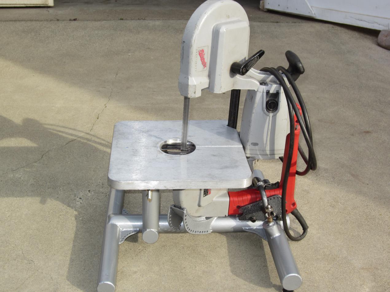

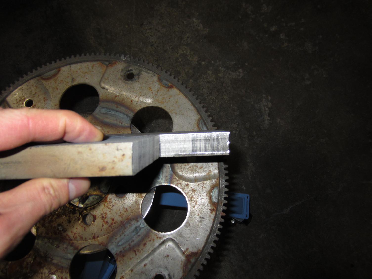

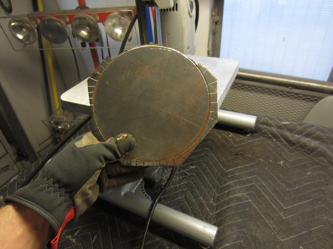

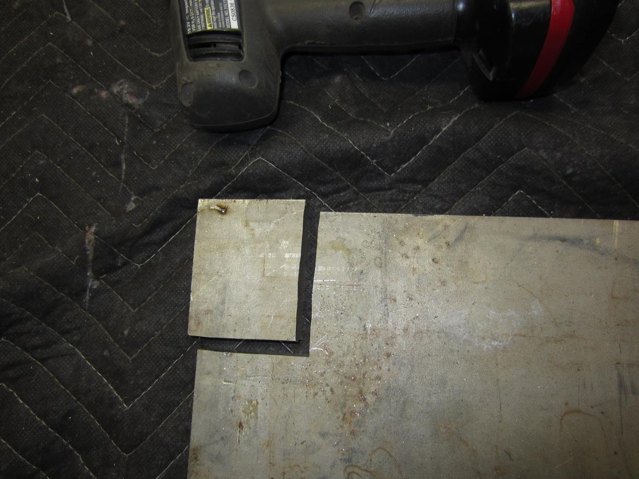

    Yeah, that is definitely the new design. I have the same 6230 model deep throat porta-band that Mark has and it really is a time saver! I posted a pic of the stand I made for it during the last contest (just in case you decide you want one too....it's a very nice upgrade IMO). I installed a new Milwaukee brand 10TPI blade yesterday and cut a 2"x3.5" chunk of 3/4" thick steel in around 3 minutes, plus the 10ga (1/8") disc shown. I try to cut with my hand hacksaw as much as possible, but I would have been at the bench cutting that 3/4" plate for 2 days with a hand hacksaw!
    I use fast speed and fairly low pressure and the saw does just fine. The only gripe I have about my porta-band is the fact the trigger is worn a little and I have to shim it a certain way when mounted in the stand to get full "throttle." Like Mark, I bought my porta-band from a pawn shop on Ebay for around $150 (2 years ago?) with the case and a new blade. It stays mounted in the stand though as that fits in my job box perfectly.

    I'm liking Andy's bandsaw stand. I'd like to think someone at Milwaukee is keeping track of clever designs that people come up with, even if it's just a photo on a cork board somewhere.
