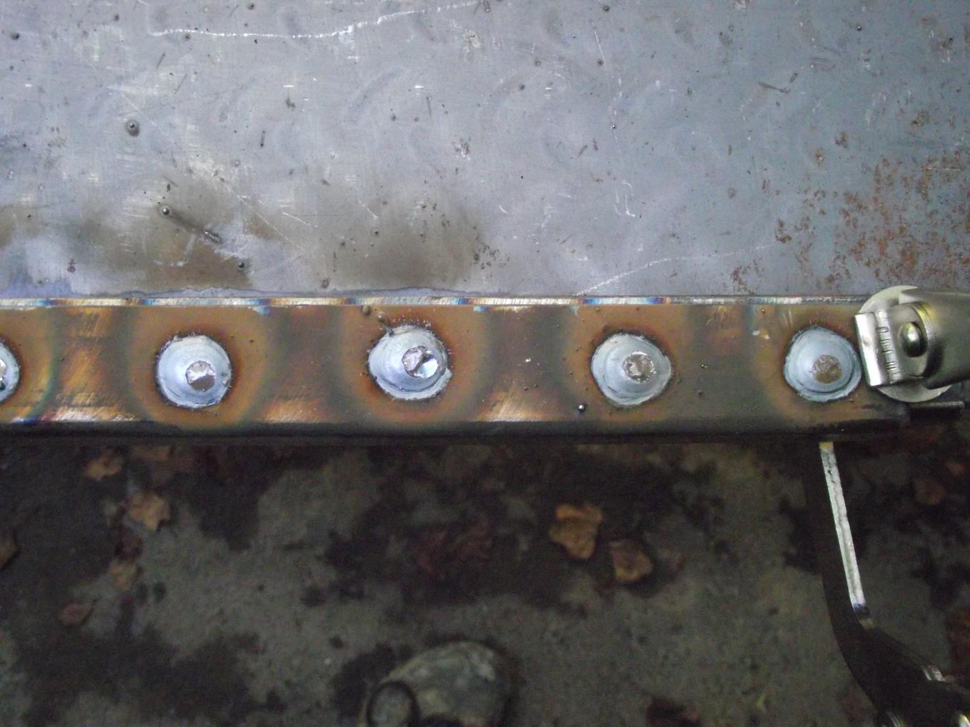

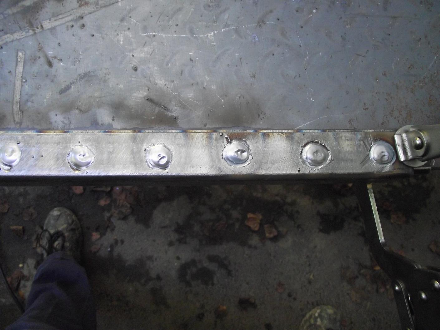

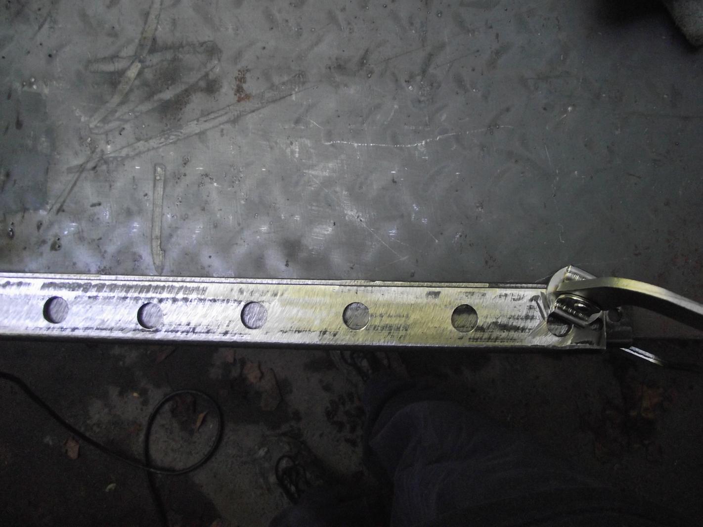

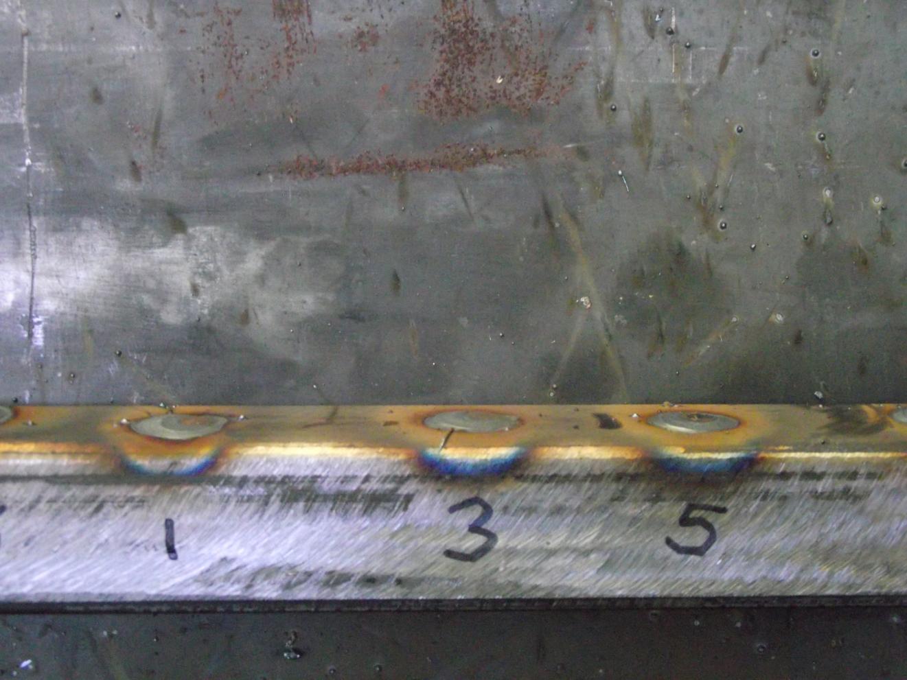

    The Everlast trailer-build videos on youtube inspired me to try some plug welds. Drilled a series of holes in 3/32 angle and nested another piece of angle underneath, looked up settings on a MIG calculator, and started welding.
    I thought it was going well enough- I was getting the dome recommended in the videos, and was feeling pretty good about the whole deal... then I got a wire wheel after it, and found a dimple on each one.
    Did I read somewhere that spatter and the dimple is a sign of too much heat?

    Those look pretty good. The edges on a couple are not quite filled. The Dimple is normal. It's the same as a small crater and one reason you dome, so it doesn't leave a concave depression below the seam. You try to minimize it, but there will always be a tiny bit of cratering with mig.
    Spatter can be a result of a cold start, or from a gun angle a little off.
    Well, thank you, Mark, I thought I'd totally barked it. You're right, I realized while welding that the edges were yet another detail to keep an eye on.
    Is that you in the Everlast videos, BTW?
    Did you fill the hole using the same technique you'd use to fill a dessert dish with frozen yogurt (start on the outer perimeter and work inward in a circular motion towards the center), or did you just aim for the center and pull the trigger? It's common to just aim for the center and pull the trigger, and while you could argue it's effectiveness (I guess), the first method is the correct and only real way to insure that both layers are fully joined (you still get the dimple in the middle). I didn't mean to imply that you didn't know any of this or that I'm talking down to you. I was just curious, that's all. I've seen more than a few plug welds break and the second method was always used in those cases.
    My recollection from the video (and the method I used) was to start at the middle of the hole on the lower plate and make circular motions outward, eventually reaching the perimeter of the hole and bonding to the upper plate that way. Then move the arc to the center to pile up some filler metal for the dome effect. I just went back to check the Everlast video- it's part 3, and the plug weld explanation starts at about time index 2:20. I was thinking it would be interesting to cut a plug weld apart to look at it in cross section.

    That sounds like pretty much the same method actually. The main idea is to make the circular motion around the perimeter and end in the center. The method that can fail is the one I mentioned previously where the person welding leaves the stinger stationary and just pulls the trigger for a second. That can leave the edge of the hole unwelded and cause insufficient penetration. I had a bunch of plug welds to re-weld after someone at my previous job hacked everything together on some 16ga stainless. If you followed what Everlast put in their video, you can be sure their method is correct.
