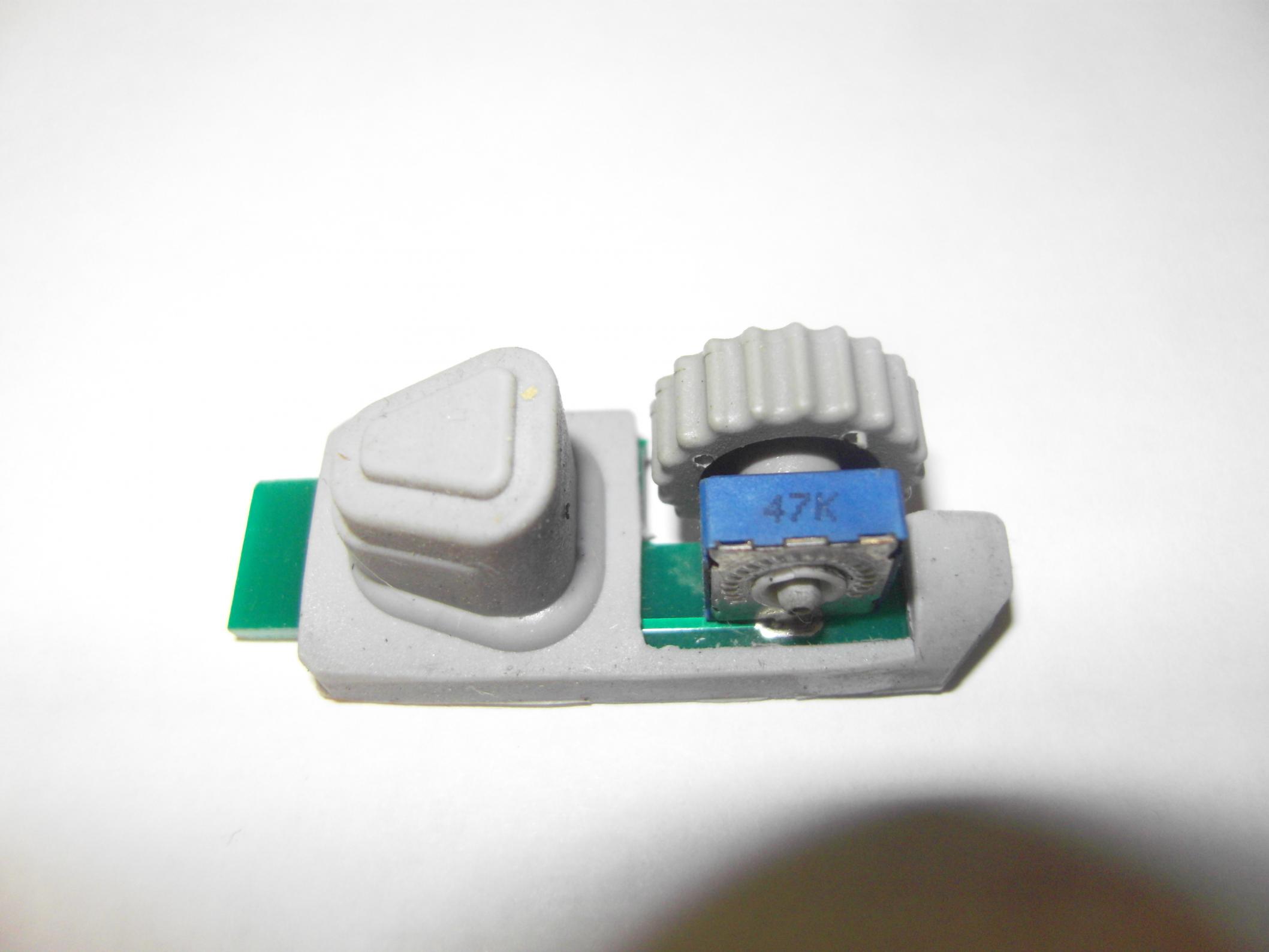

    The fingertip controls require 4T operation. Arc maintains after initial trigger. The PT185 does not have a 4T mode.
    The fingertip control works just like the pedal it's just controlled by your finger. The pedal works just fine, so I can't see a reason why the fingertip control would not.
    Thanks
    Glenn
    The Everlast fingertip control has one button for the switch and a separate dial for power. While in theory you could use it in the 2T mode, it would be difficult and might require two hands to pull it off. It was designed to be used in 4T where you tap the switch to start the arc, then move your finger to the dial to control power. 2T mode requires you hold the button down then use another finger to work the dial. Look at some of the pictures of the torch posted.

    I have tried the CK amp controller on the 250EX and it will only go to 230A but the same one on the 255EXT it will do the complete range AC or DC with the 10K. The Everlast Amptrol has a 47K and will do the complete range on the 250EX and on the 255EXT.
    The Everlast Amptrol as Rambozo said it is designed for 4T not T2. The CK is for 2T it works like a foot pedal on the torch head it has a switch that turns the machine amps on and then goes to the pot at the same time like the foot pedal should. I think the 255EXT and the 210EXT will work with different K pots 10K or 47K (potentiometer) I also think the electronics in the EXT's will excepted most Pot's.

    Everlast Amptrol unit out of the handle

    I called and spoke with CK's tech support today. I was told that the current finger remotes will work with the Everlast EXT line, but they could not guarantee it to work with anything else in the Everlast line. I was also told they were "working" on a solution and have been for a couple of months, no time frame on when it would be done.
    The 185 uses a 47k pot, so looks like it might be a make it yourself solution. I would like one that is shaped like a trigger on a pistol with a guard. Bet that would be easy to manipulate. Lots of ideas, but how to put them into actual use is the issue. Need some type of switch that will "turn on" the unit and gas valve at first movement and then leave it on for the full rotation of the pot, then as the pot is turned back to the minimum the switch is "turned off".
