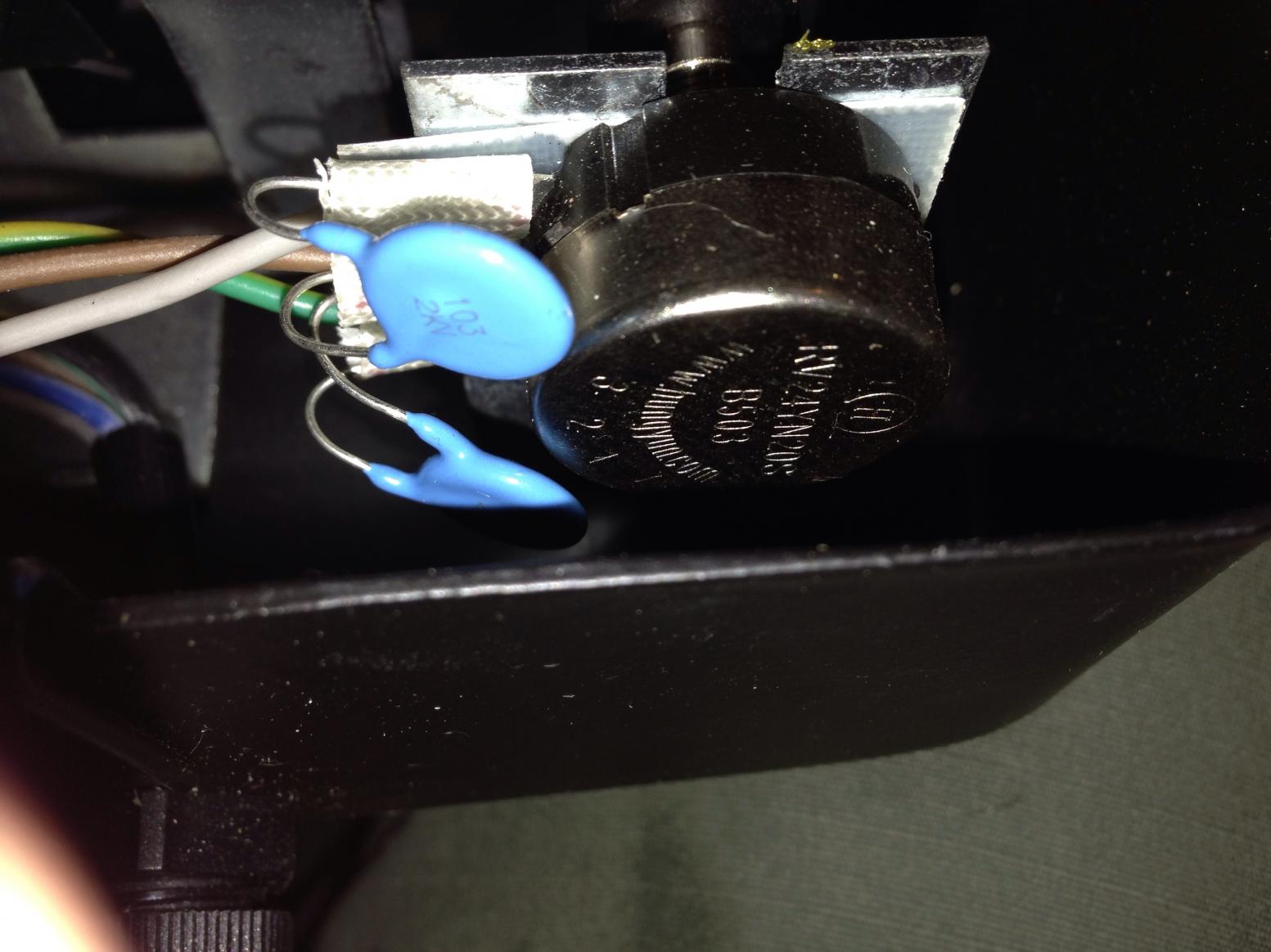

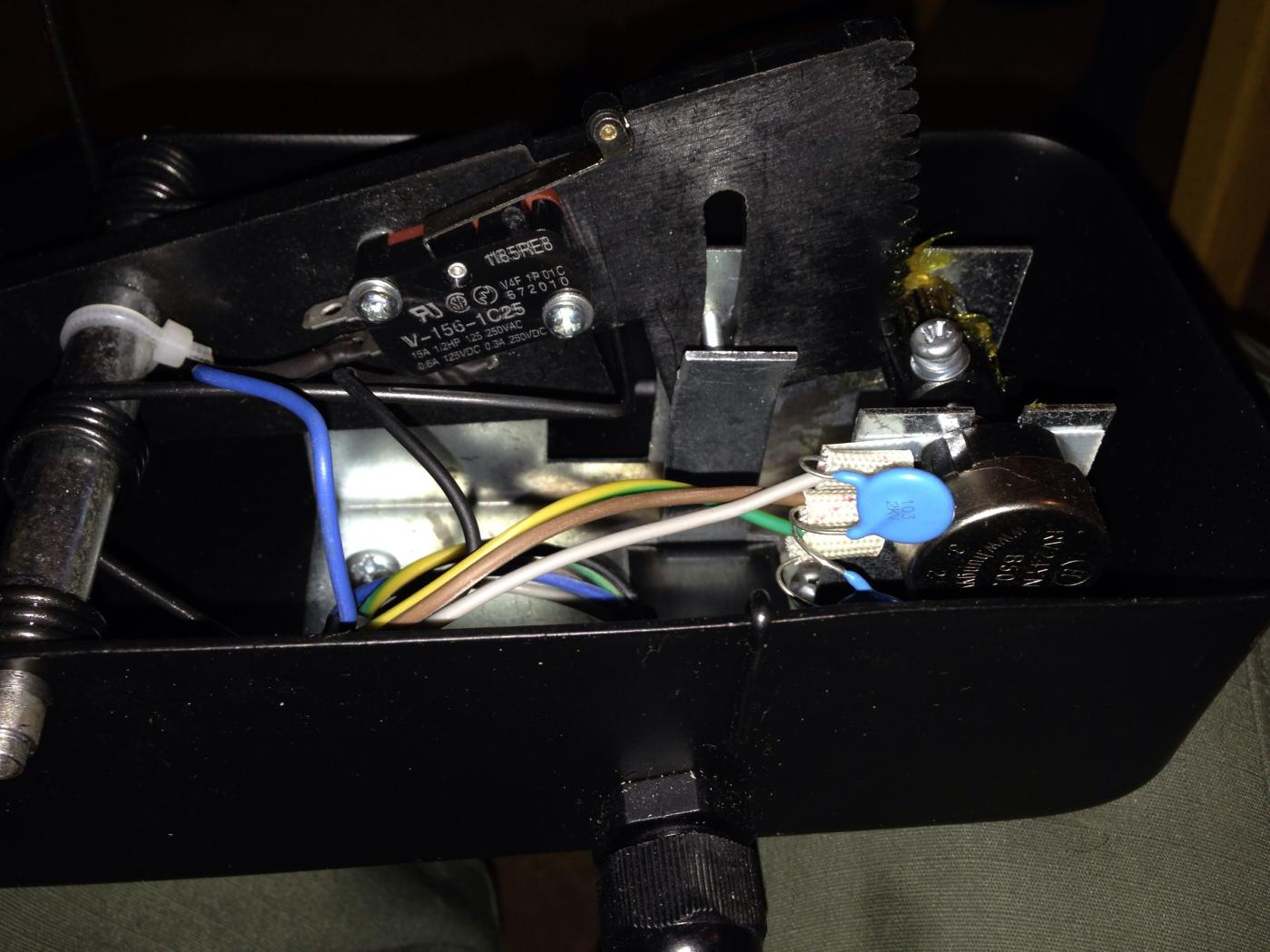

    Pulled off the cover and just checked out the guts of the foot pedal. By the numbers on the back of the pot, it's a 50k ohm one. Here are some pics
ID:	11690Click image for larger version.
    If you can't read the back of the pot, here is what it says
    RV24YN20S
    B503 (this is the code that means 50k ohms)
    www.hungyun.com
    Glenn

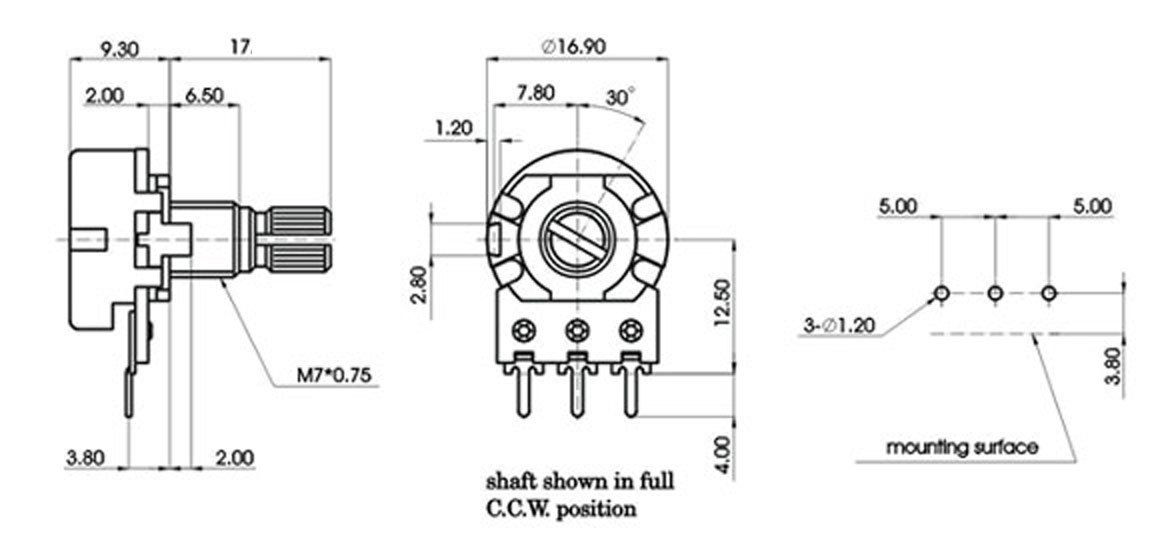

    Example on Ebay currently on order... Is the below correctly spec'd, correct "type"?
    10K OHM Logarithmic Taper Potentiometer Pot A10K 10KA Pot 17mm Shaft
    http://www.ebay.com/itm/321076524444
    Manufacturer Part No: A10K 17mm
    With Dust Seal
    Specifications
    Adjustment Type: Top Adjustment
    Power: 1/2W
    Resistance: 10K OHM OHMS
    Type: Logarithmic Type A
    Features
    Knurled Shaft
    Suits Most Standard knobs
    Shaft Diameter: 6mm
    Shaft Length: 10mm
    Mounting Hole: 7.5mm
    Base Diameter: 16mm
Name:	10K OHM Logarithmic Taper Potentiometer Pot A10K 10KA Pot 17mm Shaft.JPG
