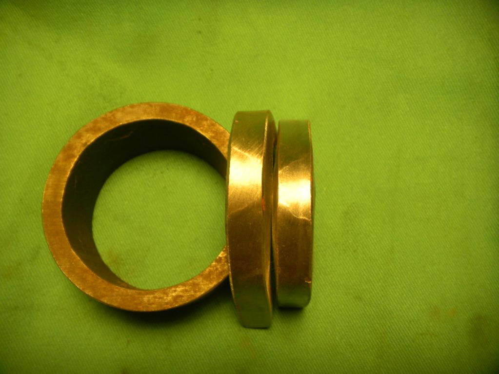

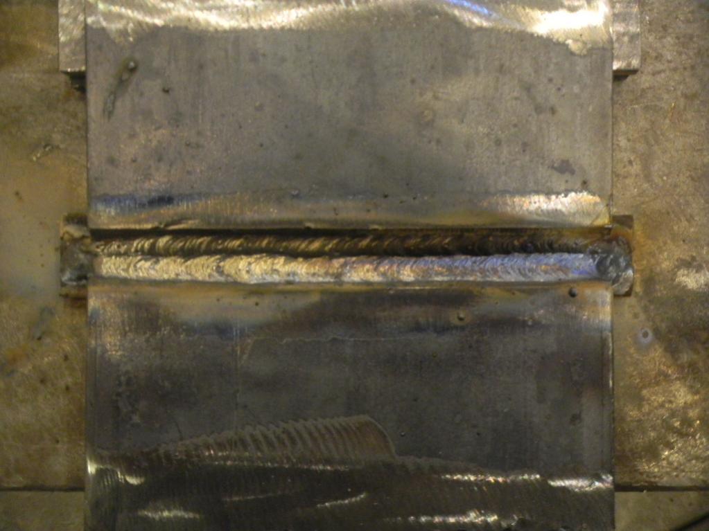

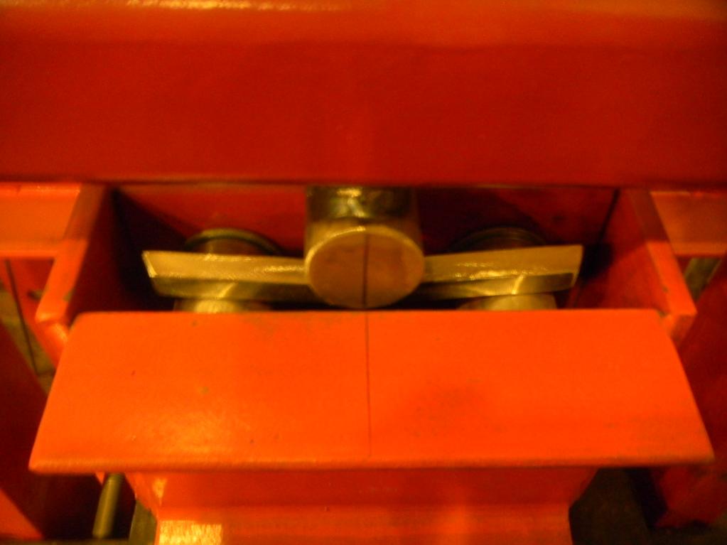

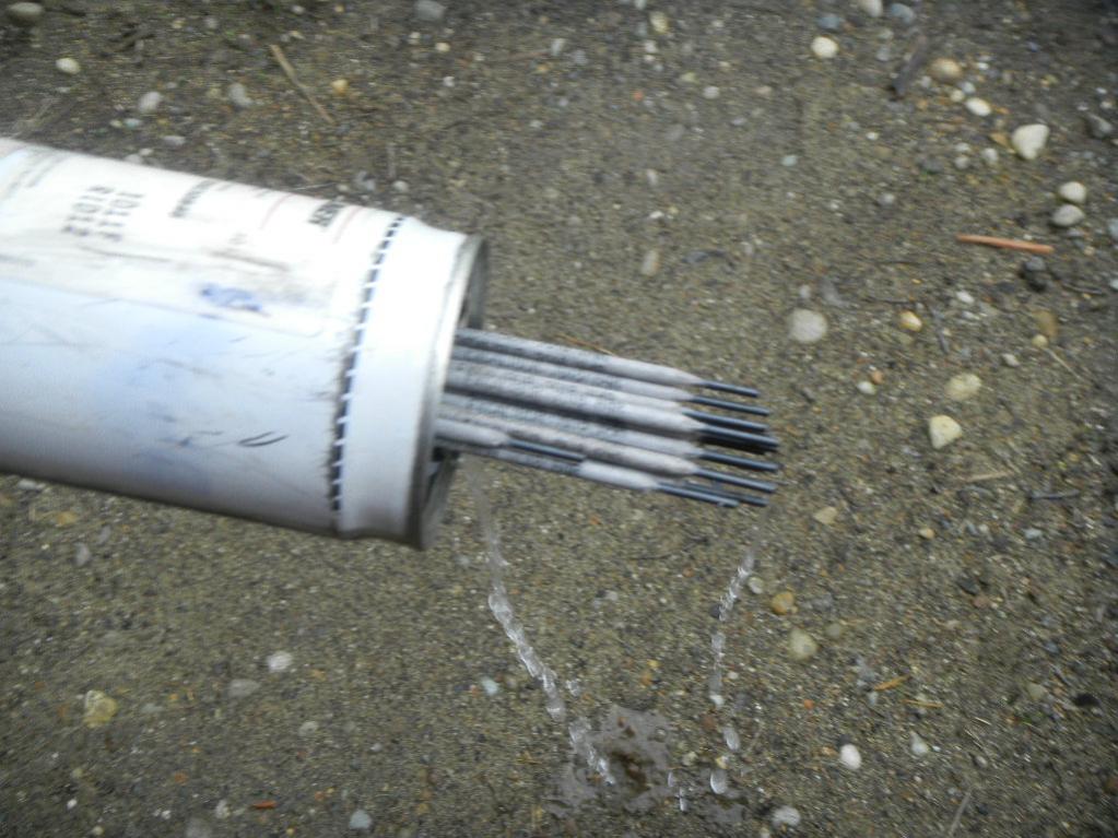

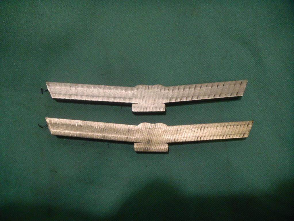

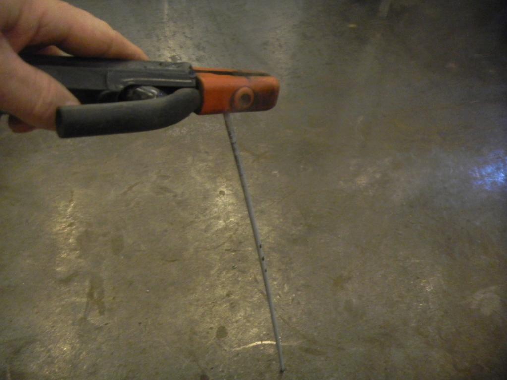

    First off let me start with the disclaimer! I don't recommend this one little bit. But I just wanted to see what I could get away with!
    I took some 1/2-inch thick plate, cut 45-degree angles on them. Placed them 3/16-inch apart. Took a hand full of 1/8-inch Lincoln Excalibur 7018. This rod has been setting on the bench for years in an open can, never seen the inside of a rod oven. I placed the rod in a welding rod can, and filled the can with water. Poured the water out. Set the Lincoln V350-pro to 120-amps, 0.0 on the arc force. Before using each rod, I placed them in the stinger and grounded them out on the welding table. Once the water started to boil out of the rod I used my glove to dry off the rod. I ran one rod after the other on this test plate, only stopping to clean. Cut the coupons into 3/8-inch strips, and did a side bend test.
    I don't think they came out to bad.

    heresy!!! next you'll tell me the earth is flat. lol
