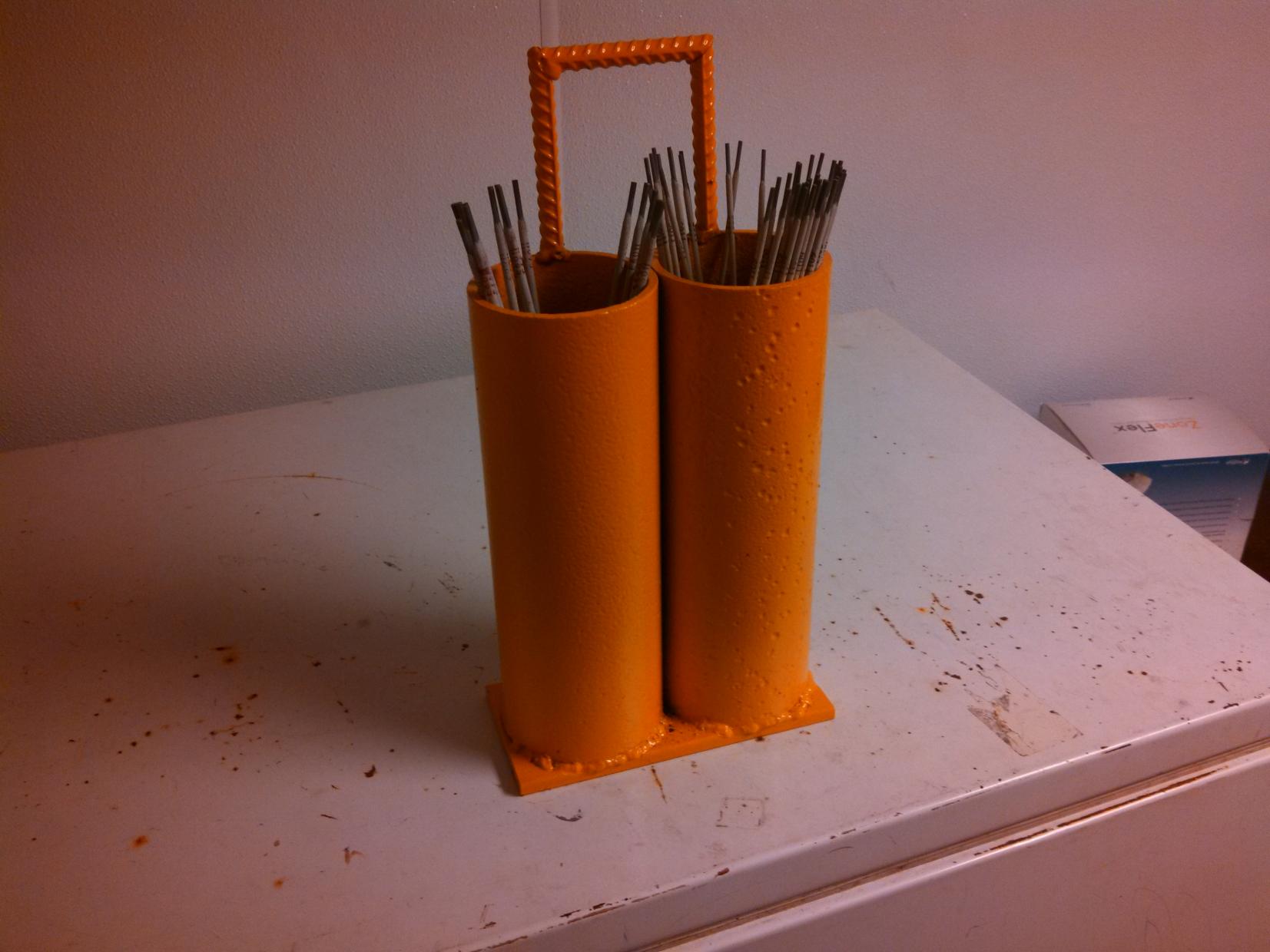

    Here's a stick electrode holder that I built. I made it from a piece of old rusty pipe that has been out behind my barn since I moved here.

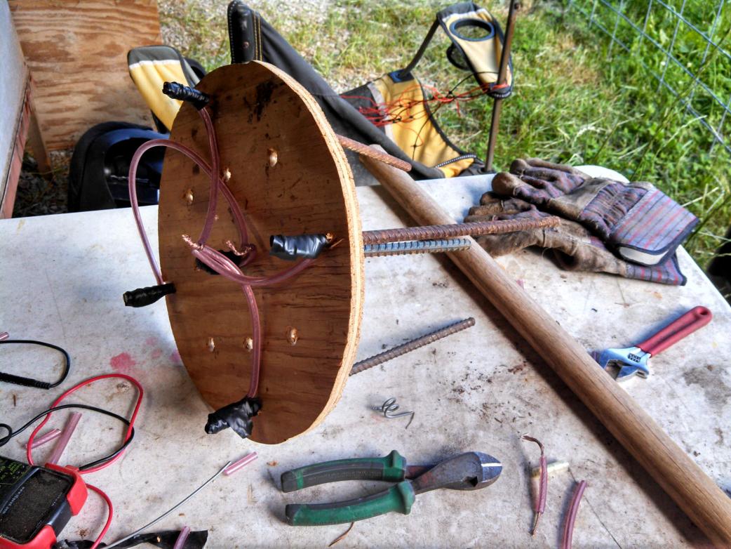

    In electrolytic rust removal, the object to be cleaned is the cathode, and you need some sacrificial iron/steel anodes to complete the process. Rebar is a common choice. I decided to use a five gallon bucket as my container, so I used a jigsaw to cut a round piece of plywood as a lid, and then drilled holes and stuck rebar through them. The more anodes you use, the faster the process will go. Also, the process is line-of-sight, so I put an additional anode in the center, to clean the inside of the pipe.

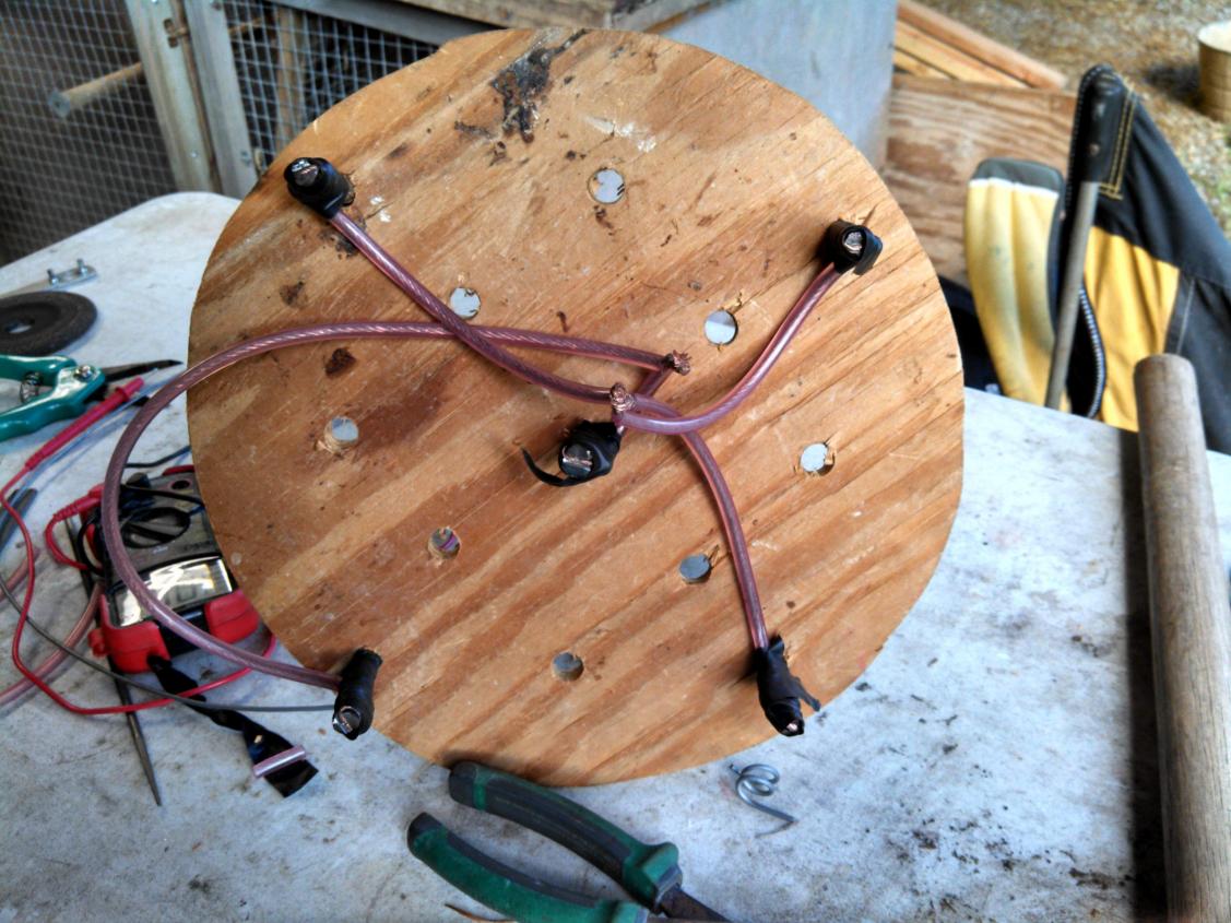

    Wiring them up was the single hardest part, because I couldn't find a good piece of wire to use. Finally, I remembered I had some speaker wire in my basement and rigged that up. I still couldn't really properly attach the wire to the rebar. I cut slots in the ends with a zip wheel and then wrapped and taped, but it was pretty shaky. I also drilled holes in the lid because the electrolytic process produces some hydrogen gas, and it needs to be vented. Really, it's probably too small an amount to worry about, but why take chances.

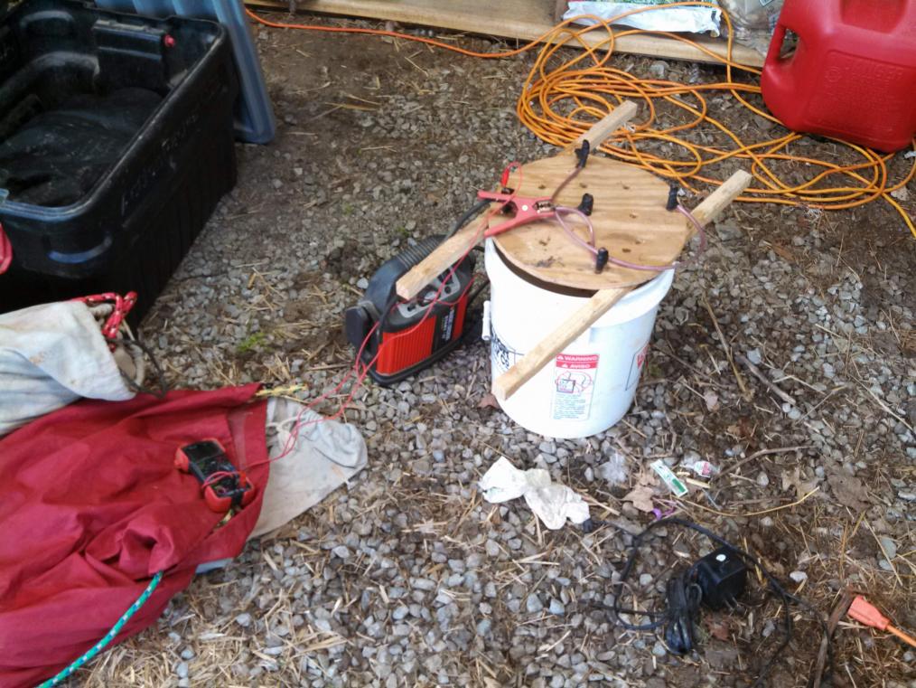

    Here it is all set up. The best thing to use for a current source is a 12-volt or 6-volt battery charger. The problem is that if you have a "smart" charger, it will be able to tell that you don't actually have a battery in the circuit, and it won't kick in. You can fix that by wiring a battery in series, but then the charger needs to have enough output to compensate for the draw, which my little charger did not. In retrospect, maybe I could have wired up some light bulbs in series to reduce the current of the circuit to a level that the charger could keep up with. Ohm's law, and all. Anyway, at first, I hooked up my 12 volt battery and left the multimeter in circuit so I could detect when the battery was low and needed to be recharged. Then I put the battery on the charger and swapped it for another one. This was tedious and annoying.

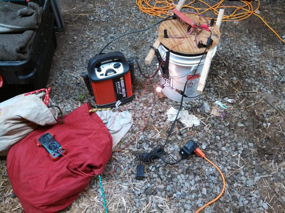

    So then I dug around in my junk box and found a 12 volt, 1 amp transformer for some long-lost piece of hardware, so I cut off its plug and hooked its leads directly to the circuit. I also stuck a 12 volt light bulb in the circuit, to reduce the current a little bit and also to give me a visual indicator that the process was still occurring. The transformer was still running at about 1.5 amps, and it burned up after some hours of this, but who cares. It got the job done.
    Incidentally, if you have a DC welder, it can be set to the lowest output setting and then used as the current source for this process. One problem there is that a battery charger may have short circuit detection, whereas a welder won't, so you have to be really sure that there won't accidentally be a short. The other thing is, I wasn't willing to chance my expensive inverter welder on this process, but if you have a buzz-box, you're good to go.

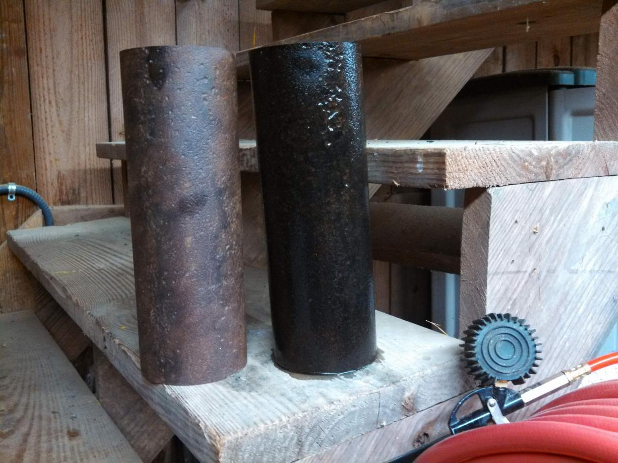

    Here's the result, with "before" on the left and "after" on the right. The "before" has been cleaned with a wire wheel, but not ground at all. The "after" is a little misleading, because it immediately (like, literally a minute later) had a patina of rust on it, but you can see how ridiculously clean it was coming out of the bath.
