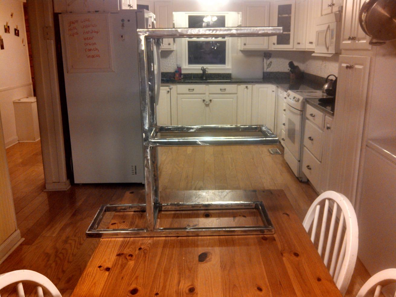

As careful as I was with my fitup, I had a lot of problems with warpage to deal with. To make matters worse, I don't own a heating torch, so the best methods of correcting the warpage aren't available to me. I had a small issue with the bottom "cupping" up where I welded the uprights on. The uprights themselves cupped when I welded the middle shelf on. And, as you can see, the middle shelf was all sorts of wonky. I tried using clamps and a hydraulic bottle jack to straighten the material cold, but it didn't really work. I would have had to do a lot more bending than I was comfortable with.
Name:	2013-06-21 23.57.07.jpg
Name:	2013-06-21 23.57.47.jpg
I ended up correcting most of the warpage by welding U-shaped beads onto the back of the tubing with my TIG torch. It was important to weld up the corners as well as across the face, or it didn't straighten much. Someone suggested spraying down the piece with a mister bottle after welding, to increase the effect of the weld. I do NOT recommend this. The entire piece rusted to heck, and I had to spend about an hour grinding it clean, which is why it is so shiny in this photo. What a dumb idea. If I had had a torch, I could have dried the piece thoroughly after misting it, but if I had had a torch, I wouldn't be doing this in the first place.
As you can see in the photos above, the middle shelf is still a bit crooked, but overall things are much better than they were. I decided to leave well enough alone.
