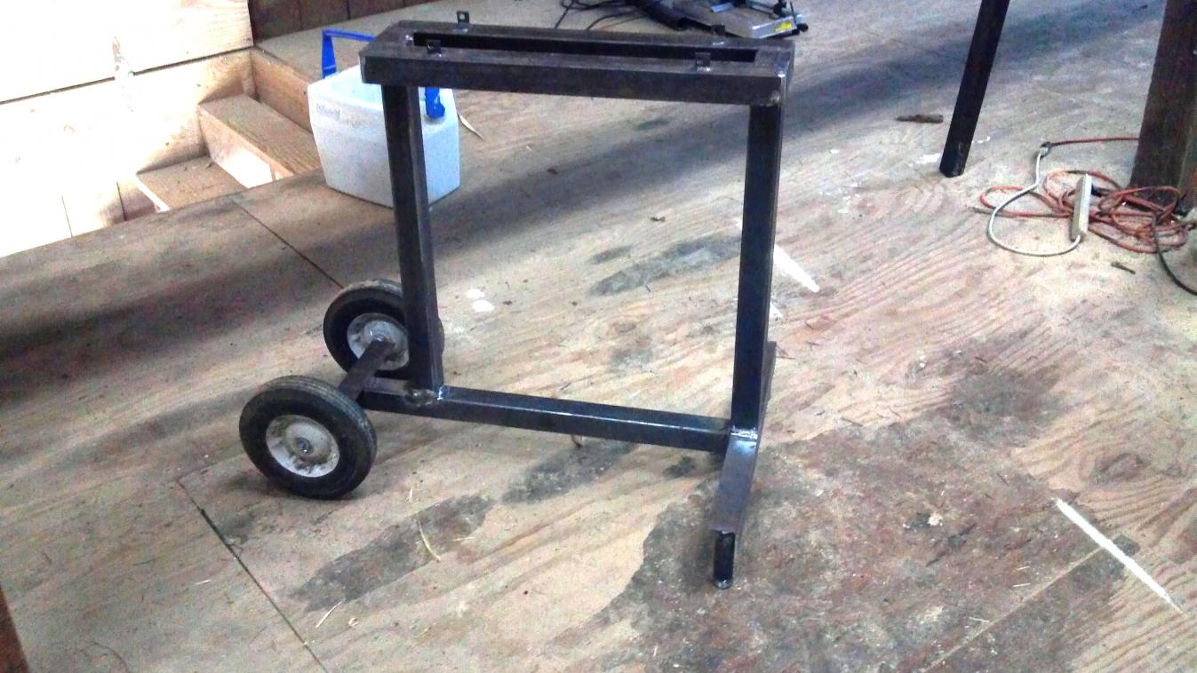

    I don't have any photos of the build in-progress, but here's a stand that I made for my good old Harbor Freight bandsaw. You may have heard that the included stand is worthless. I made the stand the same height as my work tables so that long material could be supported by the table while the bandsaw cut it.

    I could have done the top using miters, but just for fun, I coped the angle iron instead. It came out really good and square. There's no question that the coping method does a better job of avoiding warpage than mitering. By the time the face weld goes in, which is the one that could really twist things, there are two other welds in at right-angles holding the whole thing square and flat.
    The only thing I would change if I did it all again would be to not use angle iron for the legs. They're functionally fine, but they do have some flex, and I kind of wish they didn't.
    I'm not following you on this one- I wouldn't expect flex in angle iron, either. What is causing it?
    Good commentary on the saw, btw!
    Angle iron is only rigid in two planes, not three so you have to design for that. Just like sheet metal is only rigid in one plane, but with proper design, you can build very stiff structures using it.
    I guess "twist" is a better description than "flex". And when I say, "legs," I mean the horizontal pieces that hold the feet and wheels. Especially the long one in front. If you wiggle the unit side to side, the feet will twist and flex a little.
    Gotcha- "twist" I get.
    Live and learn. The whole stand looked pretty beefy at first glance and then I read about the angle iron and saw those and where they were. If it really bothers you, you can always modify.

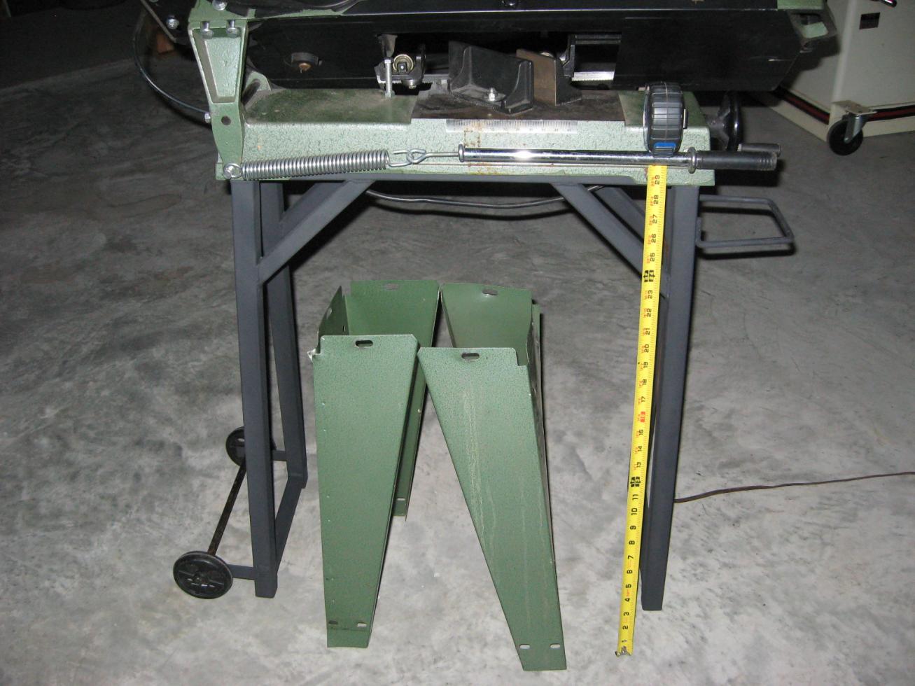

    I've owned one of these for about 3 years. My only complaint is the stand. Once you get it adjusted it will cut pretty good. I would like to get another one and build a stand so it remains vertical all the time. I think a vertical band saw is one of the most handy shop tools.
    The stand that comes with them is made for really short people. Click image for larger version.

    Speaking of vertical, another thing to keep in mind is that they make a small vertical shelf that can be left on when the machine is horizontal, so you don't have to switch it on and off. But mine didn't appear to come with it.

    I see you reused the original wheels! :p
    They look small on there but I was just going for functionality. It rolls fine from the tool room to the work area.
