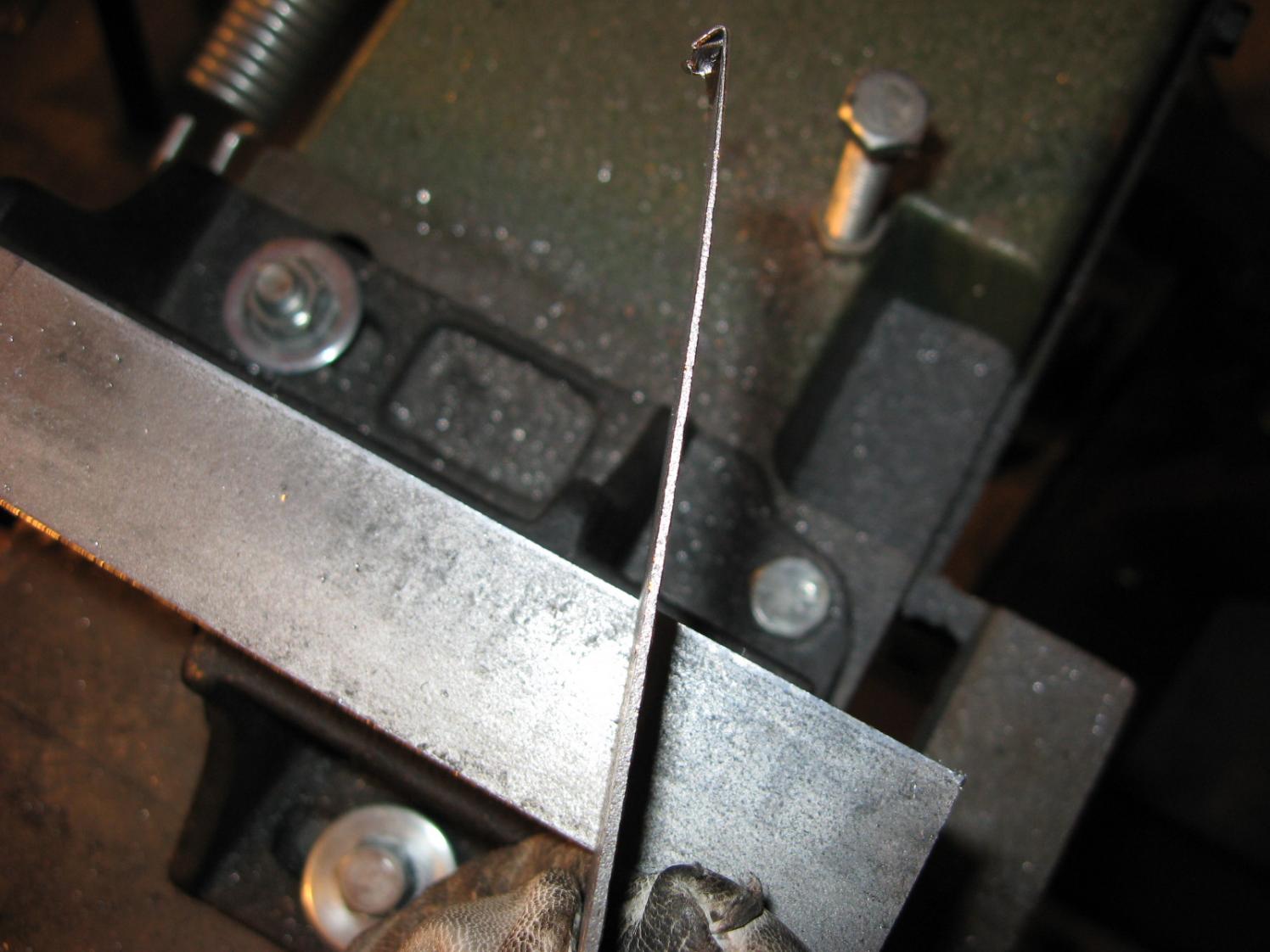

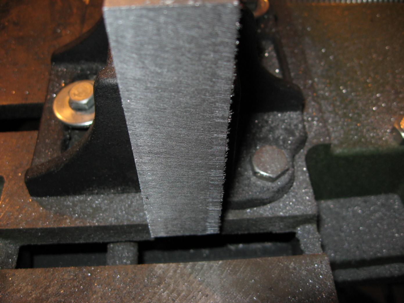

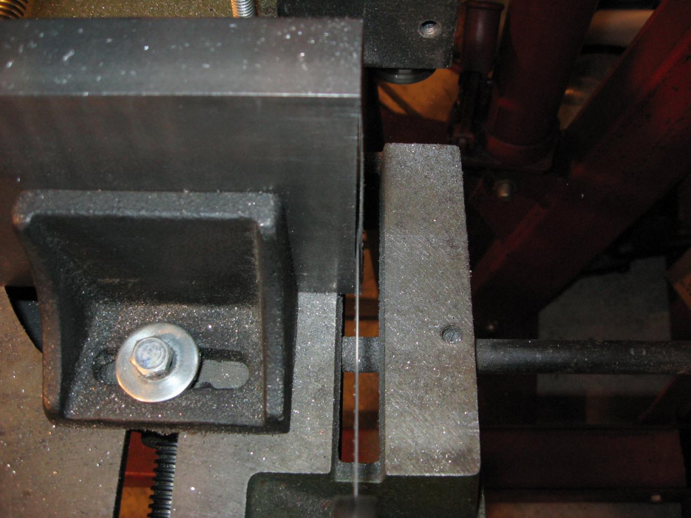

    It took a while to get this one dialed in but it tracks well now. Here's a cut to square up the end of some 1"x4" cold rolled that I made press plates from. Started at less than the blades width. Click image for larger version.
    So where is the final picture showing how square the finished bar came out?

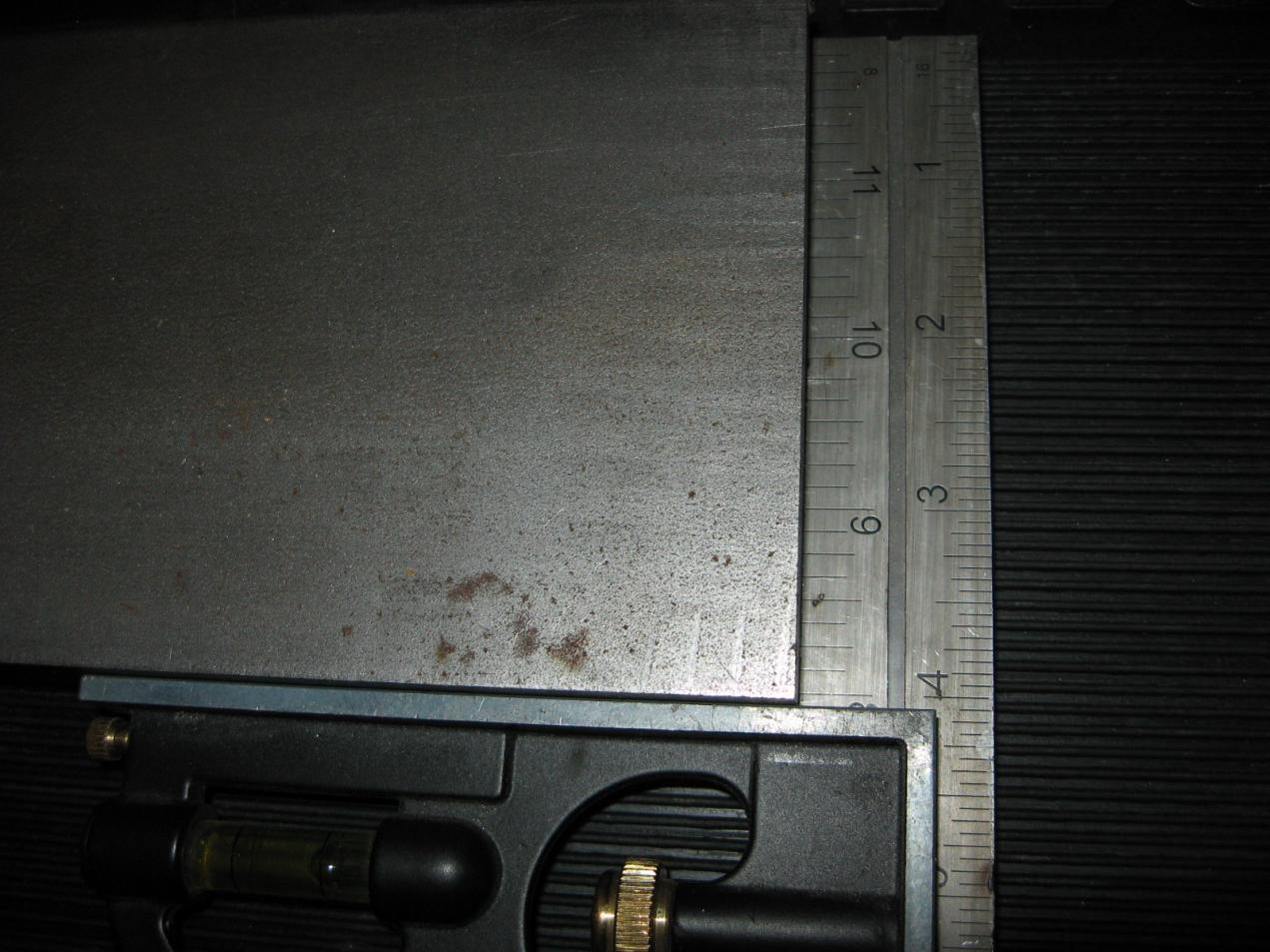

    I'll just have to go out to the shop and put a square on one.

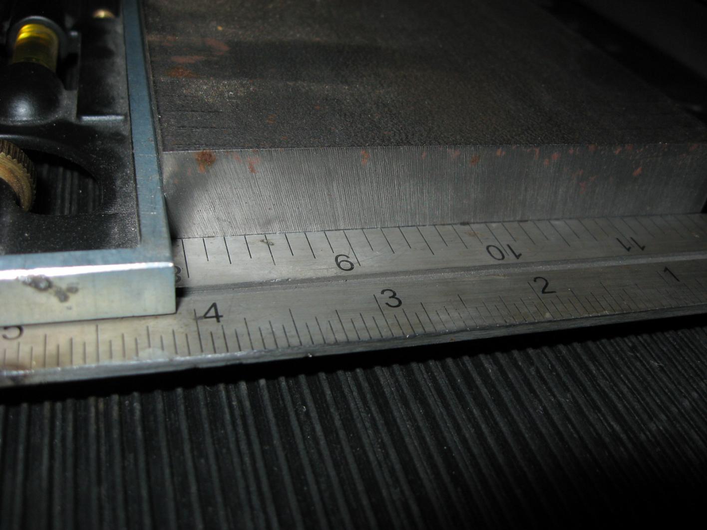

    Ok, I've taken about 30 pics trying to capture both edges with enough light to be clear.
    Keep clicking on this pic until it's at it's full size, then zoom in. (hold Ctrl key and mouse wheel forward for those who may not know) Click image for larger version.

    Looked pretty good, but now it seems to have vanished.
  8. #28
    I edited my reply to you, then decided to put it in a separate post and got my pics screwed up... all fixed now.

    What tpi are you using to cut stuff that thick?
  10. #30
    8-12 tpi vp bi-metal... I use the same blade for everything but I never cut anything thinner than 14ga. I leave the blade speed on it's fastest setting.
