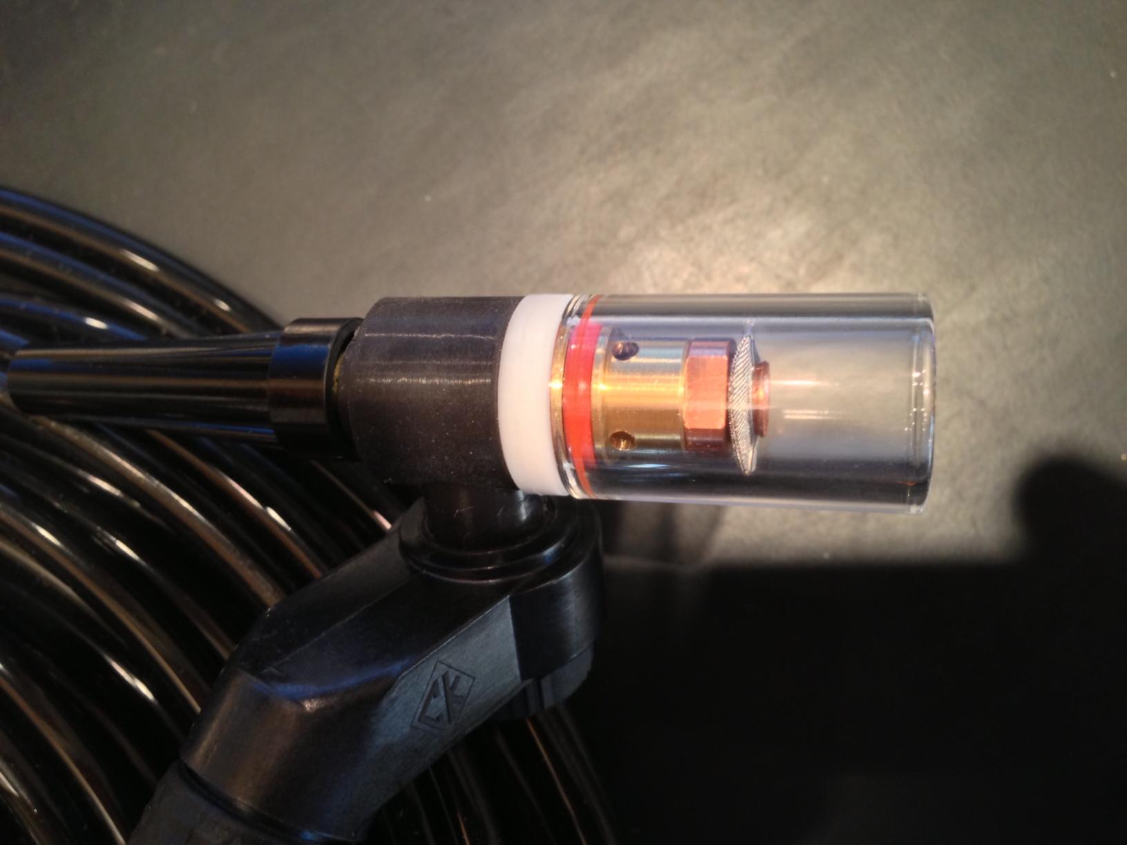

    Good points on the length................. but I just got the torch and it's a real thing of beauty! hahaha!
    I'll "live" with the longer cable and extend the foot pedal cable when I actually need/want to run a full 25' from the 210.
    Here's a close up pic of the head with the "gas saver" collet/screen system installed. Need to get the cable adapter and my ghetto cooler set up.
