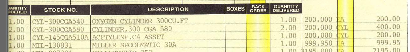

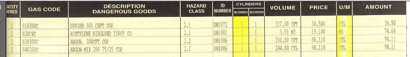

    I bought a MM 252 in the spring and my LWS gave me a killer deal on larger tanks, 300 cu ft for their price of their 250's, so I could not resist. COP=Customer Owned Property. They are a pain to lift but I bought a gantry crane for other needs and will use it for the tanks. They asked if I wanted to fill out a simple form like a company which was just my name and address so I could get better fill rates that they guarantee for months (but not on Helium gas).
    It will be a while before I have to fill these bad boys up. My LWS is only open during the week and I have to scramble at lunch time to get refills done, so the frequency will be less...BONUS!Click image for larger version.

    Prices are in Cdn.
