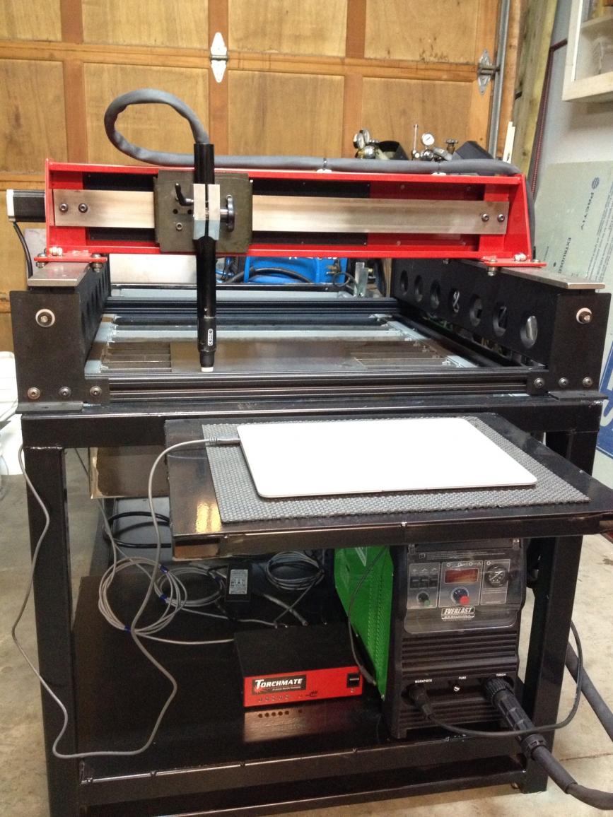

    Hey guys I'm new to site and just recently got everything set up to run my 2x2 cnc table. So for a bit of back ground info, I bought the torchmate unit, the plasma cutter is an everlast 60s blowback with a tramifet cnc machine torch ( I know I know it's not a hypertherm but the reviews and functions of this machine where excellent for the price ) I have wired the cnc control box to the plasma cutter wiring in pins 1 and 2 like supposed to. The problem I'm having is when I go to test the plasma cutter though the aux menu nothing happens? I don't know if this is relevant but when I change from 2t to 4t the plasma turns on and runs continuously with no control from the software. All I'm trying to do is a line test cut on some 14 gauge steel and and having a heck of a time trying to get it to work properly. I'm new to the fabrication world so any input would be greatly appreciated!!!

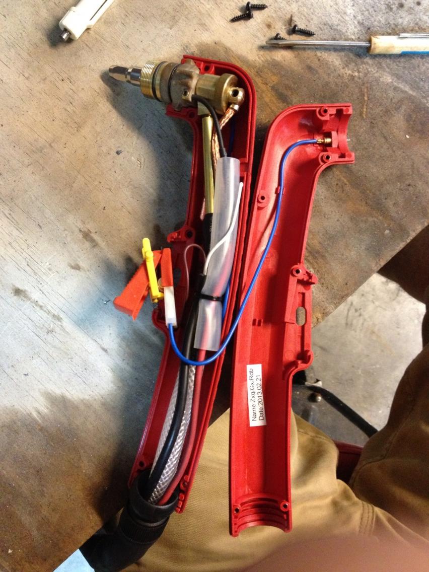

    I think you have a problem wit the torch wiring see the attached image of the torch parts.
    These wires were not in the right place in the connector on my torch and my torch would fire when the plasma unit was turned on, never off until power off. They are a safety so if the tip cover is not tight you get no air/fire from the torch. Mine were wired to pins were to go to the button on the torch handle and that is why it fired all the time. From the statement above it looks like they are in series with the signal from the CNC plug to allow the plasma fire if the cover is on correctly. You may need Everlast techs to help with this.

    Ok so for tonight I've ruled out that it isn't my control box, hooked up an ohm meter to the relay switch and turned on the plasma via computer to make sure that it was sending the signal which it is. So like acourtjester said earlier it is definitely in the machine. Just so everyone is clear on the torch situation I have two egrocut s75 torches, one is the hand torch ( which I use off the cnc table ) and the other is the machine torch for the cnc, both torches are blow back design and the consumables are interchangeable. So saying that I did check the cup and everything is tight and safety pins are pushed in, and still no luck. I also wanted to clear up that I am getting air either constant or timed flow depending on what I have it set at, but still no arc when told by my computer.

    That is my set up

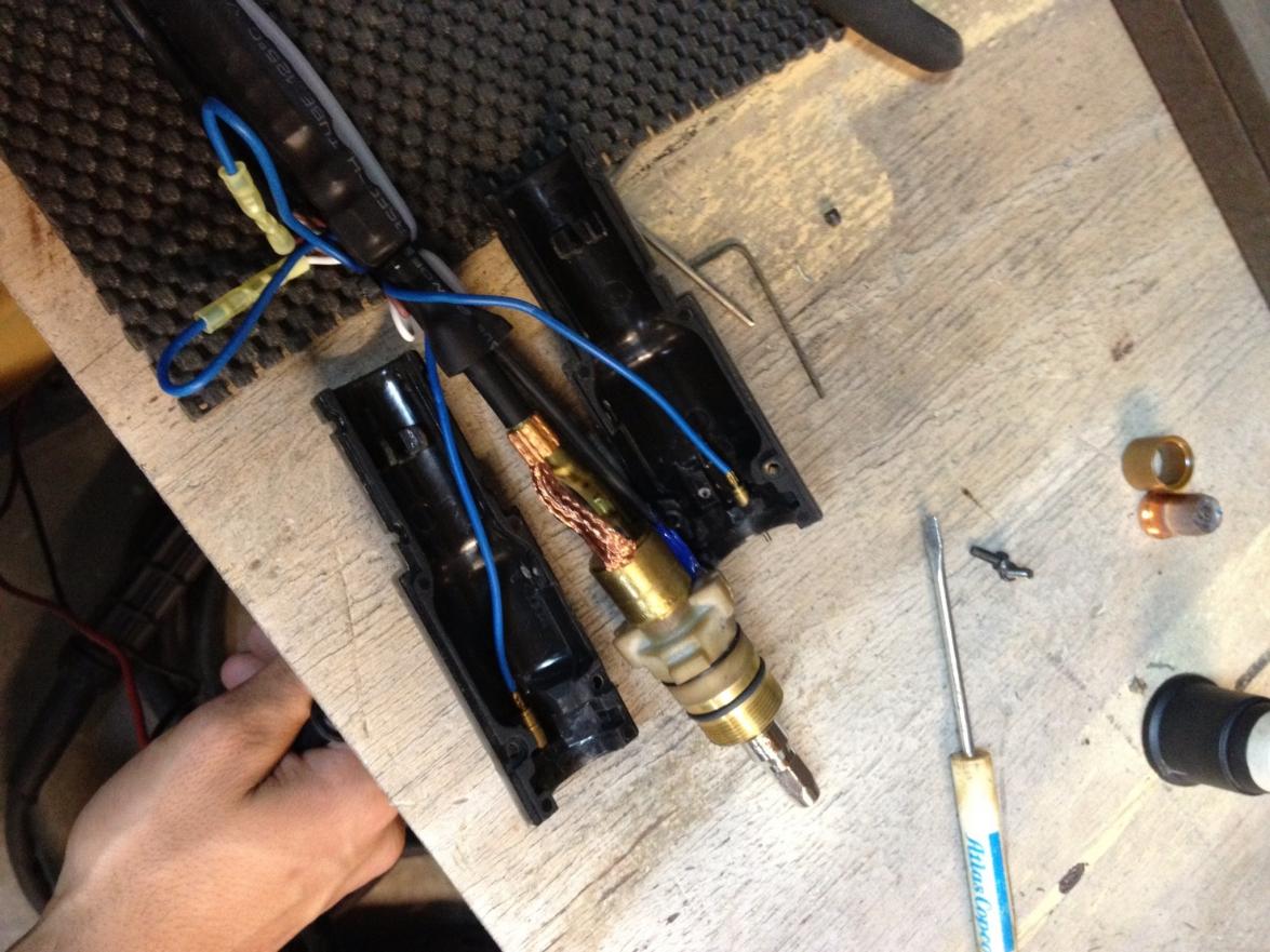

    Ok so I got a little anxious and decided to try using the hand held torch on the machine and using the cnc controls to turn the torch on and off and I'm glad that it worked. I was able to control the Hand torch through my computer however still no luck with machine torch. I took both torches apart to compare wiring and both looked the same. I also check the safety pins with an ohm meter to the end of the hose where the pins come out and am getting continuity on both pins on both the hand held torch and the machine torch so I'm kind of stumped, I took some pics of the torches apart if this helps Click image for larger version.

    Here the machine torchClick image for larger version.

    Have a look at this for a basic checkover of the torch.
    http://www.youtube.com/watch?v=cyKMP...tailpage&t=233
    Be sure the electrode piston is free to move in your machine torch. That is required for an arc start.
